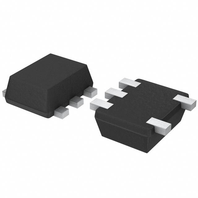

Datasheet Voltage Detector IC Series Free Delay Time Setting CMOS Voltage Detector IC Series BD52xx series BD53xx series General Description Key Specifications Rohm's BD52xx and BD53xx series are highly accurate, low current consumption Voltage Detector ICs with a capacitor-controlled time delay. The line up includes BD52xx devices with N channel open drain output and BD53xx devices with CMOS output. The devices are available for specific detection voltages ranging from 2.3V to 6.0V in increments of 0.1V. ◼ Detection voltage: 2.3V to 6.0V (Typ.) 0.1V steps ◼ High accuracy detection voltage: ±1.0% ◼ Ultra-low current consumption: 0.95µA (Typ.) Package W(typ) x D(typ) x H(max) SSOP5: 2.90mm x 2.80mm x 1.25mm Features VSOF5: ◼ Delay Time Controlled by external Capacitor ◼ Two output types (N channel open drain and CMOS output) ◼ Ultra-low current consumption ◼ Very small and low height package ◼ Package SSOP5 is similar to SOT-23-5(JEDEC) Typical Application Circuit VDD1 1.60mm x 1.60mm x 0.60mm Applications Circuits using microcontrollers or logic circuits that require a reset. VDD2 VDD1 RL RST BD52xx CT CT CL CL (Capacitor for noise filtering) (Capacitor for noise filtering) GND Open Drain Output type BD52xx Series Connection Diagram CT SSOP5 TOP VIEW Pin Descriptions GND CMOS Output type BD53xx Series N.C. VSOF5 TOP VIEW Lot. No Marking VOUT Micro RST controller BD53xx Micro controller VDD GND 4 5 Marking 1 2 3 VOUT SUB CT VDD GND SSOP5 Lot. No VSOF5 PIN No. 1 2 Symbol VOUT VDD Function Reset Output Power Supply Voltage PIN No. 1 2 Symbol VOUT SUB 3 GND GND 3 CT 4 N.C. 4 GND 5 CT Unconnected Terminal Capacitor connection terminal for output delay time Function Reset Output Substrate* Capacitor connection terminal for output delay time GND 5 VDD Power Supply Voltage *Connect the substrate to GND. ○Product structure:Silicon monolithic integrated circuit .www.rohm.com © 2013 ROHM Co., Ltd. All rights reserved. TSZ22111・14・001 ○This product is not designed for protection against radioactive rays 1/14 TSZ02201-0GJG0G300040-1-2 11.Oct.2021 Rev.009 BD52xx series BD53xx series Ordering Information B Part Number D x x Output Type 52 : Open Drain 53 : CMOS www.rohm.com © 2013 ROHM Co., Ltd. All rights reserved. TSZ22111・15・001 x x x - Reset Voltage Value Package 23 : 2.3V G : SSOP5 0.1V step FVE : VSOF5 60 : 6.0V 2/14 T R Packaging and forming specification TR : Embossed tape and reel TSZ02201-0GJG0G300040-1-2 11.Oct.2021 Rev.009 BD52xx series BD53xx series Lineup Table 1. Lineup for SSOP5 Package Package Type Output Type SSOP5 Open Drain Detection Voltage Marking CMOS Part Number Marking Part Number PW BD5260 RW BD5360 PV BD5259 RV BD5359 5.8V PU BD5258 RU BD5358 5.7V PT BD5257 RT BD5357 5.6V PS BD5256 RS BD5356 5.5V PR BD5255 RR BD5355 5.4V PQ BD5254 RQ BD5354 5.3V PP BD5253 RP BD5353 5.2V PN BD5252 RN BD5352 5.1V PM BD5251 RM BD5351 5.0V PL BD5250 RL BD5350 4.9V PK BD5249 RK BD5349 4.8V RJ BD5348 6.0V 5.9V PJ BD5248 4.7V PH BD5247 RH BD5347 4.6V PG BD5246 RG BD5346 4.5V PF BD5245 RF BD5345 4.4V PE BD5244 RE BD5344 4.3V PD BD5243 RD BD5343 4.2V PC BD5242 RC BD5342 4.1V PB BD5241 RB BD5341 4.0V PA BD5240 RA BD5340 3.9V MV BD5239 QV BD5339 3.8V MU BD5238 QU BD5338 3.7V MT BD5237 QT BD5337 3.6V MS BD5236 QS BD5336 3.5V MR BD5235 QR BD5335 3.4V MQ BD5234 QQ BD5334 3.3V MP BD5233 QP BD5333 3.2V MN BD5232 QN BD5332 3.1V MM BD5231 QM BD5331 3.0V ML BD5230 QL BD5330 2.9V MK BD5229 QK BD5329 2.8V QJ BD5328 MJ BD5228 2.7V MH BD5227 QH BD5327 2.6V MG BD5226 QG BD5326 2.5V MF BD5225 QF BD5325 2.4V ME BD5224 QE BD5324 2.3V MD BD5223 QD BD5323 www.rohm.com © 2013 ROHM Co., Ltd. All rights reserved. TSZ22111・15・001 3/14 TSZ02201-0GJG0G300040-1-2 11.Oct.2021 Rev.009 BD52xx series BD53xx series Lineup - continued Table 2. Lineup for VSOF5 Package Package Type Output Type VSOF5 Open Drain Detection Voltage Marking CMOS Part Number Marking Part Number PW BD5260 RW BD5360 PV BD5259 RV BD5359 5.8V PU BD5258 RU BD5358 5.7V PT BD5257 RT BD5357 5.6V PS BD5256 RS BD5356 5.5V PR BD5255 RR BD5355 5.4V PQ BD5254 RQ BD5354 5.3V PP BD5253 RP BD5353 5.2V PN BD5252 RN BD5352 5.1V PM BD5251 RM BD5351 5.0V PL BD5250 RL BD5350 4.9V PK BD5249 RK BD5349 4.8V RJ BD5348 6.0V 5.9V PJ BD5248 4.7V PH BD5247 RH BD5347 4.6V PG BD5246 RG BD5346 4.5V PF BD5245 RF BD5345 4.4V PE BD5244 RE BD5344 4.3V PD BD5243 RD BD5343 4.2V PC BD5242 RC BD5342 4.1V PB BD5241 RB BD5341 4.0V PA BD5240 RA BD5340 3.9V MV BD5239 QV BD5339 3.8V MU BD5238 QU BD5338 3.7V MT BD5237 QT BD5337 3.6V MS BD5236 QS BD5336 3.5V MR BD5235 QR BD5335 3.4V MQ BD5234 QQ BD5334 3.3V MP BD5233 QP BD5333 3.2V MN BD5232 QN BD5332 3.1V MM BD5231 QM BD5331 3.0V ML BD5230 QL BD5330 2.9V MK BD5229 QK BD5329 2.8V QJ BD5328 MJ BD5228 2.7V MH BD5227 QH BD5327 2.6V MG BD5226 QG BD5326 2.5V MF BD5225 QF BD5325 2.4V ME BD5224 QE BD5324 2.3V MD BD5223 QD BD5323 The part number shown in red letters are “Not Recommended for New Designs”. www.rohm.com © 2013 ROHM Co., Ltd. All rights reserved. TSZ22111・15・001 4/14 TSZ02201-0GJG0G300040-1-2 11.Oct.2021 Rev.009 BD52xx series BD53xx series Absolute maximum ratings Parameter Power Supply Voltage Nch Open Drain Output Output Voltage CMOS Output Output Current *1*3 SSOP5 Power *2*3 Dissipation VSOF5 Operating Temperature Ambient Storage Temperature Symbol VDD-GND VOUT Io Pd Topr Tstg Limits -0.3 to +10 GND-0.3 to +10 GND-0.3 to VDD+0.3 80 540 210 -40 to +105 -55 to +125 Unit V V mA mW °C °C *1 Reduced by 5.4mW/°C when used over 25°C. *2 Reduced by 2.1mW/°C when used over 25°C. *3 When mounted on ROHM standard circuit board (70mm×70mm×1.6mm, glass epoxy board). Electrical characteristics (Unless Otherwise Specified Ta=-40 to 105°C) Parameter Symbol Condition VDD=H→L, RL=470kΩ Detection Voltage VDET *1 Limit Min. Typ. VDET(T) VDET(T) ×0.99 2.475 2.5 2.418 - VDET=2.5V Ta=+25°C Ta=-40°C to 85°C VDET=3.0V Ta=85°C to 105°C Ta=+25°C Ta=-40°C to 85°C 2.404 2.970 2.901 3.0 - 2.597 3.030 3.100 VDET=3.3V Ta=85°C to 105°C Ta=+25°C Ta=-40°C to 85°C 2.885 3.267 3.191 3.3 - 3.117 3.333 3.410 VDET=4.2V Ta=85°C to 105°C Ta=+25°C Ta=-40°C to 85°C 3.173 4.158 4.061 4.2 - 3.428 4.242 4.341 VDET=4.8V Ta=85°C to 105°C Ta=+25°C Ta=-40°C to 85°C 4.039 4.752 4.641 4.8 - 4.364 4.848 4.961 0.80 0.85 0.90 0.95 0.75 0.80 0.85 0.90 - 4.987 2.40 2.55 2.70 2.85 2.25 2.40 2.55 2.70 0.5 0.5 - Ta=85°C to 105°C 4.616 VDET =2.3-3.1V VDET =3.2-4.2V Circuit Current when ON IDD1 VDD=VDET-0.2V VDET =4.3-5.2V VDET =5.3-6.0V VDET =2.3-3.1V VDET =3.2-4.2V Circuit Current when OFF IDD2 VDD=VDET+2.0V VDET =4.3-5.2V VDET =5.3-6.0V VOL≤0.4V, Ta=25 to 105°C, RL=470kΩ 0.95 Operating Voltage Range VOPL VOL≤0.4V, Ta=-40 to 25°C, RL=470kΩ 1.20 VDD=1.2V, ISINK = 0.4 mA, VDET=2.3-6.0V ‘Low’ Output Voltage (Nch) VOL VDD=2.4V, ISINK = 2.0 mA, VDET=2.7-6.0V VDD=4.8V, ISOURCE=0.7 mA, VDET(2.3V to 4.2V) VDD-0.5 ‘High’ Output Voltage (Pch) VOH VDD=6.0V, ISOURCE=0.9 mA, VDET(4.3V to 5.2V) VDD-0.5 VDD=8.0V, ISOURCE=1.1 mA, VDET(5.3V to 6.0V) VDD-0.5 VDET (T) : Standard Detection Voltage (2.3V to 6.0V, 0.1V step) RL: Pull-up resistor to be connected between VOUT and power supply. Design Guarantee. (Outgoing inspection is not done on all products.) *1 Guaranteed at Ta=25°C. www.rohm.com © 2013 ROHM Co., Ltd. All rights reserved. TSZ22111・15・001 Max. VDET(T) ×1.01 2.525 2.584 5/14 Unit V µA µA V V V TSZ02201-0GJG0G300040-1-2 11.Oct.2021 Rev.009 BD52xx series BD53xx series Electrical characteristics (Unless Otherwise Specified Ta=-40 to 105°C) - continued Parameter Leak Current Symbol Ileak Limit Condition VDD=VDS=10V *1 VDD=VDET×1.1, VDET=2.3-2.6V, RL=470kΩ VDD=VDET×1.1, VDET=2.7-4.2V, RL=470kΩ CT pin Threshold Voltage VCTH VDD=VDET×1.1, VDET=4.3-5.2V, RL=470kΩ VDD=VDET×1.1, VDET=5.3-6.0V, RL=470kΩ Output Delay Resistance CT pin Output Current Detection Voltage Temperature coefficient Hysteresis Voltage RCT ICT VDD=VDET×1.1 VCT=0.5V VCT=0.1V VDD=0.95V VCT=0.5V VDD=1.5V VDET/∆T Ta=-40°C to 105°C ∆ VDET VDD=L→H→L, RL=470kΩ VDET (T) : Standard Detection Voltage (2.3V to 6.0V, 0.1V step) RL: Pull-up resistor to be connected between VOUT and power supply. Design Guarantee. (Outgoing inspection is not done on all products.) *1 Guaranteed at Ta=25°C. www.rohm.com © 2013 ROHM Co., Ltd. All rights reserved. TSZ22111・15・001 6/14 *1 *1 Unit Min. VDD ×0.30 VDD ×0.30 VDD ×0.35 VDD ×0.40 5.5 15 150 Typ. VDD ×0.40 VDD ×0.45 VDD ×0.50 VDD ×0.50 9 40 240 Max. 0.1 VDD ×0.60 VDD ×0.60 VDD ×0.60 VDD ×0.60 12.5 - - ±100 ±360 ppm/°C VDET ×0.03 VDET ×0.05 VDET ×0.08 V µA V MΩ µA TSZ02201-0GJG0G300040-1-2 11.Oct.2021 Rev.009 BD52xx series BD53xx series Block Diagrams VDD VOUT Vref CT GND Fig.1 BD52xx Series VDD VOUT Vref CT GND Fig.2 www.rohm.com © 2013 ROHM Co., Ltd. All rights reserved. TSZ22111・15・001 BD53xx 7/14 Series TSZ02201-0GJG0G300040-1-2 11.Oct.2021 Rev.009 BD52xx series BD53xx series Typical Performance Curves BD5242G/FVE】 【 【BD5242】 "LOW" OUTPUT CURRENT : IOL[mA] CIRCUIT CURRENT : IDD [μA] 2.0 【BD5342】 1.5 1.0 0.5 0.0 0 1 2 3 4 5 6 7 8 9 10 18 6 3 0 0.0 OUTPUT VOLTAGE : VOUT[V] "HIGH" OUTPUT CURRENT : IOH [mA] 25 VDD =8.0V VDD =6.0V 5 VDD =4.8V 1 2 3 4 5 2.0 2.5 8 【BD5242G/FVE】 【BD5242】 7 【BD5342】 6 5 4 3 2 1 Ta=25℃ 0 0.5 1 1.5 2 2.5 3 3.5 4 4.5 5 5.5 6 DRAIN-SOURCE VOLTAGE : VDS[V] VDD SUPPLY VOLTAGE :VDD [V] Fig.5 “High” Output Current www.rohm.com © 2013 ROHM Co., Ltd. All rights reserved. TSZ22111・15・001 1.5 0 0 0 1.0 9 30 10 0.5 Fig.4 “Low” Output Current 35 15 VDD =1.2V DRAIN-SOURCE VOLTAGE : VDS[V] 【BD5342G/FVE】 【BD5342】 20 VDD =2.4V 9 Fig.3 Circuit Current 40 【BD5342】 12 VDD SUPPLY VOLTAGE :VDD [V] 45 【BD5242G/FVE】 【BD5242】 15 Fig.6 I/O Characteristics 8/14 TSZ02201-0GJG0G300040-1-2 11.Oct.2021 Rev.009 BD52xx series BD53xx series Typical Performance Curves – continued 450 【BD5242】 【BD5242G/FVE】 0.8 CT OUTPUT CURRENT : ICT [μA] OUTPUT VOLTAGE : VOUT[V] 1.0 【BD5342】 0.6 0.4 0.2 0.0 0.0 0.5 1.0 1.5 2.0 400 【BD5242G/FVE】 【BD5242】 350 【BD5342】 300 250 200 150 100 50 0 0 2.5 CIRCU IT CUR REN T WHEN ON : IDD1 [μA] DETECTION VOLTAGE : V DET[V] 4.8 【BD5242】 BD5242G/FVE】 【 【BD5342】 Low to high(VDET+ΔVDET) 4.4 4.0 High to low(VDET) 3.6 ~ ~ 3.2 -40 0 40 80 4 5 1.5 【BD5242】 BD5242G/FVE】 【 【BD5342】 1.0 0.5 0.0 -40 -20 0 20 40 60 80 100 TEMPERATURE : Ta[℃] TEMPERATURE : Ta[℃] Fig.10 Circuit Current when ON Fig.9 Detection Voltage Release Voltage www.rohm.com © 2013 ROHM Co., Ltd. All rights reserved. TSZ22111・15・001 3 Fig.8 CT Terminal Current Fig.7 Operating Limit Voltage 5.2 2 VDD SUPPLY VOLTAGE : VDD [V] VDD SUPPLY VOLTAGE : VDD [V] 5.6 1 9/14 TSZ02201-0GJG0G300040-1-2 11.Oct.2021 Rev.009 BD52xx series BD53xx series Typical Performance Curves – continued 1.5 【BD5242】 BD5242G/FVE】 【 MIN IMU M OPERATING VOL TAGE : VOPL[V] C IR C UIT C UR R ENT WH EN OFF: I DD2 [μA] 1.5 【BD5342】 1.0 0.5 0.0 -40 -20 0 20 40 60 80 100 【BD5242】 【BD5242G/FVE】 【BD5342】 1.0 0.5 0.0 -40 -20 Fig.11 Circuit Current when OFF 40 60 80 100 Fig.12 Operating Limit Voltage 10000 【BD5242G/FVE】 【BD5242】 【BD5242】 【BD5242G/FVE】 【BD5342】 DELAY TIME : tPLH [ms] RESISTANCE OF CT : RCT [MΩ] 20 TEMPERATURE : Ta[℃] TEMPERATURE : Ta[℃] 13 12 11 10 9 8 7 6 5 4 3 2 1 0 -40 -20 0 1000 【BD5342】 100 10 1 0.1 0.0001 0 20 40 60 80 100 0.01 0.1 CAPACITANCE OF CT : CCT[μF] TEMPERATURE : Ta[℃] Fig.14 Delay Time (tPLH) and CT Terminal External Capacitance Fig.13 CT Terminal Circuit Resistance www.rohm.com © 2013 ROHM Co., Ltd. All rights reserved. TSZ22111・15・001 0.001 10/14 TSZ02201-0GJG0G300040-1-2 11.Oct.2021 Rev.009 BD52xx series BD53xx series Application Information Explanation of Operation For both the open drain type (Fig.15) and the CMOS output type (Fig.16), the detection and release voltages are used as threshold voltages. When the voltage applied to the V DD pins reaches the applicable threshold voltage, the VOUT terminal voltage switches from either “High” to “Low” or from “Low” to “High”. Please refer to the Timing Waveform and Electrical Characteristics for information on hysteresis. Because the BD52xx series uses an open drain output type, it is necessary to connect a pull-up resistor to VDD or another power supply if needed [The output “High” voltage (VOUT) in this case becomes VDD or the voltage of the other power supply]. VDD VDD VDD RL R1 VDD Vref VOUT R2 Q2 R1 RESET Vref RESET R2 Q1 Q3 VOUT Q1 Q3 R3 R3 GND GND CT CT Fig.15 (BD52xxType Internal Block Diagram) Fig.16 (BD53xxType Internal Block Diagram) Setting of Detector Delay Time It is possible to set the delay time at the rise of VDD using a capacitor connected to the Ct terminal. Delay time at the rise of VDD tPLH:Time until when Vout rise to 1/2 of VDD after VDD rise up and beyond the release voltage(VDET+∆VDET) tPLH = -CCT×RCT×ln VDD-VCTH VDD CCT: CT pin External Capacitance RCT: CT pin Internal Impedance(Please refer to Electrical Characteristics.) VCTH: CT pin Threshold Voltage(Please refer to Electrical Characteristics.) ln : Natural Logarithm Reference Data of Falling Time (tPHL) Output Examples of Falling Time (tPHL) Output Part Number BD5227 tPHL[µs] -40°C 30.8 tPHL[µs] ,+25°C 30 tPHL[µs],+105°C 28.8 BD5327 26.8 26 24.8 *This data is for reference only. The figures will vary with the application, so please confirm actual operating conditions before use. Timing Waveforms Example: the following shows the relationship between the input voltage VDD, the CT Terminal Voltage VCT and the output voltage VOUT when the input power supply voltage VDD is made to sweep up and sweep down (The circuits are those in Figure.15 and 16). 1 When the power supply is turned on, the output is unstable VDD from after over the operating limit voltage (VOPL) until tPHL. Therefore it is possible that the reset signal is not outputted when VDET+ΔVDET ⑤ VDET the rise time of VDD is faster than tPHL. 2 When VDD is greater than VOPL but less than the reset release VOPL 0V voltage (VDET+∆VDET), the CT terminal (VCT) and output (VOUT) voltages will switch to L. VCT 3 If VDD exceeds the reset release voltage (V DET+∆VDET), then 1/2 VDD VOUT switches from L to H (with a delay due to the CT terminal). 4 If VDD drops below the detection voltage (VDET) when the power supply is powered down or when there is a power supply fluctuation, VOUT switches to L (with a delay of tPHL). VOUT tPLH tPHL tPLH 5 The potential difference between the detection voltage and the tPHL release voltage is known as the hysteresis width (∆VDET). The system is designed such that the output does not toggle with ① ② ③ ④ power supply fluctuations within this hysteresis width, preventing malfunctions due to noise. Fig.17 Timing Waveform www.rohm.com © 2013 ROHM Co., Ltd. All rights reserved. TSZ22111・15・001 11/14 TSZ02201-0GJG0G300040-1-2 11.Oct.2021 Rev.009 BD52xx series BD53xx series Circuit Applications 1) Examples of a common power supply detection reset circuit VDD2 VDD1 RL Micro controller RST BD52xx CT CL (Noise-filtering Capacitor) GND Fig.18 Open Drain Output Type VDD1 Micro RST controller BD53xx CT CL (Noise-filtering Capacitor) Application examples of BD52xx series (Open Drain output type) and BD53xx series (CMOS output type) are shown below. CASE1: Power supply of the microcontroller (VDD2) differs from the power supply of the reset detection (VDD1). Use an open drain output type (BD52xx) device with a load resistance RL attached as shown Fig.18. CASE2: Power supply of the microcontroller (VDD1) is the same as the power supply of the reset detection (VDD1). Use a CMOS output type (BD53xx) device or an open drain output type (BD52xx) device with a pull up resistor between the output and VDD1. When a capacitance CL for noise filtering is connected to the VOUT pin (the reset signal input terminal of the microcontroller), please take into account the waveform of the rise and fall of the output voltage (VOUT). Please refer to Operational Notes for recommendations on resistor and capacitor values. GND Fig.19 CMOS Output Type 2) The following is an example of a circuit application in which an OR connection between two types of detection voltage resets the microcontroller. VDD1 VDD2 VDD3 RL BD52xx NO.1 BD52xx NO.2 RST microcontroller CT CT GND Fig.20 OR Circuit Connection Application To reset the microcontroller when many independent power supplies are used in the system, OR connect an open drain output type (BD52xx series) to the microcontroller’s input with pull-up resistor to the supply voltage of the microcontroller (VDD3) as shown in Fig. 20. By pulling-up to VDD3, output “High” voltage of micro-controller power supply is possible. www.rohm.com © 2013 ROHM Co., Ltd. All rights reserved. TSZ22111・15・001 12/14 TSZ02201-0GJG0G300040-1-2 11.Oct.2021 Rev.009 BD52xx series BD53xx series 3) Examples of the power supply with resistor dividers In applications wherein the power supply voltage of an IC comes from a resistor divider circuit, an in-rush current will flow into the circuit when the output level switches from “High” to “Low” or vice versa. In-rush current is a sudden surge of current that flows from the power supply (VDD) to ground (GND) as the output logic changes its state. This current flow may cause malfunction in the systems operation such as output oscillations, etc. Figure.21 V1 IDD R2 I1 R1 Inrush Current VDD BD52xx BD53xx CIN VOUT CL GND VDD VDET 0 Fig.21 Resistor Divider Connection Application When an in-rush current (I1) flows into the circuit (Refer to Fig. 21) at the time when output switches from “Low” to “High”, a voltage drop of I1×R2 (input resistor) will occur in the circuit causing the VDD supply voltage to decrease. When the VDD voltage drops below the detection voltage, the output will switch from “High” to “Low”. While the output voltage is at “Low” condition, in-rush current will stop flowing and the voltage drop will be reduced. As a result, the output voltage will switches again from “Low” to “High” which causes an in-rush current and a voltage drop. This operation repeats and will result to oscillation. VDD - IDD Peak Current Ta=25℃ 10 BD52xx BD53xx IDD-peak[mA] 1 0.1 0.01 0.001 3 4 5 6 7 8 9 10 VDD[V] Figure.22 IDD Peak Current vs. Power Supply Voltage * This data is for reference only. The figures will vary with the application, so please confirm actual operating conditions before use. www.rohm.com © 2013 ROHM Co., Ltd. All rights reserved. TSZ22111・15・001 13/14 TSZ02201-0GJG0G300040-1-2 11.Oct.2021 Rev.009 BD52xx series BD53xx series Operational Notes 1) Absolute maximum ratings Operating the IC over the absolute maximum ratings may damage the IC. The damage can either be a short circuit between pins or an open circuit between pins. Therefore, it is important to consider circuit protection measures, such as adding a fuse, in case the IC is operated over the absolute maximum ratings. 2) Ground Voltage The voltage of the ground pin must be the lowest voltage of all pins of the IC at all operating conditions. Ensure that no pins are at a voltage below the ground pin at any time, even during transient condition. 3) Recommended operating conditions These conditions represent a range within which the expected characteristics of the IC can be approximately obtained. The electrical characteristics are guaranteed under the conditions of each parameter. 4) Bypass Capacitor for Noise Rejection To help reject noise, put a 1µF capacitor between VDD pin and GND and 1000pF capacitor between VOUT pin and GND. Be careful when using extremely big capacitor as transient response will be affected. 5) Short between pins and mounting errors Be careful when mounting the IC on printed circuit boards. The IC may be damaged if it is mounted in a wrong orientation or if pins are shorted together. Short circuit may be caused by conductive particles caught between the pins. 6) Operation under strong electromagnetic field Operating the IC in the presence of a strong electromagnetic field may cause the IC to malfunction. 7) The VDD line impedance might cause oscillation because of the detection current. 8) A VDD to GND capacitor (as close connection as possible) should be used in high VDD line impedance condition. 9) Lower than the mininum input voltage puts the VOUT in high impedance state, and it must be V DD in pull up (VDD) condition. 10) External parameters The recommended value of RL Resistor is 50kΩ to 1MΩ. The recommended value of CT Capacitor is over 100pF to 0.1µF. There are many factors (board layout, etc) that can affect characteristics. Please verify and confirm using practical applications. 11) Power on reset operation Please note that the power on reset output varies with the VDD rise time. Please verify the behavior in the actual operation. 12) Testing on application boards When testing the IC on an application board, connecting a capacitor directly to a low-impedance output pin may subject the IC to stress. Always discharge capacitors completely after each process or step. The IC’s power supply should always be turned off completely before connecting or removing it from the test setup during the inspection process. To prevent damage from static discharge, ground the IC during assembly and use similar precautions during transport and storage. 13) Rush current When power is first supplied to the IC, rush current may flow instantaneously. It is possible that the charge current to the parasitic capacitance of internal photo diode or the internal logic may be unstable. Therefore, give special consideration to power coupling capacitance, power wiring, width of GND wiring, and routing of connections. 14) CT pin discharge Due to the capabilities of the CT pin discharge transistor, the CT pin may not completely discharge when a short input pulse is applied, and in this case the delay time may not be controlled. Please verify the actual operation. . www.rohm.com © 2013 ROHM Co., Ltd. All rights reserved. TSZ22111・15・001 14/14 TSZ02201-0GJG0G300040-1-2 11.Oct.2021 Rev.009 BD52xx series BD53xx series Ordering Information B D x Output Type 52 : Open Drain 53 : CMOS x x x G Reset Voltage Value 23:2.3 V ↓ 0.1 Vstep 60:6.0 V - Package G: SSOP5A Z Production site Z : Added TR Packaging and forming specification TR: Embossed tape and reel Marking Diagram SSOP5A (TOP VIEW) Part Number Marking LOT Number Output Type Open Drain Detection Voltage Marking 6.0V 5.9V 5.8V 5.7V 5.6V 5.5V 5.4V 5.3V 5.2V 5.1V 5.0V 4.9V 4.8V 4.7V 4.6V 4.5V 4.4V 4.3V 4.2V 4.1V 4.0V www.rohm.com © 2013 ROHM Co., Ltd. All rights reserved. TSZ22111・15・001 PW PV PU PT PS PR PQ PP PN PM PL PK PJ PH PG PF PE PD PC PB PA CMOS Part Number Marking Part Number BD5260 BD5259 BD5258 BD5257 BD5256 BD5255 BD5254 BD5253 BD5252 BD5251 BD5250 BD5249 BD5248 BD5247 BD5246 BD5245 BD5244 BD5243 BD5242 BD5241 BD5240 RW RV RU RT RS RR RQ RP RN RM RL RK RJ RH RG RF RE RD RC RB RA BD5360 BD5359 BD5358 BD5357 BD5356 BD5355 BD5354 BD5353 BD5352 BD5351 BD5350 BD5349 BD5348 BD5347 BD5346 BD5345 BD5344 BD5343 BD5342 BD5341 BD5340 14-2/14 TSZ02201-0GJG0G300040-1-2 11.Oct.2021 Rev.009 BD52xx series BD53xx series Marking Diagram - continued Output Type Open Drain Detection Voltage Marking 3.9V 3.8V 3.7V 3.6V 3.5V 3.4V 3.3V 3.2V 3.1V 3.0V 2.9V 2.8V 2.7V 2.6V 2.5V 2.4V 2.3V www.rohm.com © 2013 ROHM Co., Ltd. All rights reserved. TSZ22111・15・001 MV MU MT MS MR MQ MP MN MM ML MK MJ MH MG MF ME MD CMOS Part Number Marking Part Number BD5239 BD5238 BD5237 BD5236 BD5235 BD5234 BD5233 BD5232 BD5231 BD5230 BD5229 BD5228 BD5227 BD5226 BD5225 BD5224 BD5223 QV QU QT QS QR QQ QP QN QM QL QK QJ QH QG QF QE QD BD5339 BD5338 BD5337 BD5336 BD5335 BD5334 BD5333 BD5332 BD5331 BD5330 BD5329 BD5328 BD5327 BD5326 BD5325 BD5324 BD5323 14-3/14 TSZ02201-0GJG0G300040-1-2 11.Oct.2021 Rev.009 BD52xx series BD53xx series Physical Dimension and Packing Information Package Name www.rohm.com © 2013 ROHM Co., Ltd. All rights reserved. TSZ22111・15・001 SSOP5A 14-4/14 TSZ02201-0GJG0G300040-1-2 11.Oct.2021 Rev.009 BD52xx series BD53xx series Revision History Date 11.Oct.2021 Revision 009 www.rohm.com © 2013 ROHM Co., Ltd. All rights reserved. TSZ22111・15・001 Changes Added “Revision History”. Added words for Not Recommended New Designs category product. 14-5/14 TSZ02201-0GJG0G300040-1-2 11.Oct.2021 Rev.009 Notice Precaution on using ROHM Products 1. Our Products are designed and manufactured for application in ordinary electronic equipment (such as AV equipment, OA equipment, telecommunication equipment, home electronic appliances, amusement equipment, etc.). If you intend to use our Products in devices requiring extremely high reliability (such as medical equipment (Note 1), transport equipment, traffic equipment, aircraft/spacecraft, nuclear power controllers, fuel controllers, car equipment including car accessories, safety devices, etc.) and whose malfunction or failure may cause loss of human life, bodily injury or serious damage to property (“Specific Applications”), please consult with the ROHM sales representative in advance. Unless otherwise agreed in writing by ROHM in advance, ROHM shall not be in any way responsible or liable for any damages, expenses or losses incurred by you or third parties arising from the use of any ROHM’s Products for Specific Applications. (Note1) Medical Equipment Classification of the Specific Applications JAPAN USA EU CHINA CLASSⅢ CLASSⅡb CLASSⅢ CLASSⅢ CLASSⅣ CLASSⅢ 2. ROHM designs and manufactures its Products subject to strict quality control system. However, semiconductor products can fail or malfunction at a certain rate. Please be sure to implement, at your own responsibilities, adequate safety measures including but not limited to fail-safe design against the physical injury, damage to any property, which a failure or malfunction of our Products may cause. The following are examples of safety measures: [a] Installation of protection circuits or other protective devices to improve system safety [b] Installation of redundant circuits to reduce the impact of single or multiple circuit failure 3. Our Products are designed and manufactured for use under standard conditions and not under any special or extraordinary environments or conditions, as exemplified below. Accordingly, ROHM shall not be in any way responsible or liable for any damages, expenses or losses arising from the use of any ROHM’s Products under any special or extraordinary environments or conditions. If you intend to use our Products under any special or extraordinary environments or conditions (as exemplified below), your independent verification and confirmation of product performance, reliability, etc, prior to use, must be necessary: [a] Use of our Products in any types of liquid, including water, oils, chemicals, and organic solvents [b] Use of our Products outdoors or in places where the Products are exposed to direct sunlight or dust [c] Use of our Products in places where the Products are exposed to sea wind or corrosive gases, including Cl2, H2S, NH3, SO2, and NO2 [d] Use of our Products in places where the Products are exposed to static electricity or electromagnetic waves [e] Use of our Products in proximity to heat-producing components, plastic cords, or other flammable items [f] Sealing or coating our Products with resin or other coating materials [g] Use of our Products without cleaning residue of flux (Exclude cases where no-clean type fluxes is used. However, recommend sufficiently about the residue.) ; or Washing our Products by using water or water-soluble cleaning agents for cleaning residue after soldering [h] Use of the Products in places subject to dew condensation 4. The Products are not subject to radiation-proof design. 5. Please verify and confirm characteristics of the final or mounted products in using the Products. 6. In particular, if a transient load (a large amount of load applied in a short period of time, such as pulse, is applied, confirmation of performance characteristics after on-board mounting is strongly recommended. Avoid applying power exceeding normal rated power; exceeding the power rating under steady-state loading condition may negatively affect product performance and reliability. 7. De-rate Power Dissipation depending on ambient temperature. When used in sealed area, confirm that it is the use in the range that does not exceed the maximum junction temperature. 8. Confirm that operation temperature is within the specified range described in the product specification. 9. ROHM shall not be in any way responsible or liable for failure induced under deviant condition from what is defined in this document. Precaution for Mounting / Circuit board design 1. When a highly active halogenous (chlorine, bromine, etc.) flux is used, the residue of flux may negatively affect product performance and reliability. 2. In principle, the reflow soldering method must be used on a surface-mount products, the flow soldering method must be used on a through hole mount products. If the flow soldering method is preferred on a surface-mount products, please consult with the ROHM representative in advance. For details, please refer to ROHM Mounting specification Notice-PGA-E © 2015 ROHM Co., Ltd. All rights reserved. Rev.004 Precautions Regarding Application Examples and External Circuits 1. If change is made to the constant of an external circuit, please allow a sufficient margin considering variations of the characteristics of the Products and external components, including transient characteristics, as well as static characteristics. 2. You agree that application notes, reference designs, and associated data and information contained in this document are presented only as guidance for Products use. Therefore, in case you use such information, you are solely responsible for it and you must exercise your own independent verification and judgment in the use of such information contained in this document. ROHM shall not be in any way responsible or liable for any damages, expenses or losses incurred by you or third parties arising from the use of such information. Precaution for Electrostatic This Product is electrostatic sensitive product, which may be damaged due to electrostatic discharge. Please take proper caution in your manufacturing process and storage so that voltage exceeding the Products maximum rating will not be applied to Products. Please take special care under dry condition (e.g. Grounding of human body / equipment / solder iron, isolation from charged objects, setting of Ionizer, friction prevention and temperature / humidity control). Precaution for Storage / Transportation 1. Product performance and soldered connections may deteriorate if the Products are stored in the places where: [a] the Products are exposed to sea winds or corrosive gases, including Cl 2, H2S, NH3, SO2, and NO2 [b] the temperature or humidity exceeds those recommended by ROHM [c] the Products are exposed to direct sunshine or condensation [d] the Products are exposed to high Electrostatic 2. Even under ROHM recommended storage condition, solderability of products out of recommended storage time period may be degraded. It is strongly recommended to confirm solderability before using Products of which storage time is exceeding the recommended storage time period. 3. Store / transport cartons in the correct direction, which is indicated on a carton with a symbol. Otherwise bent leads may occur due to excessive stress applied when dropping of a carton. 4. Use Products within the specified time after opening a humidity barrier bag. Baking is required before using Products of which storage time is exceeding the recommended storage time period. Precaution for Product Label A two-dimensional barcode printed on ROHM Products label is for ROHM’s internal use only. Precaution for Disposition When disposing Products please dispose them properly using an authorized industry waste company. Precaution for Foreign Exchange and Foreign Trade act Since concerned goods might be fallen under listed items of export control prescribed by Foreign exchange and Foreign trade act, please consult with ROHM in case of export. Precaution Regarding Intellectual Property Rights 1. All information and data including but not limited to application example contained in this document is for reference only. ROHM does not warrant that foregoing information or data will not infringe any intellectual property rights or any other rights of any third party regarding such information or data. 2. ROHM shall not have any obligations where the claims, actions or demands arising from the combination of the Products with other articles such as components, circuits, systems or external equipment (including software). 3. No license, expressly or implied, is granted hereby under any intellectual property rights or other rights of ROHM or any third parties with respect to the Products or the information contained in this document. Provided, however, that ROHM will not assert its intellectual property rights or other rights against you or your customers to the extent necessary to manufacture or sell products containing the Products, subject to the terms and conditions herein. Other Precaution 1. This document may not be reprinted or reproduced, in whole or in part, without prior written consent of ROHM. 2. The Products may not be disassembled, converted, modified, reproduced or otherwise changed without prior written consent of ROHM. 3. In no event shall you use in any way whatsoever the Products and the related technical information contained in the Products or this document for any military purposes, including but not limited to, the development of mass-destruction weapons. 4. The proper names of companies or products described in this document are trademarks or registered trademarks of ROHM, its affiliated companies or third parties. Notice-PGA-E © 2015 ROHM Co., Ltd. All rights reserved. Rev.004 Datasheet General Precaution 1. Before you use our Products, you are requested to carefully read this document and fully understand its contents. ROHM shall not be in any way responsible or liable for failure, malfunction or accident arising from the use of any ROHM’s Products against warning, caution or note contained in this document. 2. All information contained in this document is current as of the issuing date and subject to change without any prior notice. Before purchasing or using ROHM’s Products, please confirm the latest information with a ROHM sales representative. 3. The information contained in this document is provided on an “as is” basis and ROHM does not warrant that all information contained in this document is accurate and/or error-free. ROHM shall not be in any way responsible or liable for an y damages, expenses or losses incurred b y you or third parties resulting from inaccuracy or errors of or concerning such information. Notice – WE © 2015 ROHM Co., Ltd. All rights reserved. Rev.001

物料型号:文档描述了ROHM的BD52xx系列和BD53xx系列电压检测IC。
器件简介:这些IC是具有电容控制延迟功能的高精度、低电流消耗的电压检测器。BD52xx系列提供N通道开漏输出,而BD53xx系列提供CMOS输出。
引脚分配: - SSOP5封装: - 1号引脚:VOUT(复位输出) - 2号引脚:VDD(电源电压) - 3号引脚:GND(地) - 4号引脚:N.C.(未连接终端) - 5号引脚:Cr(输出延迟时间的电容连接端) - VSOF5封装: - 1号引脚:VOUT(复位输出) - 2号引脚:SUB(基板) - 3号引脚:CT(输出延迟时间的电容连接端) - 4号引脚:GND(地) - 5号引脚:VDD(电源电压)
参数特性: - 检测电压范围:2.3V至6.0V,以0.1V为步进。 - 高精度检测电压:±1.0%。 - 超低电流消耗:典型值为0.95µA。
功能详解:器件提供了两种输出类型,用于需要重置的微控制器或逻辑电路。通过外部电容控制延迟时间,以实现更稳定的系统重置。
应用信息:文档提供了典型应用电路图,包括开漏输出型和CMOS输出型的应用示例,以及如何设置检测延迟时间。
封装信息:提供了两种封装类型(SSOP5和VSOF5)的详细物理尺寸和包装信息。
