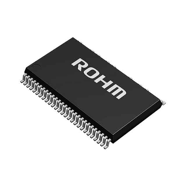

BM6248FS-E2
BM6248FS-E2
    ROHM(罗姆)
    SOP54
    IC MTR DRV DC 13.5-16.5V SSOPA54
BM6248FS-E2 数据手册
Datasheet For Air-Conditioner Fan Motor 3-Phase Brushless Fan Motor Driver BM6248FS General Description Key Specifications        This 3-phase Brushless Fan motor driver IC adopts PrestoMOS™ as the output transistor, and put in a small full molding package with the 180° sinusoidal commutation controller chip and the high voltage gate driver chip. The protection circuits for overcurrent, overheating, under voltage lock out and the high voltage bootstrap diode with current regulation are built-in. It provides downsizing the built-in PCB of the motor. Output MOSFET Voltage: Driver Output Current (DC): Driver Output Current (Pulse): Output MOSFET DC On Resistance: Duty Control Voltage Range: Phase Control Range: Maximum Junction Temperature: Package Features 600V ±1.5A (Max) ±2.5A (Max) 2.7Ω (Typ) 2.1V to 5.4V 0° to +40° +150°C W(Typ) x D(Typ) x H(Max) SSOP-A54_36A 2.0mm x 14.1mm x 2.4mm  600V PrestoMOS™ Built-in  Output Current 1.5A  Bootstrap operation by floating high side driver (including diode)  180° Sinusoidal Commutation Logic  PWM Control (Upper and lower arm switching)  Phase control supported from 0° to +40° at 1° intervals  Rotational Direction Switch  FG signal output with pulse number switch (4 or 12)  VREG Output (5V/30mA)  Protection circuits provided: CL, OCP, TSD, UVLO, MLP and the external fault input  Fault Output (open drain) SSOP-A54_36 Applications  Air Conditioners; Air Purifiers; Water Pumps; Dishwashers; Washing Machines SSOP-A54_36A Typical Application Circuit VDC GND D1 VCC C5 C6 R1 VSP C7 C13 C1 C8 R2 HW HV M VREG C2~C4 C9 HU C11 R10 R13 R8 C14 R11 R6 Q1 R5 FG R12 C10 R9 R4 R3 C12 R7 DTR Figure 1. Application Circuit Example 〇Product structure : Semiconductor IC www.rohm.com © 2018 ROHM Co., Ltd. All rights reserved. TSZ22111 • 14 • 001 〇This product has no designed protection against radioactive rays 1/30 TSZ02201-0P1P0C402200-1-2 22.Feb.2019 Rev.002 BM6248FS Contents General Description ........................................................................................................................................................................ 1 Features.......................................................................................................................................................................................... 1 Applications .................................................................................................................................................................................... 1 Key Specifications .......................................................................................................................................................................... 1 Package .................................................................................................................................................................................. 1 Typical Application Circuit ............................................................................................................................................................... 1 Contents ......................................................................................................................................................................................... 2 Block Diagram and Pin Configuration ............................................................................................................................................. 3 Pin Description................................................................................................................................................................................ 3 Description of Blocks ...................................................................................................................................................................... 4 Controller Outputs and Operation Mode Summary ......................................................................................................................... 9 Absolute Maximum Ratings .......................................................................................................................................................... 10 Thermal Resistance ..................................................................................................................................................................... 10 Recommended Operating Conditions ........................................................................................................................................... 11 Electrical Characteristics (Driver part) .......................................................................................................................................... 11 Electrical Characteristics (Controller part) .................................................................................................................................... 12 Typical Performance Curves (Reference Data) ............................................................................................................................ 13 Timing Chart ................................................................................................................................................................................. 21 Application Example ..................................................................................................................................................................... 23 Parts List ....................................................................................................................................................................................... 23 Dummy Pin Descriptions............................................................................................................................................................... 24 I/O Equivalent Circuits .................................................................................................................................................................. 25 Operational Notes ......................................................................................................................................................................... 26 Ordering Information ..................................................................................................................................................................... 28 Marking Diagrams ......................................................................................................................................................................... 28 Physical Dimension and Packing Information ............................................................................................................................... 29 Revision History ............................................................................................................................................................................ 30 www.rohm.com © 2018 ROHM Co., Ltd. All rights reserved. TSZ22111 • 15 • 001 2/30 TSZ02201-0P1P0C402200-1-2 22.Feb.2019 Rev.002 BM6248FS Block Diagram and Pin Configuration VCC VCC VSP VREG 1 5 VREG VSP 6 7 UH UL HW 9 HWP 10 HVN 11 HV HU HVP 12 HUN 13 HUP 14 PCT 15 PC 16 VH VL V/I VREG A/D 6 TEST VREG CCW 17 FGS 18 VREG FG 19 FOB 20 SNS 21 VDC 35 BU 34 U 33 BV 32 V 31 VDC 30 BW 29 W 28 PGND VCC GND TEST VREG HWN 36 LOGIC WH WL LEVEL SHIFT & GATE DRIVER LEVEL SHIFT & GATE DRIVER LEVEL SHIFT & GATE DRIVER GND GND VCC VSP 24 FAULT VREG FAULT SINE WAVE GENE. OSC BU VREG NC HWN HWP HVN HVP HUN HUP PCT PC CCW M U BV V VDC FGS FG FOB SNS NC RT GND 26 GND FIB VDC GND 23 RT BW W GND GND VCC VSP Figure 2. Block Diagram PGND Figure 3. Pin Configuration (Top View) Pin Description Pin 1 2 3 4 5 6 7 8 9 10 11 12 13 14 15 16 17 18 19 20 21 22 23 24 25 26 27 Name VCC GND GND GND VCC VSP VREG NC HWN HWP HVN HVP HUN HUP PCT PC CCW FGS FG FOB SNS NC RT GND GND GND VCC Function Low voltage power supply Ground Ground Ground Low voltage power supply Duty control voltage input pin Regulator output No connection Hall input pin phase WHall input pin phase W+ Hall input pin phase VHall input pin phase V+ Hall input pin phase UHall input pin phase U+ VSP offset voltage output pin Phase control input pin Direction switch (H:CCW) FG pulse # switch (H:12, L:4) FG signal output Fault signal output (open drain) Over current sense pin No connection Carrier frequency setting pin Ground Ground Ground Low voltage power supply Pin 36 - Name VDC VDC Function High voltage power supply 35 34 BU U U Phase U floating power supply 33 32 BV V V Phase V floating power supply 31 VDC VDC 30 29 BW W W 28 PGND PGND Phase U output Phase V output High voltage power supply Phase W floating power supply Phase W output Ground (current sense pin) Note) All pin cut surfaces visible from the side of package are no connected, except the pin number is expressed as a “-”. www.rohm.com © 2018 ROHM Co., Ltd. All rights reserved. TSZ22111 • 15 • 001 3/30 TSZ02201-0P1P0C402200-1-2 22.Feb.2019 Rev.002 BM6248FS Description of Blocks 1. Commutation Logic When the hall frequency is about 1.4Hz or less (e.g. when the motor starts up), the commutation mode is 120° square wave drive with upper and lower switching (no lead angle). The controller monitors the hall frequency, and switches to 180° sinusoidal commutation drive when the hall frequency reaches or exceeds about 1.4Hz over four consecutive cycles. Refer to the timing charts in Figures 46 and 47. 2. Duty Control The switching duty can be controlled by forcing DC voltage with value from VSPMIN to VSPMAX to the VSP pin. When the VSP voltage is VSPTST or more, the controller forces PC pin voltage to ground (Testing mode, maximum duty and no lead angle). The VSP pin is pulled down internally by a 200 kΩ resistor. Therefore, note the impedance when setting the VSP voltage with a resistance voltage divider. 3. Carrier Frequency Setting The carrier frequency setting can be freely adjusted by connecting an external resistor between the RT pin and ground. The RT pin is biased to a constant voltage, which determines the charge current to the internal capacitor. Carrier frequencies can be set within a range from about 16 kHz to 50 kHz. Refer to the formula to the right. f OSC [kHz]  400 RT [k ] 4. FG Signal Output The number of FG output pulses can be switched in accordance with the number of poles and the rotational speed of the motor. The FG signal is output from the FG pin. The 12-pulse signal is generated from the three hall signals (exclusive NOR), and the 4-pulse signal is the same as hall U signal. It is recommended to pull up FGS pin to VREG voltage when malfunctioning because of the noise. FGS No. of pulse H 12 L 4 CCW Direction H CCW L CW 5. Direction of Motor Rotation Setting The direction of rotation can be switched by the CCW pin. When CCW pin is “H” or open, the motor rotates at CCW direction. When the real direction is different from the setting, the commutation mode is 120° square wave drive (no lead angle). It is recommended to pull up CCW pin to VREG voltage when malfunctioning because of the noise. 6. Hall Signal Comparator The hall comparator provides voltage hysteresis to prevent noise malfunctions. The bias current to the hall elements should be set to the input voltage amplitude from the element, at a value is the minimum input voltage (VHALLMIN) or more. We recommend connecting a ceramic capacitor with value from 100 pF to 0.01 µF, between the differential input pins of the hall comparator. Note that the bias to hall elements must be set within the common mode input voltage range V HALLCM. www.rohm.com © 2018 ROHM Co., Ltd. All rights reserved. TSZ22111 • 15 • 001 4/30 TSZ02201-0P1P0C402200-1-2 22.Feb.2019 Rev.002 BM6248FS Description of Blocks - continued 7. Output Duty Pulse Width Limiter Pulse width duty is controlled during PWM switching in order to ensure the operation of internal power transistor. The controller doesn’t output pulse of less than tMIN (0.8µs minimum). Dead time is forcibly provided to prevent external power transistors from turning on simultaneously in upper and lower side in driver output (for example, UH and UL) of each arm. This will not overlap the minimum time tDT (1.6µs minimum). Because of this, the maximum duty of 120° square wave drive at start up is 84% (typical). 8. Phase Control Setting The driving signal phase can be advanced to the hall signal for phase control. The lead angle is set by forcing DC voltage to the PC pin. The input voltage is converted digitally by a 6-bit A/D converter, in which internal VREG voltage is assumed to be full-scale, and the converted data is processed by a logic circuit. The lead angle can be set from 0° to +40° at 1° intervals, and updated fourth hall cycle of phase W falling edge. Phase control function only operates at sinusoidal commutation mode. However, the controller forces PC pin voltage to ground (no lead angle) during testing mode. The VSP offset voltage (Figure 32) is buffered to PCT pin, to connect an external resistor between PCT pin and ground. The internal bias current is determined by PCT voltage and the resistor value (VPCT / RPCT), and mixed to PC pin. PC pin voltage is VPC = VPCT / RPCT x RPCL. As a result, the lead angle setting is followed with the duty control voltage, and the performance of the motor can be improved. Select the RPCT value from 50 kΩ to 200 kΩ in the range on the basis of 100 kΩ, because the PCT pin current capability is a 100 µA or less. VPCT = VSP-VSPMIN VSP VSPMIN PCT L.A. VPCT RPCT L.A. PC ADC RPCL RPCT VSP Figure 4. Phase Control Setting Example 1 VREG VPCT = VSP-VSPMIN VSP VSPMIN PCT L.A. VPCT RPCT L.A. RPCH PC ADC RPCL RPCT VSP Figure 5. Phase Control Setting Example 2 9. Current Limiter (CL) Circuit and Overcurrent Protection (OCP) Circuit The current limiter circuit can be activated by connecting a low value resistor for current detection between the output stage ground (PGND) and the controller ground (GND). When the SNS pin voltage reaches or surpasses the threshold value (VSNS, 0.5V typical), the controller forces all the upper switching arm inputs low (UH, VH, WH = L, L, L), thus initiating the current limiter operation. When the SNS pin voltage swings below the ground, it is recommended to insert a resistor (1.5 kΩ or more) between SNS pin and PGND pin to prevent malfunction. Since this limiter circuit is not a latch type, it returns to normal operation - synchronizing with the carrier frequency - once the SNS pin voltage falls below the threshold voltage. A filter is built into the overcurrent detection circuit to prevent malfunctions, and does not activate when a short pulse of less than tMASK is present at the input. When the SNS pin voltage reaches or surpasses the threshold value (VOVER, 0.9V typical) because of the power fault or the short circuit except the ground fault, the gate driver outputs low to the gate of all output MOSFETs, thus initiating the overcurrent protection operation. Since this protection circuit is also not a latch type, it returns to normal operation synchronizing with the carrier frequency. www.rohm.com © 2018 ROHM Co., Ltd. All rights reserved. TSZ22111 • 15 • 001 5/30 TSZ02201-0P1P0C402200-1-2 22.Feb.2019 Rev.002 BM6248FS Description of Blocks - continued 10. Under Voltage Lock Out (UVLO) Circuit To secure the lowest power supply voltage necessary to operate the controller and the driver, and to prevent under voltage malfunctions, the UVLO circuits are independently built into the upper side floating driver, the lower side driver and the controller. When the supply voltage falls to VUVL and below, the controller forces driver outputs low. When the voltage rises to VUVH and above, the UVLO circuit ends the lockout operation and returns the chip only after 32 carrier frequency periods (1.6ms for the default 20kHz frequency) to normal operation. Even if the controller returns to normal operation, the output begins from the following control input signal. The voltage monitor circuit (4.0V nominal) is built-in for the VREG voltage. Therefore, the UVLO circuit does not release operation when the VREG voltage rising is delayed behind the VCC voltage rising even if VCC voltage becomes VUVH or more. 11. Thermal Shutdown (TSD) Circuit The TSD circuit operates when the junction temperature of the controller exceeds the preset temperature (125°C nominal). At this time, the controller forces all driver outputs low. Since thermal hysteresis is provided in the TSD circuit, the chip returns to normal operation when the junction temperature falls below the preset temperature (100°C nominal). The TSD circuit is designed only to shut the IC off to prevent thermal runaway. It is not designed to protect the IC or guarantee its operation in the presence of extreme heat. Do not continue to use the IC after the TSD circuit is activated, and do not use the IC in an environment where activation of the circuit is assumed. Moreover, it is not possible to follow the output MOSFET junction temperature rising rapidly because it is a gate driver chip that monitors the temperature and it is likely not to function effectively. 12. Motor Lock Protection (MLP) Circuit When the controller detects the motor locking during fixed time of 4 seconds nominal when each edge of the hall signal doesn't input either, the controller forces all driver outputs low under a fixed time 20 seconds nominal, and self-returns to normal operation. This circuit is enabled if the voltage force to VSP is over the duty minimum voltage V SPMIN, and note that the motor cannot start up when the controller doesn’t detect the motor rotation by the minimum duty control. Even if the edge of the hall signal is inputted within range of the OFF state by this protection circuit, it is ignored. But if the VSP is forced to ground level once, the protection can be canceled immediately. 13. Hall Signal Wrong Input Detection Hall element abnormalities may cause incorrect inputs that vary from the normal logic. When all hall input signals go high or low, the hall signal wrong input detection circuit forces all driver outputs low. And when the controller detects the abnormal hall signals continuously for four times or more motor rotation, the controller forces all driver outputs low and latches the state. It is released if the duty control voltage VSP is forced to ground level once. 14. VREG Output The internal voltage regulator VREG is output for the bias of the hall element and the phase control setting. However, when using the VREG function, be aware of the IOMAX value. If a capacitor is connected to the ground in order to stabilize output, a value of 1 µF or more should be used. In this case, be sure to confirm that there is no oscillation in the output. VCC VREG R1 HUP HU HUN HV HVN HW HWN HVP HWP Controller IC Figure 6. VREG Output Pin Application Example www.rohm.com © 2018 ROHM Co., Ltd. All rights reserved. TSZ22111 • 15 • 001 6/30 TSZ02201-0P1P0C402200-1-2 22.Feb.2019 Rev.002 BM6248FS Description of Blocks - continued 15. Fault Signal Output When the controller detects either state that should be protected the overcurrent (OCP) and the over temperature (TSD), the FOB pin outputs low (open drain) and it returns to normal operation synchronizing with the carrier frequency. Even when this function is not used, be pull-up the FOB pin to the voltage of 3V or more and at least a resistor with a value 10k Ω or more. A filter is built into the fault signal input circuit to prevent malfunctions by the switching noise, and does not activate when a short pulse of less than tMASK is present at the input. The time to the fault operation is the sum total of the propagation delay time of the detection circuit and the filter time, 1.6µs (typical). VSP TRIOSC XH YL XHO YLO 1.6µs (Typ) SNS 1.6µs (Typ) 1.6µs (Typ) 1.6µs (Typ) 0.9V(Typ) OCP threshold 0.5V(Typ) CL threshold FOB Figure 7. Fault Operation ~ OCP ~ Timing Chart 10 The release time from the protection operation can be changed by inserting an external capacitor. Refer to the formula below. Release time of 5ms or more is recommended. 8 Release time : t [ms] t   ln( 1  9 2.3 )  R  C [s] VREG VREG R FOB 7 6 5 4 3 2 C 1 0 0.01 Figure 8. Release Time Setting Application Circuit 0.10 1.00 Capacitance : C[µF] Figure 9. Release Time (Reference Data @R=100kΩ) www.rohm.com © 2018 ROHM Co., Ltd. All rights reserved. TSZ22111 • 15 • 001 7/30 TSZ02201-0P1P0C402200-1-2 22.Feb.2019 Rev.002 BM6248FS Description of Blocks - continued 16. Bootstrap Operation VB DX VB VDC DX CB HO L OFF VDC CB HO H VS ON VS VCC VCC LO H ON LO L Figure 10. Charging Period OFF Figure 11. Discharging Period The bootstrap is operated by the charge period and the discharge period being alternately repeated for bootstrap capacitor (CB) as shown in the figure above. In a word, this operation is repeated while the output of an external transistor is switching with synchronous rectification. Because the supply voltage of the floating driver is charged from the VCC power supply to CB through prevention of backflow diode DX, it is approximately (VCC-1V). The resistance series connection with DX has the impedance of approximately 200 Ω. Because the total gate charge is needed only by the carrier frequency in the upper switching section of 120° commutation driving, set it after confirming actual application operation. 17. Switching Time XH, XL VDS trr ton td(on) tr 90% 90% ID 10% 10% td(off) tf toff Figure 12. Switching Time Definition Parameter High Side Switching Time Low Side Switching Time www.rohm.com © 2018 ROHM Co., Ltd. All rights reserved. TSZ22111 • 15 • 001 Symbol tdH(on) trH trrH tdH(off) tfH tdL(on) trL trrL tdL(off) tfL Reference 820 110 230 430 30 830 110 160 500 65 8/30 Unit ns ns ns ns ns ns ns ns ns ns Conditions VDC=300V, VCC=15V, ID=0.75A Inductive load The propagation delay time: Internal gate driver input stage to the driver IC output. TSZ02201-0P1P0C402200-1-2 22.Feb.2019 Rev.002 BM6248FS Controller Outputs and Operation Mode Summary Detected direction Forward (CW:U~V~W, CCW:U~W~V) Reverse (CW:U~W~V, CCW:U~V~W) Conditions Hall sensor frequency 1.4Hz ≤ < 1.4Hz VSP < VSPMIN (Duty off) Normal operation VSPMIN < VSP < VSPMAX (Control range) VSPTST < VSP (Testing mode) < 1.4Hz 1.4Hz ≤ Upper and lower arm off 120° Upper and lower switching 180° sinusoidal Upper and lower switching 180° sinusoidal Upper and lower switching (No lead angle) Current limiter (Note 1) 120° Upper and lower switching Upper arm off 120° Upper switching Upper and lower arm off Overcurrent (Note 2) TSD (Note 2) Protect operation External input (Note 2) Upper and lower arm off UVLO (Note 3) Motor lock Hall sensor abnormally (Note) (Note) (Note 1) (Note 2) (Note 3) Upper and lower arm off and latch The controller monitors both edges of three hall sensors for detecting period. Phase control function only operates at sinusoidal commutation mode. However, the controller forces no lead angle during the testing mode. It returns to normal operation by the carrier frequency synchronization. It works together with the fault operation, and returns after the release time synchronizing with the carrier frequency. It returns to normal operation after 32 cycles of the carrier oscillation period. www.rohm.com © 2018 ROHM Co., Ltd. All rights reserved. TSZ22111 • 15 • 001 9/30 TSZ02201-0P1P0C402200-1-2 22.Feb.2019 Rev.002 BM6248FS Absolute Maximum Ratings (Tj=25°C) Parameter Symbol Ratings Unit VDSS 600 V Supply Voltage VDC -0.3 to +600 V Output Voltage VU, VV, VW -0.3 to +600 V Output MOSFET High Side Supply Pin Voltage VBU, VBV, VBW -0.3 to +600 V VBU-VU, VBV-VV, VBW -VW -0.3 to +20 V Low Side Supply Voltage VCC -0.3 to +20 V Duty Control Voltage VSP -0.3 to +20 V High Side Floating Supply Voltage All Others VI/O -0.3 to +5.5 V IOMAX(DC) ±1.5 A Driver Outputs (Pulse) IOMAX(PLS) ±2.5 (Note 1) A Fault Signal Output IOMAX(FOB) 15 mA Tstg -55 to +150 °C Tjmax 150 °C Driver Outputs (DC) Storage Temperature Maximum Junction Temperature (Note) All voltages are with respect to ground unless otherwise specified. (Note 1) Pw ≤ 10µs, Duty cycle ≤ 1% Caution1: Operating the IC over the absolute maximum ratings may damage the IC. The damage can either be a short circuit between pins or an open circuit between pins and the internal circuitry. Therefore, it is important to consider circuit protection measures, such as adding a fuse, in case the IC is operated over the absolute maximum ratings. Caution2: Should by any chance the maximum junction temperature rating be exceeded the rise in temperature of the chip may result in deterioration of the properties of the chip. In case of exceeding this absolute maximum rating, design a PCB boards with thermal resistance taken into consideration by increasing board size and copper area so as not to exceed the maximum junction temperature rating. Thermal Resistance (Note 1) Parameter Symbol Thermal Resistance (Typ) 1s (Note 3) Unit SSOP-A54_36A Junction to Ambient Junction to Top Characterization Parameter (Note 2) θJA 41.7 °C/W ΨJT 10 °C/W (Note 1) Based on JESD51-2A(Still-Air) (Note 2) Refer to Figure 13. for temperature measurement point on the component package top surface. (Note 3) Using a PCB board based on JESD51-3. Layer Number of Measurement Board Material Board Size Single FR-4 114.3mm x 76.2mm x 1.57mmt Top Copper Pattern Thickness Footprints and Traces 70μm 2.7mm 5.6mm Measurement point Figure 13. Temperature Measurement Point www.rohm.com © 2018 ROHM Co., Ltd. All rights reserved. TSZ22111 • 15 • 001 10/30 TSZ02201-0P1P0C402200-1-2 22.Feb.2019 Rev.002 BM6248FS Recommended Operating Conditions (Tj=25°C) Parameter Symbol Min Typ Max Unit VDC - 310 400 V VBU-VU, VBV-VV, VBW -VW 13.5 15 16.5 V VCC 13.5 15 16.5 V Supply Voltage High Side Floating Supply Voltage Low Side Supply Voltage Bootstrap Capacitor CB 1.0 - - µF VCC Bypass Capacitor CVCC 1.0 - - µF Shunt Resistor (PGND) RS 0.6 - - Ω Junction Temperature Tj -40 - +125 °C (Note) All voltages are with respect to ground unless otherwise specified. Electrical Characteristics (Driver part, Unless otherwise specified VCC=15V and Tj=25°C) Parameter Symbol Min Typ Max Unit Conditions HS Quiescence Current IBBQ 30 70 150 µA VSP=0V, each phase LS Quiescence Current ICCQ 0.2 0.7 1.3 mA VSP=0V V(BR)DSS 600 - - V ID=1mA, VSP=0V IDSS - - 100 µA VDS=600V, VSP=0V RDS(ON) - 2.7 3.5 Ω ID=0.75A VSD - 1.1 1.5 V ID=0.75A Leak Current ILBD - - 10 µA VBX=600V Forward Voltage VFBD 1.5 1.8 2.1 V IBD=-5mA with series-res. Series Resistance RBD - 200 - Ω High Side Release Voltage VBUVH 9.5 10.0 10.5 V VBX - VX High Side Lockout Voltage VBUVL 8.5 9.0 9.5 V VBX - VX Power Supply Output MOSFET D-S Breakdown Voltage Leak Current DC On Resistance Diode Forward Voltage Bootstrap Diode Under Voltage Lock Out (Note) All voltages are with respect to ground unless otherwise specified. www.rohm.com © 2018 ROHM Co., Ltd. All rights reserved. TSZ22111 • 15 • 001 11/30 TSZ02201-0P1P0C402200-1-2 22.Feb.2019 Rev.002 BM6248FS Electrical Characteristics - continued (Controller part, Unless otherwise specified VCC=15V and Tj=25°C) Parameter Symbol Min Typ Max Unit Conditions Supply Current ICC 0.8 2.0 3.5 mA VSP=0V VREG Voltage VREG 4.5 5.0 5.5 V IO=-30mA IHALL -2.0 -0.1 +2.0 µA VIN=0V Common Mode Input VHALLCM 0.3 - VREG-1.5 V Minimum Input Level VHALLMIN 50 - - mVp-p Hysteresis Voltage P VHALLHY+ 5 13 23 mV Hysteresis Voltage N VHALLHY- -23 -13 -5 mV ISP 15 25 35 µA Duty Minimum Voltage VSPMIN 1.8 2.1 2.4 V Duty Maximum Voltage VSPMAX 5.1 5.4 5.7 V Testing Operation Range VSPTST 8.2 - 18 V Minimum Output Duty DMIN - 2 - % fOSC=20kHz Maximum Output Duty DMAX - 100 - % fOSC=20kHz Input Bias Current IIN -70 -50 -30 µA VIN=0V Input High Voltage VINH 3 - VREG V Input Low Voltage VINL 0 - 1 V Input High Voltage VFOBIH 3 - VREG V Input Low Voltage VFOBIL 0 - 1 V Output Low Voltage VFOBOL 0 0.07 0.60 V IO=5mA Output High Voltage VMONH VREG-0.40 VREG-0.10 VREG V IO=-2mA Output Low Voltage VMONL 0 0.02 0.40 V IO=2mA Input Bias Current ISNS -30 -20 -10 µA VIN=0V Current Limiter Voltage VSNS 0.48 0.50 0.52 V Overcurrent Voltage VOVER 0.84 0.90 0.96 V Noise Masking Time tMASK 0.8 1.0 1.2 µs Minimum Lead Angle PMIN - 0 1 deg VPC=0V Maximum Lead Angle PMAX 39 40 - deg VPC=2/3·VREG fOSC 18 20 22 kHz RT=20kΩ Power Supply Hall Comparators Input Bias Current Duty Control Input Bias Current VIN=5V Mode Switch - FGS, CCW Fault Input/Output - FOB Monitor Output - FG Current Detection - SNS Phase Control Carrier Frequency Oscillator Carrier Frequency Under Voltage Lock Out LS Release Voltage VCCUVH 11.5 12.0 12.5 V LS Lockout Voltage VCCUVL 10.5 11.0 11.5 V (Note) All voltages are with respect to ground unless otherwise specified. www.rohm.com © 2018 ROHM Co., Ltd. All rights reserved. TSZ22111 • 15 • 001 12/30 TSZ02201-0P1P0C402200-1-2 22.Feb.2019 Rev.002 BM6248FS Typical Performance Curves (Reference Data) 10 5 +125°C +25°C -40°C 9 Supply Current : ICC [mA] Supply Current : ICC [mA] 4.5 4 3.5 3 2.5 7 6 +125°C +25°C -40°C 5 2 4 1.5 12 14 16 18 Supply Voltage : VCC [V] 12 20 Figure 14. Quiescence Current (Low Side Drivers) 120 400 100 350 80 60 40 14 16 18 Supply Voltage : VCC [V] 20 Figure 15. Low Side Drivers Operating Current (fPWM: 20kHz) Supply Current : IQVBX [µA] Supply Current : IQVBX [µA] 8 +125°C +25°C -40°C 300 250 200 +125°C +25°C -40°C 20 150 12 14 16 18 Supply Voltage : VCC [V] 20 12 Figure 16. Quiescence Current (High Side Driver, Each Phase) www.rohm.com © 2018 ROHM Co., Ltd. All rights reserved. TSZ22111 • 15 • 001 14 16 18 Supply Voltage : VCC [V] 20 Figure 17. High Side Driver Operating Current (fPWM: 20kHz, Each Phase) 13/30 TSZ02201-0P1P0C402200-1-2 22.Feb.2019 Rev.002 BM6248FS Typical Performance Curves (Reference Data) - continued 2 +125°C +25°C -40°C -40°C +25°C +125°C 8 Forward Voltage : VSD [V] Output On Resistance : RDS(ON) [Ω] 10 6 4 1.5 1 0.5 2 0 0 0 0.5 1 1.5 Drain Current : IDS [A] 0 2 Figure 18. Output MOSFET ON Resistance 2 Figure 19. Output MOSFET Body Diode 1.2 4 +125°C +25°C -40°C Drop Voltage : VBSR [V] 1 Forward Voltage : VFBD [V] 0.5 1 1.5 Drain Current : ISD [A] 0.8 0.6 -40°C +25°C +125°C 0.4 3 2 1 0.2 0 0 0 2 4 6 8 Bootstrap Diode Current : IBD [mA] 10 0 Figure 20. Bootstrap Diode Forward Voltage www.rohm.com © 2018 ROHM Co., Ltd. All rights reserved. TSZ22111 • 15 • 001 2 4 6 8 Series Resistor Current : IBR [mA] 10 Figure 21. Bootstrap Series Resistor 14/30 TSZ02201-0P1P0C402200-1-2 22.Feb.2019 Rev.002 BM6248FS Typical Performance Curves (Reference Data) - continued 15 200 +125°C +25°C -40°C EON 150 Recovery Loss : E [µJ] Switching Loss : E [µJ] +125°C +25°C -40°C 100 10 5 50 EOFF 0 0 0 0.5 1 Drain Current : ID [A] 0 1.5 Figure 22. High Side Switching Loss (VDC=300V) 1.5 Figure 23. High Side Recovery Loss (VDC=300V) 200 15 +125°C +25°C -40°C +125°C +25°C -40°C EON 150 Recovery Loss : E [µJ] Switching Loss : E [µJ] 0.5 1 Drain Current : ID [A] 100 10 5 50 EOFF 0 0 0 0.5 1 Drain Current : ID [A] 1.5 0 Figure 24. Low Side Switching Loss (VDC=300V) www.rohm.com © 2018 ROHM Co., Ltd. All rights reserved. TSZ22111 • 15 • 001 0.5 1 Drain Current : ID [A] 1.5 Figure 25. Low Side Recovery Loss (VDC=300V) 15/30 TSZ02201-0P1P0C402200-1-2 22.Feb.2019 Rev.002 BM6248FS Typical Performance Curves (Reference Data) - continued 5.4 5.4 5.2 VREG voltage : VREG [V] VREG voltage : VREG [V] -40°C +25°C +110°C 5 4.8 5.2 -40°C +25°C +110°C 5 4.8 4.6 4.6 12 14 16 18 Supply Voltage : VCC [V] 0 20 Figure 26. VREG vs VCC 200 +110°C +25°C -40°C Input Bias Current : ISP [µA] Internal Output Voltage : [V] 40 Figure 27. VREG Drive Capability 6 5 10 20 30 Output Current : IOUT [mA] 4 3 2 1 0 -30 -15 0 15 Differential Voltage : VHUP-VHUN [mV] 50 0 30 0 Figure 28. Hall Comparator Hysteresis Voltage www.rohm.com © 2018 ROHM Co., Ltd. All rights reserved. TSZ22111 • 15 • 001 100 +110°C +25°C -40°C +110°C +25°C -40°C -1 150 5 10 15 VSP Voltage : VSP [V] 20 Figure 29. VSP Input Bias Current 16/30 TSZ02201-0P1P0C402200-1-2 22.Feb.2019 Rev.002 BM6248FS Typical Performance Curves (Reference Data) - continued 100 1.5 60 Internal Logic Value : H/L [-] Output Duty : DSP [%] 80 +110°C +25°C -40°C 40 20 1 0.5 0 +110°C +25°C -40°C 0 -0.5 0 2 4 6 VSP Voltage : VSP [V] 8 0 Figure 30. Output Duty vs VSP Voltage 5 5 10 15 VSP Voltage : VSP [V] 20 Figure 31. Testing Mode Threshold Voltage 4 +110°C +25°C -40°C 3 PC Voltage : VPC [V] PCT Voltage : VPCT [V] 4 3 2 2 1 1 -40°C +25°C +110°C 0 0 0 1 2 3 4 5 VSP Voltage : VSP [V] 6 7 0 Figure 32. VSP vs PCT Offset Voltage www.rohm.com © 2018 ROHM Co., Ltd. All rights reserved. TSZ22111 • 15 • 001 1 2 3 PCT Voltage : VPCT [V] 4 Figure 33. PCT vs PC Linearity (RPCT=RPC=100kΩ) 17/30 TSZ02201-0P1P0C402200-1-2 22.Feb.2019 Rev.002 BM6248FS Typical Performance Curves (Reference Data) - continued 30 60 +25°C +110°C -40°C +110°C +25°C -40°C 50 Frequency : fOSC [kHz] Phase : LA [deg] 25 40 30 20 20 15 10 10 0 0 0.2 0.4 0.6 0.8 VPC/VREG (Normalized) : [V/V] 14 1 Figure 34. PC Voltage Normalized vs Lead Angle 30 Figure 35. Carrier Frequency vs RT 0 0.8 +110°C +25°C -40°C -0.2 Output Voltage : VOL [V] Output Drop Voltage : ΔVOH [V] 18 22 26 External Resistor : RT [kΩ] -0.4 -0.6 0.6 0.4 0.2 -40°C +25°C +110°C -0.8 0 0 2 4 Output Current : IOUT [mA] 6 0 Figure 36. High Side Output Voltage (FG) www.rohm.com © 2018 ROHM Co., Ltd. All rights reserved. TSZ22111 • 15 • 001 2 4 Output Current : IOUT [mA] 6 Figure 37. Low Side Output Voltage (FG) 18/30 TSZ02201-0P1P0C402200-1-2 22.Feb.2019 Rev.002 BM6248FS Typical Performance Curves (Reference Data) - continued 1.5 60 +110°C +25°C -40°C Internal Logic Value : H/L [-] Input Bias Current : IIN [µA] 50 +110°C +25°C -40°C 40 30 20 +110°C +25°C -40°C 1 0.5 0 10 -0.5 0 0 1 2 3 Input Voltage : VIN [V] 4 1.5 5 Figure 38. Input Bias Current (CCW, FGS) 1.9 2.1 2.3 Input Voltage : VIN [V] 2.5 2.7 Figure 39. Input Threshold Voltage (CCW, FGS, FOB) 30 1.5 +110°C +25°C -40°C Internal Logic Value : H/L [-] SNS Input Bias Current : ISNS [µA] 1.7 20 10 0 0 1 2 3 4 SNS Input Voltage : VSNS [V] 0.5 0 +110°C +25°C -40°C -0.5 0.48 5 Figure 40. Input Bias Current (SNS) www.rohm.com © 2018 ROHM Co., Ltd. All rights reserved. TSZ22111 • 15 • 001 1 0.49 0.5 0.51 Input Voltage : VSNS [V] 0.52 Figure 41. Current Limiter Input Threshold Voltage (SNS) 19/30 TSZ02201-0P1P0C402200-1-2 22.Feb.2019 Rev.002 BM6248FS Typical Performance Curves (Reference Data) - continued 1.5 1.5 Internal Logic Value : H/L [-] Internal Logic Value : H/L [-] -40°C +25°C +110°C 1 0.5 0 1 0.5 0 -0.5 -0.5 0.6 0.7 0.8 0.9 1 Input Voltage : VSNS [V] 1.1 75 1.2 Figure 42. OCP Input Threshold Voltage (SNS) 100 125 Junction Temperature : Tj [˚C] Figure 43 Thermal Shutdown 1.5 1.5 Internal Logic Value : H/L [-] +110°C +25°C -40°C Internal Logic Value : H/L [-] 150 1 0.5 -40°C +25°C +125°C 0 -0.5 +110°C +25°C -40°C 1 0.5 0 -0.5 8 9 10 11 12 Supply Voltage : VBX-VX [V] 13 8 Figure 44. Under Voltage Lock Out (High Side Driver, Each Phase) www.rohm.com © 2018 ROHM Co., Ltd. All rights reserved. TSZ22111 • 15 • 001 9 10 11 12 Supply Voltage : VCC [V] 13 Figure 45. Under Voltage Lock Out (Low Side Drivers) 20/30 TSZ02201-0P1P0C402200-1-2 22.Feb.2019 Rev.002 BM6248FS Timing Chart (CW) Hall Signals HALL U HALL V HALL W Spin Up (Hall Period < 1.4Hz) UH PWM VHPWM WH PWM PWM UL PWM PWM PWM PWM VLPWM WL PWM PWM PWM PWM PWM PWM PWM PWM PWM PWM PWM PWM PWM PWM PWM PWM PWM CW Direction (Lead=0deg) UH VH WH UL VL WL CW Direction (Lead=30deg) UH VH WH UL VL WL FG Output (FGS=H) FG Figure 46. Timing Chart (Clockwise) www.rohm.com © 2018 ROHM Co., Ltd. All rights reserved. TSZ22111 • 15 • 001 21/30 TSZ02201-0P1P0C402200-1-2 22.Feb.2019 Rev.002 BM6248FS Timing Chart (CCW) Hall Signals HALL U HALL V HALL W Spin Up (Hall Period < 1.4Hz) UH PWM PWM VHPWM PWM WH UL PWM PWM PWM WL PWM PWM PWM PWM PWM PWM PWM VLPWM PWM PWM PWM PWM PWM PWM PWM PWM PWM PWM PWM CCW Direction (Lead=0deg) UH VH WH UL VL WL CCW Direction (Lead=30deg) UH VH WH UL VL WL FG Output (FGS=H) FG Figure 47. Timing Chart (Counter Clockwise) www.rohm.com © 2018 ROHM Co., Ltd. All rights reserved. TSZ22111 • 15 • 001 22/30 TSZ02201-0P1P0C402200-1-2 22.Feb.2019 Rev.002 BM6248FS Application Example VDC GND D1 VCC C5 C6 R1 VSP C7 C13 C1 C8 R2 HW HV M VREG C2~C4 C9 HU C11 R10 R8 C14 R9 R11 R12 C10 R6 Q1 R5 FG R13 R4 R3 C12 R7 DTR Figure 48. Application Example (180° Sinusoidal Commutation Driver, CCW="H", FGS="H") Parts List Parts Value Manufacturer Type Parts Value Ratings Type IC1 - R1 1kΩ ROHM BM6248FS ROHM MCR18EZPF1001 C1 0.1µF 50V Ceramic C2 2200pF 50V Ceramic R2 150Ω ROHM MCR18EZPJ151 C3 2200pF 50V Ceramic R3 150Ω R4 20kΩ ROHM MCR18EZPJ151 C4 2200pF 50V Ceramic ROHM MCR18EZPF2002 C5 10µF 50V Ceramic R5 R6 100kΩ ROHM MCR18EZPF1003 C6 10µF 50V Ceramic 100kΩ ROHM MCR18EZPF1003 C7 2.2µF 50V Ceramic R7 0.6Ω ROHM MCR50JZHFL1R80 // 3 C8 2.2µF 50V Ceramic R8 10kΩ ROHM MCR18EZPF1002 C9 2.2µF 50V Ceramic R9 0Ω ROHM MCR18EZPJ000 C10 0.1µF 50V Ceramic R10 - - - C11 2.2uF 50V Ceramic R11 0Ω ROHM MCR18EZPJ000 C12 100pF 50V Ceramic R12 - - - C13 0.1µF 630V Ceramic R13 100kΩ ROHM MCR18EZPF1003 C14 0.1µF 50V Ceramic Q1 - ROHM DTC124EUA HX - - Hall elements D1 - ROHM KDZ20B www.rohm.com © 2018 ROHM Co., Ltd. All rights reserved. TSZ22111 • 15 • 001 23/30 TSZ02201-0P1P0C402200-1-2 22.Feb.2019 Rev.002 BM6248FS Dummy Pin Descriptions VCC PGND VCC GND VDC (VDC) GND GND VCC VSP BU (U) VREG NC HWN HWP HVN HVP HUN HUP PCT U BV (V) V (VDC) PC CCW FGS FG FOB VDC SNS NC RT GND GND GND BW Dummy pins handling inside the package · All VCC pins are electrically connected in the inner lead frame except 5pin. · GND pins, 2pin, 3pin, 4pin, 24pin, 25pin and 26pin are electrically connected in the inner lead frame. · VDC pins, 31pin and 36pin are electrically connected in the inner lead frame. Plural same name pins · 5pin is an independent VCC pin. 5pin and the other VCC pins are electrically not connected in the inner lead frame. Therefore, 5pin and 1pin needs to connect the pins each other. · 24pin, 25pin and 26pin are electrically connected in the inner lead frame, but 24pin is better to use the carrier frequency setting ground pin, and 26pin is also better to use the small signal ground, separately. Refer to the functional block diagram or an application circuit example. (W) W (PGND) VCC PGND VCC PGND Figure 49. Dummy Pins www.rohm.com © 2018 ROHM Co., Ltd. All rights reserved. TSZ22111 • 15 • 001 24/30 TSZ02201-0P1P0C402200-1-2 22.Feb.2019 Rev.002 BM6248FS I/O Equivalent Circuits VCC VREG VREG 100k VSP RT VREG 100k 250k SNS 2k Figure 50. RT Figure 51. SNS Figure 52. VSP VREG VREG HUP HUN HVP HVN HWP HWN FG Figure 54. FG VREG Figure 53. VREG, VCC 2k Figure 55. HXP, HXN VREG VREG 100k 2k FGS 2k PC CCW 2k PCT Figure 56. FGS, CCW Figure 57. PC, PCT BX VREG VDC FOB X VCC Figure 58. FOB PGND Figure 59. VCC, PGND, VDC, BX(BU/BV/BW), X(U/V/W) www.rohm.com © 2018 ROHM Co., Ltd. All rights reserved. TSZ22111 • 15 • 001 25/30 TSZ02201-0P1P0C402200-1-2 22.Feb.2019 Rev.002 BM6248FS Operational Notes 1. Reverse Connection of Power Supply Connecting the power supply in reverse polarity can damage the IC. Take precautions against reverse polarity when connecting the power supply, such as mounting an external diode between the power supply and the IC’s power supply pins. 2. Power Supply Lines Design the PCB layout pattern to provide low impedance supply lines. Separate the ground and supply lines of the digital and analog blocks to prevent noise in the ground and supply lines of the digital block from affecting the analog block. Furthermore, connect a capacitor to ground at all power supply pins. Consider the effect of temperature and aging on the capacitance value when using electrolytic capacitors. 3. Ground Voltage Ensure that no pins are at a voltage below that of the ground pin at any time, even during transient condition. However, pins that drive inductive loads (e.g. motor driver outputs, DC-DC converter outputs) may inevitably go below ground due to back EMF or electromotive force. In such cases, the user should make sure that such voltages going below ground will not cause the IC and the system to malfunction by examining carefully all relevant factors and conditions such as motor characteristics, supply voltage, operating frequency and PCB wiring to name a few. 4. Ground Wiring Pattern When using both small-signal and large-current ground traces, the two ground traces should be routed separately but connected to a single ground at the reference point of the application board to avoid fluctuations in the small-signal ground caused by large currents. Also ensure that the ground traces of external components do not cause variations on the ground voltage. The ground lines must be as short and thick as possible to reduce line impedance. 5. Recommended Operating Conditions The function and operation of the IC are guaranteed within the range specified by the recommended operating conditions. The characteristic values are guaranteed only under the conditions of each item specified by the electrical characteristics. 6. Inrush Current When power is first supplied to the IC, it is possible that the internal logic may be unstable and inrush current may flow instantaneously due to the internal powering sequence and delays, especially if the IC has more than one power supply. Therefore, give special consideration to power coupling capacitance, power wiring, width of ground wiring, and routing of connections. 7. Operation Under Strong Electromagnetic Field Operating the IC in the presence of a strong electromagnetic field may cause the IC to malfunction. 8. Testing on Application Boards When testing the IC on an application board, connecting a capacitor directly to a low-impedance output pin may subject the IC to stress. Always discharge capacitors completely after each process or step. The IC’s power supply should always be turned off completely before connecting or removing it from the test setup during the inspection process. To prevent damage from static discharge, ground the IC during assembly and use similar precautions during transport and storage. 9. Inter-pin Short and Mounting Errors Ensure that the direction and position are correct when mounting the IC on the PCB. Incorrect mounting may result in damaging the IC. Avoid nearby pins being shorted to each other especially to ground, power supply and output pin. Inter-pin shorts could be due to many reasons such as metal particles, water droplets (in very humid environment) and unintentional solder bridge deposited in between pins during assembly to name a few. 10. Unused Input Pins Input pins of an IC are often connected to the gate of a MOS transistor. The gate has extremely high impedance and extremely low capacitance. If left unconnected, the electric field from the outside can easily charge it. The small charge acquired in this way is enough to produce a significant effect on the conduction through the transistor and cause unexpected operation of the IC. So unless otherwise specified, unused input pins should be connected to the power supply or ground line. www.rohm.com © 2018 ROHM Co., Ltd. All rights reserved. TSZ22111 • 15 • 001 26/30 TSZ02201-0P1P0C402200-1-2 22.Feb.2019 Rev.002 BM6248FS 11. Regarding the Input Pin of the IC Do not force voltage to the input pins when the power does not supply to the IC. Also, do not force voltage to the input pins that exceed the supply voltage or in the guaranteed the absolute maximum rating value even if the power is supplied to the IC. When using this IC, the high voltage pins VDC, BU/U, BV/V and BW/W need a resin coating between these pins. It is judged that the inter-pins distance is not enough. If any special mode in excess of absolute maximum ratings is to be implemented with this product or its application circuits, it is important to take physical safety measures, such as providing voltage-clamping diodes or fuses. And, set the output transistor so that it does not exceed absolute maximum ratings or ASO. In the event a large capacitor is connected between the output and ground, and if VCC and VDC are short-circuited with 0V or ground for any reason, the current charged in the capacitor flows into the output and may destroy the IC. This IC contains the controller chip, P+ isolation and P substrate layers between adjacent elements in order to keep them isolated. P-N junctions are formed at the intersection of the P layers with the N layers of other elements, creating a parasitic diode or transistor. For example (refer to figure below): When GND > Pin A and GND > Pin B, the P-N junction operates as a parasitic diode. When GND > Pin B, the P-N junction operates as a parasitic transistor. Parasitic diodes inevitably occur in the structure of the IC. The operation of parasitic diodes can result in mutual interference among circuits, operational faults, or physical damage. Therefore, conditions that cause these diodes to operate, such as applying a voltage lower than the GND voltage to an input pin (and thus to the P substrate) should be avoided. Resistor Transistor(NPN) Pin B Pin A E Pin A C P N P+ N Pin B B C N P+ N Parasitic Elements N P+ N P N B P+ N E P Substrate Parasitic Elements N P Substrate GND Parasitic Elements GND GND N Region close-by Parasitic Elements Figure 60. Example of IC structure 12. Ceramic Capacitor When using a ceramic capacitor, determine a capacitance value considering the change of capacitance with temperature and the decrease in nominal capacitance due to DC bias and others. 13. Area of Safe Operation (ASO) Operate the IC such that the output voltage, output current, and power dissipation are all within the Area of Safe Operation (ASO). www.rohm.com © 2018 ROHM Co., Ltd. All rights reserved. TSZ22111 • 15 • 001 27/30 TSZ02201-0P1P0C402200-1-2 22.Feb.2019 Rev.002 BM6248FS Ordering Information B M 6 2 4 8 ROHM Part Number BM6248 : 600V/1.5A, 180° sinusoidal F S Package FS : SSOP-A54_36A - Z E 2 Packaging specification E2 : Embossed carrier tape Marking Diagrams SSOP-A54_36A (TOP VIEW) Part Number Marking BM6248FS 1PIN MARK www.rohm.com © 2018 ROHM Co., Ltd. All rights reserved. TSZ22111 • 15 • 001 LOT Number 28/30 TSZ02201-0P1P0C402200-1-2 22.Feb.2019 Rev.002 BM6248FS Physical Dimension and Packing Information Package Name SSOP-A54_36A (UNIT : mm) PKG : SSOP-A54_36A Tape Embossed carrier tape Quantity 1000pcs Direction of feed E2 The direction is the 1pin of product is at the upper left when you hold reel on the left hand and you pull out the tape on the right hand Reel www.rohm.com © 2018 ROHM Co., Ltd. All rights reserved. TSZ22111 • 15 • 001 Direction of feed 1pin *Order quantity needs to be multiple of the minimum quantity. 29/30 TSZ02201-0P1P0C402200-1-2 22.Feb.2019 Rev.002 BM6248FS Revision History Date Revision Changes 06.Apr.2018 001 New Release 22.Feb.2019 002 Correct some misdescriptions www.rohm.com © 2018 ROHM Co., Ltd. All rights reserved. TSZ22111 • 15 • 001 30/30 TSZ02201-0P1P0C402200-1-2 22.Feb.2019 Rev.002 Notice Precaution on using ROHM Products 1. Our Products are designed and manufactured for application in ordinary electronic equipment (such as AV equipment, OA equipment, telecommunication equipment, home electronic appliances, amusement equipment, etc.). If you intend to use our Products in devices requiring extremely high reliability (such as medical equipment (Note 1), transport equipment, traffic equipment, aircraft/spacecraft, nuclear power controllers, fuel controllers, car equipment including car accessories, safety devices, etc.) and whose malfunction or failure may cause loss of human life, bodily injury or serious damage to property (“Specific Applications”), please consult with the ROHM sales representative in advance. Unless otherwise agreed in writing by ROHM in advance, ROHM shall not be in any way responsible or liable for any damages, expenses or losses incurred by you or third parties arising from the use of any ROHM’s Products for Specific Applications. (Note1) Medical Equipment Classification of the Specific Applications JAPAN USA EU CHINA CLASSⅢ CLASSⅡb CLASSⅢ CLASSⅢ CLASSⅣ CLASSⅢ 2. ROHM designs and manufactures its Products subject to strict quality control system. However, semiconductor products can fail or malfunction at a certain rate. Please be sure to implement, at your own responsibilities, adequate safety measures including but not limited to fail-safe design against the physical injury, damage to any property, which a failure or malfunction of our Products may cause. The following are examples of safety measures: [a] Installation of protection circuits or other protective devices to improve system safety [b] Installation of redundant circuits to reduce the impact of single or multiple circuit failure 3. Our Products are designed and manufactured for use under standard conditions and not under any special or extraordinary environments or conditions, as exemplified below. Accordingly, ROHM shall not be in any way responsible or liable for any damages, expenses or losses arising from the use of any ROHM’s Products under any special or extraordinary environments or conditions. If you intend to use our Products under any special or extraordinary environments or conditions (as exemplified below), your independent verification and confirmation of product performance, reliability, etc, prior to use, must be necessary: [a] Use of our Products in any types of liquid, including water, oils, chemicals, and organic solvents [b] Use of our Products outdoors or in places where the Products are exposed to direct sunlight or dust [c] Use of our Products in places where the Products are exposed to sea wind or corrosive gases, including Cl2, H2S, NH3, SO2, and NO2 [d] Use of our Products in places where the Products are exposed to static electricity or electromagnetic waves [e] Use of our Products in proximity to heat-producing components, plastic cords, or other flammable items [f] Sealing or coating our Products with resin or other coating materials [g] Use of our Products without cleaning residue of flux (Exclude cases where no-clean type fluxes is used. However, recommend sufficiently about the residue.) ; or Washing our Products by using water or water-soluble cleaning agents for cleaning residue after soldering [h] Use of the Products in places subject to dew condensation 4. The Products are not subject to radiation-proof design. 5. Please verify and confirm characteristics of the final or mounted products in using the Products. 6. In particular, if a transient load (a large amount of load applied in a short period of time, such as pulse, is applied, confirmation of performance characteristics after on-board mounting is strongly recommended. Avoid applying power exceeding normal rated power; exceeding the power rating under steady-state loading condition may negatively affect product performance and reliability. 7. De-rate Power Dissipation depending on ambient temperature. When used in sealed area, confirm that it is the use in the range that does not exceed the maximum junction temperature. 8. Confirm that operation temperature is within the specified range described in the product specification. 9. ROHM shall not be in any way responsible or liable for failure induced under deviant condition from what is defined in this document. Precaution for Mounting / Circuit board design 1. When a highly active halogenous (chlorine, bromine, etc.) flux is used, the residue of flux may negatively affect product performance and reliability. 2. In principle, the reflow soldering method must be used on a surface-mount products, the flow soldering method must be used on a through hole mount products. If the flow soldering method is preferred on a surface-mount products, please consult with the ROHM representative in advance. For details, please refer to ROHM Mounting specification Notice-PGA-E © 2015 ROHM Co., Ltd. All rights reserved. Rev.004 Precautions Regarding Application Examples and External Circuits 1. If change is made to the constant of an external circuit, please allow a sufficient margin considering variations of the characteristics of the Products and external components, including transient characteristics, as well as static characteristics. 2. You agree that application notes, reference designs, and associated data and information contained in this document are presented only as guidance for Products use. Therefore, in case you use such information, you are solely responsible for it and you must exercise your own independent verification and judgment in the use of such information contained in this document. ROHM shall not be in any way responsible or liable for any damages, expenses or losses incurred by you or third parties arising from the use of such information. Precaution for Electrostatic This Product is electrostatic sensitive product, which may be damaged due to electrostatic discharge. Please take proper caution in your manufacturing process and storage so that voltage exceeding the Products maximum rating will not be applied to Products. Please take special care under dry condition (e.g. Grounding of human body / equipment / solder iron, isolation from charged objects, setting of Ionizer, friction prevention and temperature / humidity control). Precaution for Storage / Transportation 1. Product performance and soldered connections may deteriorate if the Products are stored in the places where: [a] the Products are exposed to sea winds or corrosive gases, including Cl 2, H2S, NH3, SO2, and NO2 [b] the temperature or humidity exceeds those recommended by ROHM [c] the Products are exposed to direct sunshine or condensation [d] the Products are exposed to high Electrostatic 2. Even under ROHM recommended storage condition, solderability of products out of recommended storage time period may be degraded. It is strongly recommended to confirm solderability before using Products of which storage time is exceeding the recommended storage time period. 3. Store / transport cartons in the correct direction, which is indicated on a carton with a symbol. Otherwise bent leads may occur due to excessive stress applied when dropping of a carton. 4. Use Products within the specified time after opening a humidity barrier bag. Baking is required before using Products of which storage time is exceeding the recommended storage time period. Precaution for Product Label A two-dimensional barcode printed on ROHM Products label is for ROHM’s internal use only. Precaution for Disposition When disposing Products please dispose them properly using an authorized industry waste company. Precaution for Foreign Exchange and Foreign Trade act Since concerned goods might be fallen under listed items of export control prescribed by Foreign exchange and Foreign trade act, please consult with ROHM in case of export. Precaution Regarding Intellectual Property Rights 1. All information and data including but not limited to application example contained in this document is for reference only. ROHM does not warrant that foregoing information or data will not infringe any intellectual property rights or any other rights of any third party regarding such information or data. 2. ROHM shall not have any obligations where the claims, actions or demands arising from the combination of the Products with other articles such as components, circuits, systems or external equipment (including software). 3. No license, expressly or implied, is granted hereby under any intellectual property rights or other rights of ROHM or any third parties with respect to the Products or the information contained in this document. Provided, however, that ROHM will not assert its intellectual property rights or other rights against you or your customers to the extent necessary to manufacture or sell products containing the Products, subject to the terms and conditions herein. Other Precaution 1. This document may not be reprinted or reproduced, in whole or in part, without prior written consent of ROHM. 2. The Products may not be disassembled, converted, modified, reproduced or otherwise changed without prior written consent of ROHM. 3. In no event shall you use in any way whatsoever the Products and the related technical information contained in the Products or this document for any military purposes, including but not limited to, the development of mass-destruction weapons. 4. The proper names of companies or products described in this document are trademarks or registered trademarks of ROHM, its affiliated companies or third parties. Notice-PGA-E © 2015 ROHM Co., Ltd. All rights reserved. Rev.004 Datasheet General Precaution 1. Before you use our Products, you are requested to carefully read this document and fully understand its contents. ROHM shall not be in any way responsible or liable for failure, malfunction or accident arising from the use of any ROHM’s Products against warning, caution or note contained in this document. 2. All information contained in this document is current as of the issuing date and subject to change without any prior notice. Before purchasing or using ROHM’s Products, please confirm the latest information with a ROHM sales representative. 3. The information contained in this document is provided on an “as is” basis and ROHM does not warrant that all information contained in this document is accurate and/or error-free. ROHM shall not be in any way responsible or liable for an y damages, expenses or losses incurred b y you or third parties resulting from inaccuracy or errors of or concerning such information. Notice – WE © 2015 ROHM Co., Ltd. All rights reserved. Rev.001
