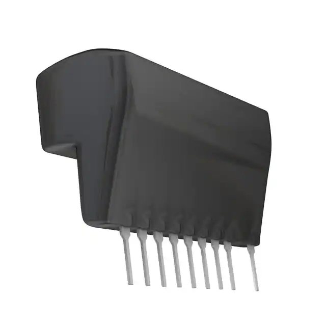

    Enclosed AC DC Converter 1 Output 5V 100mA 80 ~ 138 VAC Input
BP5034D5 数据手册
Data Sheet 100VAC Input/5VDC (100mA) Output Non-Isolated AC/DC Converter BP5034D5 Absolute Maximum Ratings Parameter Input voltage Output current ESD endurance Operating temperature range Storage temperature range Symbol Vi Io Vsurge Topr Tstg Limits 195 100 2 −20 to +80 −25 to +85 Unit V mApk kV °C °C 15.7MAX. Dimensions (Unit : mm) 28.2MAX. 10.0MAX. Mark Side 1 2 3 4 5 67 8 10 0.25± 0.05 0 . 5 ±0 . 1 3.25MAX P = 2 . 5 4 ±0 . 2 2.54�9=22.86 6.5MAX. 1 . 3 ±0 . 2 3.5MAX. Electrical Characteristics Symbol Parameter Input voltage range Vi Output voltage Vo Output current Io Line regulation Vr Load regulation Vl Output ripple voltage Vp Power conversion efficiency η Min. 113 4.7 0 − − − 48 Typ. 141 5.0 − 0.02 0.05 0.05 56 Max. 195 5.3 100 0.1 0.15 0.15 − Unit V V mA V V Vp-p % Conditions DC(80 to 138VAC) Vi=141V, Io=50mA Vi=141V ∗1 Vi=113 to 195V, Io=50mA Vi=141V, Io=0 to 50mA ∗2 Vi=141V, Io=50mA Vi=141V, Io=100mA ∗2 Derating Curve 120 Output Current Io(mA) 100 80 60 40 20 0 -30 -20 -10 0 10 20 30 40 50 60 70 80 90 Ambient Temperature Ta(°C) Operation Range Derating Curve ∗1 Maximum output current varies depending on ambient temperature ; please refer to derating curve. ∗2 Please refer to Load regulation, Conversion efficiency. Switching Frequency Switching Frequency fsw(kHz) 50 40 30 20 10 0 0 20 40 60 80 Output Current Io(mA) 100 Switching Frequency (Ta=25°C, Vi=141V) Application Circuit BP5034D5 Please note that pin No.10 side is input. Pin No. 1 2 3 4 5 6 7 8 9 10 Function Output terminal Vo(5V) N.C. N.C. N.C. COMMON COMMON N.C. N.C. Skipping pin Input terminal Vi(141VDC) 10 R1 D1 1SR35−400A 10Ω1/4W Input AC100V 50Hz/60Hz ZNR + 220V − C1 10µF/250V 87654321 FUSE 0.5A C2 0.1µF Output +5V Conversion Efficiency Conversion Efficiency (%) 60 50 40 30 20 10 0 0 20 40 60 80 Output Current Io(mA) 100 Conversion Efficiency (Ta=25°C, Vi=141V) 48% Min−Line + C3 − 100µF/50V Be sure to use fuse for safety. Please verify operation and characteristics in the customer's circuit before actual usage. Ensure that the load current does not exceed the maximum rating. External Component Specifications FUSE: Fuse C1: Input smoothing capacitor C2: Noise reduction capacitor C3: Output smoothing capacitor Use a quick-acting fuse of 0.5A Capacitance : 3.3 to 22µF Rated voltage : 250V or higher Capacitance : 0.1 to 0.22µF Rated voltage : 250V or higher Use a film or ceramic capacitor. Evaluate under actual operating conditions. Capacitance : 100 to 470µF Rated voltage : 25V or higher, low impedance Impedance is 0.39Ω max at high frequencies Ripple current is 0.1Arms or above. Capacitor impedance affects the output ripple voltage. In the absolute maximum ratings, the reverse surge voltage should be 400V or higher, the average rectifying current should be 0.5A or higher, and the forward surge current should be 20A or higher. 10 to 22Ω, 1/4W The ideal value should be determined through actual testing. A varistor must be used to protect against lightning surges and static electricity. Load Regulation 5.3 Output Voltage Vo(V) 5.2 5.1 5.0 4.9 4.8 4.7 0 20 40 60 80 Output Current Io(mA) 100 Load Regulation (Ta=25°C, Vi=141V) Surface Temperature Increase Temperature Rising ∆T(°C) 25 20 15 10 5 0 0 20 40 60 80 100 Output Current Io(mA) 120 Surface Temperature Increase (Ta=25°C, Vi=141V) D1: Rectifier diode R1: Noise reduction resistor ZNR: Varistor www.rohm.com ©2010 ROHM Co., Ltd. All rights reserved. 4±1.0 1/1 2010.01 - Rev.A Notice Notes No copying or reproduction of this document, in part or in whole, is permitted without the consent of ROHM Co.,Ltd. The content specified herein is subject to change for improvement without notice. The content specified herein is for the purpose of introducing ROHM's products (hereinafter "Products"). If you wish to use any such Product, please be sure to refer to the specifications, which can be obtained from ROHM upon request. Examples of application circuits, circuit constants and any other information contained herein illustrate the standard usage and operations of the Products. The peripheral conditions must be taken into account when designing circuits for mass production. Great care was taken in ensuring the accuracy of the information specified in this document. However, should you incur any damage arising from any inaccuracy or misprint of such information, ROHM shall bear no responsibility for such damage. The technical information specified herein is intended only to show the typical functions of and examples of application circuits for the Products. ROHM does not grant you, explicitly or implicitly, any license to use or exercise intellectual property or other rights held by ROHM and other parties. ROHM shall bear no responsibility whatsoever for any dispute arising from the use of such technical information. The Products specified in this document are intended to be used with general-use electronic equipment or devices (such as audio visual equipment, office-automation equipment, communication devices, electronic appliances and amusement devices). The Products specified in this document are not designed to be radiation tolerant. While ROHM always makes efforts to enhance the quality and reliability of its Products, a Product may fail or malfunction for a variety of reasons. Please be sure to implement in your equipment using the Products safety measures to guard against the possibility of physical injury, fire or any other damage caused in the event of the failure of any Product, such as derating, redundancy, fire control and fail-safe designs. ROHM shall bear no responsibility whatsoever for your use of any Product outside of the prescribed scope or not in accordance with the instruction manual. The Products are not designed or manufactured to be used with any equipment, device or system which requires an extremely high level of reliability the failure or malfunction of which may result in a direct threat to human life or create a risk of human injury (such as a medical instrument, transportation equipment, aerospace machinery, nuclear-reactor controller, fuelcontroller or other safety device). ROHM shall bear no responsibility in any way for use of any of the Products for the above special purposes. If a Product is intended to be used for any such special purpose, please contact a ROHM sales representative before purchasing. If you intend to export or ship overseas any Product or technology specified herein that may be controlled under the Foreign Exchange and the Foreign Trade Law, you will be required to obtain a license or permit under the Law. Thank you for your accessing to ROHM product informations. More detail product informations and catalogs are available, please contact us. ROHM Customer Support System http://www.rohm.com/contact/ www.rohm.com © 2010 ROHM Co., Ltd. All rights reserved. R1010A
