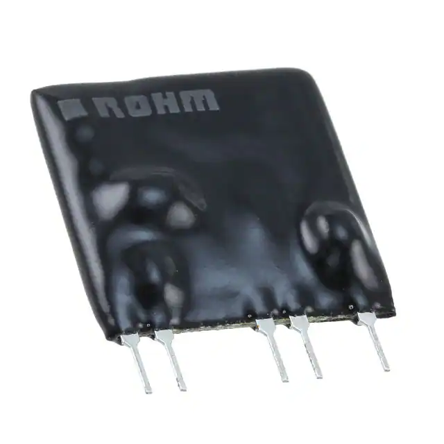

    IC AC/DC CONVERTER ISO 5SIP
BP5716 数据手册
AC100V input, 12V/1000mA output AC/DC converter BP5716 Absolute Maximum Ratings Parameter 8-pin input voltage 6-pin input voltage 8-pin input current 6-pin input current Maximum Power Withstanding voltage Operating temperature range Storage temperature range Dimensions (Unit : mm) Limits 500 25 500 10 13 2.5 105 Unit V mA mA W kV °C °C °C 1s (primary-secondary) Ambient temperature + The module self-heating Tcmax 25.5MAX. Symbol VD VDD ID IDD Po Vi Topr Tstg Conditions 24.0Max. MARKING SIDE 10.1Max. V MARKING SIDE 4.0±1.0 5.55MAX. 2.54x7=17.78TYP. 4.55MAX. Allowable maximum surface temperature Tcmax −25 to +80 −40 to +105 Electrical Characteristics Symbol Parameter 8-pin input voltage Operating power voltage Parameter Output voltage Output current Line regulation Load regulation Output ripple voltage Power conversion efficiency VD VDD ∗1 Symbol Vo Io Vr VI Vp η (Unless otherwise noted, Vi=141V, Ta=25°C) Derating Curve Derating Curve 12 Output Power (W) Min. − 8.8 Min. 11.4 0 − − − 75 Typ. Max. Unit − V 350 V 20 12 Conditions Io=1000mA DC, Io=1000mA Operation Range 6 ∗2 Switching Frequency fsw (kHz) Typ. Max. Unit Conditions V 12.0 12.6 − 1000 mA Refer to derating curve 10 200 mV Vi=113V to 170VDC, Io=1000mA 58 200 mV Io=50mA to 1000mA 300 500 mVpp − % 84 0 -30 -20 -10 0 10 20 30 40 50 60 70 80 90 Ambient Temperature Ta (°C) Switching Frequency 100 80 60 40 20 0 0 200 400 600 800 Output Current Io (mA) 1000 Switching Frequency (Vi=141V) ∗1 Operating start voltage is15.5V to 17.5V. ∗2 Pulse noise not included. Application circuit AC100V ZNR Vi(+) R5 R1 + T1 C2 3 9 D1 + Vo:12V/850mA C1 Pin No. Name 1 Vo D7 D2 1 C7 + C4 F1 D3 C3 4 5 C5 6 7 D5 + Vo:18V/100mA C6 2 GND This is the GND terminal for the secondary side 12V output. This is the primary side input minus terminal. Conversion Efficiency η (%) 10 Function This is the secondary side 12V output voltage control terminal. Insert the output smoothing capacitor 1000µF between GND. Conversion Efficiency 100 90 80 70 60 50 40 30 20 10 0 0 Conversion Efficiency (Vi=141V) GND1 GND2 5 Vin(-) Vi(-) 6 Be sure to use fuse for safety. 8 2 1 6 VDD This is the internal circuit power supply terminal. This is the built-in FET of drain terminal. The primary coil minus side of the external transformer, and the snubber circuit for noise reduction are connected to this. 5 BP5716 8 VD 200 400 600 800 Output Current Io (mA) 1000 For actual usage, Please kindly evaluate and confirm our part mounted in your product, Especially, Please make sure to confirm whether the load current exceed Max. rated current by using the current probe. External components setting C1: Capacitor for output voltage smoothing C2: For noise terminal voltage reduction C3: Capacitor for output voltage smoothing C4: Capacitor for input voltage smoothing C5: For noise terminal voltage reduction C6: Capacitor for output voltage smoothing C7: Noise terminal voltage countermeasure capacitor D1: Rectifier diode D2: Rectifier diode D3: Rectifier diode D5: Rectifier diode D7: Diode bridge R1: Resistor R5: Noise terminal voltage countermeasure resistor T1: Switching transformer F1: Fuse ZNR: Varistor 1000µF / 35V Low impedance for power supply 2200pF / 400V or higher 10µF / 50V Low impedance for power supply 33µF / 250V Please set it, if necessary 100µF / 35V Low impedance for power supply Please set it, if necessary Limiting element voltage 250V or higher 0.1 to 0.22µF 60V / 6A 1kV / 1A 80V / 0.1A 100V or higher / 1A 800V / 1A 100kΩ ± 5% 3W Limiting element voltage 300V or higher Please set it, if necessary 1W or higher 10 to 22Ω Be sure to use this for safety Must be use. It protects this part from lightning surge and static electricity. Load Regulation 14.0 Output Voltage Vo (V) Load Regulation (Vi=141V) 12.0 10.0 8.0 6.0 4.0 2.0 0.0 Maximum Io=1000mA 0 200 400 600 800 1000 1200 1400 1600 Output Current Io (mA) Surface Temperature Rising Temperature Rising ∆T (°C) 40 30 20 10 0 Surface Temperature Rising (Ta=25°C, Vi=141V) 0 200 400 600 800 Output Current Io (mA) 1000 www.rohm.com c ○ 2009 ROHM Co., Ltd. All rights reserved. 1/2 2009.04 - Rev.B BP5716 Precautions on use of products When the capacity of the output smoothing electrolytic capacitor C1 is made large, output may not rise. 1000µF to 2200µF is recommended. Set the rise time within 10ms. Set the Vod electrolytic capacitor C3 to 10µF. Be sure to use the VG terminal voltage within the operating voltage range. Set the external starting resistor (R1+R3) to 720KΩ. When reducing the resistance value, start-up may fail. Take note of the loss of the resistor when it is reduced. This product has built-in over current (reset type) protection function to prevent destruction at abrupt error. These protection functions are effective for prevention against destruction owing to abrupt accident, therefore, avoid using them for continuous protection circuit operating, or at transition Data Sheet www.rohm.com c ○ 2009 ROHM Co., Ltd. All rights reserved. 2/2 2009.04 - Rev.B Notice Notes No copying or reproduction of this document, in part or in whole, is permitted without the consent of ROHM Co.,Ltd. The content specified herein is subject to change for improvement without notice. The content specified herein is for the purpose of introducing ROHM's products (hereinafter "Products"). If you wish to use any such Product, please be sure to refer to the specifications, which can be obtained from ROHM upon request. Examples of application circuits, circuit constants and any other information contained herein illustrate the standard usage and operations of the Products. The peripheral conditions must be taken into account when designing circuits for mass production. Great care was taken in ensuring the accuracy of the information specified in this document. However, should you incur any damage arising from any inaccuracy or misprint of such information, ROHM shall bear no responsibility for such damage. The technical information specified herein is intended only to show the typical functions of and examples of application circuits for the Products. ROHM does not grant you, explicitly or implicitly, any license to use or exercise intellectual property or other rights held by ROHM and other parties. ROHM shall bear no responsibility whatsoever for any dispute arising from the use of such technical information. The Products specified in this document are intended to be used with general-use electronic equipment or devices (such as audio visual equipment, office-automation equipment, communication devices, electronic appliances and amusement devices). The Products specified in this document are not designed to be radiation tolerant. While ROHM always makes efforts to enhance the quality and reliability of its Products, a Product may fail or malfunction for a variety of reasons. Please be sure to implement in your equipment using the Products safety measures to guard against the possibility of physical injury, fire or any other damage caused in the event of the failure of any Product, such as derating, redundancy, fire control and fail-safe designs. ROHM shall bear no responsibility whatsoever for your use of any Product outside of the prescribed scope or not in accordance with the instruction manual. The Products are not designed or manufactured to be used with any equipment, device or system which requires an extremely high level of reliability the failure or malfunction of which may result in a direct threat to human life or create a risk of human injury (such as a medical instrument, transportation equipment, aerospace machinery, nuclear-reactor controller, fuel-controller or other safety device). ROHM shall bear no responsibility in any way for use of any of the Products for the above special purposes. If a Product is intended to be used for any such special purpose, please contact a ROHM sales representative before purchasing. If you intend to export or ship overseas any Product or technology specified herein that may be controlled under the Foreign Exchange and the Foreign Trade Law, you will be required to obtain a license or permit under the Law. Thank you for your accessing to ROHM product informations. More detail product informations and catalogs are available, please contact us. ROHM Customer Support System http://www.rohm.com/contact/ www.rohm.com © 2009 ROHM Co., Ltd. All rights reserved. R0039A
