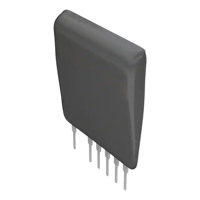

    AC/DC CONVERTER 15V 800MA 12W
BP5726-15 数据手册
Data Sheet 220VAC Input/15VDC (800mA) Output Non-Isolated AC/DC Converter BP5726-15 Absolute Maximum Ratings Parameter 7-pin input voltage 4-pin input voltage 7-pin input Current Maximum power Allowable maximum surface temperature Operating temperature range Storage temperature range Symbol VD VFB ID Po Tcmax Topr Tstg Limits 800 24 400 12 105 −25 to +80 −40 to +105 Unit V V mA W °C °C °C Conditions 27.1 MAX. Dimensions (Unit : mm) 22.5 MAX. 7.8 MAX. Mark side Ambient temperature + module self-heating Tcmax 4.0±1.0 3.25 MAX. 1 23 45 7 0.5±0.1 1.3±0.2 P=2.54±0.2 2.54x6=15.24(TYP.) 0.25±0.05 5.55 MAX. Electrical Characteristics (Unless otherwise noted, Vi=311V, rated load Ta=25°C) Derating Curve Min. 14.0 0 − − − 75 35 Typ. 15.0 − 30 80 150 85 49 Max. 16.0 800 150 500 500 − − Unit V mA mV mV mVpp % % Io=20mA Conditions Io=800mA Refer to derating curve ∗1 Vi=240V to 390VDC Io=800mA Io=50mA to 800mA ∗2 Output Power (W) 12 Parameter Output voltage Output current Line regulation Load regulation Output ripple voltage Power conversion efficiency1 Power conversion efficiency2 Symbol Vo Io Vr VI Vp η1 η2 6 Operation Range -30-20-10 0 10 20 30 40 50 60 70 80 90 Ambient Temperature Ta(°C) Conversion Efficiency Conversion Efficiency η (%) 100 90 80 70 60 50 40 30 20 10 0 0 100 200 300 400 500 600 700 800 900 1000 ∗1 Pulse noise is not included. ∗2 The output ripple voltage may vary depending on the capacitance, environment, and location of peripheral components. Especially right attention has to be paid to aluminum electrolytic capacitor, because ESR changes greatly at the time of the low temperature and output ripple voltages increase. Application Circuit Vi+ FUSE Be sure to use fuse for safety. R2 + Pin No. T1 Name Vo Vo Vi (-) VFB Vs Function This is the output detection terminal. This is the output detection terminal. This is the primary side input minus terminal. Feedback terminal This is the start terminal. Connect this via the external resistor (750kΩ) to Vi (+). This is the built-in FET of drain terminal. The primary coil minus side of the external transformer, and the snubber circuit for noise reduction are connected to this. 1 D1 C1 GND Vo:12V/500mA C4 + + Output Current of Vo12(mA) R1 D2 Vo:15V/400mA C2 2 3 4 5 C3 Load Regulation Output Voltage Vo(V) 18.0 16.0 14.0 12.0 10.0 8.0 6.0 4.0 2.0 0.0 Vi- D3 GND 7 5 43 21 7 VD 0 200 400 600 800 1000 1200 Output Current(mA) External Component Settings FUSE: FUSE C1, C4: Output smoothing capacitors Use a fuse of 1A. 470µF/35V low impedance for power supply Rated ripple current 1.4Arms or higher, ESR 35mΩ or below 2200pF/1kV 33µF/450V General purpose type 90V/6A 1kV/1A 100kΩ ±5% 3W Limiting element voltage 300V or higher 750kΩ ±5% 0.25W Limiting element voltage 600V or higher Custom type C2: Noise reduction capacitor Input voltage smoothing capacitor C3: D1, D3: Rectifier diode D2: Rectifier diode R1: Resistor R2: T1: Resistor Switching transformer www.rohm.com ©2010 ROHM Co., Ltd. All rights reserved. 1/1 2010.01 - Rev.A Notice Notes No copying or reproduction of this document, in part or in whole, is permitted without the consent of ROHM Co.,Ltd. The content specified herein is subject to change for improvement without notice. The content specified herein is for the purpose of introducing ROHM's products (hereinafter "Products"). If you wish to use any such Product, please be sure to refer to the specifications, which can be obtained from ROHM upon request. Examples of application circuits, circuit constants and any other information contained herein illustrate the standard usage and operations of the Products. The peripheral conditions must be taken into account when designing circuits for mass production. Great care was taken in ensuring the accuracy of the information specified in this document. However, should you incur any damage arising from any inaccuracy or misprint of such information, ROHM shall bear no responsibility for such damage. The technical information specified herein is intended only to show the typical functions of and examples of application circuits for the Products. ROHM does not grant you, explicitly or implicitly, any license to use or exercise intellectual property or other rights held by ROHM and other parties. ROHM shall bear no responsibility whatsoever for any dispute arising from the use of such technical information. The Products specified in this document are intended to be used with general-use electronic equipment or devices (such as audio visual equipment, office-automation equipment, communication devices, electronic appliances and amusement devices). The Products specified in this document are not designed to be radiation tolerant. While ROHM always makes efforts to enhance the quality and reliability of its Products, a Product may fail or malfunction for a variety of reasons. Please be sure to implement in your equipment using the Products safety measures to guard against the possibility of physical injury, fire or any other damage caused in the event of the failure of any Product, such as derating, redundancy, fire control and fail-safe designs. ROHM shall bear no responsibility whatsoever for your use of any Product outside of the prescribed scope or not in accordance with the instruction manual. The Products are not designed or manufactured to be used with any equipment, device or system which requires an extremely high level of reliability the failure or malfunction of which may result in a direct threat to human life or create a risk of human injury (such as a medical instrument, transportation equipment, aerospace machinery, nuclear-reactor controller, fuelcontroller or other safety device). ROHM shall bear no responsibility in any way for use of any of the Products for the above special purposes. If a Product is intended to be used for any such special purpose, please contact a ROHM sales representative before purchasing. If you intend to export or ship overseas any Product or technology specified herein that may be controlled under the Foreign Exchange and the Foreign Trade Law, you will be required to obtain a license or permit under the Law. Thank you for your accessing to ROHM product informations. More detail product informations and catalogs are available, please contact us. ROHM Customer Support System http://www.rohm.com/contact/ www.rohm.com © 2010 ROHM Co., Ltd. All rights reserved. R1010A
