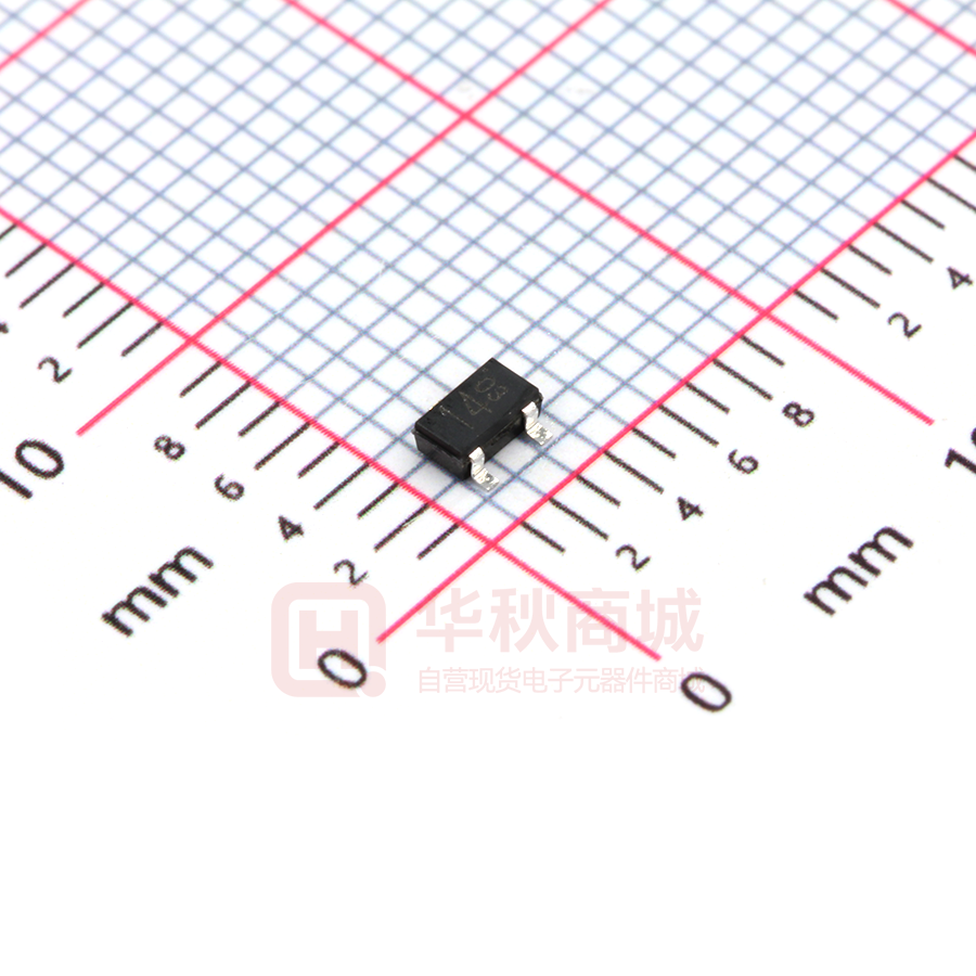

    ROHM(罗姆)
    SOT-23
    PNP -100mA -50V数字晶体管(偏置电阻内置晶体管)
DTA114EKAT146 数据手册
DTA114E series Datasheet PNP -100mA -50V Digital Transistors (Bias Resistor Built-in Transistors) l Outline Parameter VCC Value -50V IC(MAX.) -100mA R1 R2 10kΩ 10kΩ VMT3 EMT3F     DTA114EM (SC-105AA) l Features 1) Built-In Biasing Resistors, R1 = R2 = 10kΩ 2) Built-in bias resistors enable the configuration of  an inverter circuit without connecting external  input resistors (see inner circuit) . 3) Only the on/off conditions need to be set  for operation, making the circuit design easy. 4) Complementary NPN Types: DTC114E series DTA114EEB (SC-89) EMT3 UMT3F     DTA114EE SOT-416(SC-75A) UMT3 DTA114EUB (SC-85) SMT3     DTA114EUA DTA114EKA SOT-323(SC-70) SOT-346(SC-59) l Application INVERTER, INTERFACE, DRIVER l Inner circuit DTA114EM/ DTA114EEB/ DTA114EUB DTA114EE/ DTA114EUA/ DTA114EKA l Packaging specifications                                             Part No. Package Package size Taping code DTA114EM DTA114EEB DTA114EE DTA114EUB DTA114EUA DTA114EKA VMT3 EMT3F EMT3 UMT3F UMT3 SMT3 1212 1616 1616 2021 2021 2928 T2L TL TL TL T106 T146 Reel size Tape width (mm) (mm) 180 180 180 180 180 180 8 8 8 8 8 8 Basic ordering unit.(pcs) 8000 3000 3000 3000 3000 3000 Marking 14 14 14 14 14 14                                                                                           www.rohm.com © 2015 ROHM Co., Ltd. All rights reserved. 1/10 20150527 - Rev.004   DTA114E series          Datasheet l Absolute maximum ratings (Ta = 25°C) Parameter Symbol Values Unit Supply voltage VCC -50 V Input voltage VIN -40 to 10 V Output current IO -50 mA IC(MAX)*1 -100 mA Collector current DTA114EM 150 DTA114EEB 150 DTA114EE 150 PD*2 Power dissipation DTA114EUB mW 200 DTA114EUA 200 DTA114EKA 200 Junction temperature Range of storage temperature Tj 150 ℃ Tstg -55 to +150 ℃ l Electrical characteristics (Ta = 25°C) Values Parameter Input voltage Output voltage Input current Symbol Conditions Unit Min. Typ. Max. VI(off) VCC = -5V, IO = -100μA - - -0.5 VI(on) VO = -0.3V, IO = -10mA -3.0 - - VO(on) IO / I I = -10mA / -0.5mA - -100 -300 mV VI = -5V - - -880 μA II V Output current IO(off) VCC = -50V, VI = 0V - - -500 nA DC current gain GI VO = -5V, IO = -5mA 30 - - - Input resistance R1 - 7 10 13 kΩ Resistance ratio R2/R1 - 0.8 1.0 1.2 - - 250 - MHz Transition frequency f T*1 VCE = -10V, IE = 5mA, f = 100MHz *1 Characteristics of built-in transistor *2 Each terminal mounted on a reference land                                              www.rohm.com © 2015 ROHM Co., Ltd. All rights reserved.   2/10                                          20150527 - Rev.004 DTA114E series              Datasheet l Electrical characteristic curves (Ta =25°C) Fig.1 Input voltage vs. output current (ON characteristics) Fig.2 Output current vs. input voltage (OFF characteristics) Fig.3 Output current vs. output voltage Fig.4 DC current gain vs. output current                                                                                             www.rohm.com © 2015 ROHM Co., Ltd. All rights reserved. 3/10 20150527 - Rev.004 DTA114E series              Datasheet l Electrical characteristic curves (Ta =25°C) Fig.5 Output voltage vs. output current                                                                                             www.rohm.com © 2015 ROHM Co., Ltd. All rights reserved. 4/10 20150527 - Rev.004 DTA114E series                 Datasheet l Dimensions                                                                                             www.rohm.com © 2015 ROHM Co., Ltd. All rights reserved. 5/10 20150527 - Rev.004 DTA114E series            Datasheet l Dimensions                                                                                             www.rohm.com © 2015 ROHM Co., Ltd. All rights reserved. 6/10 20150527 - Rev.004 DTA114E series            Datasheet l Dimensions                                                                                             www.rohm.com © 2015 ROHM Co., Ltd. All rights reserved. 7/10 20150527 - Rev.004 DTA114E series            Datasheet l Dimensions                                                                                             www.rohm.com © 2015 ROHM Co., Ltd. All rights reserved. 8/10 20150527 - Rev.004 DTA114E series            Datasheet l Dimensions                                                                                             www.rohm.com © 2015 ROHM Co., Ltd. All rights reserved. 9/10 20150527 - Rev.004 DTA114E series            Datasheet l Dimensions                                                                                             www.rohm.com © 2015 ROHM Co., Ltd. All rights reserved. 10/10 20150527 - Rev.004 Datasheet DTA114EKA - Web Page Buy Distribution Inventory Part Number Package Unit Quantity Minimum Package Quantity Packing Type Constitution Materials List RoHS DTA114EKA SMT3 3000 3000 Taping inquiry Yes
