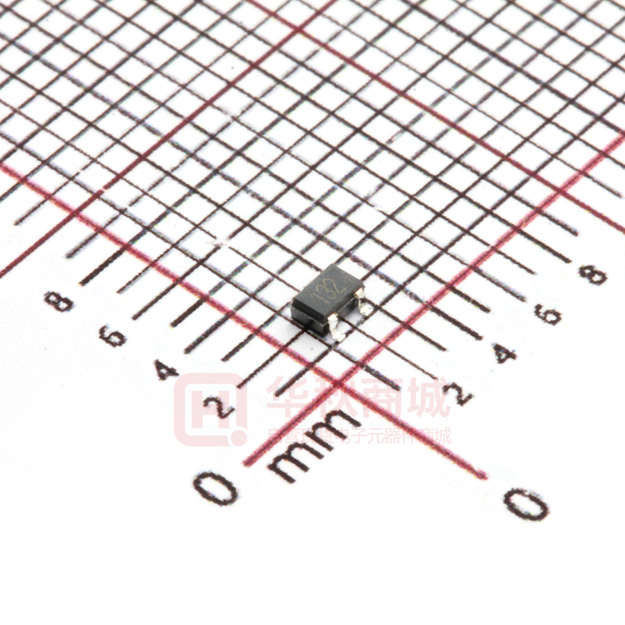

DTA123JUAT106
DTA123JUAT106
    ROHM(罗姆)
    SOT-323
    PNP -100mA -50V数字晶体管(偏置电阻内置晶体管)
DTA123JUAT106 数据手册
DTA123J series Datasheet PNP -100mA -50V Digital Transistors (Bias Resistor Built-in Transistors) l Outline Parameter VCC Value -50V IC(MAX.) -100mA R1 R2 2.2kΩ 47kΩ VMT3 EMT3F     DTA123JM (SC-105AA) l Features 1) Built-In Biasing Resistors 2) Built-in bias resistors enable the configuration of  an inverter circuit without connecting external  input resistors (see inner circuit) . 3) Only the on/off conditions need to be set  for operation, making the circuit design easy. 4) Complementary NPN Types: DTC123J series DTA123JEB (SC-89) EMT3 UMT3F     DTA123JE SOT-416(SC-75A) UMT3 DTA123JUB (SC-85) SMT3     DTA123JUA DTA123JKA SOT-323(SC-70) SOT-346(SC-59) l Application INVERTER, INTERFACE, DRIVER l Inner circuit DTA123JM/ DTA123JEB/ DTA123JUB DTA123JE/ DTA123JUA/ DTA123JKA l Packaging specifications                                             Part No. Package Package size Taping code DTA123JM DTA123JEB DTA123JE DTA123JUB DTA123JUA DTA123JKA VMT3 EMT3F EMT3 UMT3F UMT3 SMT3 1212 1616 1616 2021 2021 2928 T2L TL TL TL T106 T146 Reel size Tape width (mm) (mm) 180 180 180 180 180 180 8 8 8 8 8 8 Basic ordering unit.(pcs) Marking 8000 3000 3000 3000 3000 3000 E32 E32 E32 132 132 E32                                                                                           www.rohm.com © 2015 ROHM Co., Ltd. All rights reserved. 1/10 20150311 - Rev.002   DTA123J series          Datasheet l Absolute maximum ratings (Ta = 25°C) Parameter Symbol Values Unit Supply voltage VCC -50 V Input voltage VIN -12 to 5 V Output current IO -100 mA IC(MAX)*1 -100 mA Collector current DTA123JM 150 DTA123JEB 150 DTA123JE 150 PD*2 Power dissipation DTA123JUB mW 200 DTA123JUA 200 DTA123JKA 200 Junction temperature Range of storage temperature Tj 150 ℃ Tstg -55 to +150 ℃ l Electrical characteristics (Ta = 25°C) Values Parameter Input voltage Output voltage Input current Symbol Conditions Unit Min. Typ. Max. VI(off) VCC = -5V, IO = -100μA - - -0.5 VI(on) VO = -0.3V, IO = -5mA -1.1 - - VO(on) IO / I I = -5mA / -0.25mA - -100 -300 mV VI = -5V - - -3.6 mA II V Output current IO(off) VCC = -50V, VI = 0V - - -500 nA DC current gain GI VO = -5V, IO = -10mA 80 - - - Input resistance R1 - 1.54 2.2 2.86 kΩ Resistance ratio R2/R1 - 17 21 26 - - 250 - MHz Transition frequency f T*1 VCE = -10V, IE = 5mA, f = 100MHz *1 Characteristics of built-in transistor. *2 Each terminal mounted on a reference land.                                              www.rohm.com © 2015 ROHM Co., Ltd. All rights reserved.   2/10                                          20150311 - Rev.002 DTA123J series              Datasheet l Electrical characteristic curves (Ta =25°C) Fig.1 Input voltage vs. output current (ON characteristics) Fig.2 Output current vs. input voltage (OFF characteristics) Fig.3 Output current vs. output voltage Fig.4 DC current gain vs. output current                                                                                             www.rohm.com © 2015 ROHM Co., Ltd. All rights reserved. 3/10 20150311 - Rev.002 DTA123J series              Datasheet l Electrical characteristic curves (Ta =25°C) Fig.5 Output voltage vs. output current                                                                                             www.rohm.com © 2015 ROHM Co., Ltd. All rights reserved. 4/10 20150311 - Rev.002 DTA123J series                 Datasheet l Dimensions                                                                                             www.rohm.com © 2015 ROHM Co., Ltd. All rights reserved. 5/10 20150311 - Rev.002 DTA123J series            Datasheet l Dimensions                                                                                             www.rohm.com © 2015 ROHM Co., Ltd. All rights reserved. 6/10 20150311 - Rev.002 DTA123J series            Datasheet l Dimensions                                                                                             www.rohm.com © 2015 ROHM Co., Ltd. All rights reserved. 7/10 20150311 - Rev.002 DTA123J series            Datasheet l Dimensions                                                                                             www.rohm.com © 2015 ROHM Co., Ltd. All rights reserved. 8/10 20150311 - Rev.002 DTA123J series            Datasheet l Dimensions                                                                                             www.rohm.com © 2015 ROHM Co., Ltd. All rights reserved. 9/10 20150311 - Rev.002 DTA123J series            Datasheet l Dimensions                                                                                             www.rohm.com © 2015 ROHM Co., Ltd. All rights reserved. 10/10 20150311 - Rev.002
