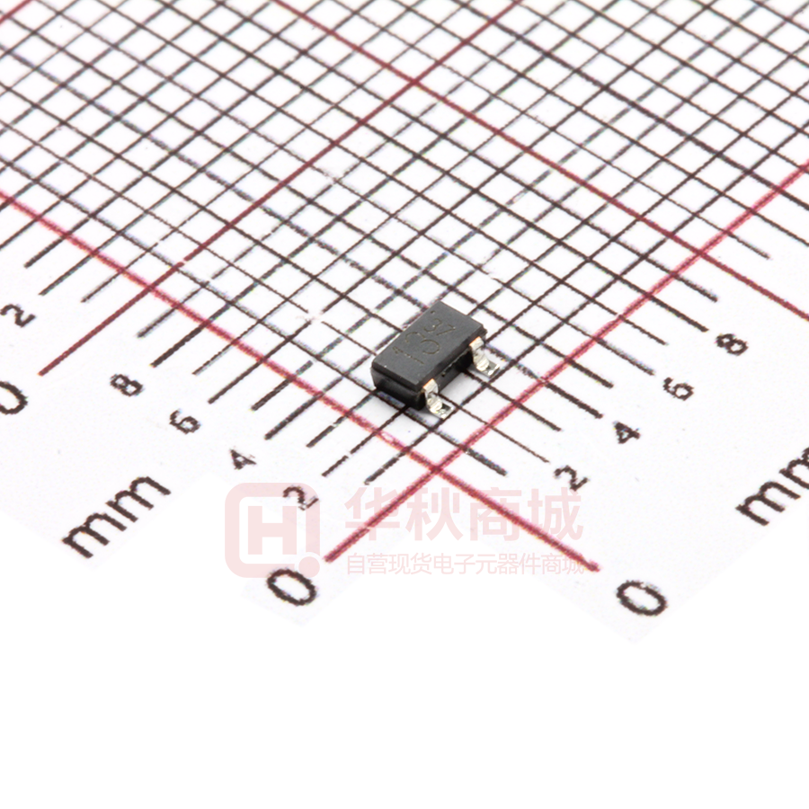

    带预偏置三极管 PNP Ic=100mA Vceo=50V hfe=30 P=200mW SOT346
DTA143EKAT146 数据手册
DTA143E series Datasheet PNP -100mA -50V Digital Transistors (Bias Resistor Built-in Transistors) l Outline Parameter VCC Value -50V IC(MAX.) -100mA R1 R2 4.7kΩ 4.7kΩ VMT3 EMT3F     DTA143EM (SC-105AA) l Features 1) Built-In Biasing Resistors, R1 = R2 = 4.7kΩ 2) Built-in bias resistors enable the configuration of  an inverter circuit without connecting external  input resistors (see inner circuit) . 3) Only the on/off conditions need to be set  for operation, making the circuit design easy. 4) Complementary NPN Types: DTC143E series DTA143EEB (SC-89) EMT3 UMT3F     DTA143EE SOT-416(SC-75A) UMT3 DTA143EUB (SC-85) SMT3     DTA143EUA DTA143EKA SOT-323(SC-70) SOT-346(SC-59) l Application INVERTER,INTERFACE,DRIVER l Inner circuit DTA143EM/ DTA143EEB/ DTA143EUB DTA143EE/ DTA143EUA/ DTA143EKA l Packaging specifications                                             Part No. Package Package size Taping code DTA143EM DTA143EEB DTA143EE DTA143EUB DTA143EUA DTA143EKA VMT3 EMT3F EMT3 UMT3F UMT3 SMT3 1212 1616 1616 2021 2021 2928 T2L TL TL TL T106 T146 Reel size Tape width (mm) (mm) 180 180 180 180 180 180 8 8 8 8 8 8 Basic ordering unit.(pcs) 8000 3000 3000 3000 3000 3000 Marking 13 13 13 13 13 13                                                                                           www.rohm.com © 2015 ROHM Co., Ltd. All rights reserved. 1/10 20150311 - Rev.004   DTA143E series          Datasheet l Absolute maximum ratings (Ta = 25°C) Parameter Symbol Values Unit Supply voltage VCC -50 V Input voltage VIN -30 to 10 V Output current IO -100 mA IC(MAX)*1 -100 mA Collector current DTA143EM 150 DTA143EEB 150 DTA143EE 150 PD*2 Power dissipation DTA143EUB mW 200 DTA143EUA 200 DTA143EKA 200 Junction temperature Range of storage temperature Tj 150 ℃ Tstg -55 to +150 ℃ l Electrical characteristics (Ta = 25°C) Values Parameter Input voltage Output voltage Input current Symbol Conditions Unit Min. Typ. Max. VI(off) VCC = -5V, IO = -100μA - - -0.5 VI(on) VO = -0.3V, IO = -20mA -3.0 - - VO(on) IO / I I = -10mA / -0.5mA - -100 -300 mV VI = -5V - - -1.8 mA II V Output current IO(off) VCC = -50V, VI = 0V - - -500 nA DC current gain GI VO = -5V, IO = -10mA 30 - - - Input resistance R1 - 3.29 4.7 6.11 kΩ Resistance ratio R2/R1 - 0.8 1.0 1.2 - - 250 - MHz Transition frequency f T*1 VCE = -10V, IE = 5mA, f = 100MHz *1 Characteristics of built-in transistor. *2 Each terminal mounted on a reference land.                                              www.rohm.com © 2015 ROHM Co., Ltd. All rights reserved.   2/10                                          20150311 - Rev.004 DTA143E series              Datasheet l Electrical characteristic curves (Ta =25°C) Fig.1 Input voltage vs. output current (ON characteristics) Fig.2 Output current vs. input voltage (OFF characteristics) Fig.3 Output current vs. output voltage Fig.4 DC current gain vs. output current                                                                                             www.rohm.com © 2015 ROHM Co., Ltd. All rights reserved. 3/10 20150311 - Rev.004 DTA143E series              Datasheet l Electrical characteristic curves (Ta =25°C) Fig.5 Output voltage vs. output current                                                                                             www.rohm.com © 2015 ROHM Co., Ltd. All rights reserved. 4/10 20150311 - Rev.004 DTA143E series                 Datasheet l Dimensions                                                                                             www.rohm.com © 2015 ROHM Co., Ltd. All rights reserved. 5/10 20150311 - Rev.004 DTA143E series            Datasheet l Dimensions                                                                                             www.rohm.com © 2015 ROHM Co., Ltd. All rights reserved. 6/10 20150311 - Rev.004 DTA143E series            Datasheet l Dimensions                                                                                             www.rohm.com © 2015 ROHM Co., Ltd. All rights reserved. 7/10 20150311 - Rev.004 DTA143E series            Datasheet l Dimensions                                                                                             www.rohm.com © 2015 ROHM Co., Ltd. All rights reserved. 8/10 20150311 - Rev.004 DTA143E series            Datasheet l Dimensions                                                                                             www.rohm.com © 2015 ROHM Co., Ltd. All rights reserved. 9/10 20150311 - Rev.004 DTA143E series            Datasheet l Dimensions                                                                                             www.rohm.com © 2015 ROHM Co., Ltd. All rights reserved. 10/10 20150311 - Rev.004 Datasheet DTA143EKA - Web Page Buy Distribution Inventory Part Number Package Unit Quantity Minimum Package Quantity Packing Type Constitution Materials List RoHS DTA143EKA SMT3 3000 3000 Taping inquiry Yes
