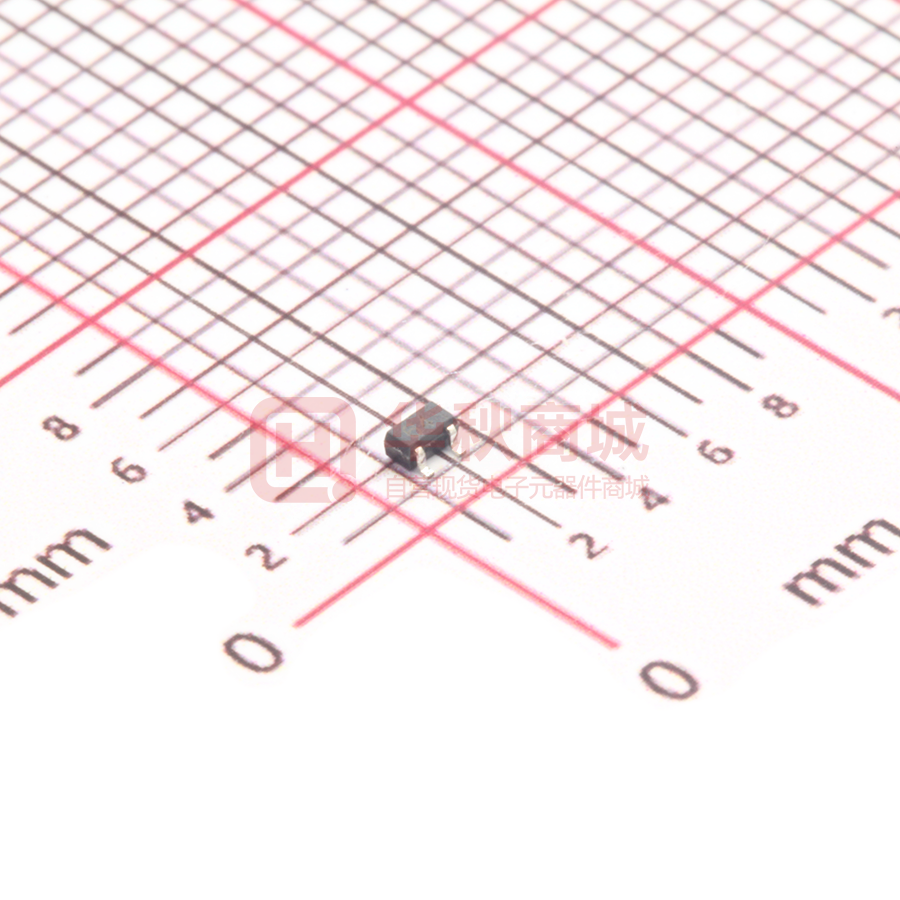

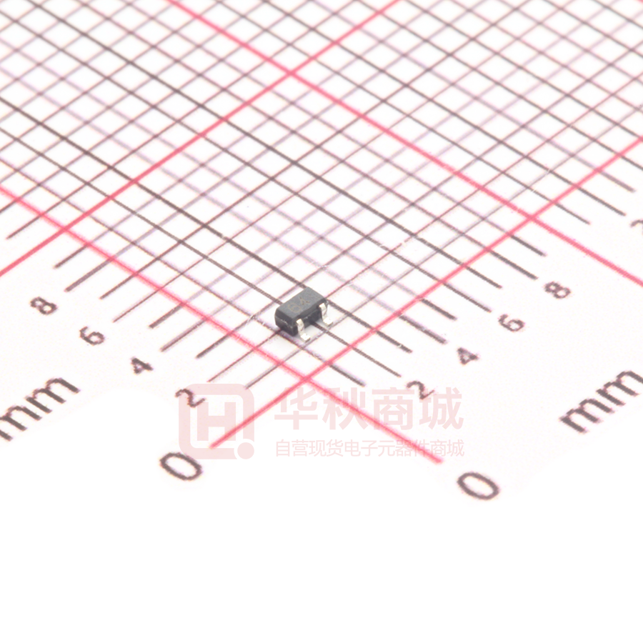

    带预偏置三极管 NPN Ic=100mA Vceo=50V hfe=68 P=150mW SOT416
DTC114YETL 数据手册
DTC114Y series Datasheet NPN 100mA 50V Digital Transistor (Bias Resistor Built-in Transistor) l Outline Parameter VCC Value 50V IC(MAX.) 100mA R1 R2 10kΩ 47kΩ SOT-723 SOT-416FL     DTC114YM DTC114YEB (VMT3) (EMT3F) SOT-416 l Features 1) Built-In Biasing Resistors, R1 = 10kΩ, R2 = 47kΩ. 2) Built-in bias resistors enable the configuration of  an inverter circuit without connecting external  input resistors (see inner circuit) . 3) Only the on/off conditions need to be set  for operation, making the circuit design easy. 4) Complementary PNP Types: DTA114Y series SOT-323FL     DTC114YE (EMT3) l Application INVERTER, INTERFACE, DRIVER DTC114YUB (UMT3F) SOT-323 SOT-346     DTC114YUA (UMT3) DTC114YKA (SMT3) l Inner circuit DTC114YM/ DTC114YEB/ DTC114YUB DTC114YE/ DTC114YUA/ DTC114YKA l Packaging specifications                                             Part No. Package Package size DTC114YM DTC114YEB DTC114YE DTC114YUB DTC114YUA DTC114YKA SOT-723 SOT-416FL SOT-416 SOT-323FL SOT-323 SOT-346 1212 1616 1616 2021 2021 2928 Taping code T2L TL TL TL T106 T146 Reel size Tape width (mm) (mm) 180 180 180 180 180 180 8 8 8 8 8 8 Basic ordering unit.(pcs) Marking 8000 3000 3000 3000 3000 3000 64 64 64 64 64 64                                                                                           www.rohm.com © 2015 ROHM Co., Ltd. All rights reserved. 1/10 20151008 - Rev.002   DTC114Y series          Datasheet l Absolute maximum ratings (Ta = 25°C) Parameter Symbol Values Unit Supply voltage VCC 50 V Input voltage VIN -6 to 40 V Output current IO 70 mA IC(MAX)*1 100 mA Collector current DTC114YM 150 DTC114YEB 150 DTC114YE 150 PD*2 Power dissipation DTC114YUB mW 200 DTC114YUA 200 DTC114YKA 200 Tj 150 ℃ Tstg -55 to +150 ℃ Junction temperature Range of storage temperature l Electrical characteristics (Ta = 25°C) Values Parameter Input voltage Output voltage Input current Symbol Conditions Unit Min. Typ. Max. VI(off) VCC = 5V, IO = 100μA - - 0.3 VI(on) VO = 0.3V, IO = 1mA 1.4 - - VO(on) IO = 5mA, II = 0.25mA - 100 300 mV VI = 5V - - 880 μA II V Output current IO(off) VCC = 50V, VI = 0V - - 500 nA DC current gain GI VO = 5V, IO = 5mA 68 - - - Input resistance R1 - 7 10 13 kΩ Resistance ratio R2/R1 - 3.7 4.7 5.7 - - 250 - MHz Transition frequency f T*1 VCE = 10V, IE = -5mA, f = 100MHz *1 Characteristics of built-in transistor *2 Each terminal mounted on a reference land.                                              www.rohm.com © 2015 ROHM Co., Ltd. All rights reserved.   2/10                                          20151008 - Rev.002 DTC114Y series              Datasheet l Electrical characteristic curves (Ta =25°C) Fig.1 Input voltage vs. output current (ON characteristics) Fig.2 Output current vs. input voltage (OFF characteristics) Fig.3 Output current vs. output voltage Fig.4 DC current gain vs. output current                                                                                             www.rohm.com © 2015 ROHM Co., Ltd. All rights reserved. 3/10 20151008 - Rev.002 DTC114Y series              Datasheet l Electrical characteristic curves (Ta =25°C) Fig.5 Output voltage vs. output current                                                                                             www.rohm.com © 2015 ROHM Co., Ltd. All rights reserved. 4/10 20151008 - Rev.002 DTC114Y series                 Datasheet l Dimensions                                                                                             www.rohm.com © 2015 ROHM Co., Ltd. All rights reserved. 5/10 20151008 - Rev.002 DTC114Y series            Datasheet l Dimensions                                                                                             www.rohm.com © 2015 ROHM Co., Ltd. All rights reserved. 6/10 20151008 - Rev.002 DTC114Y series            Datasheet l Dimensions                                                                                             www.rohm.com © 2015 ROHM Co., Ltd. All rights reserved. 7/10 20151008 - Rev.002 DTC114Y series            Datasheet l Dimensions                                                                                             www.rohm.com © 2015 ROHM Co., Ltd. All rights reserved. 8/10 20151008 - Rev.002 DTC114Y series            Datasheet l Dimensions                                                                                             www.rohm.com © 2015 ROHM Co., Ltd. All rights reserved. 9/10 20151008 - Rev.002 DTC114Y series            Datasheet l Dimensions                                                                                             www.rohm.com © 2015 ROHM Co., Ltd. All rights reserved. 10/10 20151008 - Rev.002 Datasheet DTC114YE - Web Page Buy Distribution Inventory Part Number Package Unit Quantity Minimum Package Quantity Packing Type Constitution Materials List RoHS DTC114YE EMT3 3000 3000 Taping inquiry Yes
