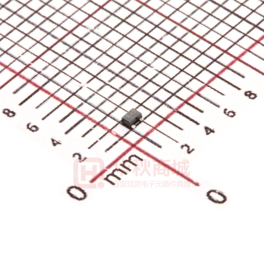

DTC123JMT2L
DTC123JMT2L
    ROHM(罗姆)
    SOT-723-3
    TRANS PREBIAS NPN 150MW VMT3
DTC123JMT2L 数据手册
DTC123J series Datasheet NPN 100mA 50V Digital Transistors (Bias Resistor Built-in Transistors) l Outline Parameter VCC Value 50V IC(MAX.) 100mA R1 R2 2.2kΩ 47kΩ VMT3 EMT3F     DTC123JM (SC-105AA) l Features 1) Built-In Biasing Resistors 2) Built-in bias resistors enable the configuration of  an inverter circuit without connecting external  input resistors (see inner circuit) . 3) Only the on/off conditions need to be set  for operation, making the circuit design easy. 4) Complementary PNP Types: DTA123J series DTC123JEB (SC-89) EMT3 UMT3F     DTC123JE SOT-416(SC-75A) UMT3 DTC123JUB (SC-85) SMT3     DTC123JUA DTC123JKA SOT-323(SC-70) SOT-346(SC-59) l Application INVERTER,INTERFACE,DRIVER l Inner circuit DTC123JM/ DTC123JEB/ DTC123JUB DTC123JE/ DTC123JUA/ DTC123JKA l Packaging specifications                                             Part No. Package Package size Taping code DTC123JM DTC123JEB DTC123JE DTC123JUB DTC123JUA DTC123JKA VMT3 EMT3F EMT3 UMT3F UMT3 SMT3 1212 1616 1616 2021 2021 2928 T2L TL TL TL T106 T146 Reel size Tape width (mm) (mm) 180 180 180 180 180 180 8 8 8 8 8 8 Basic ordering unit.(pcs) Marking 8000 3000 3000 3000 3000 3000 E42 E42 E42 142 142 E42                                                                                           www.rohm.com © 2015 ROHM Co., Ltd. All rights reserved. 1/10 20150311 - Rev.002   DTC123J series          Datasheet l Absolute maximum ratings (Ta = 25°C) Parameter Symbol Values Unit Supply voltage VCC 50 V Input voltage VIN -5 to 12 V Output current IO 100 mA IC(MAX)*1 100 mA Collector current DTC123JM 150 DTC123JEB 150 DTC123JE 150 PD*2 Power dissipation DTC123JUB mW 200 DTC123JUA 200 DTC123JKA 200 Tj 150 ℃ Tstg -55 to +150 ℃ Junction temperature Range of storage temperature l Electrical characteristics (Ta = 25°C) Values Parameter Input voltage Output voltage Input current Symbol Conditions Unit Min. Typ. Max. VI(off) VCC = 5V, IO = 100μA - - 0.5 VI(on) VO = 0.3V, IO = 5mA 1.1 - - VO(on) IO / I I = 5mA / 0.25mA - 100 300 mV VI = 5V - - 3.6 mA II V Output current IO(off) VCC = 50V, VI = 0V - - 500 nA DC current gain GI VO = 5V, IO = 10mA 80 - - - Input resistance R1 - 1.54 2.2 2.86 kΩ Resistance ratio R2/R1 - 17 21 26 - - 250 - MHz Transition frequency f T*1 VCE = 10V, IE = -5mA, f = 100MHz *1 Characteristics of built-in transistor. *2 Each terminal mounted on a reference land.                                              www.rohm.com © 2015 ROHM Co., Ltd. All rights reserved.   2/10                                          20150311 - Rev.002 DTC123J series              Datasheet l Electrical characteristic curves (Ta =25°C) Fig.1 Input voltage vs. output current (ON characteristics) Fig.2 Output current vs. input voltage (OFF characteristics) Fig.3 Output current vs. output voltage Fig.4 DC current gain vs. output current                                                                                             www.rohm.com © 2015 ROHM Co., Ltd. All rights reserved. 3/10 20150311 - Rev.002 DTC123J series              Datasheet l Electrical characteristic curves (Ta =25°C) Fig.5 Output voltage vs. output current                                                                                             www.rohm.com © 2015 ROHM Co., Ltd. All rights reserved. 4/10 20150311 - Rev.002 DTC123J series                 Datasheet l Dimensions                                                                                             www.rohm.com © 2015 ROHM Co., Ltd. All rights reserved. 5/10 20150311 - Rev.002 DTC123J series            Datasheet l Dimensions                                                                                             www.rohm.com © 2015 ROHM Co., Ltd. All rights reserved. 6/10 20150311 - Rev.002 DTC123J series            Datasheet l Dimensions                                                                                             www.rohm.com © 2015 ROHM Co., Ltd. All rights reserved. 7/10 20150311 - Rev.002 DTC123J series            Datasheet l Dimensions                                                                                             www.rohm.com © 2015 ROHM Co., Ltd. All rights reserved. 8/10 20150311 - Rev.002 DTC123J series            Datasheet l Dimensions                                                                                             www.rohm.com © 2015 ROHM Co., Ltd. All rights reserved. 9/10 20150311 - Rev.002 DTC123J series            Datasheet l Dimensions                                                                                             www.rohm.com © 2015 ROHM Co., Ltd. All rights reserved. 10/10 20150311 - Rev.002
