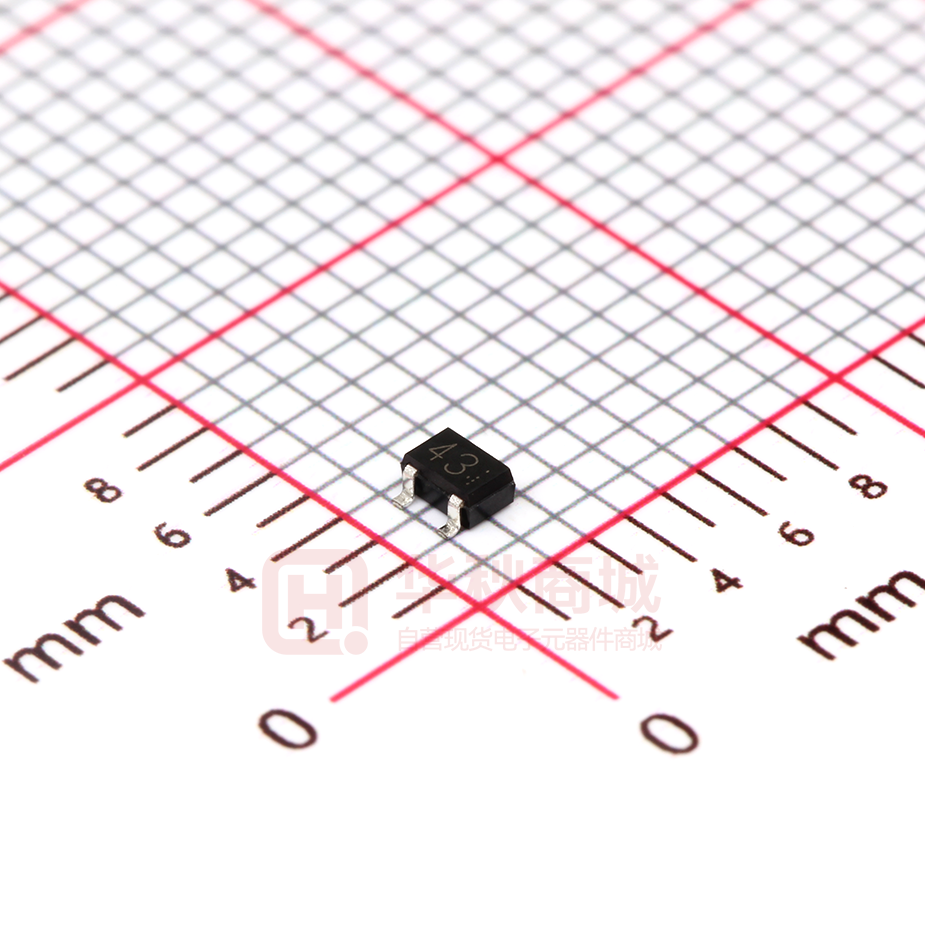

    带预偏置三极管 NPN Ic=100mA Vceo=50V hfe=30 P=200mW SOT323
DTC143XUAT106 数据手册
DTC143X series Datasheet NPN 100mA 50V Digital Transistors (Bias Resistor Built-in Transistors) l Outline Parameter VCC Value 50V IC(MAX.) 100mA R1 R2 4.7kΩ 10kΩ VMT3 EMT3F     DTC143XM (SC-105AA) l Features 1) Built-In Biasing Resistors 2) Built-in bias resistors enable the configuration of  an inverter circuit without connecting external  input resistors (see inner circuit) . 3) Only the on/off conditions need to be set  for operation, making the circuit design easy. 4) Complementary PNP Types: DTA143X series DTC143XEB (SC-89) EMT3 UMT3F     DTC143XE SOT-416(SC-75A) UMT3 DTC143XUB (SC-85) SMT3     DTC143XUA DTC143XKA SOT-323(SC-70) SOT-346(SC-59) l Application INVERTER, INTERFACE, DRIVER l Inner circuit DTC143XM/ DTC143XEB/ DTC143XUB DTC143XE/ DTC143XUA/ DTC143XKA l Packaging specifications                                             Part No. Package Package size Taping code DTC143XM DTC143XEB DTC143XE DTC143XUB DTC143XUA DTC143XKA VMT3 EMT3F EMT3 UMT3F UMT3 SMT3 1212 1616 1616 2021 2021 2928 T2L TL TL TL T106 T146 Reel size Tape width (mm) (mm) 180 180 180 180 180 180 8 8 8 8 8 8 Basic ordering unit.(pcs) Marking 8000 3000 3000 3000 3000 3000 43 43 43 43 43 43                                                                                           www.rohm.com © 2015 ROHM Co., Ltd. All rights reserved. 1/10 20150311 - Rev.002   DTC143X series          Datasheet l Absolute maximum ratings (Ta = 25°C) Parameter Symbol Values Unit Supply voltage VCC 50 V Input voltage VIN -7 to 20 V Output current IO 100 mA IC(MAX)*1 100 mA Collector current DTC143XM 150 DTC143XEB 150 DTC143XE 150 PD*2 Power dissipation DTC143XUB mW 200 DTC143XUA 200 DTC143XKA 200 Tj 150 ℃ Tstg -55 to +150 ℃ Junction temperature Range of storage temperature l Electrical characteristics (Ta = 25°C) Values Parameter Input voltage Output voltage Input current Symbol Conditions Unit Min. Typ. Max. VI(off) VCC = 5V, IO = 100μA - - 0.3 VI(on) VO = 0.3V, IO = 20mA 2.5 - - VO(on) IO / I I = 10mA / 0.5mA - 100 300 mV VI = 5V - - 1.8 mA II V Output current IO(off) VCC = 50V, VI = 0V - - 500 nA DC current gain GI VO = 5V, IO = 10mA 30 - - - Input resistance R1 - 3.29 4.7 6.11 kΩ Resistance ratio R2/R1 - 1.7 2.1 2.6 - - 250 - MHz Transition frequency f T*1 VCE = 10V, IE = -5mA, f = 100MHz *1 Characteristics of built-in transistor. *2 Each terminal mounted on a reference land.                                              www.rohm.com © 2015 ROHM Co., Ltd. All rights reserved.   2/10                                          20150311 - Rev.002 DTC143X series              Datasheet l Electrical characteristic curves (Ta =25°C) Fig.1 Input voltage vs. output current (ON characteristics) Fig.2 Output current vs. input voltage (OFF characteristics) Fig.3 Output current vs. output voltage Fig.4 DC current gain vs. output current                                                                                             www.rohm.com © 2015 ROHM Co., Ltd. All rights reserved. 3/10 20150311 - Rev.002 DTC143X series              Datasheet l Electrical characteristic curves (Ta =25°C) Fig.5 Output voltage vs. output current                                                                                             www.rohm.com © 2015 ROHM Co., Ltd. All rights reserved. 4/10 20150311 - Rev.002 DTC143X series                 Datasheet l Dimensions                                                                                             www.rohm.com © 2015 ROHM Co., Ltd. All rights reserved. 5/10 20150311 - Rev.002 DTC143X series            Datasheet l Dimensions                                                                                             www.rohm.com © 2015 ROHM Co., Ltd. All rights reserved. 6/10 20150311 - Rev.002 DTC143X series            Datasheet l Dimensions                                                                                             www.rohm.com © 2015 ROHM Co., Ltd. All rights reserved. 7/10 20150311 - Rev.002 DTC143X series            Datasheet l Dimensions                                                                                             www.rohm.com © 2015 ROHM Co., Ltd. All rights reserved. 8/10 20150311 - Rev.002 DTC143X series            Datasheet l Dimensions                                                                                             www.rohm.com © 2015 ROHM Co., Ltd. All rights reserved. 9/10 20150311 - Rev.002 DTC143X series            Datasheet l Dimensions                                                                                             www.rohm.com © 2015 ROHM Co., Ltd. All rights reserved. 10/10 20150311 - Rev.002
