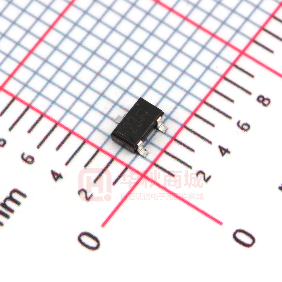

DTD143EK NPN 500mA 50V Digital Transistors Datasheet (Bias Resistor Built-in Transistors) lOutline Parameter Value VCC 50V 500mA 4.7kW 4.7kW IC(MAX.) R1 R2 SMT3 OUT IN GND DTD143EK SOT-346 (SC-59) lFeatures 1) Built-In Biasing Resistors, R1 = R2 = 4.7kW. 2) Built-in bias resistors enable the configuration of lInner circuit an inverter circuit without connecting external input resistors (see inner circuit). 3) The bias resistors consist of thin-film resistors with complete isolation to allow negative biasing of the input. They also have the advantage of completely eliminating parasitic effects. 4) Only the on/off conditions need to be set for operation, making the circuit design easy. 5) Complementary PNP Types :DTB143EK 6) Lead Free/RoHS Compliant. lApplication Switching circuit, Inverter circuit, Interface circuit, Driver circuit lPackaging specifications Part No. DTD143EK Package Package size (mm) Taping code SMT3 2928 T146 www.rohm.com © 2012 ROHM Co., Ltd. All rights reserved. 1/5 Basic Reel size Tape width ordering (mm) (mm) unit (pcs) 180 8 3,000 Marking F23 2012.07 - Rev.D Data Sheet DTD143EK lAbsolute maximum ratings (Ta = 25°C) Parameter Symbol Values Unit Supply voltage VCC 50 V Input voltage VIN -10 to +30 V Collector current IC*1 500 mA Power dissipation PD *2 200 mW Tj 150 °C Tstg -55 to +150 °C Junction temperature Range of storage temperature lElectrical characteristics(Ta = 25°C) Parameter Symbol Conditions Min. Typ. Max. Unit VI(off) VCC = 5V, IO = 100mA - - 0.5 VI(on) VO = 0.3V, IO = 20mA 3.0 - - VO(on) IO / II = 50mA / 2.5mA - 0.1 0.3 V VI = 5V - - 1.8 mA IO(off) VCC = 50V, VI = 0V - - 0.5 mA DC current gain GI VO = 5V, IO = 50mA 47 - - - Input resistance R1 - 3.29 4.7 6.11 kW Resistance ratio R2/R1 - 0.8 1 1.2 - - 200 - MHz Input voltage Output voltage Input current Output current Transition frequency II fT *1 VCE = 10V, IE = -50mA, f = 100MHz V *1 Characteristics of built-in transistor *2 Each terminal mounted on a reference footprint www.rohm.com © 2012 ROHM Co., Ltd. All rights reserved. 2/5 2012.07 - Rev.D Data Sheet DTD143EK lElectrical characteristic curves(Ta = 25°C) Fig.2 Output current vs. input voltage (OFF characteristics) INPUT VOLTAGE : VI(on) [V] OUTPUT CURRENT : IO [A] Fig.1 Input voltage vs. output current (ON characteristics) OUTPUT CURRENT : IO [mA] INPUT VOLTAGE : VI(off)[V] Fig.4 DC current gain vs. output current Fig.3 Output current vs. output voltage II= 2.0mA 500 1.8mA Ta=25ºC 400 1.4mA 1.2mA 300 1.0mA 0.8mA 200 0.6mA 100 0.4mA 0 0.2mA 0A 0 5 10 OUTPUT CURRENT : IO [mA] OUTPUT VOLTAGE : VO [V] www.rohm.com © 2012 ROHM Co., Ltd. All rights reserved. DC CURRENT GAIN : GI OUTPUT CURRENT : IO [mA] 1.6mA 3/5 2012.07 - Rev.D Data Sheet DTD143EK lElectrical characteristic curves(Ta = 25°C) OUTPUT VOLTAGE : VO(on) [V] Fig.5 Output voltage vs. output current OUTPUT CURRENT : IO [mA] www.rohm.com © 2012 ROHM Co., Ltd. All rights reserved. 4/5 2012.07 - Rev.D Data Sheet DTD143EK lDimensions (Unit : mm) D SMT3 A c Lp L1 E HE Q e A3 b x S A A1 l1 A e1 e S b2 Patterm of terminal position areas DIM A A1 A3 b c D E e HE L1 Lp Q x y MILIMETERS MIN MAX 1.00 1.30 0.00 0.10 0.25 0.35 0.50 0.09 0.25 2.80 3.00 1.50 1.80 0.95 2.60 3.00 0.30 0.60 0.40 0.70 0.20 0.30 0.10 0.10 DIM e1 b2 l1 INCHES MIN 0 MAX 0.051 0.004 0.01 0.014 0.004 0.11 0.059 0.02 0.01 0.118 0.071 0.04 0.102 0.012 0.016 0.008 - MILIMETERS MIN MAX 2.10 0.60 0.90 0.118 0.024 0.028 0.012 0.004 0.004 INCHES MIN MAX 0.08 - 0.024 0.035 Dimension in mm/inches www.rohm.com © 2012 ROHM Co., Ltd. All rights reserved. 5/5 2012.07 - Rev.D Notice Notes No copying or reproduction of this document, in part or in whole, is permitted without the consent of ROHM Co.,Ltd. The content specified herein is subject to change for improvement without notice. The content specified herein is for the purpose of introducing ROHM's products (hereinafter "Products"). If you wish to use any such Product, please be sure to refer to the specifications, which can be obtained from ROHM upon request. Examples of application circuits, circuit constants and any other information contained herein illustrate the standard usage and operations of the Products. The peripheral conditions must be taken into account when designing circuits for mass production. Great care was taken in ensuring the accuracy of the information specified in this document. However, should you incur any damage arising from any inaccuracy or misprint of such information, ROHM shall bear no responsibility for such damage. The technical information specified herein is intended only to show the typical functions of and examples of application circuits for the Products. ROHM does not grant you, explicitly or implicitly, any license to use or exercise intellectual property or other rights held by ROHM and other parties. ROHM shall bear no responsibility whatsoever for any dispute arising from the use of such technical information. The Products specified in this document are intended to be used with general-use electronic equipment or devices (such as audio visual equipment, office-automation equipment, communication devices, electronic appliances and amusement devices). The Products specified in this document are not designed to be radiation tolerant. While ROHM always makes efforts to enhance the quality and reliability of its Products, a Product may fail or malfunction for a variety of reasons. Please be sure to implement in your equipment using the Products safety measures to guard against the possibility of physical injury, fire or any other damage caused in the event of the failure of any Product, such as derating, redundancy, fire control and fail-safe designs. ROHM shall bear no responsibility whatsoever for your use of any Product outside of the prescribed scope or not in accordance with the instruction manual. The Products are not designed or manufactured to be used with any equipment, device or system which requires an extremely high level of reliability the failure or malfunction of which may result in a direct threat to human life or create a risk of human injury (such as a medical instrument, transportation equipment, aerospace machinery, nuclear-reactor controller, fuelcontroller or other safety device). ROHM shall bear no responsibility in any way for use of any of the Products for the above special purposes. If a Product is intended to be used for any such special purpose, please contact a ROHM sales representative before purchasing. If you intend to export or ship overseas any Product or technology specified herein that may be controlled under the Foreign Exchange and the Foreign Trade Law, you will be required to obtain a license or permit under the Law. Thank you for your accessing to ROHM product informations. More detail product informations and catalogs are available, please contact us. ROHM Customer Support System http://www.rohm.com/contact/ www.rohm.com © 2012 ROHM Co., Ltd. All rights reserved. R1120A
DTD143EKT146
物料型号:DTD143EK
器件简介:NPN型数字晶体管,内置偏置电阻,适用于开关电路、反相电路、接口电路和驱动电路。
引脚分配:SMT3封装,引脚分别为OUT、IN、GND。
参数特性: - 供电电压(Vcc):50V - 集电极电流(Ic):最大500mA - 偏置电阻(R1, R2):4.7kΩ
功能详解: 1. 内置偏置电阻,R1和R2均为4.7kΩ,无需外接输入电阻即可配置反相电路。 2. 偏置电阻由薄膜电阻构成,具有完全隔离,可实现输入的负偏置,消除寄生效应。 3. 操作只需设置开关状态,简化电路设计。 4. 互补PNP型号为DTB143EK。 5. 符合无铅/RoHS标准。
应用信息:适用于开关电路、反相电路、接口电路和驱动电路。
封装信息: - 型号:DTD143EK - 封装类型:SMT3 - 封装尺寸:2.9mm x 2.8mm - 胶带代码:T146 - 卷轴尺寸:180mm - 胶带宽度:8mm - 基本订购单位:3000pcs - 标记:F23
