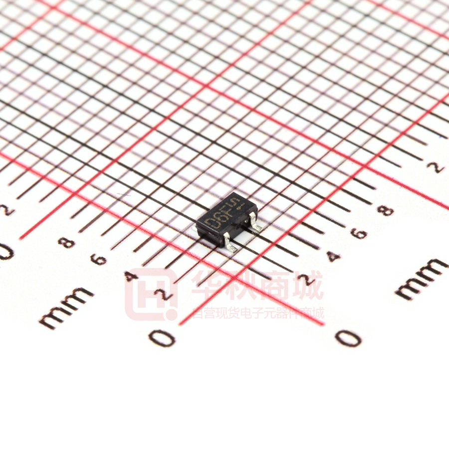

    稳压二极管 Vz=6.47~7.14V Izt=5mA P=1W SC74A
FTZ6.8ET148 数据手册
FTZ6.8E Diodes Zener diode FTZ6.8E zExternal dimensions (Unit : mm) zLand size figure (Unit : mm) r r ‫ޓޓޓ‬ 㧗 ฦ࡝࡯࠼ߣ߽หኸᴺ ‫ޓ‬㧙 Each lead has same dimension 㪇㪅㪋㪌 㪇㪅㪊㪌  㪇㪅㪊㪌 㪇㪅㪋㪌 㪇㪅㪍 㧗 㧙 r   zFeatures 1) Small mold type. (SMD5) 2) High reliability. 㪉㪅㪋 㪇㪅㪏㪤㪠㪥㪅 㪈㪅㪇㪤㪠㪥㪅 zApplications Voltage regulation (Anode common twin type) 㪇㪅㪐㪌 㪇㪅㪐㪌   r r  zConstruction Silicon epitaxial planar  㨪 㨪  r  㪪㪤㪛㪌 㪈㪅㪐 zStructure 㩷 㪩㪦㪟㪤㩷㪑㩷㪪㪤㪛㪌 㪡㪜㪠㪫㪘㩷㪑㩷㪪㪚㪄㪎㪋㪘 㫎㪼㪼㫂㩷㪺㫆㪻㪼 zTaping specifications (Unit : mm) 㱢㪈㪅㪌㫧㪇㪅㪈 䇭䇭䇭䇭䇭㩷㩷㪇 㪉㪅㪇㫧㪇㪅㪇㪌 㪇㪅㪊㫧㪇㪅㪈 㱢㪈㪅㪇㪤㪠㪥 㪋㪅㪇㫧㪇㪅㪈 㪊㪅㪉㫧㪇㪅㪈 zAbsolute maximum ratings (Ta=25qC) Parameter Symbol Power dissipation (*1) P(㶎) Junction temperature Tj Storage temperature Tstg (㶎) Total of 4 elements zElectrical characteristics (Ta=25qC ) ( Per chip) Parameter Symbol Min. VZ Zener voltage 6.47 㪊㪅㪉㫧㪇㪅㪈 㪏㪅㪇㫧㪇㪅㪉 㪌㪅㪌㫧㪇㪅㪉 㪇䌾㪇㪅㪌 㪊㪅㪉㫧㪇㪅㪈 㪊㪅㪌㫧㪇㪅㪇㪌 㪈㪅㪎㪌㫧㪇㪅㪈 㪋㪅㪇㫧㪇㪅㪈 Limits 200 150 -55 to +150 㪈㪅㪊㪌㫧㪇㪅㪈 Unit mW 㷄 㷄 Conditions Typ. - Max. 7.14 Unit V IZ=5mA - 0.5 μA VR=3.5V ZZ Operating resistance Rising operating resistance Z䌺㫂 ΀Zener voltage is measured with 40msec current supply. 40 60 㱅 㱅 Iz=5mA Iz=0.5mA Reverse current 㪠㪩 - Rev.A 1/2 FTZ6.8E Diodes zElectrical characteristic curves (Ta=25qC) 㪈㪇㪇㪇 㪫㪸㪔㪎㪌㷄 㪫㪸㪔㪄㪉㪌㷄 㪇㪅㪈 㪫㪸㪔㪈㪌㪇㷄 㪇㪅㪇㪈 㪈㪇㪇 㪽㪔㪈㪤㪟㫑 㪈㪇㪇 㪈㪇 㪫㪸㪔㪎㪌㷄 㪈 㪫㪸㪔㪉㪌㷄 㪇㪅㪈 㪫㪸㪔㪄㪉㪌㷄 㪇㪅㪇㪈 㪇㪅㪇㪇㪈 㪍㪅㪌 㪎 㪎㪅㪌 㪱㪜㪥㪜㪩㩷㪭㪦㪣㪫㪘㪞㪜㪑㪭㫑㩿㪭㪀 㪭㫑㪄㪠㫑㩷㪚㪟㪘㪩㪘㪚㪫㪜㪩㪠㪪㪫㪠㪚㪪 㪇 㪏 㪉 㪊 㪈 㪋 㪇 㪩㪜㪭㪜㪩㪪㪜㩷㪚㪬㪩㪩㪜㪥㪫㪑㪠㪩㩿㫅㪘㪀 㪍㪅㪏 㪘㪭㪜㪑㪍㪅㪏㪇㪭 㪍㪅㪍 㪈㪐 㪫㪸㪔㪉㪌㷄 㪭㪩㪔㪊㪅㪌㪭 㫅㪔㪊㪇㫇㪺㫊 㪇㪅㪏 㪇㪅㪎 㪇㪅㪍 㪇㪅㪌 㪇㪅㪋 㪇㪅㪊 㪘㪭㪜㪑㪇㪅㪈㪉㪇㫅㪘 㪇㪅㪉 㪈 㪱㪜㪥㪜㪩㩷㪚㪬㪩㪩㪜㪥㪫㩿㫄㪘㪀 㪱㫑㪄㪠㫑㩷㪚㪟㪘㪩㪘㪚㪫㪜㪩㪠㪪㪫㪠㪚㪪 㪈㪍 㪘㪭㪜㪑㪈㪏㪅㪈㪇㫇㪝 㪈㪌 㪈㪋 㪈㪊 㪈㪉 㪈㪈 㪊㪇 㪈㪇 㪩㫋㪿㩿㫁㪄㪸㪀 㪈㪇㪇 㪩㫋㪿㩿㫁㪄㪺㪀 㪤㫆㫌㫅㫋㪼㪻㩷㫆㫅㩷㪼㫇㫆㫏㫐㩷㪹㫆㪸㫉㪻 㪠㪤㪔㪈㪇㫄㪘 㪈㪇 㪈㫄㫊 㪠㪝㪔㪈㪇㪇㫄㪘 㫋㫀㫄㪼 㪜㪣㪜㪚㪫㪩㪦㪪㪫㪘㪫㪠㪚 㪛㪠㪪㪚㪟㪘㪩㪞㪜㩷㪫㪜㪪㪫㩷㪜㪪㪛㩿㪢㪭㪀 㪫㪩㪘㪥㪪㪠㪜㪥㪫 㪫㪟㪘㪜㪩㪤㪘㪣㩷㪠㪤㪧㪜㪛㪘㪥㪚㪜㪑㪩㫋㪿㩷㩿㷄㪆㪮㪀 㪇㪅㪈 㪈㪎 㪚㫋㩷㪛㪠㪪㪩㪜㪪㪠㪦㪥㩷㪤㪘㪧 㪈㪇㪇㪇 㪈 㪉㪌 㪈㪌 㪈㪇 㪘㪭㪜㪑㪈㪈㪅㪌㫂㪭 㪌 㪇 㪇㪅㪇㪈 㪇㪅㪈 㪈 㪈㪇 㪈㪇㪇 㪫㪠㪤㪜㪑㫋㩿㫊㪀 㪩㫋㪿㪄㫋㩷㪚㪟㪘㪩㪘㪚㪫㪜㪩㪠㪪㪫㪠㪚㪪 㪥㫆㩷㪹㫉㪼㪸㫂㩷㪸㫋㩷㪊㪇㫂㪭 㪥㫆㩷㪹㫉㪼㪸㫂㩷㪸㫋㩷㪊㪇㫂㪭 㪉㪇 㪊㪇㪇㫌㫊 㪈 㪇㪅㪇㪇㪈 㪌 㪫㪸㪔㪉㪌㷄 㪽㪔㪈㪤㪟㫑 㪭㪩㪔㪇㪭 㫅㪔㪈㪇㫇㪺㫊 㪈㪏 㪠㪩㩷㪛㪠㪪㪩㪜㪪㪠㪦㪥㩷㪤㪘㪧 㪭㫑㩷㪛㪠㪪㪩㪜㪪㪠㪦㪥㩷㪤㪘㪧 㪈㪇 㪋 㪈㪇 㪇 㪈㪇㪇 㪊 㪉㪇 㪇㪅㪈 㪍㪅㪌 㪉 㪩㪜㪭㪜㪩㪪㪜㩷㪭㪦㪣㪫㪘㪞㪜㪑㪭㪩㩿㪭㪀 㪭㪩㪄㪚㫋㩷㪚㪟㪘㪩㪘㪚㪫㪜㪩㪠㪪㪫㪠㪚㪪 㪈 㪇㪅㪐 㪫㪸㪔㪉㪌㷄 㪠㪱㪔㪌㫄㪘 㫅㪔㪊㪇㫇㪺㫊 㪍㪅㪐 㪈 㪩㪜㪭㪜㪩㪪㪜㩷㪭㪦㪣㪫㪘㪞㪜䋺㪭㪩㩿㪭㪀 㪭㪩㪄㪠㪩㩷㪚㪟㪘㪩㪘㪚㪫㪜㪩㪠㪪㪫㪠㪚㪪 㪎 㪍㪅㪎 㪈 㪚㪘㪧㪘㪚㪠㪫㪘㪥㪚㪜 㪙㪜㪫㪮㪜㪜㪥㪫㪜㪩㪤㪠㪥㪘㪣㪪㪑㪚㫋㩿㫇㪝㪀 㪍 㪛㪰㪥㪘㪤㪠㪚㩷㪠㪤㪧㪜㪛㪘㪥㪚㪜㪑㪱㫑㩿㱅㪀 㪈㪇 㪇㪅㪇㪇㪇㪈 㪇㪅㪇㪇㪈 㪱㪜㪥㪜㪩㩷㪭㪦㪣㪫㪘㪞㪜㪑㪭㫑㩿䌖㪀 㪫㪸㪔㪈㪉㪌㷄 㪫㪸㪔㪈㪌㪇㷄 㪚㪘㪧㪘㪚㪠㪫㪘㪥㪚㪜㩷㪙㪜㪫㪮㪜㪜㪥 㪫㪜㪩㪤㪠㪥㪘㪣㪪㪑㪚㫋㩿㫇㪝㪀 㪫㪸㪔㪈㪉㪌㷄 㪫㪸㪔㪉㪌㷄 㪈 㪩㪜㪭㪜㪩㪪㪜㩷㪚㪬㪩㪩㪜㪥㪫㪑㪠㪩㩷㩿㫅㪘㪀 㪱㪜㪥㪜㪩㩷㪚㪬㪩㪩㪜㪥㪫㪑㪠㫑㩿㫄㪘㪀 㪈㪇 㪚㪔㪉㪇㪇㫇㪝 㪩㪔㪇㱅 㪚㪔㪈㪇㪇㫇㪝 㪩㪔㪈㪅㪌㫂㱅 㪚㪔㪈㪌㪇㫇㪝 㪩㪔㪊㪊㪇㱅 㪈㪇㪇㪇 㪜㪪㪛㩷㪛㪠㪪㪧㪜㪩㪪㪠㪦㪥㩷㪤㪘㪧 Rev.A 2/2 Datasheet Notice Precaution on using ROHM Products 1. Our Products are designed and manufactured for application in ordinary electronic equipments (such as AV equipment, OA equipment, telecommunication equipment, home electronic appliances, amusement equipment, etc.). If you (Note 1) , transport intend to use our Products in devices requiring extremely high reliability (such as medical equipment equipment, traffic equipment, aircraft/spacecraft, nuclear power controllers, fuel controllers, car equipment including car accessories, safety devices, etc.) and whose malfunction or failure may cause loss of human life, bodily injury or serious damage to property (“Specific Applications”), please consult with the ROHM sales representative in advance. Unless otherwise agreed in writing by ROHM in advance, ROHM shall not be in any way responsible or liable for any damages, expenses or losses incurred by you or third parties arising from the use of any ROHM’s Products for Specific Applications. (Note1) Medical Equipment Classification of the Specific Applications JAPAN USA EU CHINA CLASSⅢ CLASSⅡb CLASSⅢ CLASSⅢ CLASSⅣ CLASSⅢ 2. ROHM designs and manufactures its Products subject to strict quality control system. However, semiconductor products can fail or malfunction at a certain rate. Please be sure to implement, at your own responsibilities, adequate safety measures including but not limited to fail-safe design against the physical injury, damage to any property, which a failure or malfunction of our Products may cause. The following are examples of safety measures: [a] Installation of protection circuits or other protective devices to improve system safety [b] Installation of redundant circuits to reduce the impact of single or multiple circuit failure 3. Our Products are designed and manufactured for use under standard conditions and not under any special or extraordinary environments or conditions, as exemplified below. Accordingly, ROHM shall not be in any way responsible or liable for any damages, expenses or losses arising from the use of any ROHM’s Products under any special or extraordinary environments or conditions. If you intend to use our Products under any special or extraordinary environments or conditions (as exemplified below), your independent verification and confirmation of product performance, reliability, etc, prior to use, must be necessary: [a] Use of our Products in any types of liquid, including water, oils, chemicals, and organic solvents [b] Use of our Products outdoors or in places where the Products are exposed to direct sunlight or dust [c] Use of our Products in places where the Products are exposed to sea wind or corrosive gases, including Cl2, H2S, NH3, SO2, and NO2 [d] Use of our Products in places where the Products are exposed to static electricity or electromagnetic waves [e] Use of our Products in proximity to heat-producing components, plastic cords, or other flammable items [f] Sealing or coating our Products with resin or other coating materials [g] Use of our Products without cleaning residue of flux (even if you use no-clean type fluxes, cleaning residue of flux is recommended); or Washing our Products by using water or water-soluble cleaning agents for cleaning residue after soldering [h] Use of the Products in places subject to dew condensation 4. The Products are not subject to radiation-proof design. 5. Please verify and confirm characteristics of the final or mounted products in using the Products. 6. In particular, if a transient load (a large amount of load applied in a short period of time, such as pulse. is applied, confirmation of performance characteristics after on-board mounting is strongly recommended. Avoid applying power exceeding normal rated power; exceeding the power rating under steady-state loading condition may negatively affect product performance and reliability. 7. De-rate Power Dissipation (Pd) depending on Ambient temperature (Ta). When used in sealed area, confirm the actual ambient temperature. 8. Confirm that operation temperature is within the specified range described in the product specification. 9. ROHM shall not be in any way responsible or liable for failure induced under deviant condition from what is defined in this document. Precaution for Mounting / Circuit board design 1. When a highly active halogenous (chlorine, bromine, etc.) flux is used, the residue of flux may negatively affect product performance and reliability. 2. In principle, the reflow soldering method must be used on a surface-mount products, the flow soldering method must be used on a through hole mount products. If the flow soldering method is preferred on a surface-mount products, please consult with the ROHM representative in advance. For details, please refer to ROHM Mounting specification Notice-PGA-E © 2015 ROHM Co., Ltd. All rights reserved. Rev.001 Datasheet Precautions Regarding Application Examples and External Circuits 1. If change is made to the constant of an external circuit, please allow a sufficient margin considering variations of the characteristics of the Products and external components, including transient characteristics, as well as static characteristics. 2. You agree that application notes, reference designs, and associated data and information contained in this document are presented only as guidance for Products use. Therefore, in case you use such information, you are solely responsible for it and you must exercise your own independent verification and judgment in the use of such information contained in this document. ROHM shall not be in any way responsible or liable for any damages, expenses or losses incurred by you or third parties arising from the use of such information. Precaution for Electrostatic This Product is electrostatic sensitive product, which may be damaged due to electrostatic discharge. Please take proper caution in your manufacturing process and storage so that voltage exceeding the Products maximum rating will not be applied to Products. Please take special care under dry condition (e.g. Grounding of human body / equipment / solder iron, isolation from charged objects, setting of Ionizer, friction prevention and temperature / humidity control). Precaution for Storage / Transportation 1. Product performance and soldered connections may deteriorate if the Products are stored in the places where: [a] the Products are exposed to sea winds or corrosive gases, including Cl2, H2S, NH3, SO2, and NO2 [b] the temperature or humidity exceeds those recommended by ROHM [c] the Products are exposed to direct sunshine or condensation [d] the Products are exposed to high Electrostatic 2. Even under ROHM recommended storage condition, solderability of products out of recommended storage time period may be degraded. It is strongly recommended to confirm solderability before using Products of which storage time is exceeding the recommended storage time period. 3. Store / transport cartons in the correct direction, which is indicated on a carton with a symbol. Otherwise bent leads may occur due to excessive stress applied when dropping of a carton. 4. Use Products within the specified time after opening a humidity barrier bag. Baking is required before using Products of which storage time is exceeding the recommended storage time period. Precaution for Product Label QR code printed on ROHM Products label is for ROHM’s internal use only. Precaution for Disposition When disposing Products please dispose them properly using an authorized industry waste company. Precaution for Foreign Exchange and Foreign Trade act Since concerned goods might be fallen under listed items of export control prescribed by Foreign exchange and Foreign trade act, please consult with ROHM in case of export. Precaution Regarding Intellectual Property Rights 1. All information and data including but not limited to application example contained in this document is for reference only. ROHM does not warrant that foregoing information or data will not infringe any intellectual property rights or any other rights of any third party regarding such information or data. 2. ROHM shall not have any obligations where the claims, actions or demands arising from the combination of the Products with other articles such as components, circuits, systems or external equipment (including software). 3. No license, expressly or implied, is granted hereby under any intellectual property rights or other rights of ROHM or any third parties with respect to the Products or the information contained in this document. Provided, however, that ROHM will not assert its intellectual property rights or other rights against you or your customers to the extent necessary to manufacture or sell products containing the Products, subject to the terms and conditions herein. Other Precaution 1. This document may not be reprinted or reproduced, in whole or in part, without prior written consent of ROHM. 2. The Products may not be disassembled, converted, modified, reproduced or otherwise changed without prior written consent of ROHM. 3. In no event shall you use in any way whatsoever the Products and the related technical information contained in the Products or this document for any military purposes, including but not limited to, the development of mass-destruction weapons. 4. The proper names of companies or products described in this document are trademarks or registered trademarks of ROHM, its affiliated companies or third parties. Notice-PGA-E © 2015 ROHM Co., Ltd. All rights reserved. Rev.001 Datasheet General Precaution 1. Before you use our Pro ducts, you are requested to care fully read this document and fully understand its contents. ROHM shall n ot be in an y way responsible or liabl e for fa ilure, malfunction or acci dent arising from the use of a ny ROHM’s Products against warning, caution or note contained in this document. 2. All information contained in this docume nt is current as of the issuing date and subj ect to change without any prior notice. Before purchasing or using ROHM’s Products, please confirm the la test information with a ROHM sale s representative. 3. The information contained in this doc ument is provi ded on an “as is” basis and ROHM does not warrant that all information contained in this document is accurate an d/or error-free. ROHM shall not be in an y way responsible or liable for an y damages, expenses or losses incurred b y you or third parties resulting from inaccur acy or errors of or concerning such information. Notice – WE © 2015 ROHM Co., Ltd. All rights reserved. Rev.001
