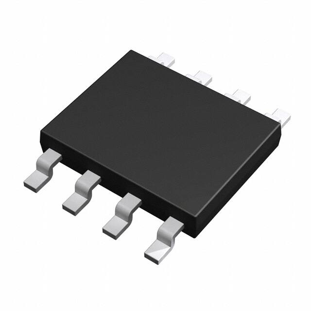

    通用标准系列LM393 / LM339 / LM2903 / LM2901单片集成电路在单芯片上集成了两个/四个独立的比较器,具有高增益、低功耗的特点,工作电压范围为2[V]至36[V](单电源)。
LM2903DGKR 数据手册
General-purpose Operational Amplifiers /Comparators TROPHY SERIES Comparators LM393DR/PWR/DGKR,LM2903DR/PWR/DGKR/VQDR/VQPWR LM339DR/PWR,LM2901DR/PWR/VQDR/VQPWR ●Description The Universal Standard family LM393 / LM339/ LM2903 / LM2901 monolithic ICs integrate two/four independent comparators on a single chip and feature high gain, low power consumption, and an operating voltage range from 2[V] to 36[V] (single power supply). LM393 family LM393DR LM393PWR LM393DGKR No.11094EBT03 TROPHY SERIES Dual LM2903 family LM2903DR LM2903PWR LM2903DGKR LM2903VQDR LM2903VQPWR LM339DR LM339PWR Quad LM339 family LM2901 family LM2901DR LM2901PWR LM2901VQDR LM2901VQPWR ●Features 1) Operating temperature range Commercial Grade LM339/393 family : 0[℃] to + 70[℃] Extended Industrial Grade LM2903/2901 family : -40[℃] to +125[℃] 2) Open collector output 3) Single / dual power supply compatible 4) Low supply current 0.8[mA] typ. (LM393/339/2903/2901 family) 5) Low input-bias current: 25[nA] typ. 6) Low input-offset voltage: 2[mV] typ. 7) Differential input voltage range equal to maximum rating 8) Low output saturation voltage 9) TTL,MOS,CMOS compatible output ●Pin Assignment 1OUT 1 14 OUT3 1OUT 1 8 Vcc 2OUT 2 13 OUT4 Vcc 3 - + 2IN4 - + 11 4IN+ 12 GND 1IN- 2 -  + 7 2OUT 1IN+ 3  + - 6 2IN- 2IN+ 5 10 4IN- 1IN- 6 - + - + 9 3IN+ GN D 4 5 2IN+ 1IN+ 7 8 3IN- SOIC8 LM393DR LM2903DR LM2903VQDR TSSOP8 LM393PW R LM2903PW R LM2903VQPW R MSOP8/VSSOP8 LM393DGKR LM2903DGKR SOIC14 LM339DR LM2901DR LM2901VQDR TSSOP14 LM339PW R LM2901PW R LM2901VQPW R www.rohm.com © 2011 ROHM Co., Ltd. All rights reserved. 1/17 2011.06 - Rev.B LM393DR/PWR/DGKR,LM2903DR/PWR/DGKR/VQDR/VQPWR LM339DR/PWR,LM2901DR/PWR/VQDR/VQPWR ●Absolute Maximum Ratings (Ta=25℃) Parameter Supply Voltage Input Differential Voltage Common-mode Input Operating Temperature Storage Temperature Range Maximum Junction Temperature Symbol Vcc-GND Vid Vicm Topr Tstg Tj 0 to +70 -65 to +150 +150 Ratings LM393 family LM339 family LM2903 family +36 ±36 -0.3 to +36 Technical Note LM2901 family Unit V V V -40 to +125 ℃ ℃ ℃ ●Electric Characteristics ○LM393/339 family(Unless otherwise specified, Vcc=+5[V]) Limits Parameter Temperature Symbol range Min. 25℃ Input Offset Voltage (*1) VIO Full range 25℃ Input Offset Current (*1) IIO Full range 25℃ Input Bias Current (*1) IIB Full range 25℃ VICR Full range AVD 25℃ 25℃ IOH Full range 25℃ VOL Full range IOL 25℃ 25℃ Supply Current ICC Full range - - Response Time Tre 25℃ - (*1) Absolute value 0.3 - - 0.3 - - 1.3 2.5 - - - - 1.3 - - μs - 6 - - - 0.8 700 - 1 - 6 - - 16 0.8 700 - 2 mA RL=∞,Vcc=30[V] RL=5.1[kΩ],VRL=5[V],CL=15pF VIN=100[mVp-p], overdrive=5[mV] RL=5.1[kΩ],VRL=5[V], CL=15pF VIN=TTL-Level input step Vref=1.4[V] mA VID=-1[V],VOL=1.5[V] RL=∞,Vcc=5V 89 89 - - - 150 1 400 - - - 150 1 400 mV VID=-1[V],IOL=4[mA] 89 μA VID=1[V],VO=30[V] - 25 - - 200 0.1 Vcc-2.0 - - - 25 - - 200 0.1 Vcc-2.0 - - V/mA nA Vcc=15[V] VO=1.4 to 11.4[V], RL≧15[kΩ],VRL=15[V] VID=1[V],VO=5[V] 89 88 - - - - 400 Vcc-1.5 - - - - 400 Vcc-1.5 V - 88 - - - 25 250 250 - - - 25 150 250 nA VO=1.4[V] 88 - - - 5 9 50 - - - 5 9 50 nA VO=1.4[V] 88 - LM393 family Typ. 2 Max. 7 Min. - LM339 family Typ. 2 Max. 7 mV Unit condition Fig. No. Vcc=5 to 30[V],VO=1.4[V] VIC=VIC(min) 88 Common-mode Input Voltage Range Large Signal Differential Voltage Amplification High Level Output Current Low Level Output Voltage Low Level Output Current 89 www.rohm.com © 2011 ROHM Co., Ltd. All rights reserved. 2/17 2011.06 - Rev.B LM393DR/PWR/DGKR,LM2903DR/PWR/DGKR/VQDR/VQPWR LM339DR/PWR,LM2901DR/PWR/VQDR/VQPWR Technical Note ○LM2903/2901 family(Unless otherwise specified, Vcc=+5[V]) Limits Parameter Symbol Temperature range LM2903 family Min. 25℃ Input Offset Voltage (*2) VIO Full range 25℃ Input Offset Current (*2) IIO Full range 25℃ IIB Full range 25℃ VICR Full range AVD 25℃ 25℃ IOH Full range 25℃ VOL 25℃ Full range Low Level Output Current IOL 25℃ - - - - 6 - Supply Current ICC 25℃ - - Response Time Tre 25℃ - 0.3 - - 0.3 - 1 1.3 2.5 - - - 1 1.3 2.5 - μs - 150 150 - 16 0.8 1 400 400 700 - 2 - - - - 6 - - 150 150 - 16 0.8 1 500 400 700 - 2 mA RL=∞,Vcc=MAX(*7) RL=5.1[Ω],VRL=5[V],CL=15pF VIN=100[mVp-p], Overdrive=5[mV] RL=5.1[kΩ],VRL=5[V], CL=15pF VIN=TTL-Level input step Vref=1.4[V] mA VID=-1[V], VOL=1.5[V] RL=∞,Vcc=5V 89 89 mV VIN(-)=1[V],VIN(+)=0[V] ISINK≦4[mA] 89 μA VID=1[V], VOH=MAX - 25 - - 100 0.1 Vcc-2.0 LM2901 family Min. - - - - - - - - 25 - Typ. 2 - 5 - 25 - - - 100 0.1 Max. 7 Unit Condition Fig. No Typ. 2 - 5 - 25 - - Max. 7 15 50 200 250 500 Vcc-1.5 - - - - - - - mV 15 50 nA 200 250 nA 500 Vcc-1.5 Vcc=5 to MAX),VO=1.4[V] VIC=VIC (min) 88 VO=1.4[V] 88 Input Bias Current (*2) VO=1.4[V] 88 Common-mode Input Voltage Range V Vcc-2.0 - 88 Large Signal Differential Voltage Amplification - - - - V/mV nA Vcc=15[V],VOUT=1.4 to 11.4[V], RL≧15[kΩ],VRL=15[V] VID=1[V], VOH=5[V] 88 High Level Output Current 89 LM2901(*3) Low Level Output Voltage LM2901V(*3) 89 (*2) Absolute value (*3) Supply Voltage Maximum Value LM2901DR, LM2901PWR MAX=30[V], LM2901VQDR, LM2901VQPWR MAX=32[V] www.rohm.com © 2011 ROHM Co., Ltd. All rights reserved. 3/17 2011.06 - Rev.B LM393DR/PWR/DGKR,LM2903DR/PWR/DGKR/VQDR/VQPWR LM339DR/PWR,LM2901DR/PWR/VQDR/VQPWR ●Reference Data LM393 family 1000 LM393 family Technical Note 1  . 0℃ LM393 family 1 LM393 family POWER DISSIPATION [mW] . 800 LM393DGKR LM393PWR 0.8 SUPPLY CURRENT [mA] 0.8 SUPPLY CURRENT [mA] 36V 25℃ 600 0.6 0.6 400 LM393DR 0.4 70℃ 0.4 2V 200 0.2 0.2 5V 0 0 25 50 70 0 0 0 10 20 30 SUPPLY VOLTAGE [V] 40 75 100 125 0 10 AMBIENT TEMPERATURE [℃] . 20 30 40 50 60 70 AMBIENT TEMPER ATURE [℃] 80 Fig.1 Derating Curve 500 OUTPUT SATURATION VOLTAGE [mV] 70℃ LM393 family Fig.2 Supply Current – Supply Voltage 500 OUTPUT SATU RATION VOLT AGE [mV] LM393 family Fig. 3 Supply Current – Ambient Temperature 2.0 LOW LEVEL OUTPUT VOLTAGE [V] 1.8 1.6 1.4 1.2 1.0 0.8 0.6 0.4 0.2 0.0 0 2 4 6 8 0℃ 70℃ 25℃ LM393 family 400 400 2V 300 25℃ 300 5V 200 0℃ 200 36V 100 100 0 0 10 20 30 SUPPLY VOLTAGE [V] 40 0 0 10 20 30 40 50 60 70 AMBIENT TEMPERATURE [℃] 80 10 12 14 16 18 20 Fig.4 Fig. 5 OUTPUT SINK CURRENT [mA] Fig. 6 Output Saturation Voltage – Supply Voltage (IOL=4[mA]) 40 OUTPUT SINK CURR ENT [mA] LM393 family Output Saturation Voltage – Ambient Temperature (IOL=4[mA]) 8 INPUT OFFSET VOLTAGE [mV] 6 4 2 0 -2 -4 -6 -8 70℃ 0℃ 25℃ LM393 family Low Level Output Voltage – Output Sink Current (VCC=5[V]) 8 INPUT OFFSET VOLTAGE [mV] 6 4 2 0 -2 -4 -6 -8 36V 2V 5V LM393 family 30 36V 5V 20 10 2V 0 0 10 20 30 40 50 60 70 AMBIEN T TEMPERATURE [℃] 80 0 10 20 30 40 0 10 20 30 40 50 60 70 80 SUPPLY VOLTAGE [V] AMBIENT TEMPERATURE [℃] Output Sink Current – Ambient Temperature (VOUT=1.5[V]) 160 140 INPUT BIAS CURRENT [nA] LM393 family Fig. 7 Input Offset Voltage – Supply Voltage Fig. 8 Fig. 9 Input Offset Voltage – Ambient Temperature . 160 140 LM393 family 50 40 INPUT OFFSET CURRENT [nA] 30 20 10 0 -10 -20 -30 -40 -50 0℃ LM393 family INPUT BIAS CURRENT [nA] 120 100 80 60 40 20 0 0 10 20 30 40 SUPPLY VOLTAGE [V] 70℃ 0℃ 25℃ 120 100 80 60 40 20 0 0 10 20 30 40 50 60 70 AMBIENT TEMPERATURE [℃] 80 2V 5V 36V 25℃ 70℃ 0 10 20 30 SUPPLY VOLTAGE [V] 40 Fig. 10 Input Bias Current – Supply Voltage Fig. 11 Input Bias Current – Ambient Temperature Fig. 12 Input Offset Current – Supply Voltage (*)The data above is ability value of sample, it is not guaranteed. LM393family:0[℃]~+70[℃] www.rohm.com © 2011 ROHM Co., Ltd. All rights reserved. 4/17 2011.06 - Rev.B LM393DR/PWR/DGKR,LM2903DR/PWR/DGKR/VQDR/VQPWR LM339DR/PWR,LM2901DR/PWR/VQDR/VQPWR ●Reference Data LM393 family 50 40 IN PUT OFFSET CU RRENT [nA] 30 20 10 0 -10 -20 -30 -40 -50 0 10 20 30 40 50 60 70 AMBIENT TEMPERATURE [℃] 80 2V 5V 36V Technical Note . LM393 family 140 130 120 110 100 90 80 70 60 0 70℃ 0℃ 25℃ LM393 family . 140 130 36V LM393 family LARGE SIGNAL VOLTAGE GAIN [dB] LARGE SIGNAL VOLT AGE GAIN [dB] 120 110 100 90 80 70 60 0 10 20 30 40 50 60 70 AMBIENT TEMPERATURE [°C] 80 2V 5V 10 20 30 SUPPLY VOLTAGE [V] 40 Fig. 13 Input Offset Current – Ambient Temperature 160 140 120 100 80 60 40 0 10 20 30 SUPPLY VOLTAGE [V] 40 LM393 family Fig. 14 . Fig. 15 Large Signal Voltage Gain – Ambient Temperature 140 130 120 110 100 90 80 70 60 0 10 20 30 40 50 60 70 AMBIENT TEMPERAT URE [°C] 80 LM393 family Large Signal Voltage Gain – Supply Voltage POWER SUPPLY REJECTION RAT IO [dB] 140 130 120 36V LM393 family 0℃ 25℃ 110 100 90 80 70 60 0 10 2V 5V 70℃ 20 30 40 50 60 70 AMBIENT TEMPERATURE [°C] 80 Fig. 16 Common Mode Rejection Ratio – Supply Voltage .. 5 LM393 family Fig. 17 Common Mode Rejection Ratio – Ambient Temperature 5 RESPONSE TIME (HIGH to LOW) [μ s] LM393 family POWER SUPPLY REJECTION RATIO [dB] COMMON MODE REJECTION RATIO[dB] . Fig. 18 Power Supply Rejection Ratio – Ambient Temperature RESPONSE T IME (LOW to HIGH) [μs] . 4 3 5mV overdrive 4 3 5mV overdrive 2 20mV overdrive 2 20mV overdrive 100mV overdrive 1 100mV overdrive 1 0 0 10 20 30 40 50 60 70 AMBIENT TEMPERATURE [°C] 80 0 0 10 20 30 40 50 60 70 AMBIENT TEMPERATURE [°C] 80 Fig. 19 Response Time (Low to High) – Ambient Temperature (VCC=5[V],VRL=5[V],RL=5.1[kΩ]) Fig. 20 Response Time (High to Low) –Ambient Temperature (VCC=5[V],VRL=5[V],RL=5.1[kΩ]) (*)The data above is ability value of sample, it is not guaranteed. LM393family:0[℃]~+70[℃] www.rohm.com © 2011 ROHM Co., Ltd. All rights reserved. 5/17 2011.06 - Rev.B LM393DR/PWR/DGKR,LM2903DR/PWR/DGKR/VQDR/VQPWR LM339DR/PWR,LM2901DR/PWR/VQDR/VQPWR ●Reference Data LM339 family 1000 LM339 family Technical Note 1  . 0℃ LM339 family LM339 family 1 POWER DISSIPATION [mW] . 800 SUPPLY CURRENT [mA] SUPPLY CURRENT [mA] LM339PWR 0.8 25℃ 0.8 36V 5V 600 0.6 0.6 400 LM339DR 0.4 70℃ 0.4 2V 200 0.2 0.2 0 0 25 50 70 0 0 0 10 20 30 SUPPLY VOLTAGE [V] 40 0 10 20 30 40 50 60 70 AMBIENT TEMPER ATURE [℃] 80 75 100 125 AMBIENT TEMPERATURE [℃] . Fig.21 Derating Curve LM339 family Fig.22 Supply Current – Supply Voltage 500 OUTPUT SATU RATION VOLT AGE [mV] LM339 family Fig. 23 Supply Current – Ambient Temperature 2.0 LOW LEVEL OUTPUT VOLTAGE [V] LM339 family 500 OUTPUT SATURATION VOLTAGE [mV] 70℃ 1.8 1.6 1.4 1.2 1.0 0.8 0.6 0.4 0.2 0.0 0 2 4 6 8 0℃ 70℃ 25℃ 400 400 2V 300 25℃ 300 5V 200 0℃ 200 36V 100 100 0 0 10 20 30 SUPPLY VOLTAGE [V] 40 0 0 10 20 30 40 50 60 70 AMBIENT TEMPERATURE [℃] 80 10 12 14 16 18 20 Fig.24 Output Saturation Voltage – Supply Voltage (IOL=4[mA]) 40 OUTPUT SINK CURR ENT [mA] LM339 family Output Saturation Voltage – Ambient Temperature (IOL=4[mA]) 8 INPUT OFFSET VOLTAGE [mV] 6 4 2 0 -2 -4 -6 -8 70℃ 0℃ 25℃ LM339 family Fig. 25 OUTPUT SINK CURRENT [mA] Low Level Output Voltage – Output Sink Current (VCC=5[V]) 8 INPUT OFFSET VOLTAGE [mV] 6 4 2 0 -2 -4 -6 -8 36V 2V 5V LM339 family Fig. 26 30 36V 20 5V 10 2V 0 0 10 20 30 40 50 60 70 AMBIEN T TEMPERATURE [℃] 80 0 10 20 30 40 0 10 20 30 40 50 60 70 80 SUPPLY VOLTAGE [V] AMBIENT TEMPERATURE [℃] Fig. 27 Output Sink Current – Ambient Temperature (VOUT=1.5[V]) 160 140 INPUT BIAS CURRENT [nA] LM339 family Fig. 28 Input Offset Voltage – Supply Voltage 160 140 INPUT BIAS CURRENT [nA] 120 100 80 60 40 20 0 2V 5V 36V LM339 family Fig. 29 Input Offset Voltage – Ambient Temperature 50 40 INPUT OFFSET CURRENT [nA] 30 20 10 0 -10 -20 -30 -40 -50 25℃ 70℃ 0℃ LM339 family 120 100 80 60 40 20 0 0 10 20 30 40 SUPPLY VOLTAGE [V] 70℃ 0℃ 25℃ . 0 10 20 30 40 50 60 70 AMBIENT TEMPERATURE [℃] 80 0 10 20 30 SUPPLY VOLTAGE [V] 40 Input Bias Current – Supply Voltage Fig. 30 Fig. 31 Input Bias Current – Ambient Temperature Fig. 32 Input Offset Current – Supply Voltage (*)The data above is ability value of sample, it is not guaranteed. LM339family:0[℃]~+70[℃] www.rohm.com © 2011 ROHM Co., Ltd. All rights reserved. 6/17 2011.06 - Rev.B LM393DR/PWR/DGKR,LM2903DR/PWR/DGKR/VQDR/VQPWR LM339DR/PWR,LM2901DR/PWR/VQDR/VQPWR ●Reference Data LM339 family 40 IN PUT OFFSET CU RRENT [nA] 30 20 10 0 -10 -20 -30 -40 -50 0 10 20 30 40 50 60 70 AMBIENT TEMPERATURE [℃] 80 2V 5V 36V Technical Note . 50 . LM339 family 140 130 120 110 100 90 80 70 60 0 70℃ 0℃ 25℃ LM339 family 140 130 36V LM339 family LARGE SIGNAL VOLTAGE GAIN [dB] LARGE SIGNAL VOLT AGE GAIN [dB] 120 110 100 90 80 70 60 0 10 20 30 40 50 60 70 AMBIENT TEMPERATURE [°C] 80 2V 5V 10 20 30 SUPPLY VOLTAGE [V] 40 Fig. 33 Input Offset Current – Ambient Temperature POWER SUPPLY REJECTION RAT IO [dB] COMMON MODE REJECTION RATIO[dB] . 160 140 120 0℃ LM339 family Fig. 34 Large Signal Voltage Gain – Supply Voltage . POWER SUPPLY REJECTION RATIO [dB] Fig. 35 Large Signal Voltage Gain – Ambient Temperature 140 130 120 110 100 90 80 70 60 0 10 20 30 40 50 60 70 AMBIENT TEMPERAT URE [°C] 80 LM339 family 140 130 120 36V LM339 family 25℃ 110 100 90 80 70 60 0 10 2V 5V 100 80 60 40 0 10 20 30 SUPPLY VOLTAGE [V] 40 70℃ 20 30 40 50 60 70 AMBIENT TEMPERATURE [°C] 80 Fig. 36 Common Mode Rejection Ratio – Supply Voltage .. 5 LM339 family Fig. 37 Common Mode Rejection Ratio – Ambient Temperature 5 RESPONSE TIME (HIGH to LOW) [μ s] LM339 family Fig. 38 Power Supply Rejection Ratio – Ambient Temperature RESPONSE T IME (LOW to HIGH) [μs] . 4 3 5mV overdrive 4 3 5mV overdrive 2 20mV overdrive 2 20mV overdrive 100mV overdrive 1 100mV overdrive 1 0 0 10 20 30 40 50 60 70 AMBIENT TEMPERATURE [°C] 80 0 0 10 20 30 40 50 60 70 AMBIENT TEMPERATURE [°C] 80 Fig. 39 Response Time (Low to High) – Ambient Temperature (VCC=5[V],VRL=5[V],RL=5.1[kΩ]) Fig. 40 Response Time (High to Low) –Ambient Temperature (VCC=5[V],VRL=5[V],RL=5.1[kΩ]) (*)The data above is ability value of sample, it is not guaranteed. BA10393F:-40[℃]~+70[℃] ℃]~+85[℃] *)上記のデータはサンプルの実力値であり、保証するものではありません。BA10393F:-40[ www.rohm.com © 2011 ROHM Co., Ltd. All rights reserved. 7/17 2011.06 - Rev.B LM393DR/PWR/DGKR,LM2903DR/PWR/DGKR/VQDR/VQPWR LM339DR/PWR,LM2901DR/PWR/VQDR/VQPWR ●Reference Data LM2903 family 800 1000 POWER DISSIPATION [mW] POWER DISSIPATION Pd [mV] LM2903 family Technical Note 1.6 1.4 LM2903 family LM2903 family 1.6 1.4 600 SUPPLY CURRENT [mA] SUPPLY CURRENT [mA] 800 LM2903PT 600 1.2 1.0 0.8 0.6 0.4 0.2 105℃ 125℃ -40℃ 25℃ 1.2 1.0 0.8 0.6 0.4 0.2 0.0 2V 36V 5V LM2903DGKR 400 400 200 200 LM2903DT 00 00 25 25 0.0 AMBIENT TEMPERTURE [℃] 50 50 75 75 100 100 125 125 . 150 150 0 10 20 30 40 -50 -25 0 25 50 75 100 125 150 AMBIENT TEMPERATURE [℃] SUPPLY VOLTAGE [V] AMBIENT TEMPERATURE [℃] Fig. 41 Derating Curve LM2903 family Fig. 42 Supply Current – Supply Voltage LM2903 family Fig. 43 Supply Current – Ambient Temperature LM2903 family MAXIMUM OUTPUT VOLTAGE [mV] 200 200 2 1.8 MAXIMUM OUTPUT VOLTAGE [mV] 150 125℃ 105℃ 150 OUTPUT VOLTAGE [V] 1.6 1.4 1.2 1 0.8 0.6 0.4 0.2 -40℃ 105℃ 125℃ 25℃ 2V 100 100 5V 50 25℃ -40℃ 50 36V 0 0 10 20 30 40 0 -50 -25 0 25 50 75 100 125 150 0 0 2 4 6 8 10 12 14 16 18 20 SUPPLY VOLTAGE [V] SUPPLY VOLTAGE [V] OUTPUT SINK CURRENT [mA] Fig. 44 Output Saturation Voltage – Supply Voltage (IOL=4[mA]) LM2903 family Fig. 45 Output Saturation Voltage – Ambient Temperature (IOL=4[mA]) LM2903 family Fig. 46 Low Level Output Voltage – Output Sink Current (VCC=5[V]) LM2903 family 40 8 8 INPUT OFFSET VOLTAGE [mV] 6 4 2V INPUT OFFSET VOLTAGE [mV] OUTPUT SINK CURRENT [mA] 6 4 2 0 -2 -4 -6 -8 25℃ 105℃ 125℃ -40℃ 30 5V 36V 2 0 -2 -4 -6 -8 5V 36V 20 2V 10 0 -50 -25 0 25 50 75 100 125 150 0 10 20 30 40 -50 -25 0 25 50 75 100 125 150 AMBIENT TEMPERATURE [℃] SUPPLY VOLTAGE [V] AMBIENT TEMPERATURE [℃] Fig. 47 Output Sink Current – Ambient Temperature (VOUT=1.5[V]) LM2903 family Fig. 48 Input Offset Voltage – Supply Voltage LM2903 family Fig. 49 Input Offset Voltage – Ambient Temperature LM2903 family 160 160 INPUT OFFSET CURRENT[nA] 50 40 30 20 10 0 -10 -20 -30 -40 -50 -50 -25 0 25 50 75 100 125 150 0 10 20 30 40 105℃ 125℃ -40℃ 25℃ INPUT BIAS CURRENT [nA] INPUT BIAS CURRENT [nA] 140 120 100 80 60 40 20 0 0 5 10 15 20 25 30 35 105℃ 125℃ -40℃ 25℃ 140 120 100 80 60 40 20 0 5V 2V 36V SUPPLY VOLTAGE [V] Fig. 50 AMBIENT TEMPERATURE [℃] Fig. 51 SUPPLY VOLTAGE [V] Fig. 52 Input Bias Current – Supply Voltage Input Bias Current – Ambient Temperature Input Offset Current – Supply Voltage (*)The data above is ability value of sample, it is not guaranteed.LM2903family:-40[℃]~+125[℃] www.rohm.com © 2011 ROHM Co., Ltd. All rights reserved. 8/17 2011.06 - Rev.B LM393DR/PWR/DGKR,LM2903DR/PWR/DGKR/VQDR/VQPWR LM339DR/PWR,LM2901DR/PWR/VQDR/VQPWR ●Reference Data LM2903 family LM2903 family Technical Note 50 140 LM2903 family LM2903 family 140 LARGE SINGAL VOLTAGE GAIN [dB] INPUT OFFSET CURRENT [nA] 40 30 20 10 0 -10 -20 -30 -40 -50 -50 -25 0 25 50 75 100 125 150 5V 36V 2V LARGE SINGAL VOLTAGE GAIN [dB] 130 120 110 100 90 80 70 60 0 10 125℃ 105℃ 130 36V 120 110 100 90 80 70 60 -50 -25 0 25 50 75 100 125 150 15V 5V 25℃ -40℃ 20 30 40 AMBIENT TEMPERATURE [℃] SUPPLY VOLTAGE [V] AMBIENT TEMPERATURE [℃] Fig. 53 Input Offset Current – Ambient Temperature LM2903 family Fig. 54 Large Signal Voltage Gain – Supply Voltage LM2903 family Fig. 55 Large Signal Voltage Gain – Ambient Temperature LM2903 family COMMON MODE REJECTION RATIO [dB] COMMON MODE REJECTION RATIO [dB] 160 140 120 105℃ 150 6 INPUT OFFSET VOLTAGE [mV] 25℃ 105℃ 125 100 75 5V 36V 4 -40℃ 125℃ 2 125℃ 100 80 60 40 0 10 20 30 40 0 -2 -4 -6 -40℃ 25℃ 50 25 0 -50 -25 0 25 2V 50 75 100 125 150 -1 0 1 2 3 4 5 SUPPLY VOLTAGE [V] AMBIENT TEMPERATURE [℃] INPUT VOLTAGE [V] Fig. 56 Common Mode Rejection Ratio – Supply Voltage LM2903 family Fig. 57 Common Mode Rejection Ratio – Ambient Temperature LM2903 family Fig. 58 Input Offset Voltage – Input Voltage (VCC=5V) LM2903 family POWER SUPPLY REJECTION RATIO [dB] 180 160 140 120 100 80 60 -50 -25 0 25 50 75 100 125 150 RESPONSE TIME (LOW TO HIGH)[μs] RRESPONSE TIME (LOW TO HIGH)[μs] 200 5 5 4 4 3 3 5mV overdrive 2 125℃ 105℃ 25℃ -40℃ 2 100mV overdrive 20mV overdrive 1 1 0 -100 -80 -60 -40 -20 0 0 -50 -25 0 25 50 75 100 125 150 AMBIENT TEMPERATURE [℃] OVER DRIVE VOLTAGE [V] AMBIENT TEMPERATURE [℃] Fig. 59 Power Supply Rejection Ratio – Ambient Temperature LM2903 family Fig. 60 Response Time (Low to High) – Over Drive Voltage LM2903 family Fig. 61 Response Time (Low to High) – Ambient Temperature (VCC=5[V],VRL=5[V],RL=5.1[kΩ]) (VCC=5[V],VRL=5[V],RL=5.1[kΩ]) RESPONSE TIME (HIGH TO LOW)[μs] 5 RESPONSE TIME (HIGH TO LOW)[μs] 5 4 4 100mV overdrive 20mV overdrive 5mV overdrive 3 125℃ 105℃ 25℃ -40℃ 3 2 2 1 1 0 0 20 40 60 80 100 0 -50 -25 0 25 50 75 100 125 150 OVER DRIVE VOLTAGE [V] AMBIENT TEMPERATURE [℃] Fig. 62 Response Time (High to Low) – Over Drive Voltage (VCC=5[V],VRL=5[V],RL=5.1[kΩ]) Fig. 63 Response Time (High to Low) – Ambient Temperature (VCC=5[V],VRL=5[V],RL=5.1[kΩ]) (*)The data above is ability value of sample, it is not guaranteed. LM2903family:-40[℃]~+125[℃] www.rohm.com © 2011 ROHM Co., Ltd. All rights reserved. 9/17 2011.06 - Rev.B LM393DR/PWR/DGKR,LM2903DR/PWR/DGKR/VQDR/VQPWR LM339DR/PWR,LM2901DR/PWR/VQDR/VQPWR ●Reference Data LM2901 family 1000 1000 LM2901 family Technical Note 2.0 1.8 LM2901 family 1.6 1.4 LM2901 family POWER DISSIPATION Pd [mW] POWER DISSIPATION [mW] SUPPLY CURRENT [mA] SUPPLY CURRENT [mA] 800 800 1.6 1.4 1.2 1.0 0.8 0.6 0.4 0.2 105℃ -40℃ 25℃ LM290PWR 600 600 1.2 1.0 0.8 0.6 0.4 0.2 0.0 2V 36V 5V 400 400 LM2901DR 200 200 125℃ 00 0 0 0.0 AMBIENT TEMPERATURE [℃] AMBIENT TEMPERATURE [℃] 25 25 50 50 75 75 100 100 125 125 150 150 0 10 20 30 40 -50 -25 0 25 50 75 100 125 150 SUPPLY VOLTAGE [V] AMBIENT TEMPERATURE [℃] Fig. 64 Fig. 65 Supply Current – Supply Voltage Fig. 66 Supply Current – Ambient Temperature LM2901 family Derating Curve LM2901 family 200 200 LM2901 family 2 1.8 MAXIMUM OUTPUT VOLTAGE [mV] MAXIMUM OUTPUT VOLTAGE [mV] 150 125℃ 150 OUTPUT VOLTAGE [V] 1.6 1.4 1.2 1 0.8 0.6 0.4 0.2 -40℃ 105℃ 125℃ 25℃ 105℃ 2V 100 100 5V 50 25℃ -40℃ 50 36V 0 0 10 20 30 40 0 -50 -25 0 25 50 75 100 125 150 0 0 2 4 6 8 10 12 14 16 18 20 SUPPLY VOLTAGE [V] SUPPLY VOLTAGE [V] OUTPUT SINK CURRENT [mA] Fig. 67 Output Saturation Voltage – Supply Voltage (IOL=4[mA]) 40 LM2901 family Fig. 68 Output Saturation Voltage – Ambient Temperature (IOL=4[mA]) 8 LM2901 family Fig. 69 Low Level Output Voltage – Output Sink Current (VCC=5[V]) 8 LM2901 family INPUT OFFSET VOLTAGE [mV] INPUT OFFSET VOLTAGE [mV] OUTPUT SINK CURRENT [mA] 6 4 2 0 -2 -4 -6 -8 25℃ 105℃ 125℃ -40℃ 6 4 2V 30 5V 36V 2 0 -2 -4 -6 -8 5V 36V 20 2V 10 0 -50 -25 0 25 50 75 100 125 150 0 10 20 30 40 -50 -25 0 25 50 75 100 125 150 AMBIENT TEMPERATURE [℃] SUPPLY VOLTAGE [V] AMBIENT TEMPERATURE [℃] Fig. 70 Output Sink Current – Ambient Temperature (VOUT=1.5[V]) 160 LM2901 family Fig. 71 Input Offset Voltage – Supply Voltage LM2901 family Fig. 72 Input Offset Voltage – Ambient Temperature LM2901 family 160 50 INPUT OFFSET CURRENT[nA] INPUT BIAS CURRENT [nA] INPUT BIAS CURRENT [nA] 140 120 100 80 60 40 20 0 0 5 10 15 20 25 30 35 105℃ 125℃ -40℃ 25℃ 140 120 100 80 60 40 20 0 -50 -25 0 25 50 75 100 125 150 5V 2V 40 30 20 10 0 -10 -20 -30 -40 -50 0 10 20 30 40 105℃ 125℃ -40℃ 25℃ 36V SUPPLY VOLTAGE [V] AMBIENT TEMPERATURE [℃] SUPPLY VOLTAGE [V] Fig. 73 Input Bias Current – Supply Voltage Fig. 74 Input Bias Current – Ambient Temperature Fig. 75 Input Offset Current – Supply Voltage (*)The data above is ability value of sample, it is not guaranteed. LM901family:-40[℃]~+125[℃] www.rohm.com © 2011 ROHM Co., Ltd. All rights reserved. 10/17 2011.06 - Rev.B LM393DR/PWR/DGKR,LM2903DR/PWR/DGKR/VQDR/VQPWR LM339DR/PWR,LM2901DR/PWR/VQDR/VQPWR ●Reference Data LM2901 family LM2901 family LM2901 family Technical Note LM2901 family 50 140 140 LARGE SINGAL VOLTAGE GAIN [dB] INPUT OFFSET CURRENT [nA] 40 30 20 10 0 -10 -20 -30 -40 -50 -50 -25 0 25 50 75 100 125 150 5V 36V 2V LARGE SINGAL VOLTAGE GAIN [dB] 130 120 110 100 125℃ 105℃ 130 120 110 100 36V 25℃ 90 80 70 60 0 10 20 -40℃ 15V 5V 90 80 70 60 -50 -25 0 25 50 75 100 125 150 30 40 AMBIENT TEMPERATURE [℃] SUPPLY VOLTAGE [V] AMBIENT TEMPERATURE [℃] Fig. 76 Input Offset Current – Ambient Temperature LM2901 family Fig. 77 Large Signal Voltage Gain – Supply Voltage LM2901 family Fig. 78 Large Signal Voltage Gain – Ambient Temperature LM2901 family COMMON MODE REJECTION RATIO [dB] COMMON MODE REJECTION RATIO [dB] 160 140 120 100 80 60 40 0 10 20 30 40 150 6 25℃ INPUT OFFSET VOLTAGE [mV] 105℃ 125 100 75 50 25 0 -50 -25 0 25 36V 4 -40℃ 105℃ 125℃ 2 125℃ 5V 2V 0 -2 -4 -6 -40℃ 25℃ 50 75 100 125 150 -1 0 1 2 3 4 5 SUPPLY VOLTAGE [V] AMBIENT TEMPERATURE [℃] INPUT VOLTAGE [V] Fig. 79 Common Mode Rejection Ratio – Supply Voltage LM2901 family Fig. 80 Common Mode Rejection Ratio – Ambient Temperature LM2901 family Fig. 81 Input Offset Voltage – Input Voltage (VCC=5V) LM2901 family POWER SUPPLY REJECTION RATIO [dB] 180 160 140 120 100 80 60 -50 -25 0 25 50 75 100 125 150 RESPONSE TIME (LOW TO HIGH)[μs] RRESPONSE TIME (LOW TO HIGH)[μs] 200 5 5 4 4 3 3 5mV overdrive 100mV overdrive 2 125℃ 105℃ 25℃ -40℃ 2 20mV overdrive 1 1 0 -100 -80 -60 -40 -20 0 0 -50 -25 0 25 50 75 100 125 150 AMBIENT TEMPERATURE [℃] OVER DRIVE VOLTAGE [V] AMBIENT TEMPERATURE [℃] Fig. 82 Power Supply Rejection Ratio – Ambient Temperature RESPONSE TIME (HIGH TO LOW)[μs] 5 LM2901 family Fig. 83 Response Time (Low to High) – Over Drive Voltage 5 Fig. 84 (VCC=5[V],VRL=5[V],RL=5.1[kΩ]) Response Time (Low to High) – Ambient Temperature (VCC=5[V],VRL=5[V],RL=5.1[kΩ]) LM2901 family RESPONSE TIME (HIGH TO LOW)[μs] 4 4 100mV overdrive 3 3 20mV overdrive 5mV overdrive 125℃ 105℃ 25℃ 2 2 -40℃ 1 1 0 0 20 40 60 80 100 0 -50 -25 0 25 50 75 100 125 150 OVER DRIVE VOLTAGE [V] AMBIENT TEMPERATURE [℃] Response Time (High to Low) – Over Drive Voltage (VCC=5[V],VRL=5[V],RL=5.1[kΩ]) Fig. 85 Fig. 86 Response Time (High to Low) – Ambient Temperature (VCC=5[V],VRL=5[V],RL=5.1[kΩ]) (*)The data above is ability value of sample, it is not guaranteed. LM901family:-40[℃]~+125[℃] www.rohm.com © 2011 ROHM Co., Ltd. All rights reserved. 11/17 2011.06 - Rev.B LM393DR/PWR/DGKR,LM2903DR/PWR/DGKR/VQDR/VQPWR LM339DR/PWR,LM2901DR/PWR/VQDR/VQPWR ●Circuit Diagram Technical Note Vcc OUT IN+ IN- GND Fig.87 Circuit Diagram (each Comparator) ●Measurement circuit 1 NULL Method measurement condition Parameter Input Offset Voltage Input Offset Current Input Bias Current Large Signal Voltage Gain VF VF1 VF2 VF3 VF4 VF5 VF6 S1 ON S2 ON S3 LM393/LM339 family Vcc GND 0 0 0 0 0 0 EK -1.4 -1.4 -1.4 -1.4 -1.4 -11.4 VICR 0 0 0 0 0 0 Vcc,GND,EK,VICR Unit:[V] LM2903/LM2901 family Calculation Vcc GND EK VICR 5 to 30 5 5 5 15 15 0 0 0 0 0 0 -1.4 -1.4 -1.4 -1.4 -1.4 -11.4 0 0 0 0 0 0 1 2 3 4 ON 5 to 30 ON ON ON 5 5 5 15 15 OFF OFF OFF ON ON ON OFF ON -Calculation- 1.Input offset voltage (VIO) Vio  VF1 1+ Rf /Rs [ V] S1 Rf 50[kΩ] RK 500[kΩ] 0.1[μF] +15[V ] Ri= 10[kΩ] Ri= 10[kΩ] RS= 50[Ω] DUT S3 RK 500[kΩ] NULL 1000[pF] 0.1[μF] 2.Input offset current (IIO) Iio  VF2 - VF1 Ri (1+ R f / R s) [A] V ICR RS= 50[Ω] Vcc EK 3.Input bias current (IIb) Ib  VF4 - VF3 2× R i (1+ Rf / Rs) [A] 50[kΩ] S2 GND RL V RL -15[V ] V VF 4.Large signal differential voltage gain (AVD) AV  20× Log 10× (1+ Rf /Rs) VF6 - VF5 [dB] Fig.88 Measurement Circuit1 (each Comparator) www.rohm.com © 2011 ROHM Co., Ltd. All rights reserved. 12/17 2011.06 - Rev.B LM393DR/PWR/DGKR,LM2903DR/PWR/DGKR/VQDR/VQPWR LM339DR/PWR,LM2901DR/PWR/VQDR/VQPWR ●Measurement Circuit2 Switch Condition SW No. Supply Current Low Level Output Current Low Level Output Current High Level Output Current Response Time ― SW 1 OFF OFF OFF OFF ON SW 2 OFF ON ON ON OFF SW 3 OFF ON ON ON ON SW 4 OFF OFF OFF OFF ON SW 5 OFF ON OFF OFF OFF Technical Note SW 6 OFF ON OFF OFF ON SW 7 OFF OFF ON ON OFF VOL=1.5[V] IOL=4[mA] VOH=36[V] RL=5.1[kΩ] VRL=5[V] Vcc 5[V] A - SW1 SW2 SW3 GND 0[V] + SW4 SW5 SW6 SW7 RL A V VIN- VIN+ VRL VOL/VOH Fig.89 Measurement Circuit2 (each channel) Input waveform VIN +100[mV] 0[V] VIN Input waveform over drive 0[V] over drive +100[mV] VUOT 5[V] VUOT Output waveform 5[V] Output waveform 2.5[V] 2.5[V] 0[V] Tre LH 0[V] Tre LH Fig.90 Response Time www.rohm.com © 2011 ROHM Co., Ltd. All rights reserved. 13/17 2011.06 - Rev.B LM393DR/PWR/DGKR,LM2903DR/PWR/DGKR/VQDR/VQPWR LM339DR/PWR,LM2901DR/PWR/VQDR/VQPWR ●Description of Electrical Characteristics Technical Note Described below are descriptions of the relevant electrical terms. Please note that item names, symbols, and their meanings may differ from those on another manufacturer’s documents. 1. Absolute maximum ratings The absolute maximum ratings are values that should never be exceeded, since doing so may result in deterioration of electrical characteristics or damage to the part itself as well as peripheral components. 1.1 Power supply voltage (Vcc/GND) Expresses the maximum voltage that can be supplied between the positive and negative power supply terminals without causing deterioration of the electrical characteristics or destruction of the internal circuitry. 1.2 Differential input voltage (VID) Indicates the maximum voltage that can be supplied between the non-inverting and inverting terminals without damaging the IC. 1.3 Input common-mode voltage range (VICR) Signifies the maximum voltage that can be supplied to non-inverting and inverting terminals without causing deterioration of the electrical characteristics or damage to the IC itself. Normal operation is not guaranteed within the input common-mode voltage range of the maximum ratings – use within the input common-mode voltage range of the electric characteristics instead. 1.4 Operating temperature range and storage temperature range (Topr,Tstg) The operating temperature range indicates the temperature range within which the IC can operate. The higher the ambient temperature, the lower the power consumption of the IC. The storage temperature range denotes the range of temperatures the IC can be stored under without causing excessive deterioration of the electrical characteristics. 1.5 Power dissipation (Pd) Indicates the power that can be consumed by a particular mounted board at ambient temperature (25°C). For packaged products, Pd is determined by maximum junction temperature and the thermal resistance. 2. Electrical characteristics 2.1 Input offset voltage (VIO) Signifies the voltage difference between the non-inverting and inverting terminals. It can be thought of as the input voltage difference required for setting the output voltage to 0V. 2.2 Input offset current (IIO) Indicates the difference of the input bias current between the non-inverting and inverting terminals. 2.3 Input bias current (IIB) Denotes the current that flows into or out of the input terminal, it is defined by the average of the input bias current at the non-inverting terminal and the input bias current at the inverting terminal. 2.4 Input common-mode voltage range (VICR) Indicates the input voltage range under which the IC operates normally. 2.5 Large signal differential voltage gain (AVD) The amplifying rate (gain) of the output voltage against the voltage difference between the non-inverting and inverting terminals, it is (normally) the amplifying rate (gain) with respect to DC voltage. AVD = (output voltage fluctuation) / (input offset fluctuation) 2.6 Supply current (ICC) Indicates the current of the IC itself that flows under specific conditions and during no-load steady state. 2.7 Low level output current (IOL) Denotes the maximum current that can be output under specific output conditions. 2.8 Low level output voltage (VOL) Signifies the voltage range that can be output under specific output conditions. 2.9 High level output current (IOH) Indicates the current that flows into the IC under specific input and output conditions. 2.10 Response time (tre) The interval between the application of input and output conditions. 2.11 Common-mode rejection ratio (CMRR) Denotes the ratio of fluctuation of the input offset voltage when the in-phase input voltage is changed (DC fluctuation). CMRR = (change of input common-mode voltage) / (input offset fluctuation) 2.12 Power supply rejection ratio (PSRR) Signifies the ratio of fluctuation of the input offset voltage when the supply voltage is changed (DC fluctuation). PSRR = (change in power supply voltage) / (input offset fluctuation) www.rohm.com © 2011 ROHM Co., Ltd. All rights reserved. 14/17 2011.06 - Rev.B LM393DR/PWR/DGKR,LM2903DR/PWR/DGKR/VQDR/VQPWR LM339DR/PWR,LM2901DR/PWR/VQDR/VQPWR ●Derating Curves 800 Technical Note 1000 POWER DISSIPATION Pd [mW] POWER DISSIPATION Pd [mW] LM393PWR LM2903PWR/VQPWR 600 800 LM339PWR LM2901PWR/VQPWR LM339DR LM2901DR/VQDR LM393PWR LM2903PWR/VQPWR 600 400 LM393DR LM2903DR/VQDR 400 200 200 0 0 25 50 75 100 125 150 0 0 25 50 75 100 125 150 AMBIENT TEMPERATURE [℃] AMBIENT TEMPERATURE [℃] LM393DR/PWR/DGKR LM2903DR/PWR/DGKR/VQDR/VQPWR Power Dissipation LM339DR/PWR LM2901DR/PWR/VQDR/VQPWR Power Dissipation Package SOIC8 (*8) TSSOP8 (*6) MSOP8/VSSOP8 (*7) Pd[W] 450 500 470 θja [℃/W] 3.6 4.0 3.76 θja = (Tj-Ta)/Pd[℃/W] Package SOIC14 TSSOP14 Pd[W] 610 870 θja [℃/W] 4.9 7.0 θja = (Tj-Ta)/Pd[℃/W] Fig.91 Derating Curves ●Precautions 1) Unused circuits When there are unused circuits it is recommended that they be connected as in Fig.92, setting the non-inverting input terminalto a potential within the in-phase input voltage range (VICR). 2) Input terminal voltage Applying GND + 36V to the input terminal is possible without causing deterioration of the electrical characteristics or destruction, irrespective of the supply voltage. However, this does not ensure normal circuit operation. Please note that the circuit operates normally only when the input voltage is within the common mode input voltage range of the electric characteristics. - + V cc GND Fig.92 Disable circuit example 3) Power supply (single / dual) The op-amp operates when the specified voltage supplied is between Vcc and GND. Therefore, the single supply op-amp can be used as a dual supply op-amp as well. 4) Power dissipation Pd Using the unit in excess of the rated power dissipation may cause deterioration in electrical characteristics due to a rise in chip temperature, including reduced current capability. Therefore, please take into consideration the power dissipation (Pd) under actual operating conditions and apply a sufficient margin in thermal design. Refer to the thermal derating curves for more information. 5) Short-circuit between pins and erroneous mounting Incorrect mounting may damage the IC. In addition, the presence of foreign particles between the outputs, the output and the power supply, or the output and GND may result in IC destruction. 6) Terminal short-circuits When the output and Vcc terminals are shorted, excessive output current may flow, resulting in undue heat generation and, subsequently, destruction. 7) Operation in a strong electromagnetic field Operation in a strong electromagnetic field may cause malfunctions. 8) Radiation This IC is not designed to withstand radiation. 9) IC handing Applying mechanical stress to the IC by deflecting or bending the board may cause fluctuations in the electrical characteristics due to piezoelectric (piezo) effects. 10) Board inspection Connecting a capacitor to a pin with low impedance may stress the IC. Therefore, discharging the capacitor after every process is recommended. In addition, when attaching and detaching the jig during the inspection phase, ensure that the power is turned OFF before inspection and removal. Furthermore, please take measures against ESD in the assembly process as well as during transportation and storage. www.rohm.com © 2011 ROHM Co., Ltd. All rights reserved. 15/17 2011.06 - Rev.B LM393DR/PWR/DGKR,LM2903DR/PWR/DGKR/VQDR/VQPWR LM339DR/PWR,LM2901DR/PWR/VQDR/VQPWR ●Ordering part number Technical Note L M 2 9 0 3 V Q D Package type D : SOIC PW : TSSOP DGK : MSOP/VSSOP R Packaging and forming specification R: Embossed tape and reel Family name LM393 LM339 LM2901 LM2903 Operating Voltage VQ : Tested to 32V None : Tested to 30V SOIC8 4.9±0.2 (MAX 5.25 include BURR) ° 4° +6° −4 0.45Min. Tape Quantity Direction of feed Embossed carrier tape 2500pcs 8 7 6 5 6.0±0.3 3.9±0.2 ( reel on the left hand and you pull out the tape on the right hand The direction is the 1pin of product is at the upper left when you hold ) 1 2 3 4 0.545 1.375±0.1 0.2±0.1 S 0.175 1.27 0.42±0.1 0.1 S 1pin (Unit : mm) (Unit Reel Direction of feed ∗ Order quantity needs to be multiple of the minimum quantity. SOIC14 8.65 ± 0.1 (Max 9.0 include BURR) 14 8 ° 4° +6° −4 Tape Quantity Embossed carrier tape 2500pcs 6.0 ± 0.2 3.9 ± 0.1 0.65± 0.15 1.05± 0.2 Direction of feed ( reel on the left hand and you pull out the tape on the right hand The direction is the 1pin of product is at the upper left when you hold ) 0.515 1.65MAX 1 1PIN MARK 7 +0.05 0.22 −0.03 S 1.375 ± 0.075 0.175 ± 0.075 1.27 +0.05 0.42 −0.04 0.08 S 0.08 M 1pin (Unit : mm) Reel Direction of feed ∗ Order quantity needs to be multiple of the minimum quantity. TSSOP8 3.0 ± 0.1 (MAX 3.35 include BURR) 8 7 6 5 4±4 Tape Quantity Embossed carrier tape 2500pcs 6.4 ± 0.2 4.4 ± 0.1 0.5 ± 0.15 Direction of feed 1.0 ± 0.2 ( reel on the left hand and you pull out the tape on the right hand The direction is the 1pin of product is at the upper left when you hold ) 1 2 3 4 1.2MAX 0.525 1PIN MARK S +0.05 0.145 −0.03 1.0 ± 0.05 0.1 ± 0.05 0.08 S +0.05 0.245 −0.04 0.65 0.08 M 1pin (Unit : mm) Reel Direction of feed ∗ Order quantity needs to be multiple of the minimum quantity. www.rohm.com © 2011 ROHM Co., Ltd. All rights reserved. 16/17 2011.06 - Rev.B LM393DR/PWR/DGKR,LM2903DR/PWR/DGKR/VQDR/VQPWR LM339DR/PWR,LM2901DR/PWR/VQDR/VQPWR Technical Note TSSOP14 5.0±0.1 (Max 5.35 include BURR) 4 ±4 14 8 Tape Quantity Direction of feed Embossed carrier tape 2500pcs 6.4±0.2 4.4±0.1 0.5±0.15 0.55 1 7 1PIN MARK S +0.05 0.145 −0.03 1.2MAX 1.0±0.05 0.1±0.05 0.08 S 0.65 +0.05 0.245 −0.04 0.08 M 1.0±0.2 ( reel on the left hand and you pull out the tape on the right hand The direction is the 1pin of product is at the upper left when you hold ) 1pin (Unit : mm) Reel Direction of feed ∗ Order quantity needs to be multiple of the minimum quantity. MSOP / VSSOP8 3.0 ± 0.1 (MAX 3.35 include BURR) 8 7 6 5 4±4 Tape Quantity Embossed carrier tape 2500pcs 4.9 ± 0.2 3.0 ± 0.1 0.45 ± 0.15 Direction of feed 0.95 ± 0.2 ( reel on the left hand and you pull out the tape on the right hand The direction is the 1pin of product is at the upper left when you hold ) 1 2 3 1PIN MARK S 4 1.1MAX 0.525 +0.05 0.145 −0.03 0.85±0.05 0.1±0.05 0.08 S +0.05 0.32 −0.04 0.65 0.08 M 1pin (Unit : mm) Reel Direction of feed ∗ Order quantity needs to be multiple of the minimum quantity. www.rohm.com © 2011 ROHM Co., Ltd. All rights reserved. 17/17 2011.06 - Rev.B Notice Notes No copying or reproduction of this document, in part or in whole, is permitted without the consent of ROHM Co.,Ltd. The content specified herein is subject to change for improvement without notice. The content specified herein is for the purpose of introducing ROHM's products (hereinafter "Products"). If you wish to use any such Product, please be sure to refer to the specifications, which can be obtained from ROHM upon request. Examples of application circuits, circuit constants and any other information contained herein illustrate the standard usage and operations of the Products. The peripheral conditions must be taken into account when designing circuits for mass production. Great care was taken in ensuring the accuracy of the information specified in this document. However, should you incur any damage arising from any inaccuracy or misprint of such information, ROHM shall bear no responsibility for such damage. The technical information specified herein is intended only to show the typical functions of and examples of application circuits for the Products. ROHM does not grant you, explicitly or implicitly, any license to use or exercise intellectual property or other rights held by ROHM and other parties. ROHM shall bear no responsibility whatsoever for any dispute arising from the use of such technical information. The Products specified in this document are intended to be used with general-use electronic equipment or devices (such as audio visual equipment, office-automation equipment, communication devices, electronic appliances and amusement devices). The Products specified in this document are not designed to be radiation tolerant. While ROHM always makes efforts to enhance the quality and reliability of its Products, a Product may fail or malfunction for a variety of reasons. Please be sure to implement in your equipment using the Products safety measures to guard against the possibility of physical injury, fire or any other damage caused in the event of the failure of any Product, such as derating, redundancy, fire control and fail-safe designs. ROHM shall bear no responsibility whatsoever for your use of any Product outside of the prescribed scope or not in accordance with the instruction manual. The Products are not designed or manufactured to be used with any equipment, device or system which requires an extremely high level of reliability the failure or malfunction of which may result in a direct threat to human life or create a risk of human injury (such as a medical instrument, transportation equipment, aerospace machinery, nuclear-reactor controller, fuelcontroller or other safety device). ROHM shall bear no responsibility in any way for use of any of the Products for the above special purposes. If a Product is intended to be used for any such special purpose, please contact a ROHM sales representative before purchasing. If you intend to export or ship overseas any Product or technology specified herein that may be controlled under the Foreign Exchange and the Foreign Trade Law, you will be required to obtain a license or permit under the Law. Thank you for your accessing to ROHM product informations. More detail product informations and catalogs are available, please contact us. ROHM Customer Support System http://www.rohm.com/contact/ www.rohm.com © 2011 ROHM Co., Ltd. All rights reserved. R1120A
