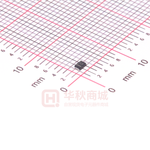

RB160VA-40 Diodes Schottky barrier diode RB160VA-40 Applications General rectification External dimensions (Unit : mm) 0.17±0.1    0 .0 5 1.3±0.05 Land size figure (Unit : mm) 1.1 1.9±0.1 2.5±0.2 Features 1) Small mold type. (TUMD2) 2) Low IF, Low IR. 3) High reliability. TUMD2 Structure Construction Silicon epitaxial planar 0.8±0.05 ROHM : TUMD2     0 .1 do t (year we ek fac to ry) + day 0.6±0.2 Taping specifications (Unit : mm) 4.0±0.1 2.0±0.05 1.75±0.1 φ1 .55±0.1       0 0.25±0.05 3.5±0.0 5 8.0±0.2 1.43±0.05 4.0±0.1 φ1.0±0.2      0 2.75 2.8±0.05 0.9±0.08 Absolute maximum ratings (Ta=25°C) Param eter Reverse voltage (repetitive peak) Reverse voltage (DC) Average rectified forward current Forward peak surge current(60Hz・1cyc) Junction tem perature Storage tem perature Electrical characteristics (Ta=25°C) Sym bol VRM VR Io IFSM Tj Tstg Lim its 40 40 1 5 150 -40 to +150 Unit V V A A ℃ ℃ Param eter Forward voltage Reverse current Sym bol VF IR Min. - Typ. 0.50 1.5 Max. 0.55 50 Unit V µA Conditions IF=700m A VR=40V Rev.B 0.8 0.5 2.0 1/3 RB160VA-40 Diodes Electrical characteristic curves (Ta=25°C) 1 Ta=150℃ 100000 Ta=150℃ Ta=125℃ 10000 1000 f=1MHz FORWARD CURRENT:IF(mA) REVERSE CURRENT:IR(uA) Ta=125℃ 0.1 Ta=75℃ Ta=25℃ 0.01 Ta=-25℃ 1000 100 10 1 0.1 0.01 0.001 Ta=-25℃ Ta=75℃ Ta=25℃ CAPACITANCE BETWEEN TERMINALS:Ct(pF) 100 10 0.001 0 100 200 300 4 00 500 FORWARD VOLTAGE:VF(mV) VF-IF CHARACTERISTICS 600 1 0 10 20 30 REVERSE VOLTAGE:VR(V) VR-IR CHARACTERISTICS 40 0 10 20 REVERSE VOLTAGE:VR(V) VR-Ct CHARACTERISTICS 30 530 30 Ta=25℃ IF=0.7A n=30pcs 200 Ta=25℃ VR=40V n=30pcs 190 180 170 160 150 140 130 120 110 100 AVE:121.1pF Ta=25℃ f=1MHz VR=0V n=10pcs FORWARD VOLTAGE:VF(mV) REVERSE CURRENT:IR(uA) 20 15 10 5 0 AVE:1.5772uA 510 500 490 480 AVE:501.9mV VF DISPERSION MAP CAPACITANCE BETWEEN TERMINALS:Ct(pF) 520 25 IR DISPERSION MAP Ct DISPERSION MAP 20 Ifsm 1cyc 20 30 PEAK SURGE FORWARD CURRENT:IFSM(A) PEAK SURGE FORWARD CURRENT:IFSM(A) PEAK SURGE FORWARD CURRENT:IFSM(A) Ifsm 15 8.3ms 8.3ms 1cyc 25 20 15 10 5 0 Ifsm t 15 8.3ms 10 10 5 AVE:15.6A 0 5 0 1 IFSM DISRESION MAP 10 NUMBER OF CYCLES IFSM-CYCLE CHARACTERISTICS 100 1 10 TIME:t(ms) IFSM-t CHARACTERISTICS 100 1000 Mounted on epoxy board IM=10mA IF=0.2A 1 0.9 0.8 Rth(j-a) D=1/2 Sin(θ=180) DC 0.3 TRANSIENT THAERMAL IMPEDANCE:Rth (℃/W) REVERSE POWER DISSIPATION:PR (W) FORWARD POWER DISSIPATION:Pf(W) 1ms time 300us 0.7 0.6 0.5 0.4 0.3 0.2 0.1 0.2 Sin(θ=180) D=1/2 0.1 DC 100 Rth(j-c) 10 0.001 0.1 10 1000 0 0 0.5 1 1.5 AVERAGE RECTIFIED FORWARD CURRENT:Io(A) Io-Pf CHARACTERISTICS 2 0 0 10 20 30 40 REVERSE VOLTAGE:VR(V) VR-PR CHARACTERISTICS TIME:t(s) Rth-t CHARACTERISTICS Rev.B 2/3 RB160VA-40 Diodes 2 0A 0V DC t T 1 Io VR D=t/T VR=20V Tj=150℃ 2 DC Sin(θ=180) 1.5 D=1/2 1 0A 0V t T 0 0 25 50 75 100 125 AMBIENT TEMPERATURE:Ta(℃) Derating Curve゙(Io-Ta) 150 0 0 25 50 75 100 125 150 CASE TEMPARATURE:Tc(℃) Derating Curve゙(Io-Tc) Io VR D=t/T VR=20V Tj=125℃ AVERAGE RECTIFIED FORWARD CURRENT:Io(A) 1.5 D=1/2 AVERAGE RECTIFIED FORWARD CURRENT:Io(A) 0.5 Sin(θ=180) 0.5 Rev.B 3/3 Appendix Notes No technical content pages of this document may be reproduced in any form or transmitted by any means without prior permission of ROHM CO.,LTD. The contents described herein are subject to change without notice. The specifications for the product described in this document are for reference only. Upon actual use, therefore, please request that specifications to be separately delivered. Application circuit diagrams and circuit constants contained herein are shown as examples of standard use and operation. Please pay careful attention to the peripheral conditions when designing circuits and deciding upon circuit constants in the set. Any data, including, but not limited to application circuit diagrams information, described herein are intended only as illustrations of such devices and not as the specifications for such devices. ROHM CO.,LTD. disclaims any warranty that any use of such devices shall be free from infringement of any third party's intellectual property rights or other proprietary rights, and further, assumes no liability of whatsoever nature in the event of any such infringement, or arising from or connected with or related to the use of such devices. Upon the sale of any such devices, other than for buyer's right to use such devices itself, resell or otherwise dispose of the same, no express or implied right or license to practice or commercially exploit any intellectual property rights or other proprietary rights owned or controlled by ROHM CO., LTD. is granted to any such buyer. Products listed in this document are no antiradiation design. The products listed in this document are designed to be used with ordinary electronic equipment or devices (such as audio visual equipment, office-automation equipment, communications devices, electrical appliances and electronic toys). Should you intend to use these products with equipment or devices which require an extremely high level of reliability and the malfunction of with would directly endanger human life (such as medical instruments, transportation equipment, aerospace machinery, nuclear-reactor controllers, fuel controllers and other safety devices), please be sure to consult with our sales representative in advance. About Export Control Order in Japan Products described herein are the objects of controlled goods in Annex 1 (Item 16) of Export Trade Control Order in Japan. In case of export from Japan, please confirm if it applies to "objective" criteria or an "informed" (by MITI clause) on the basis of "catch all controls for Non-Proliferation of Weapons of Mass Destruction. Appendix1-Rev1.1
