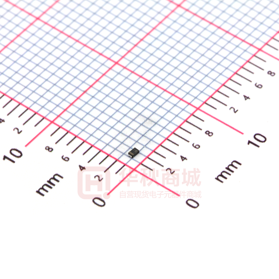

    肖特基二极管 Single VR=30V IF=30mA IR=500nA VMN2
RB751CS-40T2R 数据手册
Schottky Barrier Diode RB751CS-40 Datasheet lDimensions (Unit : mm) lApplication Low current rectification lLand size figure (Unit : mm) 0.55 0.16±0.05 0.45 0.6±0.05 2) Low VF 0.45 VMN2 e N co ew m m D es en ig de ns d f (VMN2) 1.0±0.05 0.9±0.05 1) Ultra Small mold type or 0.5 lFeatures lStructure 3) High reliability 0.156 Cathode 0.37±0.03 0.35±0.1 ROHM : VMN2 dot (year week factory)+day lConstruction Silicon epitaxial planar lTaping specifications (Unit : mm) Anode lAbsolute maximum ratings (Ta= 25°C) Symbol Limits Unit Reverse voltage (repetitive peak) VRM 40 V Reverse voltage (DC) VR 30 V Io 30 mA IFSM 200 mA Junction temperature Tj 125 °C Storage temperature Tstg -40 to +125 °C N ot R Parameter Average rectified forward current Forward current surge peak (60Hz・1cyc) lElectrical characteristics (Ta = 25°C) Parameter Conditions Symbol Min. Typ. Max. Unit Forward voltage VF - - 0.37 V IF=1mA Reverse current IR - - 0.5 mA VR=30V Capacitance between terminals Ct - 2 - pF VR=1V, f=1MHz www.rohm.com © 2013 ROHM Co., Ltd. All rights reserved. 1/5 2013.04 - Rev.B Data Sheet RB751CS-40 lElectrical characteristic curves 100000 Tj = 125°C 1 Tj = 25°C 0.1 Tj = -25°C 0.01 0.001 0 1000 Tj = 25°C 10 1 100 200 300 400 500 600 700 800 0 5 0 5 10 15 20 25 30 35 40 330 FORWARD VOLTAGE : VF(mV) R CAPACITANCE BETWEEN TERMINALS : Ct(pF) N ot 0.1 Tj = -25°C REVERSE VOLTAGE : VR(V) VR-IR CHARACTERISTICS f = 1MHz 1 Tj = 75°C 100 FORWARD VOLTAGE : VF(mV) VF-IF CHARACTERISTICS 10 Tj = 125°C 10000 or REVERSE CURRENT : IR(nA) Tj = 75°C 10 e N co ew m m D es en ig de ns d f FORWARD CURRENT : IF(mA) 100 10 15 20 25 320 310 AVE : 304.2mV 300 290 280 30 REVERSE VOLTAGE : VR(V) VR-Ct CHARACTERISTICS www.rohm.com © 2013 ROHM Co., Ltd. All rights reserved. Tj=25°C IF=1mA n=30pcs VF DISPERSION MAP 2/5 2013.04 - Rev.B Data Sheet RB751CS-40 lElectrical characteristic curves 1000 10 700 600 500 400 300 200 100 0 8 7 6 AVE : 111.0nA 5 4 3 1 0 1cyc. 5 AVE : 3.40A 0 Ct DISPERSION MAP REVERSE RECOVERY TIME : trr(ns) 8.3ms R 10 N ot PEAK SURGE FORWARD CURRENT : IFSM(A) IFSM 15 AVE : 1.81pF 2 IR DISPERSION MAP 20 or 800 Tj=25°C f=1MHz VR=0V n=10pcs 9 e N co ew m m D es en ig de ns d f REVERSE CURRENT : IR(nA) 900 CAPACITANCE BETWEEN TERMINALS : Ct(pF) Tj=25°C VR=30V n=30pcs IFSM DISPERSION MAP www.rohm.com © 2013 ROHM Co., Ltd. All rights reserved. 30 Tj=25°C IF=0.5A IR=1A Irr=0.25*IR n=10pcs 25 20 15 AVE : 11.7ns 10 5 0 trr DISPERSION MAP 3/5 2013.04 - Rev.B Data Sheet RB751CS-40 lElectrical characteristic curves 10 8.3ms 1cyc. 6 4 2 0 1 IFSM 8 or 8.3ms PEAK SURGE FORWARD CURRENT : IFSM(A) IFSM 8 time 6 e N co ew m m D es en ig de ns d f PEAK SURGE FORWARD CURRENT : IFSM(A) 10 10 4 2 0 100 1 NUMBER OF CYCLES IFSM-CYCLE CHARACTERISTICS TIME : t(ms) IFSM-t CHARACTERISTICS R Rth(j-c) 10 0.001 Mounted on glass epoxy board IM=10mA IF=100mA FORWARD POWER DISPERSION : PF (W) Rth(j-a) 100 100 0.05 N ot TRANSIENT THERMAL IMPEDANCE : Rth (°C/W) 1000 10 time 1ms 300ms 0.1 10 D = 1/2 0.03 Sin(θ=180) 0.02 0.01 0 1000 DC 0 0.01 0.02 0.03 0.04 0.05 AVERAGE RECTIFIED FORWARD CURRENT : Io(A) Io-PF CHARACTERISTICS TIME : t(s) Rth-t CHARACTERISTICS www.rohm.com © 2013 ROHM Co., Ltd. All rights reserved. 0.04 4/5 2013.04 - Rev.B Data Sheet RB751CS-40 lElectrical characteristic curves 0.002 Sin(θ=180) 0.001 0 0 10 20 30 t T DC D = 1/2 0.04 0.02 Sin(θ=180) 0 25 50 75 100 125 AMBIENT TEMPERATURE : Ta(°C) DERATING CURVE (Io-Ta) VR D=t/T VR=20V Tj=125°C R 0.06 DC D = 1/2 0.04 N ot AVERAGE RECTIFIED FORWARD CURRENT : Io(A) 0V VR D=t/T VR=20V Tj=125°C Io 0A 0.08 T 0.06 0 40 REVERSE VOLTAGE : VR(V) VR-PR CHARACTERISTICS 0.1 0.08 t e N co ew m m D es en ig de ns d f D = 1/2 0V or AVERAGE RECTIFIED FORWARD CURRENT : Io(A) REVERSE POWER DISPERSION : PR (W) DC Io 0A 0.1 0.003 0.02 0 Sin(θ=180) 0 25 50 75 100 125 CASE TEMPERATURE : Tc(°C) DERATING CURVE (Io-Tc) www.rohm.com © 2013 ROHM Co., Ltd. All rights reserved. 5/5 2013.04 - Rev.B Datasheet Notice Precaution on using ROHM Products Our Products are designed and manufactured for application in ordinary electronic equipments (such as AV equipment, OA equipment, telecommunication equipment, home electronic appliances, amusement equipment, etc.). If you (Note 1) , transport intend to use our Products in devices requiring extremely high reliability (such as medical equipment equipment, traffic equipment, aircraft/spacecraft, nuclear power controllers, fuel controllers, car equipment including car accessories, safety devices, etc.) and whose malfunction or failure may cause loss of human life, bodily injury or serious damage to property (“Specific Applications”), please consult with the ROHM sales representative in advance. Unless otherwise agreed in writing by ROHM in advance, ROHM shall not be in any way responsible or liable for any damages, expenses or losses incurred by you or third parties arising from the use of any ROHM’s Products for Specific Applications. or 1. ROHM designs and manufactures its Products subject to strict quality control system. However, semiconductor products can fail or malfunction at a certain rate. Please be sure to implement, at your own responsibilities, adequate safety measures including but not limited to fail-safe design against the physical injury, damage to any property, which a failure or malfunction of our Products may cause. The following are examples of safety measures: [a] Installation of protection circuits or other protective devices to improve system safety [b] Installation of redundant circuits to reduce the impact of single or multiple circuit failure 3. Our Products are designed and manufactured for use under standard conditions and not under any special or extraordinary environments or conditions, as exemplified below. Accordingly, ROHM shall not be in any way responsible or liable for any damages, expenses or losses arising from the use of any ROHM’s Products under any special or extraordinary environments or conditions. If you intend to use our Products under any special or extraordinary environments or conditions (as exemplified below), your independent verification and confirmation of product performance, reliability, etc, prior to use, must be necessary: [a] Use of our Products in any types of liquid, including water, oils, chemicals, and organic solvents [b] Use of our Products outdoors or in places where the Products are exposed to direct sunlight or dust [c] Use of our Products in places where the Products are exposed to sea wind or corrosive gases, including Cl2, H2S, NH3, SO2, and NO2 [d] Use of our Products in places where the Products are exposed to static electricity or electromagnetic waves [e] Use of our Products in proximity to heat-producing components, plastic cords, or other flammable items [f] Sealing or coating our Products with resin or other coating materials [g] Use of our Products without cleaning residue of flux (even if you use no-clean type fluxes, cleaning residue of flux is recommended); or Washing our Products by using water or water-soluble cleaning agents for cleaning residue after soldering [h] Use of the Products in places subject to dew condensation 4. The Products are not subject to radiation-proof design. 5. Please verify and confirm characteristics of the final or mounted products in using the Products. 6. In particular, if a transient load (a large amount of load applied in a short period of time, such as pulse. is applied, confirmation of performance characteristics after on-board mounting is strongly recommended. Avoid applying power exceeding normal rated power; exceeding the power rating under steady-state loading condition may negatively affect product performance and reliability. 7. De-rate Power Dissipation (Pd) depending on Ambient temperature (Ta). When used in sealed area, confirm the actual ambient temperature. 8. Confirm that operation temperature is within the specified range described in the product specification. 9. ROHM shall not be in any way responsible or liable for failure induced under deviant condition from what is defined in this document. ot R 2. N e N co ew m m D es en ig de ns d f (Note1) Medical Equipment Classification of the Specific Applications JAPAN USA EU CHINA CLASSⅢ CLASSⅡb CLASSⅢ CLASSⅢ CLASSⅣ CLASSⅢ Precaution for Mounting / Circuit board design 1. When a highly active halogenous (chlorine, bromine, etc.) flux is used, the residue of flux may negatively affect product performance and reliability. 2. In principle, the reflow soldering method must be used on a surface-mount products, the flow soldering method must be used on a through hole mount products. If the flow soldering method is preferred on a surface-mount products, please consult with the ROHM representative in advance. For details, please refer to ROHM Mounting specification Notice-PGA-E © 2015 ROHM Co., Ltd. All rights reserved. Rev.001 Datasheet Precautions Regarding Application Examples and External Circuits If change is made to the constant of an external circuit, please allow a sufficient margin considering variations of the characteristics of the Products and external components, including transient characteristics, as well as static characteristics. 2. You agree that application notes, reference designs, and associated data and information contained in this document are presented only as guidance for Products use. Therefore, in case you use such information, you are solely responsible for it and you must exercise your own independent verification and judgment in the use of such information contained in this document. ROHM shall not be in any way responsible or liable for any damages, expenses or losses incurred by you or third parties arising from the use of such information. Precaution for Electrostatic or 1. e N co ew m m D es en ig de ns d f This Product is electrostatic sensitive product, which may be damaged due to electrostatic discharge. Please take proper caution in your manufacturing process and storage so that voltage exceeding the Products maximum rating will not be applied to Products. Please take special care under dry condition (e.g. Grounding of human body / equipment / solder iron, isolation from charged objects, setting of Ionizer, friction prevention and temperature / humidity control). Precaution for Storage / Transportation 1. Product performance and soldered connections may deteriorate if the Products are stored in the places where: [a] the Products are exposed to sea winds or corrosive gases, including Cl2, H2S, NH3, SO2, and NO2 [b] the temperature or humidity exceeds those recommended by ROHM [c] the Products are exposed to direct sunshine or condensation [d] the Products are exposed to high Electrostatic 2. Even under ROHM recommended storage condition, solderability of products out of recommended storage time period may be degraded. It is strongly recommended to confirm solderability before using Products of which storage time is exceeding the recommended storage time period. 3. Store / transport cartons in the correct direction, which is indicated on a carton with a symbol. Otherwise bent leads may occur due to excessive stress applied when dropping of a carton. 4. Use Products within the specified time after opening a humidity barrier bag. Baking is required before using Products of which storage time is exceeding the recommended storage time period. Precaution for Product Label QR code printed on ROHM Products label is for ROHM’s internal use only. Precaution for Disposition When disposing Products please dispose them properly using an authorized industry waste company. Precaution for Foreign Exchange and Foreign Trade act Since concerned goods might be fallen under listed items of export control prescribed by Foreign exchange and Foreign trade act, please consult with ROHM in case of export. All information and data including but not limited to application example contained in this document is for reference only. ROHM does not warrant that foregoing information or data will not infringe any intellectual property rights or any other rights of any third party regarding such information or data. ot 1. R Precaution Regarding Intellectual Property Rights ROHM shall not have any obligations where the claims, actions or demands arising from the combination of the Products with other articles such as components, circuits, systems or external equipment (including software). 3. No license, expressly or implied, is granted hereby under any intellectual property rights or other rights of ROHM or any third parties with respect to the Products or the information contained in this document. Provided, however, that ROHM will not assert its intellectual property rights or other rights against you or your customers to the extent necessary to manufacture or sell products containing the Products, subject to the terms and conditions herein. N 2. Other Precaution 1. This document may not be reprinted or reproduced, in whole or in part, without prior written consent of ROHM. 2. The Products may not be disassembled, converted, modified, reproduced or otherwise changed without prior written consent of ROHM. 3. In no event shall you use in any way whatsoever the Products and the related technical information contained in the Products or this document for any military purposes, including but not limited to, the development of mass-destruction weapons. 4. The proper names of companies or products described in this document are trademarks or registered trademarks of ROHM, its affiliated companies or third parties. Notice-PGA-E © 2015 ROHM Co., Ltd. All rights reserved. Rev.001 Datasheet General Precaution 1. Before you use our Pro ducts, you are requested to care fully read this document and fully understand its contents. ROHM shall n ot be in an y way responsible or liabl e for fa ilure, malfunction or acci dent arising from the use of a ny ROHM’s Products against warning, caution or note contained in this document. 2. All information contained in this docume nt is current as of the issuing date and subj ect to change without any prior notice. Before purchasing or using ROHM’s Products, please confirm the la test information with a ROHM sale s representative. The information contained in this doc ument is provi ded on an “as is” basis and ROHM does not warrant that all information contained in this document is accurate an d/or error-free. ROHM shall not be in an y way responsible or liable for an y damages, expenses or losses incurred b y you or third parties resulting from inaccur acy or errors of or concerning such information. N ot R e N co ew m m D es en ig de ns d f or 3. Notice – WE © 2015 ROHM Co., Ltd. All rights reserved. Rev.001
