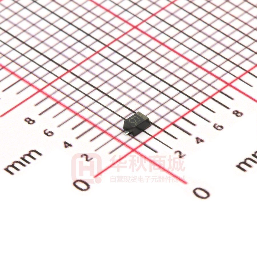

    整流二极管 VRRM=40V If=300mA VF=370mV CT=2pF SOD323
RB751V-40TE-17 数据手册
RB751V-40 Diodes Schottky barrier diode zLand size figure zExternal dimensions (Unit : mm) 0.1±0.1     0.05 1.25±0.1 e N co ew m m D es en ig de ns d f zApplications Low current rectification or RB751V-40 0.8MIN. 0.9MIN. 2.5±0.2 1.7±0.1 2.1 zFeatures 1) Ultra small mold type. (UMD2) 2) Low VF 3) High reliability UMD2 zConstruction Silicon epitaxial planar zStructure 0.7±0.2     0.1 0.3±0.05 ROHM : UMD2 JEDEC : S0D-323 JEITA : SC-90/A dot (year week factory) zTaping dimensions (Unit : mm) φ1.55±0.05 2.0±0.05 0.3±0.1 4.0±0.1 1.40±0.1 2.8±0.1 2.75 8.0±0.2 3.5±0.05 1.75±0.1 4.0±0.1 φ1.05 R 1.0±0.1 zAbsolute maximum ratings (Ta=25°C) Param eter Lim its Unit VRM Forward current s urge peak ( 60Hz・ 1cyc ) J unction tem perature S torage tem perature IFSM Tj Ts tg 40 30 30 200 125 -40 to +125 V V mA mA N ot Sym bol R evers e voltage (repetitive peak) Revers e voltage (DC) Average rectified forward current VR Io ℃ ℃ zElectrical characteristic (Ta=25°C) Param eter Forward voltage Sym bol Min. Typ. Max. Unit VF - - 0.37 V Conditions IF =1m A Revers e current IR - - 0.5 µA VR =30V Capacitance betw een term inal Ct - 2 - pF VR =1V , f=1MHz Rev.B 1/3 RB751V-40 Diodes zElectrical characteristic curves Ta=125℃ 1 Ta=-25℃ Ta=25℃ 0.01 0 Ta=75℃ 10 Ta=25℃ 1 0.1 Ta=-25℃ 0.01 1 e N co ew m m D es en ig de ns d f 0.1 CAPACITANCE BETWEEN TERMINALS:Ct(pF) Ta=75℃ f=1MHz 100 REVERSE CURRENT:IR(uA) 10 or Ta=125℃ FORWARD CURRENT:IF(mA) 10 1000 100 0.001 100 200 300 400 500 600 700 800 900 1000 0 FORWARD VOLTAGE:VF(mV) VF-IF CHARACTERISTICS 10 20 0.1 30 0 10 REVERSE VOLTAGE:VR(V) VR-IR CHARACTERISTICS 20 30 REVERSE VOLTAGE:VR(V) VR-Ct CHARACTERISTICS VF分布 260 700 600 500 400 300 200 AVE:267.4mV 250 100 0 0 PEAK SURGE FORWARD CURRENT:IFSM(A) 1cyc AVE:1.97pF 3 2 9 8.3ms 8.3ms 1cyc 10 AVE:7.30A 5 Ifsm 8 t 7 6 5 4 3 2 1 0 1 ot 10 100 0 1 NUMBER OF CYCLES IFSM-CYCLE CHARACTERISTICS 10 TIME:t(ms) IFSM-t CHARACTERISTICS 100 0.003 0.04 1000 Rth(j-a) Rth(j-c) 100 Mounted on epoxy board IM=10mA 10 1ms IF=100mA FORWARD POWER DISSIPATION:Pf(W) TRANSIENT THAERMAL IMPEDANCE:Rth (℃/W) 4 10 IFSM DISPERSION MAP N 5 Ct DISPERSION MAP Ifsm 15 R PEAK SURGE FORWARD CURRENT:IFSM(A) 5 6 0 20 8.3ms 10 7 IR DISPERSION MAP Ifsm 15 Ta=25℃ f=1MHz VR=1V n=10pcs 8 1 AVE:185.5nA VF DIPERSION MAP 20 9 CAPACITANCE BETWEEN TERMINALS:Ct(pF) 270 800 PEAK SURGE FORWARD CURRENT:IFSM(A) 280 Ta=25℃ VR=30V n=30pcs 900 0.03 REVERSE POWER DISSIPATION:PR (W) 290 10 1000 Ta=25℃ IF=1mA n=30pcs REVERSE CURRENT:IR(nA) FORWARD VOLTAGE:VF(mV) 300 D=1/2 Sin(θ=180) 0.02 DC 0.01 0.002 D=1/2 DC 0.001 Sin(θ=180) time 300us 1 0.001 0.00 0.1 10 TIME:t(s) Rth-t CHARACTERISTICS 1000 0 0.00 0.01 0.02 0.03 0.04 AVERAGE RECTIFIED FORWARD CURRENT Io(A) Io-Pf CHARACTERISTICS 0.05 0 10 20 30 REVERSE VOLTAGE:VR(V) VR-PR CHARACTERISTICS Rev.B 2/3 RB751V-40 Diodes 0.10 t 0.06 DC 0.04 D=1/2 0.02 T VR D=t/T VR=15V Tj=125℃ Sin(θ=180) 0 Io 0A 0V 0.08 t 0.06 DC 0.04 D=1/2 0.02 T VR D=t/T VR=15V Tj=125℃ or 0.08 AVERAGE RECTIFIED FORWARD CURRENT:Io(A) Io 0A 0V Sin(θ=180) e N co ew m m D es en ig de ns d f AVERAGE RECTIFIED FORWARD CURRENT:Io(A) 0.1 0.00 0 25 50 75 100 125 0 25 50 75 100 125 CASE TEMPARATURE:Tc(℃) Derating Curve゙(Io-Tc) N ot R AMBIENT TEMPERATURE:Ta(℃) Derating Curve゙(Io-Ta) Rev.B 3/3 Datasheet Notice Precaution on using ROHM Products Our Products are designed and manufactured for application in ordinary electronic equipments (such as AV equipment, OA equipment, telecommunication equipment, home electronic appliances, amusement equipment, etc.). If you (Note 1) , transport intend to use our Products in devices requiring extremely high reliability (such as medical equipment equipment, traffic equipment, aircraft/spacecraft, nuclear power controllers, fuel controllers, car equipment including car accessories, safety devices, etc.) and whose malfunction or failure may cause loss of human life, bodily injury or serious damage to property (“Specific Applications”), please consult with the ROHM sales representative in advance. Unless otherwise agreed in writing by ROHM in advance, ROHM shall not be in any way responsible or liable for any damages, expenses or losses incurred by you or third parties arising from the use of any ROHM’s Products for Specific Applications. or 1. ROHM designs and manufactures its Products subject to strict quality control system. However, semiconductor products can fail or malfunction at a certain rate. Please be sure to implement, at your own responsibilities, adequate safety measures including but not limited to fail-safe design against the physical injury, damage to any property, which a failure or malfunction of our Products may cause. The following are examples of safety measures: [a] Installation of protection circuits or other protective devices to improve system safety [b] Installation of redundant circuits to reduce the impact of single or multiple circuit failure 3. Our Products are designed and manufactured for use under standard conditions and not under any special or extraordinary environments or conditions, as exemplified below. Accordingly, ROHM shall not be in any way responsible or liable for any damages, expenses or losses arising from the use of any ROHM’s Products under any special or extraordinary environments or conditions. If you intend to use our Products under any special or extraordinary environments or conditions (as exemplified below), your independent verification and confirmation of product performance, reliability, etc, prior to use, must be necessary: [a] Use of our Products in any types of liquid, including water, oils, chemicals, and organic solvents [b] Use of our Products outdoors or in places where the Products are exposed to direct sunlight or dust [c] Use of our Products in places where the Products are exposed to sea wind or corrosive gases, including Cl2, H2S, NH3, SO2, and NO2 [d] Use of our Products in places where the Products are exposed to static electricity or electromagnetic waves [e] Use of our Products in proximity to heat-producing components, plastic cords, or other flammable items [f] Sealing or coating our Products with resin or other coating materials [g] Use of our Products without cleaning residue of flux (even if you use no-clean type fluxes, cleaning residue of flux is recommended); or Washing our Products by using water or water-soluble cleaning agents for cleaning residue after soldering [h] Use of the Products in places subject to dew condensation 4. The Products are not subject to radiation-proof design. 5. Please verify and confirm characteristics of the final or mounted products in using the Products. 6. In particular, if a transient load (a large amount of load applied in a short period of time, such as pulse. is applied, confirmation of performance characteristics after on-board mounting is strongly recommended. Avoid applying power exceeding normal rated power; exceeding the power rating under steady-state loading condition may negatively affect product performance and reliability. 7. De-rate Power Dissipation (Pd) depending on Ambient temperature (Ta). When used in sealed area, confirm the actual ambient temperature. 8. Confirm that operation temperature is within the specified range described in the product specification. 9. ROHM shall not be in any way responsible or liable for failure induced under deviant condition from what is defined in this document. ot R 2. N e N co ew m m D es en ig de ns d f (Note1) Medical Equipment Classification of the Specific Applications JAPAN USA EU CHINA CLASSⅢ CLASSⅡb CLASSⅢ CLASSⅢ CLASSⅣ CLASSⅢ Precaution for Mounting / Circuit board design 1. When a highly active halogenous (chlorine, bromine, etc.) flux is used, the residue of flux may negatively affect product performance and reliability. 2. In principle, the reflow soldering method must be used on a surface-mount products, the flow soldering method must be used on a through hole mount products. If the flow soldering method is preferred on a surface-mount products, please consult with the ROHM representative in advance. For details, please refer to ROHM Mounting specification Notice-PGA-E © 2015 ROHM Co., Ltd. All rights reserved. Rev.001 Datasheet Precautions Regarding Application Examples and External Circuits If change is made to the constant of an external circuit, please allow a sufficient margin considering variations of the characteristics of the Products and external components, including transient characteristics, as well as static characteristics. 2. You agree that application notes, reference designs, and associated data and information contained in this document are presented only as guidance for Products use. Therefore, in case you use such information, you are solely responsible for it and you must exercise your own independent verification and judgment in the use of such information contained in this document. ROHM shall not be in any way responsible or liable for any damages, expenses or losses incurred by you or third parties arising from the use of such information. Precaution for Electrostatic or 1. e N co ew m m D es en ig de ns d f This Product is electrostatic sensitive product, which may be damaged due to electrostatic discharge. Please take proper caution in your manufacturing process and storage so that voltage exceeding the Products maximum rating will not be applied to Products. Please take special care under dry condition (e.g. Grounding of human body / equipment / solder iron, isolation from charged objects, setting of Ionizer, friction prevention and temperature / humidity control). Precaution for Storage / Transportation 1. Product performance and soldered connections may deteriorate if the Products are stored in the places where: [a] the Products are exposed to sea winds or corrosive gases, including Cl2, H2S, NH3, SO2, and NO2 [b] the temperature or humidity exceeds those recommended by ROHM [c] the Products are exposed to direct sunshine or condensation [d] the Products are exposed to high Electrostatic 2. Even under ROHM recommended storage condition, solderability of products out of recommended storage time period may be degraded. It is strongly recommended to confirm solderability before using Products of which storage time is exceeding the recommended storage time period. 3. Store / transport cartons in the correct direction, which is indicated on a carton with a symbol. Otherwise bent leads may occur due to excessive stress applied when dropping of a carton. 4. Use Products within the specified time after opening a humidity barrier bag. Baking is required before using Products of which storage time is exceeding the recommended storage time period. Precaution for Product Label QR code printed on ROHM Products label is for ROHM’s internal use only. Precaution for Disposition When disposing Products please dispose them properly using an authorized industry waste company. Precaution for Foreign Exchange and Foreign Trade act Since concerned goods might be fallen under listed items of export control prescribed by Foreign exchange and Foreign trade act, please consult with ROHM in case of export. All information and data including but not limited to application example contained in this document is for reference only. ROHM does not warrant that foregoing information or data will not infringe any intellectual property rights or any other rights of any third party regarding such information or data. ot 1. R Precaution Regarding Intellectual Property Rights ROHM shall not have any obligations where the claims, actions or demands arising from the combination of the Products with other articles such as components, circuits, systems or external equipment (including software). 3. No license, expressly or implied, is granted hereby under any intellectual property rights or other rights of ROHM or any third parties with respect to the Products or the information contained in this document. Provided, however, that ROHM will not assert its intellectual property rights or other rights against you or your customers to the extent necessary to manufacture or sell products containing the Products, subject to the terms and conditions herein. N 2. Other Precaution 1. This document may not be reprinted or reproduced, in whole or in part, without prior written consent of ROHM. 2. The Products may not be disassembled, converted, modified, reproduced or otherwise changed without prior written consent of ROHM. 3. In no event shall you use in any way whatsoever the Products and the related technical information contained in the Products or this document for any military purposes, including but not limited to, the development of mass-destruction weapons. 4. The proper names of companies or products described in this document are trademarks or registered trademarks of ROHM, its affiliated companies or third parties. Notice-PGA-E © 2015 ROHM Co., Ltd. All rights reserved. Rev.001 Datasheet General Precaution 1. Before you use our Pro ducts, you are requested to care fully read this document and fully understand its contents. ROHM shall n ot be in an y way responsible or liabl e for fa ilure, malfunction or acci dent arising from the use of a ny ROHM’s Products against warning, caution or note contained in this document. 2. All information contained in this docume nt is current as of the issuing date and subj ect to change without any prior notice. Before purchasing or using ROHM’s Products, please confirm the la test information with a ROHM sale s representative. The information contained in this doc ument is provi ded on an “as is” basis and ROHM does not warrant that all information contained in this document is accurate an d/or error-free. ROHM shall not be in an y way responsible or liable for an y damages, expenses or losses incurred b y you or third parties resulting from inaccur acy or errors of or concerning such information. N ot R e N co ew m m D es en ig de ns d f or 3. Notice – WE © 2015 ROHM Co., Ltd. All rights reserved. Rev.001
