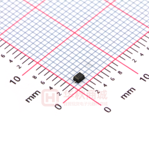

RN731V Diodes PIN diode RN731V Applications VHF / UHF band variable attenuators and AGC. Dimensions (Unit : mm) 1.25±0.1 0.1±0.1     0.05 Land size figure (Unit : mm) 0.9MIN. Features 1) Small mold type. (UMD2) 2) Low high-frequency forward resistance / low capacitance (CT). 0.8MIN. 1.7±0.1 2.5±0.2 U MD2 Construction Silicon epitaxial planar Structure 0.3±0.05 0.7±0.2     0.1 ROHM : UMD2 JEDEC : S0D-323 JEITA : SC-90/A dot (year week factory) Taping dimensions (Unit : mm) 4.0±0.1 2.0±0.05 φ1.55±0.05 1.75±0.1 0.3±0.1 3.5±0.05 8.0±0.2 1.40±0.1 4.0±0.1 φ1.05 1.0±0.1 Absolute maximum ratings (Ta=25°C) Parameter Reverse voltage (DC) Forward current (DC) Power dissipation Junction temperature Storage temperature Symbol VR IF Pd Tj Tstg Limits 50 50 100 125 -55 to +125 Unit V mA mW ℃ ℃ Electrical characteristics (Ta=25°C) Param eter Forward voltage Revers e current Capacitance between term inal High frequency res is tance S ym bol VF IR Ct Rf Min. Typ. Max. 1 0.1 0.4 7 Unit V µA pF Ω Conditions IF =50m A VR =50V VR =35V , f=1MHz IF =10m A,f=100MHz 2.75 2.8±0.1 Rev.C 2.1 1/2 RN731V Diodes Electrical characteristic curves (Ta=25°C) 100 1000 Ta=75℃ 100 REVERSE CURRENT:IR(nA) Ta=125℃ 1 f=1MHz CAPACITANCE BETWEEN TERMINALS:Ct(pF) 0.1 70 0 FORWARD CURRENT:IF(mA) 10 1 0.1 0.01 0.001 10 Ta=75℃ Ta=125℃ Ta=25℃ Ta=-25℃ Ta=25℃ 1 Ta=-25℃ 0.0001 0.1 0 100 200 300 400 500 600 700 800 900 1000 1100 0.00001 0 10 FORWARD VOLTAGE:VF(mV) VF-IF CHARACTERISTICS 20 30 40 50 60 REVERSE VOLTAGE:VR(V) VR-IR CHARACTERISTICS 5 10 15 20 25 REVERSE VOLTAGE:VR(V) VR-Ct CHARACTERISTICS 30 35 10000 1 FORWARD VOLTAGE:VF(mV) Ta=25℃ VR=0V 950 Ta=25℃ IF=50mA n=30pcs 1000 f=1MHz f=10MHz CAPACITANCE BETWEEN TERMINALS:Ct(pF) FORWARD OPERATING RESISTANCE:rf(Ω) 940 930 100 f=100MHz 10 920 AVE:930.5mV 910 1 0.01 0.1 0.1 1 FORWARD CURRENT:IF(mA) rf-IF CHARACTERISTICS 10 1 10 100 FREQUENCY(MHz) Ct-f CHARACTERISTICS 1000 900 VF DISPERSION MAP 50 45 REVERSE CURRENT:IR(nA) 40 35 30 25 20 15 10 5 0 IR DISPERSION MAP AVE:10.58nA Ta=25℃ VR=50V n=30pcs 0.5 Ta=25℃ f=1MHz VR=35V n=10pcs 5 Ta=25℃ f=100MHz IF=10mA n=10pcs CAPACITANCE BETWEEN TERMINALS:Ct(pF) FORWARD OPERATING RESISTANCE:rf(Ω) 0.4 4 0.3 3 0.2 2 0.1 AVE:0.203pF 0 Ct DISPERSION MAP 1 AVE:3.406Ω 0 FORWARD CURRENT:IF(mA) rf DISPERSION MAP 5 AVE:2.96kV ELECTROSTATIC DDISCHARGE TEST ESD(KV) 4 3 AVE:1.38kV 2 1 C=200pF R=0Ω C=100pF R=1.5kΩ 0 ESD DISPERSION MAP Rev.C 2/2 Appendix Notes No technical content pages of this document may be reproduced in any form or transmitted by any means without prior permission of ROHM CO.,LTD. The contents described herein are subject to change without notice. The specifications for the product described in this document are for reference only. Upon actual use, therefore, please request that specifications to be separately delivered. Application circuit diagrams and circuit constants contained herein are shown as examples of standard use and operation. Please pay careful attention to the peripheral conditions when designing circuits and deciding upon circuit constants in the set. Any data, including, but not limited to application circuit diagrams information, described herein are intended only as illustrations of such devices and not as the specifications for such devices. ROHM CO.,LTD. disclaims any warranty that any use of such devices shall be free from infringement of any third party's intellectual property rights or other proprietary rights, and further, assumes no liability of whatsoever nature in the event of any such infringement, or arising from or connected with or related to the use of such devices. Upon the sale of any such devices, other than for buyer's right to use such devices itself, resell or otherwise dispose of the same, no express or implied right or license to practice or commercially exploit any intellectual property rights or other proprietary rights owned or controlled by ROHM CO., LTD. is granted to any such buyer. Products listed in this document are no antiradiation design. The products listed in this document are designed to be used with ordinary electronic equipment or devices (such as audio visual equipment, office-automation equipment, communications devices, electrical appliances and electronic toys). Should you intend to use these products with equipment or devices which require an extremely high level of reliability and the malfunction of with would directly endanger human life (such as medical instruments, transportation equipment, aerospace machinery, nuclear-reactor controllers, fuel controllers and other safety devices), please be sure to consult with our sales representative in advance. About Export Control Order in Japan Products described herein are the objects of controlled goods in Annex 1 (Item 16) of Export Trade Control Order in Japan. In case of export from Japan, please confirm if it applies to "objective" criteria or an "informed" (by MITI clause) on the basis of "catch all controls for Non-Proliferation of Weapons of Mass Destruction. Appendix1-Rev1.1
