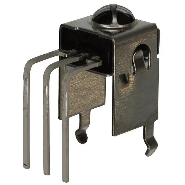

RPM7240-R series Photo Link Module IR Receiver Module RPM7240-R series RPM7240-R series are remote control receiver module. Small-sized, light-weight, and low voltage operated (from 2.7V) modules have been achieved by using resin mold. Center frequency 40.0kHz Applications All household electric appliances such as TV, DVD, air conditioner and audio equipment. Features 1) Low voltage operation. (VCC=2.7 to 3.6V) 2) Low current consumption. (ICC=0.3mA, VCC=3V) 3) Superior anti VCC noise characteristics. 4) 5 types of holders available to each set. RPM7240-R series SIDE VIEW RSIP-A3 (H13) Height to lens Products No. 15.0mm RPM7240-H13R RSIP-A3 (H5) 9.6mm RPM7240-H5R RSIP-A3 (H4) 15.9mm RPM7240-H4R TOP VIEW RSIP-A3 (H8) 7.2mm RPM7240-H8R RSIP-A3 (H9) 12.0mm RPM7240-H9R Absolute maximum ratings (Ta = 25°C) Parameter Supply Voltage Output current Storage temperature Operating temperature voltage Symbol VCC IO Tstg Topr Limits 6.3 2.0 −30 to +100 −10 to +75 Unit V mA °C °C Recommended operating conditions (Ta = 25°C) Parameter Supply voltage Symbol VCC Min. 2.7 Typ. 3.0 Max. 3.6 Unit V Rev.B 1/6 RPM7240-R series Photo Link Module Block diagram VCC 100kΩ AMP LIMITER Detector BPF Comparator ROUT I/V GND Terminal description Pin No. 1 2 3 Pin name VOUT GND VCC Function OUTPUT TERMINAL GROUND POWER SUPPLY Electrical, Optical characteristics (Unless otherwise noted, Ta = 25°C VCC=3V) Parameter Consumption Current Effective Distance High Level Output Voltage Low Level Output Voltage ON Pulse Width OFF Pulse Width Center frequency Horizontal half angle Vertical half angle Symbol ICC L VH VL TON TOFF fo θ 1/2 θ 1/2 Min. − 8 2.5 − 400 400 − − − Typ. 300 15 − − 600 600 40.0 45 35 Max. 500 − − 0.5 800 800 − − − Unit µA m V V µs µs kHz deg deg ∗2 ∗2 Isink < 200µA = Outer light condition Ee < 10 (Ix) Outer light condition Ee < 10 (Ix) Conditions No outside light, No signal input Outer light condition Ee < 10 (Ix) ∗1 ∗1 ∗1 ∗1 ∗1 ∗1 600/600µs burst wave is transmitted by standard transmitter. However, it must be measured after the initial transmission pulse is 10 pulse. ∗2 It is an angle when the linear arrival distance become half. Measurement Conditions (1) Transmit signal 600µs 600µs Carrier frequency=fo, Duty=50% Fig.1 Transmit signal Rev.B 2/6 RPM7240-R series Photo Link Module (2) Standard transmitter λ peak=940nm ∆ λ=40nm 20cm io=VOUT / R RPM-302B Standard transmitter R VOUT Fig.2 Measurement of standard transmitter proofreading When standard transmitter output the signal at Fig.1 standard photodiode output become io=5µAp-p under the measurement condition Fig.2. (The radiant intensity of standard transmitter : 50mW / sr) RPM-302B : standard photodiode has short current Isc=27µA at Ee=1000(lx) (using CIE standard light source A) (3) Measurement effective distance, horizontal & vertical half angle RPM7240-R series θ θ Standard transmitter Light detector face illuminance : Ee Effective distance : L (θ ; Indicates horizontal and vertical directions) Fig.3 Measurement condition for effective distance Effective distance L : Effective distance at θ=0° Fig.3 Horizontal & vertical half angle θ: The angle which effective distance became 50% of L. Rev.B 3/6 RPM7240-R series Photo Link Module (4) Output signal 600µs 600µs Transmit signal Carrier frequency=f0 Carrier Duty=50% VCC Output signal VH 1/2 VCC VL GND TON TOFF Fig.4 (5) Measurement circuit for the output voltage and the consumption current ICC A ROUT RPM7240-R GND V VH, VL VCC VCC Fig.5 Rev.B 4/6 RPM7240-R series Photo Link Module Notes (1) All characteristics of the receiver in this specification are specified by supplying burst wave form (Fig.1) with ROHM standard transmitter (Fig.2 ). If in case of other burst wave form will be used, please check these spec. Carefully under the evaluations. (2) When the receiver will be used as the wire-less remote controller, please use the signal method the signal format which refer to “Measures to prevent malfunctioning of IR remote-controlled electric home appliances”. (Published July 1987 by Association of Electric Home Appliances) If using other signal method, signal format, (ex: signal format which not including the leader signal) the receiver might have chances to miss-function. (3) Please set up transmitter’s carrier frequency as same as the receiver’s f0 frequency. Otherwise error might be occurred. (4) If transmission signal has non-continues carrier, error might be occurred. Continuous carrier is necessary. T1 T1≠T2 T2 (5) The receiver was designed to use as in-door use only. Therefore, please understand that the receiver cannot cover all characteristics, in case of using it out-door. (6) Noise environment (Light noise from inverter Lamp, and other kind of Lamps, Power ripple, electromagnetic noise from power circuit, and etc) may cause a reduced effective distance. (7) The receiver may not work properly if receiving signal judgment is done by single pulse due to the surrounding / environmental noises. To prevent such misjudgment, please make sure that the receiver is set up to work only when receiving series of coded signal. (8) Emitting unit (remote control transmitter) has to be considered about its emitting device function, characteristics and characteristics of the receiver. (9) Please connect ‘Holder’ on to the ‘Ground (GND)’ of PCB. If the holder is not connected to the GND, there is a possibility of worsening the characteristics of product. (10) Do not supply unnecessary stress to lead and holder. (11) Please pay careful attention to the lens. It might have a chance to miss-function when the lens get dust or dirty. And also please do not touch the lens. (12) In order to prevent products from ESD, human body and solder iron, etc. are required to be grounded. Rev.B 5/6 RPM7240-R series Photo Link Module Dimensions (Unit : mm) 9.0 6.0 1.8 7.3 15.0 17.95 7.30 7.20 3.60 0.65 7.95 0.4 3.6 7.00 2.95 3.6 9.25 123 1.4 1.4 4.6 6.3 0.6 0.5 0.6 2.54 2.54 2.54 1.80 2.54 0.30 RSIP-A3 (H13) RSIP-A3 (H8) 2.35 0.65 2.95 3.6 1.8 2.95 12.00 3.60 7.0 12.65 7.00 12.65 0.50 123 0.6 0.4 4.2 0.40 2.54 2.54 2.54 2.54 1.80 0.5 0.6 RSIP-A3 (H4) RSIP-A3 (H9) 9.0 6.0 1.8 7.3 12.55 3.6 2.95 Pin No. 0.5 0.6 0.6 0.4 2.5 1.4 1.4 4.6 6.3 Rout GND VCC 3.6 2.54 2.54 RSIP-A3 (H5) 1.0 0.30 0.60 0.60 1.40 1.40 3.60 1.4 1.4 0.65 2.35 15.9 7.30 7.3 0.60 0.60 0.40 2.5 0.50 3.60 1.40 1.40 2.35 Rev.B 6/6 Appendix Notes No technical content pages of this document may be reproduced in any form or transmitted by any means without prior permission of ROHM CO.,LTD. The contents described herein are subject to change without notice. The specifications for the product described in this document are for reference only. Upon actual use, therefore, please request that specifications to be separately delivered. Application circuit diagrams and circuit constants contained herein are shown as examples of standard use and operation. Please pay careful attention to the peripheral conditions when designing circuits and deciding upon circuit constants in the set. Any data, including, but not limited to application circuit diagrams information, described herein are intended only as illustrations of such devices and not as the specifications for such devices. ROHM CO.,LTD. disclaims any warranty that any use of such devices shall be free from infringement of any third party's intellectual property rights or other proprietary rights, and further, assumes no liability of whatsoever nature in the event of any such infringement, or arising from or connected with or related to the use of such devices. Upon the sale of any such devices, other than for buyer's right to use such devices itself, resell or otherwise dispose of the same, no express or implied right or license to practice or commercially exploit any intellectual property rights or other proprietary rights owned or controlled by ROHM CO., LTD. is granted to any such buyer. Products listed in this document are no antiradiation design. The products listed in this document are designed to be used with ordinary electronic equipment or devices (such as audio visual equipment, office-automation equipment, communications devices, electrical appliances and electronic toys). Should you intend to use these products with equipment or devices which require an extremely high level of reliability and the malfunction of with would directly endanger human life (such as medical instruments, transportation equipment, aerospace machinery, nuclear-reactor controllers, fuel controllers and other safety devices), please be sure to consult with our sales representative in advance. About Export Control Order in Japan Products described herein are the objects of controlled goods in Annex 1 (Item 16) of Export Trade Control Order in Japan. In case of export from Japan, please confirm if it applies to "objective" criteria or an "informed" (by MITI clause) on the basis of "catch all controls for Non-Proliferation of Weapons of Mass Destruction. Appendix1-Rev1.1
