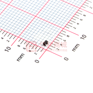

1.2V Drive Pch MOSFET RZE002P02 Structure Silicon P-channel MOSFET Features 1) High speed switching. 2) Small package (EMT3). 3) 1.2V drive. 0.2 0.5 0.5 Dimensions (Unit : mm) EMT3 1.6 0.3 (3) 0.7 0.55 0.8 (2) (1) 1.6 0.2 0.15 Applications Switching Package specifications Package Type RZE002P02 Code Basic ordering unit (pieces) Taping TL 3000 1.0 (1)Source (2)Gate (3)Drain Abbreviated symbol : YK Inner circuit (3) ∗2 (2) ∗1 (1) ∗1 ESD PROTECTION DIODE ∗2 BODY DIODE (1) Source (2) Gate (3) Drain Absolute maximum ratings (Ta=25°C) Parameter Drain-source voltage Gate-source voltage Drain current Souce current (Body diode) Total power dissipation Channel temperature Range of storage temperature ∗1 Pw≤10µs, Duty cycle≤1% ∗2 Each terminal mounted on a recommended land Continuous Pulsed Continuous Pulsed Symbol VDSS VGSS ID IDP ∗1 IS ISP ∗1 PD ∗2 Tch Tstg Limits −20 ±10 ±200 ±800 −100 −800 150 150 −55 to +150 Unit V V mA mA mA mA mW °C °C Thermal resistance Parameter Channel to ambient ∗ Each terminal mounted on a recommended land Symbol Rth(ch-a) ∗ Limits 833 Unit °C/W www.rohm.com c ○ 2009 ROHM Co., Ltd. All rights reserved. 1/4 2009.06 - Rev.A 0.1Min. RZE002P02 Electrical characteristics (Ta=25°C) Parameter Symbol Min. IGSS − Gate-source leakage Drain-source breakdown voltage V(BR) DSS −20 Zero gate voltage drain current − IDSS Gate threshold voltage VGS (th) −0.3 − − Static drain-source on-state RDS (on)∗ − resistance − − Forward transfer admittance Input capacitance Output capacitance Reverse transfer capacitance Turn-on delay time Rise time Turn-off delay time Fall time Total gate charge Gate-source charge Gate-drain charge ∗Pulsed Data Sheet Yfs Ciss Coss Crss td (on) tr td (off) tf Qg Qgs Qgd ∗ ∗ ∗ ∗ ∗ ∗ ∗ ∗ 0.2 − − − − − − − − − − Typ. − − − − 0.8 1.0 1.3 1.6 2.4 − 115 10 6 6 4 17 17 1.4 0.3 0.3 Max. ±10 − −1 −1.0 1.2 1.5 2.2 3.5 9.6 − − − − − − − − − − − Unit µA V µA V Ω Ω Ω Ω Ω S pF pF pF ns ns ns ns nC nC nC Conditions VGS= ±10V, VDS=0V ID= −1mA, VGS=0V VDS= −20V, VGS=0V VDS= −10V, ID= −100µA ID= −200mA, VGS= −4.5V ID= −100mA, VGS= −2.5V ID= −100mA, VGS= −1.8V ID= −40mA, VGS= −1.5V ID= −10mA, VGS= −1.2V VDS= −10V, ID= −200mA VDS= −10V VGS= 0V f=1MHz VDD −10V ID= −100mA VGS= −4.5V RL 100Ω RG= 10Ω VDD −10V RL 50Ω ID= −200mA RG= 10Ω VGS= −4.5V Body diode characteristics (Source-drain) Parameter Forward voltage ∗Pulsed Symbol VSD ∗ Min. − Typ. − Max. −1.2 Unit V Conditions IS= −200mA, VGS=0V www.rohm.com c ○ 2009 ROHM Co., Ltd. All rights reserved. 2/4 2009.06 - Rev.A RZE002P02 Electrical characteristics curves 0.2 VGS= -10V VGS= -4.5V VGS= -3.2V Ta=25°C Pulsed DRAIN CURRENT : -ID [A] 0.2 VGS= -4.5V 0.15 VGS= -2.5V VGS= -1.8V VGS= -1.5V VGS= -1.2V Ta=25°C Pulsed DRAIN CURRENT : -ID [A] 1 VDS= -10V Pulsed Data Sheet DRAIN CURRENT : -ID [A] 0.15 0.1 Ta= 125°C 0.01 Ta= 75°C Ta= 25°C Ta= - 25°C 0.1 VGS= -1.5V 0.05 VGS= -1.2V 0 0 0.2 0.4 0.6 VGS= -2.5V VGS= -2.0V VGS= -1.8V 0.1 0.05 VGS= -1.0V 0 0.001 VGS= -1.0V 0.0001 0 2 4 6 8 10 0 0.5 1 1.5 0.8 1 DRAIN-SOURCE VOLTAGE : -VDS[V] Fig.1 Typical Output Characteristics( Ⅰ) DRAIN-SOURCE VOLTAGE : -VDS[V] Fig.2 Typical Output Characteristics( Ⅱ) GATE-SOURCE VOLTAGE : -VGS[V] Fig.3 Typical Transfer Characteristics STATIC DRAIN-SOURCE ON-STATE RESISTANCE : RDS(ON)[mΩ] STATIC DRAIN-SOURCE ON-STATE RESISTANCE : RDS(ON)[mΩ] 10000 STATIC DRAIN-SOURCE ON-STATE RESISTANCE : RDS(ON)[mΩ] Ta=25°C Pulsed 10000 VGS= -4.5V Pulsed 10000 Ta=125°C Ta=75°C Ta=25°C Ta= -25°C VGS= -2.5V Pulsed Ta=125°C Ta=75°C Ta=25°C Ta= -25°C 1000 VGS= -1.2V VGS= -1.5V VGS= -1.8V VGS= -2.5V VGS= -4.5V 100 0.001 0.01 0.1 1 1000 1000 100 0.001 0.01 0.1 1 100 0.001 0.01 0.1 1 DRAIN-CURRENT : -ID [A] Fig.4 Static Drain-Source On-State Resistance vs. Drain Current( Ⅰ) DRAIN-CURRENT : -ID [A] Fig.5 Static Drain-Source On-State Resistance vs. Drain Current( Ⅱ) DRAIN-CURRENT : -ID [A] Fig.6 Static Drain-Source On-State Resistance vs. Drain Current( Ⅲ) STATIC DRAIN-SOURCE ON-STATE RESISTANCE : RDS(ON)[mΩ] STATIC DRAIN-SOURCE ON-STATE RESISTANCE : RDS(ON)[mΩ] 10000 Ta=125°C Ta=75°C Ta=25°C Ta= -25°C STATIC DRAIN-SOURCE ON-STATE RESISTANCE : RDS(ON)[mΩ] VGS= -1.8V Pulsed 10000 VGS= -1.5V Pulsed 10000 VGS= -1.2V Pulsed 1000 1000 Ta=125°C Ta=75°C Ta=25°C Ta= -25°C 1000 Ta=125°C Ta=75°C Ta=25°C Ta= -25°C 100 0.001 0.01 0.1 1 100 0.001 0.01 DRAIN-CURRENT : -ID [A] Fig.8 Static Drain-Source On-State Resistance vs. Drain Current( Ⅴ) 0.1 100 0.001 0.01 DRAIN-CURRENT : -ID [A] Fig.9 Static Drain-Source On-State Resistance vs. Drain Current( Ⅵ) 0.1 DRAIN-CURRENT : -ID [A] Fig.7 Static Drain-Source On-State Resistance vs. Drain Current( Ⅳ) www.rohm.com c ○ 2009 ROHM Co., Ltd. All rights reserved. 3/4 2009.06 - Rev.A RZE002P02 FORWARD TRANSFER ADMITTANCE : |Yfs| [S] 1.0 1 REVERSE DRAIN CURRENT : -Is [A] 5 STATIC DRAIN-SOURCE ON-STATE RESISTANCE : R DS(ON)[Ω] Data Sheet VDS= -10V Pulsed VGS=0V Pulsed Ta=25°C Pulsed 4 ID = -0.2A 3 ID = -0.01A 2 Ta=-25°C Ta=25°C Ta=75°C Ta=125°C 0.1 Ta=125°C Ta=75°C Ta=25°C Ta=-25°C 1 0.1 0.01 0.01 0.1 DRAIN-CURRENT : -ID [A] Fig.10 Forward Transfer Admittance vs. Drain Current 1 0 0.5 1 1.5 0 0 2 4 6 8 10 SOURCE-DRAIN VOLTAGE : -VSD [V] Fig.11 Reverse Drain Current vs. Sourse-Drain Voltage GATE-SOURCE VOLTAGE : -VGS[V] Fig.12 Static Drain-Source On-State Resistance vs. Gate Source Voltage 1000 td(off) SWITCHING TIME : t [ns] 100 tf GATE-SOURCE VOLTAGE : -VGS [V] 4 CAPACITANCE : C [pF] Ta=25°C VDD = -10V VGS=-4.5V R G=10Ω Pulsed 5 1000 Ta=25°C f=1MHz VGS=0V Ciss 100 3 2 Ta=25°C VDD = -10V VGS=-0.2V RG=10Ω Pulsed 0 0.5 1 1.5 10 10 Coss Crss 1 0.01 0.1 1 10 100 1 1 0.01 tr td(on) 0.1 DRAIN-CURRENT : -ID [A] 1 0 TOTAL GATE CHARGE : Qg [nC] Fig.14 Dynamic Input Characteristics DRAIN-SOURCE VOLTAGE : -VDS[V] Fig.15 Typical Capacitance vs. Drain-Source Voltage Fig.13 Switching Characteristics Measurement circuit Pulse Width VGS ID RL D.U.T. RG VDD VDS VGS 10% 50% 10% 90% 50% 10% 90% VDS 90% td(on) ton tr td(off) toff tf Fig.1-1 Switching Time Measurement Circuit Fig.1-2 Switching Waveforms VG VGS ID RL IG(Const.) RG D.U.T. VDD VDS Qg VGS Qgs Qgd Charge Fig.2-1 Gate Charge Measurement Circuit Fig.2-2 Gate Charge Waveform Notice This product might cause chip aging and breakdown under the large electrified environment. www.rohm.com c ○ 2009 ROHM Co., Ltd. All rights reserved. 4/4 2009.06 - Rev.A Notice Notes No copying or reproduction of this document, in part or in whole, is permitted without the consent of ROHM Co.,Ltd. The content specified herein is subject to change for improvement without notice. The content specified herein is for the purpose of introducing ROHM's products (hereinafter "Products"). If you wish to use any such Product, please be sure to refer to the specifications, which can be obtained from ROHM upon request. Examples of application circuits, circuit constants and any other information contained herein illustrate the standard usage and operations of the Products. The peripheral conditions must be taken into account when designing circuits for mass production. Great care was taken in ensuring the accuracy of the information specified in this document. However, should you incur any damage arising from any inaccuracy or misprint of such information, ROHM shall bear no responsibility for such damage. The technical information specified herein is intended only to show the typical functions of and examples of application circuits for the Products. ROHM does not grant you, explicitly or implicitly, any license to use or exercise intellectual property or other rights held by ROHM and other parties. ROHM shall bear no responsibility whatsoever for any dispute arising from the use of such technical information. The Products specified in this document are intended to be used with general-use electronic equipment or devices (such as audio visual equipment, office-automation equipment, communication devices, electronic appliances and amusement devices). The Products specified in this document are not designed to be radiation tolerant. While ROHM always makes efforts to enhance the quality and reliability of its Products, a Product may fail or malfunction for a variety of reasons. Please be sure to implement in your equipment using the Products safety measures to guard against the possibility of physical injury, fire or any other damage caused in the event of the failure of any Product, such as derating, redundancy, fire control and fail-safe designs. ROHM shall bear no responsibility whatsoever for your use of any Product outside of the prescribed scope or not in accordance with the instruction manual. The Products are not designed or manufactured to be used with any equipment, device or system which requires an extremely high level of reliability the failure or malfunction of which may result in a direct threat to human life or create a risk of human injury (such as a medical instrument, transportation equipment, aerospace machinery, nuclear-reactor controller, fuel-controller or other safety device). ROHM shall bear no responsibility in any way for use of any of the Products for the above special purposes. If a Product is intended to be used for any such special purpose, please contact a ROHM sales representative before purchasing. If you intend to export or ship overseas any Product or technology specified herein that may be controlled under the Foreign Exchange and the Foreign Trade Law, you will be required to obtain a license or permit under the Law. Thank you for your accessing to ROHM product informations. More detail product informations and catalogs are available, please contact us. ROHM Customer Support System http://www.rohm.com/contact/ www.rohm.com © 2009 ROHM Co., Ltd. All rights reserved. R0039A
