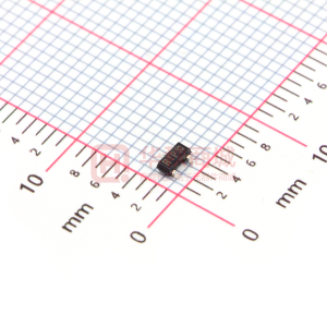

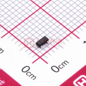

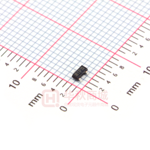

UMT2222A / SST2222A / MMST2222A Transistors NPN Medium Power Transistor (Switching) UMT2222A / SST2222A / MMST2222A Features 1) BVCEO > 40V (IC=10mA) 2) Complements the UMT2907A / SST2907A / MMST2907A. Dimensions (Unit : mm) UMT2222A ROHM : UMT3 EIAJ : SC-70 (1) Emitter (2) Base (3) Collector Package, marking, and packaging specifications Part No. Packaging type Marking Code Basic ordering unit (pieces) UMT2222A UMT3 R1P T106 3000 SST2222A MMST2222A SST3 R1P T116 3000 SMT3 R1P T146 3000 SST2222A ROHM : SST3 (1) Emitter (2) Base (3) Collector Absolute maximum ratings (Ta = 25°C) Parameter Collector-base voltage Collector-emitter voltage Emitter-base voltage Collector current UMT2222A,SST2222A, MMST2222A PC Tj Tstg Symbol VCBO VCEO VEBO IC Limits 75 40 6 0.6 0.2 0.35 150 −55 to +150 Unit V V V A W W °C °C MMST2222A ROHM : SMT3 EIAJ : SC-59 (1) Emitter (2) Base (3) Collector Collector power SST2222A dissipation Junction temperature Storage temperature ∗ ∗ When mounted on a 7 x 5 x 0.6 mm ceramic board Electrical characteristics (Ta = 25°C) Parameter Collector-base breakdown voltage Collector-emitter breakdown voltage Emitter-base breakdown voltage Collector cutoff current Emitter cutoff current Collector-emitter saturation voltage Base-emitter saturation voltage Symbol BVCBO BVCEO BVEBO ICBO IEBO VCE(sat) VBE(sat) Min. 75 40 6 − − − − 0.6 − 35 DC current transfer ratio hFE 50 75 50 100 Transition frequency Output capacitance Emitter input capacitance Delay time Rise time Storage time Fall time fT Cob Cib td tr tstg tf 40 300 − − − − − − Typ. − − − − − − − − − − − − − − − − − − − − − − Max. − − − 100 100 0.3 1 1.2 2 − − − − 300 − − 8 25 10 25 225 60 MHz pF pF ns ns ns ns − Unit V V V nA nA V V IC =10µA IC =10mA IE =10µA VCB = 60V VEB = 3V IC/IB =150mA/15mA IC/IB =500mA/50mA IC/IB =150mA/15mA IC/IB =500mA/50mA VCE =10V , IC =0.1mA VCE =10V , IC =1mA VCE =10V , IC =10mA VCE =1V , IC =150mA VCE =10V , IC =150mA VCE =10V , IC =500mA VCE =20V , IC =−20mA, f =100MHz VCB =10V , f =100kHz VEB =0.5V , f =100kHz VCC =30V , VBE(OFF) =0.5V , IC =150mA , IB1 =15mA VCC =30V , VBE(OFF) =0.5V , IC =150mA , IB1 =15mA VCC =30V , IC =150mA , IB1 =−IB2 =15mA VCC =30V , IC =150mA , IB1 =−IB2 =15mA Conditions Rev.A 1/3 UMT2222A / SST2222A / MMST2222A Transistors Electrical characteristic curves 100 COLLECTOR CURRENT : Ic(mA) Ta=25°C 600 500 400 1000 Ta=25°C DC CURRENT GAIN : hFE VCE=10V 50 300 200 100 100 1V 0 0 10 5 COLLECTOR-EMITTER VOLTAGE : VCE(V) IB=0µA 10 0.1 1.0 10 COLLECTOR CURRENT : Ic(mA) 100 1000 Fig.1 Grounded emitter output characteristics Fig.3 DC current gain vs. collector current(Ι) COLLECTOR EMITTER SATURATION VOLTAGE : VCE(sat)(V) Ta=25°C IC / IB=10 0.3 1000 VCE=10V DC CURRENT GAIN : hFE Ta=125°C 0.2 25°C −55°C 100 0.1 0 1.0 10 100 1000 COLLECTOR CURRENT : Ic(mA) 10 0.1 1.0 10 COLLECTOR CURRENT : Ic(mA) 100 1000 Fig.2 Collector-emitter saturation voltage vs. collector current Fig.4 DC current gain vs. collector current(ΙΙ) BASE EMITTER SATURATION VOLTAGE : VBE(sat)(V) 1000 1.8 1.6 Ta=25°C VCE=10V f=1kHz Ta=25°C IC / IB=10 AC CURRENT GAIN : hFE 1.2 100 0.8 0.4 10 0.1 0 1.0 1.0 10 COLLECTOR CURRENT : Ic(mA) 100 1000 10 100 1000 COLLECTOR CURRENT : Ic(mA) Fig.5 AC current gain vs. collector current Fig.6 Base-emitter saturation voltage vs. collector current Rev.A 2/3 UMT2222A / SST2222A / MMST2222A Transistors BASE EMITTER VOLTAGE : VBE(ON)(V) 1.8 1.6 Ta=25°C VCE=10V 1000 Ta=25°C IC / IB=10 500 Ta=25°C VCC=30V IC / IB=10 TURN ON TIME : ton(ns) 1.2 100 VCC=30V 10V 0.8 0.4 RISE TIME : tr(ns) 100 10 0 1 10 100 1000 COLLECTOR CURRENT : Ic(mA) 10 1.0 10 100 1000 COLLECTOR CURRENT : Ic(mA) 5 1.0 10 100 1000 COLLECTOR CURRENT : Ic(mA) Fig.7 Grounded emitter propagation characteristics Fig.8 Turn-on time vs. collector current Fig.9 Rise time vs. collector current 1000 Ta=25°C VCC=30V IC=10IB1=10IB2 1000 Ta=25°C VCC=30V IC=10IB1=10IB2 100 Ta=25°C f=1MHz STORAGE TIME : Ts(ns) CAPACITANCE(pF) FALL TIME : tf(ns) Cib 100 100 10 Cob 10 1.0 10 100 1000 COLLECTOR CURRENT : Ic(mA) 10 1.0 10 100 1000 COLLECTOR CURRENT : Ic(mA) 1 0.1 1.0 10 REVERSE BIAS VOLTAGE(V) 100 Fig.10 Storage time vs. collector current Fig.11 Fall time vs. collector current Fig.12 Input / output capacitance vs. voltage 100 COLLECTOR-EMITTER VOLTAGE : VCE(V) 100MHz 250MHz 300MHz 200MHz 10 1 250MHz 0.1 CURRENT GAIN-BANDWIDTH PRODUCT(MHz) Ta=25°C 1000 Ta=25°C VCE=10V 100 1 10 100 1000 COLLECTOR CURRENT : Ic(mA) 10 1.0 10 100 1000 COLLECTOR CURRENT : Ic(mA) Fig.13 Gain bandwidth product Fig.14 Gain bandwidth product vs. collector current Rev.A 3/3 Appendix Notes No technical content pages of this document may be reproduced in any form or transmitted by any means without prior permission of ROHM CO.,LTD. The contents described herein are subject to change without notice. The specifications for the product described in this document are for reference only. Upon actual use, therefore, please request that specifications to be separately delivered. Application circuit diagrams and circuit constants contained herein are shown as examples of standard use and operation. Please pay careful attention to the peripheral conditions when designing circuits and deciding upon circuit constants in the set. Any data, including, but not limited to application circuit diagrams information, described herein are intended only as illustrations of such devices and not as the specifications for such devices. ROHM CO.,LTD. disclaims any warranty that any use of such devices shall be free from infringement of any third party's intellectual property rights or other proprietary rights, and further, assumes no liability of whatsoever nature in the event of any such infringement, or arising from or connected with or related to the use of such devices. Upon the sale of any such devices, other than for buyer's right to use such devices itself, resell or otherwise dispose of the same, no express or implied right or license to practice or commercially exploit any intellectual property rights or other proprietary rights owned or controlled by ROHM CO., LTD. is granted to any such buyer. Products listed in this document are no antiradiation design. The products listed in this document are designed to be used with ordinary electronic equipment or devices (such as audio visual equipment, office-automation equipment, communications devices, electrical appliances and electronic toys). Should you intend to use these products with equipment or devices which require an extremely high level of reliability and the malfunction of which would directly endanger human life (such as medical instruments, transportation equipment, aerospace machinery, nuclear-reactor controllers, fuel controllers and other safety devices), please be sure to consult with our sales representative in advance. It is our top priority to supply products with the utmost quality and reliability. However, there is always a chance of failure due to unexpected factors. Therefore, please take into account the derating characteristics and allow for sufficient safety features, such as extra margin, anti-flammability, and fail-safe measures when designing in order to prevent possible accidents that may result in bodily harm or fire caused by component failure. ROHM cannot be held responsible for any damages arising from the use of the products under conditions out of the range of the specifications or due to non-compliance with the NOTES specified in this catalog. Thank you for your accessing to ROHM product informations. More detail product informations and catalogs are available, please contact your nearest sales office. ROHM Customer Support System www.rohm.com Copyright © 2007 ROHM CO.,LTD. THE AMERICAS / EUPOPE / ASIA / JAPAN Contact us : webmaster@ rohm.co. jp 21, Saiin Mizosaki-cho, Ukyo-ku, Kyoto 615-8585, Japan TEL : +81-75-311-2121 FAX : +81-75-315-0172 Appendix1-Rev2.0
