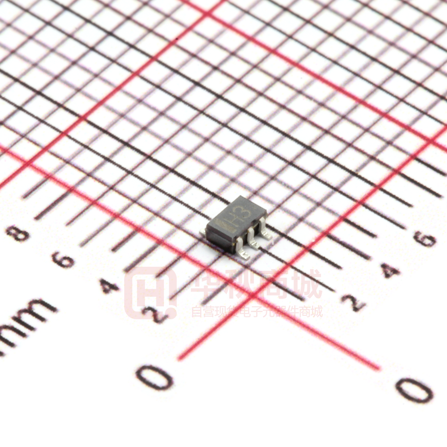

EMH3 / UMH3N / IMH3A Datasheet NPN 100mA 50V Complex Digital Transistors (Bias Resistor Built-in Transistors) Outline Parameter VCEO IC(MAX.) R1 Tr1 and Tr2 EMT6 UMT6 (6) (6) 50V 100mA 4.7k (5) (5) (4) (4) (1) (1) (2) (2) (3) (3) EMH3 (SC-107C) UMH3N SOT-363 (SC-88) SMT6 (4) Features (5) 1) Built-In Biasing Resistors. 2) Two DTC143T chips in one package. 3) Built-in bias resistors enable the configuration of an inverter circuit without connecting external input resistors (see inner circuit). 4) The bias resistors consist of thin-film resistors with complete isolation to allow negative biasing of the input. They also have the advantage of completely eliminating parasitic effects. 5) Only the on/off conditions need to be set for operation, making the circuit design easy. 6) Lead Free/RoHS Compliant. (6) (3) (2) (1) IMH3A SOT-457 (SC-74) Inner circuit IMH3A EMH3 / UMH3N Application Inverter circuit, Interface circuit, Driver circuit Collector (6) Base (5) Emitter (4) Collector (4) Base (5) Emitter (6) (1) Emitter (2) Base (3) Collector (3) Emitter (2) Base (1) Collector Packaging specifications Basic Reel size Tape width ordering (mm) (mm) unit (pcs) Package Package size (mm) Taping code EMH3 EMT6 1616 T2R 180 8 8,000 H3 UMH3N UMT6 2021 TN 180 8 3,000 H3 IMH3A SMT6 2928 T110 180 8 3,000 H3 Part No. www.rohm.com © 2014 ROHM Co., Ltd. All rights reserved. 1/6 Marking 2014.10 - Rev.C Data Sheet EMH3 / UMH3N / IMH3A Absolute maximum ratings (Ta = 25°C) Parameter Symbol Values Unit Collector-base voltage VCBO 50 V Collector-emitter voltage VCEO 50 V Emitter-base voltage VEBO 5 V IC(MAX.)*1 100 mA Collector current Collector Power dissipation EMH3 / UMH3N PD IMH3A Junction temperature Range of storage temperature *2 150 (Total) *3 mW 300 (Total) *4 mW Tj 150 °C Tstg 55 to 150 °C Electrical characteristics(Ta = 25°C) Parameter Symbol Collector-base breakdown voltage BVCBO Collector-emitter breakdown voltage Emitter-base breakdown voltage Min. Typ. Max. Unit IC= 50A 50 - - V BVCEO IC= 1mA 50 - - V BVEBO IE= 50A 5 - - V Collector cut-off current ICBO VCB = 50V - - 0.5 A Emitter cut-off current IEBO VEB = 4V - - 0.5 A IC / IB= 5mA / 0.25mA - - 0.15 V 100 250 600 - - 3.5 4.7 5.9 k VCE = 10V, IE = 5mA, f = 100MHz - 250 - MHz Collector-emitter saturation voltage VCE(sat) DC current gain hFE Input resistance R1 Transition frequency fT *1 Conditions VCE= 5V , IC= 1mA , *1 Characteristics of built-in transistor *2 Each terminal mounted on a reference footprint *3 120mW per element must not be exceeded. *4 200mW per element must not be exceeded. www.rohm.com © 2014 ROHM Co., Ltd. All rights reserved. 2/6 2014.10 - Rev.C Data Sheet EMH3 / UMH3N / IMH3A Electrical characteristic curves(Ta = 25°C) Fig.2 Grounded emitter output characteristics Fig.1 Grounded emitter propagation characteristics 100 10 Ta=25ºC COLLECTOR CURRENT : IC (mA) COLLECTOR CURRENT : Ic (mA) VCE=5V 1 0.1 Ta=100ºC 25ºC 40ºC 0.01 0.001 0 0.5 1 1.5 400μA 60 200μA 40 100μA 20 50μA 20 10 5 2 2m 5 10 1 lC/lB=20 500m 200m Ta=100°C 25°C −40°C 100m 50m 20m 10m 5m 2m 1m 100μ 200μ 500μ 1m 5m 10m 20m 50m100m 2m 5m 10m 20m 50m 100m COLLECTOR CURRENT : IC (mA) COLLECTOR CURRENT : IC (mA) www.rohm.com © 2014 ROHM Co., Ltd. All rights reserved. 0A 0 COLLECTOR TO EMITTER VOLTAGE : VCE (V) COLLECTOR SATURATION VOLTAGE : VCE(sat) (V) DC CURRENT GAIN : hFE Ta=100°C 25°C −40°C 1 100μ 200μ 500μ 1m 150μA Fig.4 Collector-emitter saturation voltage vs. Collector Current 200 50 250μA 0 VCE=5V 100 350μA 300μA 2 Fig.3 DC Current gain vs. Collector Current 500 450μA 80 BASE TO EMITTER VOLTAGE : VBE (V) 1k IB= 500μA 3/6 2014.10 - Rev.C Data Sheet EMH3 / UMH3N / IMH3A Dimensions (Unit : mm) D EMT6 A x c S A Lp Lp HE L E L b A1 y S l1 A e1 e S e b2 Patterm of terminal position areas  DIM A1 A b c D E e HE L Lp x y DIM e1 b2 l1 MILIMETERS MIN MAX 0.00 0.10 0.45 0.55 0.17 0.27 0.08 0.18 1.50 1.70 1.10 1.30 0.50 1.50 1.70 0.10 0.30 0.35 0.10 0.10 MILIMETERS MIN MAX 1.25 0.37 0.45 INCHES MIN 0 0.018 0.007 0.003 0.059 0.043 MAX 0.004 0.022 0.011 0.007 0.067 0.051 0.02 0.059 0.004 - 0.067 0.012 0.014 0.004 0.004 INCHES MIN MAX 0.049 - 0.015 0.018 Dimension in mm/inches www.rohm.com © 2014 ROHM Co., Ltd. All rights reserved. 4/6 2014.10 - Rev.C Data Sheet EMH3 / UMH3N / IMH3A Dimensions (Unit : mm) D A e c x Lp A3 S A e l1 A1 y S e1 A b HE E Q L1 UMT6 S b2 Patterm of terminal position areas  DIM A A1 A3 b c D E e HE L1 Lp Q x y DIM e1 b2 l1 MILIMETERS MIN MAX 0.80 1.00 0.00 0.10 0.25 0.15 0.30 0.10 0.20 1.90 2.10 1.15 1.35 0.65 2.00 2.20 0.20 0.50 0.25 0.55 0.10 0.30 0.10 0.10 MILIMETERS MIN MAX 1.55 0.40 0.65 INCHES MIN 0 MAX 0.039 0.004 0.01 0.006 0.004 0.075 0.045 0.012 0.008 0.083 0.053 0.03 0.079 0.008 0.01 0.004 - 0.087 0.02 0.022 0.012 0.004 0.004 INCHES MIN MAX 0.06 - 0.016 0.026 Dimension in mm/inches www.rohm.com © 2014 ROHM Co., Ltd. All rights reserved. 5/6 2014.10 - Rev.C Data Sheet EMH3 / UMH3N / IMH3A Dimensions (Unit : mm) SMT6 D A e c L1 Lp HE E Q b A3 x S A y S A1 l1 A e1 e S b2 Patterm of terminal position areas  DIM A A1 A3 b c D E e HE L1 Lp Q x y DIM e1 b2 l1 MILIMETERS MIN MAX 1.00 1.30 0.00 0.10 0.25 0.25 0.40 0.09 0.25 2.80 3.00 1.50 1.80 0.95 2.60 3.00 0.30 0.60 0.40 0.70 0.20 0.30 0.20 0.10 MILIMETERS MIN MAX 2.10 0.60 0.90 INCHES MIN 0.039 0 MAX 0.051 0.004 0.01 0.01 0.004 0.11 0.059 0.016 0.01 0.118 0.071 0.04 0.102 0.012 0.016 0.008 - 0.118 0.024 0.028 0.012 0.008 0.004 INCHES MIN MAX 0.08 - 0.024 0.035 Dimension in mm/inches www.rohm.com © 2014 ROHM Co., Ltd. All rights reserved. 6/6 2014.10 - Rev.C Notice Notes 1) The information contained herein is subject to change without notice. 2) Before you use our Products, please contact our sales representative and verify the latest specifications : 3) Although ROHM is continuously working to improve product reliability and quality, semiconductors can break down and malfunction due to various factors. Therefore, in order to prevent personal injury or fire arising from failure, please take safety measures such as complying with the derating characteristics, implementing redundant and fire prevention designs, and utilizing backups and fail-safe procedures. ROHM shall have no responsibility for any damages arising out of the use of our Poducts beyond the rating specified by ROHM. 4) Examples of application circuits, circuit constants and any other information contained herein are provided only to illustrate the standard usage and operations of the Products. The peripheral conditions must be taken into account when designing circuits for mass production. 5) The technical information specified herein is intended only to show the typical functions of and examples of application circuits for the Products. ROHM does not grant you, explicitly or implicitly, any license to use or exercise intellectual property or other rights held by ROHM or any other parties. ROHM shall have no responsibility whatsoever for any dispute arising out of the use of such technical information. 6) The Products are intended for use in general electronic equipment (i.e. AV/OA devices, communication, consumer systems, gaming/entertainment sets) as well as the applications indicated in this document. 7) The Products specified in this document are not designed to be radiation tolerant. 8) For use of our Products in applications requiring a high degree of reliability (as exemplified below), please contact and consult with a ROHM representative : transportation equipment (i.e. cars, ships, trains), primary communication equipment, traffic lights, fire/crime prevention, safety equipment, medical systems, servers, solar cells, and power transmission systems. 9) Do not use our Products in applications requiring extremely high reliability, such as aerospace equipment, nuclear power control systems, and submarine repeaters. 10) ROHM shall have no responsibility for any damages or injury arising from non-compliance with the recommended usage conditions and specifications contained herein. 11) ROHM has used reasonable care to ensur the accuracy of the information contained in this document. However, ROHM does not warrants that such information is error-free, and ROHM shall have no responsibility for any damages arising from any inaccuracy or misprint of such information. 12) Please use the Products in accordance with any applicable environmental laws and regulations, such as the RoHS Directive. For more details, including RoHS compatibility, please contact a ROHM sales office. ROHM shall have no responsibility for any damages or losses resulting non-compliance with any applicable laws or regulations. 13) When providing our Products and technologies contained in this document to other countries, you must abide by the procedures and provisions stipulated in all applicable export laws and regulations, including without limitation the US Export Administration Regulations and the Foreign Exchange and Foreign Trade Act. 14) This document, in part or in whole, may not be reprinted or reproduced without prior consent of ROHM. Thank you for your accessing to ROHM product informations. More detail product informations and catalogs are available, please contact us. ROHM Customer Support System http://www.rohm.com/contact/ www.rohm.com © 2014 ROHM Co., Ltd. All rights reserved. R1102A
