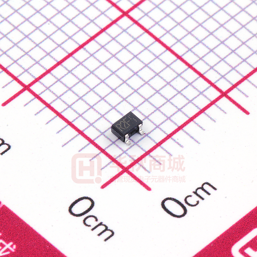

    通用三极管 PNP Ic=600mA Vceo=60V hfe=100~300 P=200mW UMT3
UMT2907AT106 数据手册
UMT2907A Datasheet PNP Medium Power Transistor (Switching) l Outline Parameter Value VCEO -60V IC -600mA   SOT-323     SC-70       UMT3 l Features 1)BVCEO<-60V (IC=-10mA)   l Inner circuit l Application AUDIO FREQUENCY SMALL SIGNAL AMPLIFIER                                             l Packaging specifications Part No. Package Package size Taping code UMT2907A SOT-323 (UMT3) 2021 T106 Reel size Tape width (mm) (mm) 180 8 Basic ordering unit.(pcs) Marking 3000 R2F l Absolute maximum ratings (Ta = 25°C) Parameter Symbol VCBO VCEO VEBO IC PD*1 Tj Tstg Collector-base voltage Collector-emitter voltage Emitter-base voltage Collector current Power dissipation Junction temperature Range of storage temperature Values Unit -60 -60 -5 -600 200 150 -55 to +150 V V V mA mW ℃ ℃                                                                                                                                                                                     www.rohm.com © 2016 ROHM Co., Ltd. All rights reserved. 1/4 20161025 - Rev.002     UMT2907A Datasheet l Electrical characteristics (Ta = 25°C) IC = -10μA Min. -60 Values Typ. - Max. - IC = -10mA -60 - - V IE = -10μA VCB = -50V VCE = -30V VEB = -3V VCE(sat)1 I C = -150mA, I B = -15mA -5 - - -100 -100 -100 -400 V nA nA nA mV VCE(sat)2*2 I C = -500mA, I B = -50mA VBE(sat)1 I C = -150mA, I B = -15mA - - -1.6 -1.3 V V VBE(sat)2*2 I C = -500mA, I B = -50mA - - -2.6 V Parameter Symbol Collector-base breakdown voltage Collector-emitter breakdown voltage Emitter-base breakdown voltage BVCBO BVCEO Collector cut-off current Emitter cut-off current Collector-emitter saturation voltage Base-emitter saturation voltage DC current gain Conditions BVEBO ICBO ICES IEBO Unit V hFE1 VCE = -10V, IC = -100μA 75 - - - hFE2 VCE = -10V, IC = -1mA 100 - - - hFE3 VCE = -10V, IC = -10mA 100 - - - hFE4*2 VCE = -10V, IC = -150mA 100 - 300 - hFE5*2 VCE = -10V, IC = -500mA 50 - - - Output capacitance Cob VCB = -10V, IE = 0A f = 100kHz - - 8 pF Input capacitance Cib VBE = -2V, IC = 0A f = 100kHz - - 30 pF Transition frequency fT VCE = -20V, IE = 50mA f = 100MHz 200 - - MHz Turn-On Delay time ton*2 - - 50 ns Delay time td*2 - - 10 ns Rise time tr*2 VCC ⋍ -30V, IC = -150mA IB1 = -15mA, RL = 200Ω VBE(off) = 500mV See test circuit - - 40 ns Turn-Off Delay time toff*2 - - 100 ns Storage time tstg*2 VCC ⋍ -30V IC = -150mA IB1 = -15mA IB2 = 15mA, RL = 200Ω See test circuit - - 80 ns - - 30 ns Fall time tf*2 *1 Each terminal mounted on a reference land. *2 Pulsed       www.rohm.com © 2016 ROHM Co., Ltd. All rights reserved.           2/4 20161025 - Rev.002     UMT2907A Datasheet SWITCHING TIME TEST CIRCUIT                                                                                             www.rohm.com © 2016 ROHM Co., Ltd. All rights reserved. 3/4 20161025 - Rev.002     UMT2907A Datasheet l Dimensions                                                                                             www.rohm.com © 2016 ROHM Co., Ltd. All rights reserved. 4/4 20161025 - Rev.002 Notice Precaution on using ROHM Products 1. Our Products are designed and manufactured for application in ordinary electronic equipments (such as AV equipment, OA equipment, telecommunication equipment, home electronic appliances, amusement equipment, etc.). If you (Note 1) intend to use our Products in devices requiring extremely high reliability (such as medical equipment , transport equipment, traffic equipment, aircraft/spacecraft, nuclear power controllers, fuel controllers, car equipment including car accessories, safety devices, etc.) and whose malfunction or failure may cause loss of human life, bodily injury or serious damage to property (“Specific Applications”), please consult with the ROHM sales representative in advance. Unless otherwise agreed in writing by ROHM in advance, ROHM shall not be in any way responsible or liable for any damages, expenses or losses incurred by you or third parties arising from the use of any ROHM’s Products for Specific Applications. (Note1) Medical Equipment Classification of the Specific Applications JAPAN USA EU CHINA CLASSⅢ CLASSⅡb CLASSⅢ CLASSⅢ CLASSⅣ CLASSⅢ 2. ROHM designs and manufactures its Products subject to strict quality control system. However, semiconductor products can fail or malfunction at a certain rate. Please be sure to implement, at your own responsibilities, adequate safety measures including but not limited to fail-safe design against the physical injury, damage to any property, which a failure or malfunction of our Products may cause. The following are examples of safety measures: [a] Installation of protection circuits or other protective devices to improve system safety [b] Installation of redundant circuits to reduce the impact of single or multiple circuit failure 3. Our Products are designed and manufactured for use under standard conditions and not under any special or extraordinary environments or conditions, as exemplified below. Accordingly, ROHM shall not be in any way responsible or liable for any damages, expenses or losses arising from the use of any ROHM’s Products under any special or extraordinary environments or conditions. If you intend to use our Products under any special or extraordinary environments or conditions (as exemplified below), your independent verification and confirmation of product performance, reliability, etc, prior to use, must be necessary: [a] Use of our Products in any types of liquid, including water, oils, chemicals, and organic solvents [b] Use of our Products outdoors or in places where the Products are exposed to direct sunlight or dust [c] Use of our Products in places where the Products are exposed to sea wind or corrosive gases, including Cl2, H2S, NH3, SO2, and NO2 [d] Use of our Products in places where the Products are exposed to static electricity or electromagnetic waves [e] Use of our Products in proximity to heat-producing components, plastic cords, or other flammable items [f] Sealing or coating our Products with resin or other coating materials [g] Use of our Products without cleaning residue of flux (even if you use no-clean type fluxes, cleaning residue of flux is recommended); or Washing our Products by using water or water-soluble cleaning agents for cleaning residue after soldering [h] Use of the Products in places subject to dew condensation 4. The Products are not subject to radiation-proof design. 5. Please verify and confirm characteristics of the final or mounted products in using the Products. 6. In particular, if a transient load (a large amount of load applied in a short period of time, such as pulse. is applied, confirmation of performance characteristics after on-board mounting is strongly recommended. Avoid applying power exceeding normal rated power; exceeding the power rating under steady-state loading condition may negatively affect product performance and reliability. 7. De-rate Power Dissipation depending on ambient temperature. When used in sealed area, confirm that it is the use in the range that does not exceed the maximum junction temperature. 8. Confirm that operation temperature is within the specified range described in the product specification. 9. ROHM shall not be in any way responsible or liable for failure induced under deviant condition from what is defined in this document. Precaution for Mounting / Circuit board design 1. When a highly active halogenous (chlorine, bromine, etc.) flux is used, the residue of flux may negatively affect product performance and reliability. 2. In principle, the reflow soldering method must be used on a surface-mount products, the flow soldering method must be used on a through hole mount products. If the flow soldering method is preferred on a surface-mount products, please consult with the ROHM representative in advance. For details, please refer to ROHM Mounting specification Notice-PGA-E © 2015 ROHM Co., Ltd. All rights reserved. Rev.003 Precautions Regarding Application Examples and External Circuits 1. If change is made to the constant of an external circuit, please allow a sufficient margin considering variations of the characteristics of the Products and external components, including transient characteristics, as well as static characteristics. 2. You agree that application notes, reference designs, and associated data and information contained in this document are presented only as guidance for Products use. Therefore, in case you use such information, you are solely responsible for it and you must exercise your own independent verification and judgment in the use of such information contained in this document. ROHM shall not be in any way responsible or liable for any damages, expenses or losses incurred by you or third parties arising from the use of such information. Precaution for Electrostatic This Product is electrostatic sensitive product, which may be damaged due to electrostatic discharge. Please take proper caution in your manufacturing process and storage so that voltage exceeding the Products maximum rating will not be applied to Products. Please take special care under dry condition (e.g. Grounding of human body / equipment / solder iron, isolation from charged objects, setting of Ionizer, friction prevention and temperature / humidity control). Precaution for Storage / Transportation 1. Product performance and soldered connections may deteriorate if the Products are stored in the places where: [a] the Products are exposed to sea winds or corrosive gases, including Cl2, H2S, NH3, SO2, and NO2 [b] the temperature or humidity exceeds those recommended by ROHM [c] the Products are exposed to direct sunshine or condensation [d] the Products are exposed to high Electrostatic 2. Even under ROHM recommended storage condition, solderability of products out of recommended storage time period may be degraded. It is strongly recommended to confirm solderability before using Products of which storage time is exceeding the recommended storage time period. 3. Store / transport cartons in the correct direction, which is indicated on a carton with a symbol. Otherwise bent leads may occur due to excessive stress applied when dropping of a carton. 4. Use Products within the specified time after opening a humidity barrier bag. Baking is required before using Products of which storage time is exceeding the recommended storage time period. Precaution for Product Label A two-dimensional barcode printed on ROHM Products label is for ROHM’s internal use only. Precaution for Disposition When disposing Products please dispose them properly using an authorized industry waste company. Precaution for Foreign Exchange and Foreign Trade act Since concerned goods might be fallen under listed items of export control prescribed by Foreign exchange and Foreign trade act, please consult with ROHM in case of export. Precaution Regarding Intellectual Property Rights 1. All information and data including but not limited to application example contained in this document is for reference only. ROHM does not warrant that foregoing information or data will not infringe any intellectual property rights or any other rights of any third party regarding such information or data. 2. ROHM shall not have any obligations where the claims, actions or demands arising from the combination of the Products with other articles such as components, circuits, systems or external equipment (including software). 3. No license, expressly or implied, is granted hereby under any intellectual property rights or other rights of ROHM or any third parties with respect to the Products or the information contained in this document. Provided, however, that ROHM will not assert its intellectual property rights or other rights against you or your customers to the extent necessary to manufacture or sell products containing the Products, subject to the terms and conditions herein. Other Precaution 1. This document may not be reprinted or reproduced, in whole or in part, without prior written consent of ROHM. 2. The Products may not be disassembled, converted, modified, reproduced or otherwise changed without prior written consent of ROHM. 3. In no event shall you use in any way whatsoever the Products and the related technical information contained in the Products or this document for any military purposes, including but not limited to, the development of mass-destruction weapons. 4. The proper names of companies or products described in this document are trademarks or registered trademarks of ROHM, its affiliated companies or third parties. Notice-PGA-E © 2015 ROHM Co., Ltd. All rights reserved. Rev.003 Datasheet UMT2907A - Web Page Buy Distribution Inventory Part Number Package Unit Quantity Minimum Package Quantity Packing Type Constitution Materials List RoHS UMT2907A UMT3 3000 3000 Taping inquiry Yes
