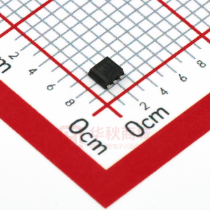

1.5V Drive Nch+Pch MOSFET US6M11 Structure Silicon N-channel MOSFET / Silicon P-channel MOSFET Dimensions (Unit : mm) TUMT6 Features 1) Nch MOSFET and Pch MOSFET are put in TUMT6 package. 2) Low on-resistance. 3) Low voltage drive (1.5V drive). 4) Built-in G-S Protection Diode. Abbreviated symbol : M11 Applications Switching Inner circuit (6) (5) (4) ∗1 Packaging specifications Package Type US6M11 (1) (2) (3) ∗1 ESD PROTECTION DIODE ∗2 BODY DIODE Taping TR 3000 ∗2 ∗2 Code Basic ordering unit (pieces) ∗1 (1) Tr1 (Nch) Source (2) Tr1 (Nch) Gate (3) Tr2 (Pch) Drain (4) Tr2 (Pch) Source (5) Tr2 (Pch) Gate (6) Tr1 (Nch) Drain Absolute maximum ratings (Ta=25°C) Parameter Drain-source voltage Gate-source voltage Drain current Source current (Body diode) Power dissipation Channel temperature Range of storage temperature ∗1 Pw≤10µs, Duty cycle≤1% ∗2 Mounted on a ceramic board. Symbol VDSS VGSS ID IDP ∗1 IS ISP ∗1 PD ∗2 Tch Tstg Continuous Pulsed Continuous Pulsed Limits Unit Tr1 : Nchannel Tr2 : Pchannel 20 V −12 ±10 V ±10 A ±1.3 ±1.5 A ±5.2 ±6 0.5 A −0.5 6 A −5.2 1.0 W / TOTAL 0.7 150 −55 to +150 W / ELEMENT °C °C Thermal resistance Parameter Channel to ambient ∗ Mounted on a ceramic board Symbol Rth(ch-a) ∗ Limits 125 179 Unit °C/W / TOTAL °C/W / ELEMENT www.rohm.com c ○ 2009 ROHM Co., Ltd. All rights reserved. 0.2Max. 1/7 2009.07 - Rev.A US6M11 Electrical characteristics (Ta=25°C) Parameter Symbol IGSS Gate-source leakage Drain-source breakdown voltage V(BR) DSS Zero gate voltage drain current IDSS Gate threshold voltage VGS (th) Static drain-source on-state resistance Forward transfer admittance Input capacitance Output capacitance Reverse transfer capacitance Turn-on delay time Rise time Turn-off delay time Fall time Total gate charge Gate-source charge Gate-drain charge ∗Pulsed Data Sheet RDS (on)∗ Yfs Ciss Coss Crss td (on) tr td (off) tf Qg Qgs Qgd ∗ ∗ ∗ ∗ ∗ ∗ ∗ ∗ Min. − 20 − 0.3 − − − − 1.6 − − − − − − − − − − Typ. − − − − 130 170 220 300 − 110 18 15 5 5 20 3 1.8 0.3 0.3 Max. ±10 − 1 1.0 180 240 310 600 − − − − − − − − − − − Unit µA V µA V mΩ mΩ mΩ mΩ S pF pF pF ns ns ns ns nC nC nC Conditions VGS= ±10V, VDS=0V ID= 1mA, VGS=0V VDS= 20V, VGS=0V VDS= 10V, ID= 1mA ID= 1.5A, VGS= 4.5V ID= 1.5A, VGS= 2.5V ID= 0.8A, VGS= 1.8V ID= 0.3A, VGS= 1.5V VDS= 10V, ID= 1.5A VDS= 10V VGS=0V f=1MHz VDD 10V ID= 1A VGS= 4.5V RL 10Ω RG=10Ω VDD 10V, VGS= 4.5V ID= 1.5A RL 6.7Ω, RG= 10Ω Body diode characteristics (Source-drain) (Ta=25°C) Parameter Forward voltage ∗Pulsed Symbol VSD ∗ Min. − Typ. − Max. 1.2 Unit V Conditions IS= 1.5A, VGS=0V Electrical characteristics (Ta=25°C) Parameter Symbol Min. IGSS − Gate-source leakage Drain-source breakdown voltage V(BR) DSS −12 Zero gate voltage drain current − IDSS Gate threshold voltage VGS (th) −0.3 − − Static drain-source on-state ∗ RDS (on) resistance − − Forward transfer admittance Yfs ∗ 1.4 Input capacitance − Ciss Output capacitance − Coss Reverse transfer capacitance Crss − Turn-on delay time td (on) ∗ − Rise time − tr ∗ Turn-off delay time − td (off) ∗ Fall time tf ∗ − Total gate charge − Qg ∗ Gate-source charge − Qgs ∗ Gate-drain charge − Qgd ∗ ∗Pulsed Typ. − − − − 190 280 400 530 − 290 28 21 8 10 30 9 2.4 0.6 0.4 Max. ±10 − −1 −1.0 260 390 600 1060 − − − − − − − − − − − Unit µA V µA V mΩ mΩ mΩ mΩ S pF pF pF ns ns ns ns nC nC nC Conditions VGS= ±10V, VDS=0V ID= −1mA, VGS=0V VDS= −12V, VGS=0V VDS= −6V, ID= −1mA ID= −1.3A, VGS= −4.5V ID= −0.6A, VGS= −2.5V ID= −0.6A, VGS= −1.8V ID= −0.2A, VGS= −1.5V VDS= −6V, ID= −1.3A VDS= −6V VGS= 0V f=1MHz VDD −6V ID= −0.6A VGS= −4.5V RL 10Ω RG= 10Ω VDD −6V, VGS= −4.5V ID= −1.3A RL 4.6Ω, RG= 10Ω Body diode characteristics (Source-drain) (Ta=25°C) Parameter Forward voltage ∗Pulsed Symbol VSD ∗ Min. − Typ. − Max. −1.2 Unit V Conditions IS= −1.3A, VGS=0V www.rohm.com c ○ 2009 ROHM Co., Ltd. All rights reserved. 2/7 2009.07 - Rev.A US6M11 Electrical characteristic curves 1.5 DRAIN CURRENT : ID [A] VGS= 10V VGS= 4.5V VGS= 2.5V Ta=25°C Pulsed DRAIN CURRENT : ID [A] 1.5 VGS= 4.5V VGS= 1.8V VGS= 1.5V 1 Ta=25°C Pulsed DRAIN CURRENT : ID [A] 10 VDS= 10V Pulsed Ta= 125°C Ta= 75°C Ta= 25°C Ta= - 25°C Data Sheet 1 1 VGS= 1.8V VGS= 1.5V 0.1 0.5 VGS= 1.3V 0.5 VGS= 1.1V 0 VGS= 1.3V 0.01 VGS= 1.2V 0 0 0.2 0.4 0.6 0.8 1 0.001 0 2 4 6 8 10 0 0.5 1 1.5 2 DRAIN-SOURCE VOLTAGE : VDS[V] Fig.1 Typical Output Characteristics( Ⅰ) DRAIN-SOURCE VOLTAGE : VDS[V] Fig.2 Typical Output Characteristics( Ⅱ) GATE-SOURCE VOLTAGE : VGS[V] Fig.3 Typical Transfer Characteristics 10000 STATIC DRAIN-SOURCE ON-STATE RESISTANCE : R DS(on)[mΩ] STATIC DRAIN-SOURCE ON-STATE RESISTANCE : R DS(on)[mΩ] STATIC DRAIN-SOURCE ON-STATE RESISTANCE : R DS(on)[mΩ] Ta= 25°C Pulsed 10000 VGS= 1.5V VGS= 1.8V VGS= 2.5V VGS= 4.5V VGS= 4.5V Pulsed Ta=125°C Ta=75°C Ta=25°C Ta= -25°C 10000 VGS= 2.5V Pulsed 1000 1000 1000 Ta=125°C Ta=75°C Ta=25°C Ta= -25°C 100 100 100 10 0.01 0.1 1 10 10 0.01 0.1 1 10 10 0.01 0.1 1 10 DRAIN-CURRENT : ID [A] Fig.4 Static Drain-Source On-State Resistance vs. Drain Current( Ⅰ) DRAIN-CURRENT : ID [A] Fig.5 Static Drain-Source On-State Resistance vs. Drain Current( Ⅱ) DRAIN-CURRENT : ID [A] Fig.6 Static Drain-Source On-State Resistance vs. Drain Current( Ⅲ) 10000 STATIC DRAIN-SOURCE ON-STATE RESISTANCE : R DS(on)[mΩ] STATIC DRAIN-SOURCE ON-STATE RESISTANCE : R DS(on)[mΩ] VGS= 1.8V Pulsed Ta=125°C Ta=75°C Ta=25°C Ta= -25°C 10000 FORWARD TRANSFER ADMITTANCE : |Yfs| [S] VGS= 1.5V Pulsed 10 1000 1000 Ta=125°C Ta=75°C Ta=25°C Ta= -25°C VDS= 10V Pulsed 1 Ta= -25°C Ta=25°C Ta=75°C Ta=125°C 100 100 10 0.01 0.1 1 10 10 0.01 0.1 1 10 0.1 0.01 0.1 1 10 DRAIN-CURRENT : ID [A] Fig.7 Static Drain-Source On-State Resistance vs. Drain Current( Ⅳ) DRAIN-CURRENT : ID [A] Fig.8 Static Drain-Source On-State Resistance vs. Drain Current( Ⅴ) DRAIN-CURRENT : ID [A] Fig.9 Forward Transfer Admittance vs. Drain Current www.rohm.com c ○ 2009 ROHM Co., Ltd. All rights reserved. 3/7 2009.07 - Rev.A US6M11 10 REVERSE DRAIN CURRENT : Is [A] VGS=0V Pulsed 600 STATIC DRAIN-SOURCE ON-STATE RESISTANCE : RDS(ON)[mΩ] 500 ID = 0.8A 400 ID = 1.5A 300 200 100 tr 0 0 0.5 1 1.5 0 2 4 6 8 10 1 0.01 0.1 1 10 Ta=25°C Pulsed SWITCHING TIME : t [ns] 1000 Ta=25°C VDD = 10V VGS=4.5V RG=10Ω Pulsed Data Sheet td(off) 100 tf 1 0.1 Ta=125°C Ta=75°C Ta=25°C Ta=-25°C 10 td(on) 0.01 SOURCE-DRAIN VOLTAGE : VSD [V] Fig.10 Reverse Drain Current vs. Sourse-Drain Voltage GATE-SOURCE VOLTAGE : VGS[V] Fig.11 Static Drain-Source On-State Resistance vs. Gate Source Voltage DRAIN-CURRENT : ID [A] Fig.12 Switching Characteristics 5 GATE-SOURCE VOLTAGE : VGS [V] 1000 CAPACITANCE : C [pF] 4 Ta=25°C f=1MHz VGS=0V Ciss 3 100 Coss Crss 2 Ta=25°C VDD = 10V ID = 1.5A RG=10Ω Pulsed 0 0.5 1 1.5 2 1 0 10 0.01 0.1 1 10 100 TOTAL GATE CHARGE : Qg [nC] Fig.13 Dynamic Input Characteristics DRAIN-SOURCE VOLTAGE : VDS[V] Fig.14 Typical Capacitance vs. Drain-Source Voltage www.rohm.com c ○ 2009 ROHM Co., Ltd. All rights reserved. 4/7 2009.07 - Rev.A US6M11 2 DRAIN CURRENT : -ID [A] Ta=25°C Pulsed 2 VGS= -10V VGS= -4.5V VGS= -2.5V VGS= -1.8V 1 VGS= -1.5V 0.5 VGS= -1.2V VGS= -4.5V VGS= -2.5V VGS= -1.8V Ta=25°C Pulsed DRAIN CURRENT : -ID [A] 10 VDS= -6V Pulsed Data Sheet 1.5 DRAIN CURRENT : -ID [A] 1.5 1 Ta= 125°C Ta= 75°C Ta= 25°C Ta= - 25°C 1 VGS= -1.5V VGS= -1.2V 0.1 0.5 VGS= -1.0V 0.01 0 0 0.2 0.4 0.6 0.8 1 0 0 2 4 6 8 10 0.001 0 0.5 1 1.5 2 DRAIN-SOURCE VOLTAGE : -VDS[V] Fig.1 Typical output characteristics( Ⅰ) DRAIN-SOURCE VOLTAGE : -VDS[V] Fig.2 Typical output characteristics( Ⅱ) GATE-SOURCE VOLTAGE : -VGS[V] Fig.3 Typical Transfer Characteristics STATIC DRAIN-SOURCE ON-STATE RESISTANCE : R DS(ON)[mΩ] STATIC DRAIN-SOURCE ON-STATE RESISTANCE : R DS(ON)[mΩ] Ta=25°C Pulsed STATIC DRAIN-SOURCE ON-STATE RESISTANCE : R DS(ON)[mΩ] 10000 10000 VGS= -4.5V Pulsed 10000 VGS= -2.5V Pulsed 1000 1000 1000 100 VGS= -1.5V VGS= -1.8V VGS= -2.5V VGS= -4.5V 100 Ta=125°C Ta=75°C Ta=25°C Ta= -25°C 0.1 1 10 100 Ta=125°C Ta=75°C Ta=25°C Ta= -25°C 0.1 1 10 10 0.01 0.1 1 10 10 0.01 10 0.01 DRAIN-CURRENT : -ID [A] Fig.4 Static Drain-Source On-State Resistance vs. Drain Current( Ⅰ) DRAIN-CURRENT : -ID [A] Fig.5 Static Drain-Source On-State Resistance vs. Drain Current( Ⅱ) DRAIN-CURRENT : -ID [A] Fig.6 Static Drain-Source On-State Resistance vs. Drain Current( Ⅲ) 10000 STATIC DRAIN-SOURCE ON-STATE RESISTANCE : R DS(ON)[mΩ] 1000 STATIC DRAIN-SOURCE ON-STATE RESISTANCE : R DS(ON)[mΩ] VGS= -1.8V Pulsed 10000 VGS= -1.5V Pulsed FORWARD TRANSFER ADMITTANCE : |Yfs| [S] 10 VDS= -6V Pulsed 1000 1 Ta= -25°C Ta=25°C Ta=75°C Ta=125°C 0.1 0.01 100 Ta=125°C Ta=75°C Ta=25°C Ta= -25°C 100 Ta=125°C Ta=75°C Ta=25°C Ta= -25°C 10 0.01 0.1 1 10 10 0.01 0.1 1 10 0.1 1 10 DRAIN-CURRENT : -ID [A] Fig.7 Static Drain-Source On-State Resistance vs. Drain Current( Ⅳ) DRAIN-CURRENT : -ID [A] Fig.8 Static Drain-Source On-State Resistance vs. Drain Current( Ⅳ) DRAIN-CURRENT : -ID [A] Fig.9 Forward Transfer Admittance vs. Drain Current www.rohm.com c ○ 2009 ROHM Co., Ltd. All rights reserved. 5/7 2009.07 - Rev.A US6M11 VGS=0V Pulsed STATIC DRAIN-SOURCE ON-STATE RESISTANCE : RDS(ON)[mΩ] 10 REVERSE DRAIN CURRENT : -Is [A] 600 500 400 300 200 100 tr 0.01 0 0.5 1 1.5 0 0 2 4 6 8 10 1 0.01 0.1 1 10 td(on) ID = -0.6A ID = -1.3A Ta=25°C Pulsed 1000 SWITCHING TIME : t [ns] tf 100 td(off) Data Sheet 1 Ta=25°C VDD = -6V VGS= -4.5V RG=10Ω Pulsed 0.1 Ta=125°C Ta=75°C Ta=25°C Ta=-25°C 10 SOURCE-DRAIN VOLTAGE : -VSD [V] Fig.10 Reverse Drain Current vs. Sourse-Drain Voltage GATE-SOURCE VOLTAGE : -VGS[V] Fig.11 Static Drain-Source On-State Resistance vs. Gate Source Voltage DRAIN-CURRENT : -ID [A] Fig.12 Switching Characteristics 5 GATE-SOURCE VOLTAGE : -VGS [V] 1000 4 CAPACITANCE : C [pF] 100 Ciss 3 2 1 Ta=25°C VDD = -6V ID = -1.3A RG=10Ω Pulsed 10 Coss Crss Ta=25°C f=1MHz VGS=0V 10 100 0 0 0.5 1 1.5 2 2.5 3 TOTAL GATE CHARGE : Qg [nC] Fig.13 Dynamic Input Characteristics 1 0.01 0.1 1 DRAIN-SOURCE VOLTAGE : -VDS[V] Fig.14 Typical Capacitance vs. Drain-Source Voltage www.rohm.com c ○ 2009 ROHM Co., Ltd. All rights reserved. 6/7 2009.07 - Rev.A US6M11 Measurement circuit VGS ID RL D.U.T. RG VDD VGS VDS 50% 10% 10% Data Sheet VDS Pulse Width 90% 50% 10% 90% td(on) ton tr td(off) toff 90% tr Fig.1-1 Switching Time Measurement Circuit Fig.1-2 Switching Waveforms VG VGS ID RL VDS Qg VGS Qgs Qgd IG (Const.) RG D.U.T. VDD Charge Fig.2-1 Gate Charge Measurement Circuit Fig.2-2 Gate Charge Waveform VGS ID RL D.U.T. RG VDD Pulse Width VDS VGS 10% 50% 10% 90% 50% 10% 90% VDS 90% td(on) ton tr td(off) toff tr Fig.3-1 Switching Time Measurement Circuit ID VGS RL IG(Const.) RG VDD D.U.T. Fig.3-2 Switching Waveforms VG VDS Qg VGS Qgs Qgd Charge Fig.4-1 Gate Charge Measurement Circuit Fig.4-2 Gate Charge Waveform Notice This product might cause chip aging and breakdown under the large electrified environment. Please consider to design ESD protection circuit. www.rohm.com c ○ 2009 ROHM Co., Ltd. All rights reserved. 7/7 2009.07 - Rev.A Notice Notes No copying or reproduction of this document, in part or in whole, is permitted without the consent of ROHM Co.,Ltd. The content specified herein is subject to change for improvement without notice. The content specified herein is for the purpose of introducing ROHM's products (hereinafter "Products"). If you wish to use any such Product, please be sure to refer to the specifications, which can be obtained from ROHM upon request. Examples of application circuits, circuit constants and any other information contained herein illustrate the standard usage and operations of the Products. The peripheral conditions must be taken into account when designing circuits for mass production. Great care was taken in ensuring the accuracy of the information specified in this document. However, should you incur any damage arising from any inaccuracy or misprint of such information, ROHM shall bear no responsibility for such damage. The technical information specified herein is intended only to show the typical functions of and examples of application circuits for the Products. ROHM does not grant you, explicitly or implicitly, any license to use or exercise intellectual property or other rights held by ROHM and other parties. ROHM shall bear no responsibility whatsoever for any dispute arising from the use of such technical information. The Products specified in this document are intended to be used with general-use electronic equipment or devices (such as audio visual equipment, office-automation equipment, communication devices, electronic appliances and amusement devices). The Products specified in this document are not designed to be radiation tolerant. While ROHM always makes efforts to enhance the quality and reliability of its Products, a Product may fail or malfunction for a variety of reasons. Please be sure to implement in your equipment using the Products safety measures to guard against the possibility of physical injury, fire or any other damage caused in the event of the failure of any Product, such as derating, redundancy, fire control and fail-safe designs. ROHM shall bear no responsibility whatsoever for your use of any Product outside of the prescribed scope or not in accordance with the instruction manual. The Products are not designed or manufactured to be used with any equipment, device or system which requires an extremely high level of reliability the failure or malfunction of which may result in a direct threat to human life or create a risk of human injury (such as a medical instrument, transportation equipment, aerospace machinery, nuclear-reactor controller, fuel-controller or other safety device). ROHM shall bear no responsibility in any way for use of any of the Products for the above special purposes. If a Product is intended to be used for any such special purpose, please contact a ROHM sales representative before purchasing. If you intend to export or ship overseas any Product or technology specified herein that may be controlled under the Foreign Exchange and the Foreign Trade Law, you will be required to obtain a license or permit under the Law. Thank you for your accessing to ROHM product informations. More detail product informations and catalogs are available, please contact us. ROHM Customer Support System http://www.rohm.com/contact/ www.rohm.com © 2009 ROHM Co., Ltd. All rights reserved. R0039A
