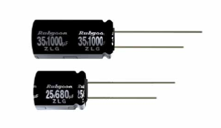

    RUBYCON(红宝石)
    插件,D5xL7mm
    直插铝电解电容 插件,D5xL7mm 47µF ±20% Ф5.00 x 7.00mm 10V 260mΩ 350mA 1000Hrs@105℃
10ZLG47MEFC5X7 数据手册
RADIAL LEAD ALUMINUM ELECTROLYTIC CAPACITORS ZLG ZLG SERIES 105℃ Ultra Low Impedance ・Load Life : 105℃ 1000∼5000 hours. RoHS compliance ◆SPECIFICATIONS Items Characteristics Category Temperature Range −40∼+105℃ Rated Voltage Range 6.3∼35Vdc Capacitance Tolerance ±20% (20℃, 120Hz) I=0.03CV or 3μA whichever is greater. (After 2 minutes) Leakage Current(MAX) I=Leakage Current(μA)     C=Capacitance(μF)     V=Rated Voltage(Vdc) Rated Voltage 120Hz) 6.3 10 16 25 35 (20℃, (Vdc) tanδ 0.22 0.19 0.16 0.14 0.12 Dissipation Factor(MAX) (tanδ) When capacitance is over 1000μF, tanδ shall be added 0.02 to the listed value with increase of every 1000μF. After applying rated voltage with rated ripple current for specified time at 105℃, the capacitors shall meet the following requirements. Within ±25% of the initial value. Dissipation Factor Not more than 200% of the specified value. Leakage Current Not more than the specified value. Rated Voltage 6.3 (Vdc) Z (−25℃) /Z (20℃) 2 Low Temperature Stability Impedance Ratio(MAX) Z (−40℃) /Z (20℃) 12 10 16 4.7∼10uF 22∼47uF 56∼100uF Coefficient 120∼270uF 330∼680uF 820∼1500uF 2200∼3900uF 35 2 2 2 2 12 10 8 6 L=7 φD≦6.3 φD= 8 L≧11 φD= 10 φD≧12.5 (120Hz) ◆DIMENSIONS ◆MULTIPLIER FOR RIPPLE CURRENT Frequency (Hz) 25 Life Time (hrs) 1000 2000 3000 4000 5000 Case Size Capacitance Change 120 1k 10k 100k≦ 0.15 0.18 0.27 0.49 0.55 0.60 0.70 0.53 0.70 0.73 0.73 0.77 0.80 0.85 0.80 0.90 0.92 0.92 0.94 0.96 0.98 1.00 1.00 1.00 1.00 1.00 1.00 1.00 (mm) SLEEVE(PET) φd L+α MAX 15MIN 〈L=7〉 φD φD+0.5MAX 4MIN 〈L≧11〉 4 φd F F ±0.5 Endurance 5 6.3 0.45 1.5 α 2.0 φD 2.5 1.0 ◆PART NUMBER 5 φd 6.3 8 0.5 10 12.5 0.6 F 2.0 α L≦16 : α=1.5 L≧20 : α=2.0 2.5 3.5 5.0 ◆OPTION □□□ ZLG □□□□□ M □□□ □□ D×L Rated Voltage Series Capacitance Capacitance Tolerance Option Lead Forming Case Size Code PET Sleeve EFC
