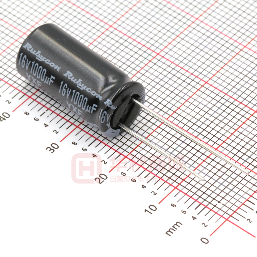

16YXF1000MFFC10X20
16YXF1000MFFC10X20
    RUBYCON(红宝石)
    插件,D10xL20mm
    直插铝电解电容 插件,D10xL20mm 1mF ±20% Ф10.00 x 20.00mm 16V 78mΩ 1.05A 7000Hrs@105℃
16YXF1000MFFC10X20 数据手册
小型铝电解电容器 YXF MINIATURE ALUMINUM ELECTROLYTIC CAPACITORS ဣଚ YXF SERIES 105ņ‫׊‬๱ం!‫گ‬ፆੇ೗ 105ņ Long Life, Low Impedance Ŕ༬ā‫׊‬NjFEATURES • RoHSኸସ‫ܔ‬ᆌ೗ • 105ņĂ4000ċ10000ၭ้೗ă RoHS compliance. Load Life : 105ņ 4000ċ10000 hours. • ߛೕፆੇࡀ߭ยۨă Prescribe Impedance value at 100 kHz. Ŕࡀ߭՗NjSPECIFICATIONS ༬āāāႠ ၜāణ Items ߾ ፕ ࿒ ‫ྷ ݔ ܈‬ Characteristics lj40ċLJ105ņ Category Temperature Range ‫ ۉ ۨ ܮ‬უ ‫ྷ ݔ‬ 6.3ċ100Vdc Rated Voltage Range ৢ ‫ ۉ‬ඹ ଉ ሎ Ⴙ ֶ Ġ20% (20ņLj120Hz) Capacitance Tolerance ၭᇀIǙ0.01CVࢅ3µAዐ‫ڦ‬ড‫ٷ‬ኵ!(แे‫ۉۨܮ‬უ2‫ݴ‬ዓࢫ) ୑ ‫ۉ‬ ୁ IǙ0.01CV or 3µA whichever is greater. (After 2 minutes) Leakage Current(MAX) I>୑‫(!ୁۉ‬µA) C>ৢ‫ۉ‬ඹଉ!(µF) V>‫ۉۨܮ‬უ!(Vdc) Capacitance Rated Voltage Leakage Current (20ņLj120Hz) ‫ۉۨܮ‬უ!(Vdc) 6.3 10 16 25 35 50 63 100 Rated Voltage tan˺ 0.22 0.19 0.16 0.14 0.12 0.10 0.09 0.08 ໦฿ঙኟൎኵ(tan˺) Dissipation Factor(MAX) ‫ܔ‬ᇀৢ‫ۉ‬ඹଉ‫ࡗג‬1000µF‫ׂڦ‬೗Ljഄৢ‫ۉ‬ඹଉ௅ሺे1000µFLjሶ໦฿ঙኟൎኵሞฉ՗ኵ‫ڦ‬ए‫إ‬ฉेฉ0.02ă When capacitance is over 1000µF, tan˺ shall be added 0.02 to the listed value with increase of every 1000µF. ሞ105ņ࣍ৣዐLjփ‫ۉۨܮࡗג‬უ‫ۨܮे۠ాྷݔڦ‬࿖հ‫ୁۉ‬Lj૶Ⴤेሜᆸ՗้क़ࢫLj஢ፁᅜူ߳ၜᄲ൱ă After applying rated voltage with rated ripple current for specified time at 105ņ, the capacitors shall meet the following requirements. Ⴀ ‫گ‬ ࿒ ༬ ‫ۉۨܮ‬უ!(Vdc) Rated Voltage Z(lj25ņ)/Z(20ņ) Ⴀ Low Temperature Stability (ፆ ੇ Բ) Z(lj40ņ)/Z(20ņ) Impedance Ratio(MAX) 6.3 10 16 ဣāຕ Coefficient 50 63 100 4 3 2 2 2 2 2 2 6 4 3 3 3 3 3 120 1k 10k 100k ļ 1uF 0.35 0.60 0.80 1.00 2.2ċ10uF 0.42 0.60 0.80 1.00 22ċ33uF 0.55 0.75 0.90 1.00 Frequency 35 8 Ŕ࿖հ‫ୁۉ‬ցኟဣຕNjMULTIPLIER FOR RIPPLE CURRENT ೕ୲ (Hz) 25 47ċ330uF 0.70 0.85 0.95 1.00 470ċ1000uF 0.75 0.90 0.98 1.00 2200ċ15000uF 0.80 0.95 1.00 1.00 ̋ Dļ6.3 ̋ DǙ8,10 ̋ DǙ12.5 (120Hz) Ŕ؅٫཮NjDIMENSIONS ̋d LLJ˷MAX ̋D ̋d F 6.3 5 8 0.5 2.0 ˷ ऻࡽ Code ̋ DLJ0.5MAX 4MIN 15MIN ŔޭऻࡽNjOPTION PET༫࠶āPET Sleeve (mm) ༫࠶ SLEEVE(PET) ± 0. 5 ৳ Endurance F ఱ ้क़(hrs) Life Time 6.3ċ10Vdc 16ċ100Vdc 5000 4000 7000 6000 10000 8000 ୩੕؅٫ Case Size ‫؛‬೺ኵ‫ڦ‬Ġ25%ᅜా Within Ġ25% of the initial value. ࡀ߭ኵ‫ڦ‬200%ᅜူ Not more than 200% of the specified value. ࡀ߭ኵᅜူ Not more than the specified value. ৢ ‫ ۉ‬ඹ ଉ Վ ࣅ ୲ Capacitance Change ໦ ฿ ঙ ኟ ൎ ኵ Dissipation Factor ୑ ‫ۉ‬ ୁ Leakage Current 2.5 10 12.5 0.6 3.5 5.0 16 18 0.8 7.5 Lļ16 : ˷=1.5 LĽ20 : ˷=2.0 EFC Ŕׂ೗႙ࡽ༹ဣNjPART NUMBER ŕŕŕ ‫ۉۨܮ‬უ YXF ဣଚఁ‫׬‬ ŕŕŕŕŕ ৢ‫ۉ‬ඹଉ N ৢ‫ۉ‬ඹଉሎႹֶ ŕŕŕ ޭऻࡽ ŕŕ ᆅ၍े߾ऻࡽ DġL ୩੕؅٫ Rated Voltage Series Capacitance Capacitance Tolerance Option Lead Forming Case Size 小型铝电解电容器 YXF MINIATURE ALUMINUM ELECTROLYTIC CAPACITORS ŔՔጚ೗ᅃબ՗NjSTANDARD SIZE ‫ۉۨܮ‬უ ྔႚ؅٫! ‫ۨܮ‬࿖հ‫ୁۉ‬ ፆੇ (ˮ MAX) ৢ‫ۉ‬ඹଉ Rated Impedance Size Rated ripple current Voltage Capacitance (µF) ̋ D×L(mm) (mA r.m.s./105ņ, 100kHz) 20ņ, 100kHz lj10ņ, 100kHz (Vdc) 6.3 10 16 25 35 100 220 330 470 1000 2200 3300 4700 6800 10000 15000 100 220 330 470 1000 2200 3300 4700 6800 10000 47 100 220 330 470 1000 2200 3300 4700 6800 33 47 100 220 330 470 1000 2200 3300 4700 33 47 100 220 330 470 1000 2200 3300 5ġ11 6.3ġ11 6.3ġ11 8ġ11.5 10ġ12.5 12.5ġ20 12.5ġ20 16ġ25 16ġ25 16ġ31.5 18ġ35.5 5ġ11 6.3ġ11 8ġ11.5 8ġ11.5 10ġ16 12.5ġ20 12.5ġ25 16ġ25 16ġ31.5 18ġ35.5 5ġ11 6.3ġ11 8ġ11.5 8ġ11.5 10ġ12.5 10ġ20 12.5ġ25 16ġ25 16ġ31.5 18ġ35.5 5ġ11 5ġ11 6.3ġ11 8ġ11.5 10ġ12.5 10ġ16 12.5ġ20 16ġ25 16ġ31.5 18ġ35.5 5ġ11 6.3ġ11 8ġ11.5 10ġ12.5 10ġ16 10ġ20 12.5ġ25 16ġ31.5 18ġ35.5 150 250 250 400 580 1300 1300 1850 1850 2000 2200 150 250 400 400 770 1300 1650 1850 2000 2200 150 250 400 400 580 1050 1650 1850 2000 2200 150 150 250 400 580 770 1300 1850 2000 2200 150 250 400 580 770 1050 1650 2000 2200 0.90 0.40 0.40 0.25 0.16 0.062 0.062 0.034 0.034 0.029 0.025 0.90 0.40 0.25 0.25 0.12 0.062 0.048 0.034 0.029 0.025 0.90 0.40 0.25 0.25 0.16 0.078 0.048 0.034 0.029 0.025 0.90 0.90 0.40 0.25 0.16 0.12 0.062 0.034 0.029 0.025 0.90 0.40 0.25 0.16 0.12 0.078 0.048 0.029 0.025 3.6 1.6 1.6 1.0 0.65 0.21 0.21 0.096 0.096 0.087 0.058 3.6 1.6 1.0 1.0 0.46 0.21 0.16 0.096 0.087 0.058 3.6 1.6 1.0 1.0 0.65 0.30 0.16 0.096 0.087 0.058 3.6 3.6 1.6 1.0 0.65 0.46 0.21 0.096 0.087 0.058 3.6 1.6 1.0 0.65 0.46 0.30 0.16 0.087 0.058 ‫ۉۨܮ‬უ! Rated Voltage (Vdc) 50 63 100 ྔႚ؅٫!‫ۨܮ‬࿖հ‫ ୁۉ‬ፆੇ (ˮ MAX) Impedance Size Rated ripple current Capacitance (µF) ̋ D×L(mm) (mA r.m.s./105ņ, 100kHz) 20ņ, 100kHz lj10ņ, 100kHz ৢ‫ۉ‬ඹଉ 1 2.2 3.3 4.7 10 22 33 47 100 220 330 470 1000 2200 10 22 33 47 100 220 330 470 1000 1 2.2 3.3 4.7 10 22 33 47 100 220 330 5ġ11 5ġ11 5ġ11 5ġ11 5ġ11 5ġ11 6.3ġ11 6.3ġ11 8ġ11.5 10ġ16 10ġ20 12.5ġ20 16ġ25 18ġ35.5 5ġ11 6.3ġ11 6.3ġ11 8ġ11.5 10ġ12.5 10ġ20 12.5ġ20 12.5ġ25 16ġ31.5 5ġ11 5ġ11 5ġ11 5ġ11 6.3ġ11 8ġ11.5 10ġ12.5 10ġ16 12.5ġ20 16ġ25 16ġ25 30 43 53 88 100 150 250 250 400 770 1050 1300 1850 2200 87 140 140 210 300 520 660 750 1390 20 30 40 65 140 160 230 290 430 900 900 4.0 2.5 2.2 1.9 1.5 0.90 0.40 0.40 0.25 0.12 0.078 0.062 0.034 0.025 2.3 1.3 1.2 0.63 0.43 0.21 0.16 0.12 0.054 4.5 3.0 2.7 2.5 1.2 0.63 0.43 0.31 0.16 0.073 0.073 8.0 6.0 5.6 5.0 4.0 3.6 1.6 1.6 1.0 0.46 0.30 0.21 0.096 0.058 9.3 5.2 5.0 2.8 1.8 0.84 0.64 0.45 0.20 15.0 13.0 11.0 10.0 5.0 2.8 1.8 1.5 0.64 0.27 0.27
