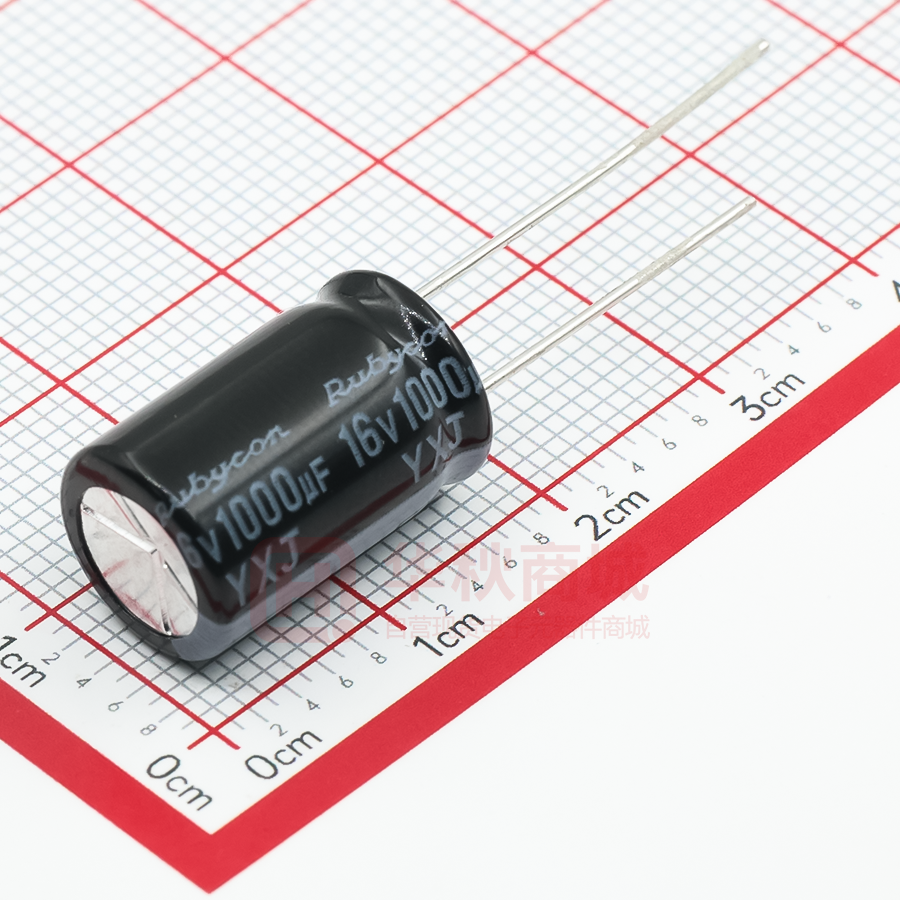

16YXJ1000MT810X16
16YXJ1000MT810X16
    RUBYCON(红宝石)
    插件,D10xL16mm
    1000UF ±20% 16V
16YXJ1000MT810X16 数据手册
        ! "  series 105# 4000$10000%&'()*(+,-' Load Life : 105# 4000$10000 hours. Miniaturized, Long Life RoHS compliance ./012SPECIFICATIONS  Item  Characteristics  Category Temperature Range -40 +105  Rated Voltage Range 6.3 100Vdc  Capacitance Tolerance  Leakage Current (MAX) ±20%20, 120Hz IQ0.01CVRS3TA#UVWXY4Z[.*+2\,) IQ0.01CV or 3TA whichever is greater.]] ]](After 2 minutes) I=TA C=TF V=Vdc Leakage Current Capacitance Rated Voltage KLM#NOtanP Dissipation Factor (MAX) (20, 120Hz)  (Vdc) Rated Voltage 6.3 10 16 25 35 50 63 100 tanP 0.22 0.19 0.16 0.14 0.12 0.10 0.09 0.08 1000TF0^_4`#S1000TFa3bcd"#Zc0.020+_eZ6347 When capacitance is over 1000TF, tanP shall be added 0.02 to the listed value with increase of every 1000TF. 105 !"#$%&'()*+,-./01234567 After applying rated voltage with rated ripple current for specified time at 105, the capacitors shall meet the following requirements. $%(hrs) Time(hrs) 6.3 10Vdc 16 100Vdc 4000 5000 oD=5 oD=6.3,8 6000 7000 8000 10000 oDp10 fgh ijZ#±25k[l 6.3Vdcm±30% Capacitance Change Within ±25k of the initial value6.3Vdcm±30%  Endurance KLM#NO Dissipation Factor  Leakage Current 8  Low Temperature Stability 9:;? Impedance Ratio (MAX) GH9A Case Size nZ# 200% [. Not more than 200% of the specified value. nZ[. Not more than the specified value.  (Vdc) Rated Voltage 6.3 10 16 25 35 50 63 100 Z(-25)/Z(+20) 4 3 2 2 2 2 2 2 Z(-40)/Z(+20) 8 6 4 3 3 3 3 3 (120Hz) .34562PART NUMBER  YXJ @
16YXJ1000MT810X16
1. 物料型号:YXJ系列 2. 器件简介:105℃下可工作4000至10000小时的小型长寿命电容器,符合RoHS标准。 3. 引脚分配:文档中未明确提供引脚分配信息,但通常径向电容器有引线作为电极。 4. 参数特性: - 工作温度范围:-40~+105°C - 额定电压范围:6.3~100Vdc - 电容公差:±20%(在20°C, 120Hz时) - 漏电流:在额定电压下,漏电流不超过0.01CV或3A(以较大者为准) - 损耗角正切(Dissipation Factor):随额定电压不同而变化,例如在6.3Vdc时为0.22,在100Vdc时为0.08 - 低温特性:在不同额定电压下,-25°C到+20°C的阻抗比(Impedance Ratio)不同,如6.3Vdc时为4,100Vdc时为2 5. 功能详解:文档提供了电容器的耐久性测试条件和结果,包括在105°C下应用额定电压和额定纹波电流后的电容变化率、损耗角正切和漏电流等。 6. 应用信息:文档中未明确提供应用信息,但根据参数特性,这些电容器适用于需要小型化和长寿命的场合。 7. 封装信息:提供了电容器的尺寸信息,包括直径(D)、引线直径(d)、高度(F)和最大长度(L+a)。
