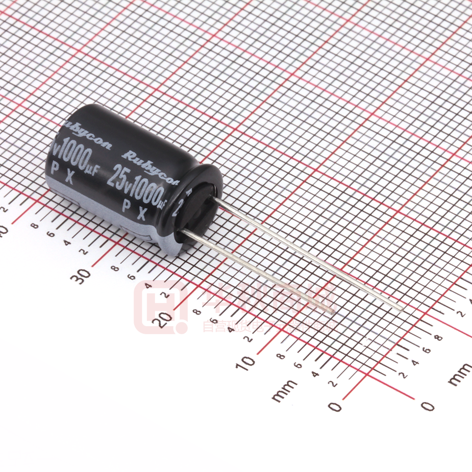

25PX1000MEFC10X16
25PX1000MEFC10X16
    RUBYCON(红宝石)
    插件,D10xL16mm
    直插铝电解电容 插件,D10xL16mm 1mF ±20% Ф10.00 x 16.00mm 25V 740mA 2000Hrs@105℃
25PX1000MEFC10X16 数据手册
小型铝电解电容器 PX MINIATURE ALUMINUM ELECTROLYTIC CAPACITORS ဣଚ! PX SERIES 105ņ Քጚ೗ 105ņ Standard !! • Ŕ༬ā‫׊‬NjFEATURES RoHSኸସ‫ܔ‬ᆌ೗ă RoHS compliance. Ŕࡀ߭՗NjSPECIFICATIONS ၜāణ! ༬āāāႠ Items ߾ ፕ ࿒ ‫! ྷ ݔ ܈‬ Category Temperature Range ‫ ۉ ۨ ܮ‬უ ‫! ྷ ݔ‬ Rated Voltage Range Characteristics lj55ċLJ105ņ lj40ċLJ105ņ lj25ċLJ105ņ 6.3ċ100Vdc 160ċ400Vdc 450Vdc ৢ ‫ ۉ‬ඹ ଉ ሎ Ⴙ ֶ ! Ġ20%(20ņ, 120Hz) Capacitance Tolerance 6.3ċ100Vdc 160ċ450Vdc CVļ1000 ၭᇀIǙ0.01CVࢅ3µAዐ‫ڦ‬ড‫ٷ‬ኵ ୑ ‫ۉ‬ ୁ! Leakage Current(MAX) Leakage Current ໦฿ঙኟൎኵ(tan˺) Dissipation Factor(MAX) CVǚ1000 I=0.1CVLJ40µAᅜူ(1‫ݴ‬ዓኵ) I=0.04CVLJ100µAᅜူ(1‫ݴ‬ዓኵ) IǙ0.01CV or 3µA whichever is greater. I=0.1CVLJ40µA (1minute) I=0.04CVLJ100µA (1minute) (แे‫ۉۨܮ‬უ2‫ݴ‬ዓࢫ) I=0.03CVLJ15µAᅜူ(5‫ݴ‬ዓኵ) I=0.02CVLJ25µAᅜူ(5‫ݴ‬ዓኵ) (After 2 minutes application of rated voltage) I=0.03CVLJ15µA (5minutes) I=0.02CVLJ25µA (5minutes) IǙ୑‫(!ୁۉ‬µA) ā CǙৢ‫ۉ‬ඹଉ!(µF) āVǙ‫ۉۨܮ‬უ!(Vdc) ā!Rated Voltage Capacitance ‫ۉۨܮ‬უ!(Vdc) 6.3 10 16 25 35 50 63 100 160 200 250 350 400 450 Rated Voltage tan˺ 0.28 0.24 0.20 0.16 0.14 0.12 0.10 0.08 0.20 0.20 0.20 0.25 0.25 0.25 (20ņ, 120Hz) ‫ܔ‬ᇀৢ‫ۉ‬ඹଉ‫ࡗג‬1000µF‫ׂڦ‬೗Ljഄৢ‫ۉ‬ඹଉ௅ሺे1000µFLjሶ໦฿ঙኟൎኵሞฉ՗ኵ‫ڦ‬ए‫إ‬ฉेฉ0.02ă When capacitance is over 1000µF, tan˺ shall be added 0.02 to the listed value with increase of every 1000µF. 105ņ࣍ৣዐLjփ‫ۉۨܮࡗג‬უ‫ۨܮे۠ాྷݔڦ‬࿖հ‫ୁۉ‬Lj૶Ⴤेሜᆸ՗้क़ࢫLj஢ፁᅜူ߳ၜᄲ൱ă Ⴀ! ‫گ‬ ࿒ ༬ Ⴀ! Low Temperature Stability (ፆ ੇ Բ) ‫ۉۨܮ‬უ!(Vdc) Rated Voltage Z(lj25ņ)/Z(20ņ) Z(lj40ņ)/Z(20ņ) Impedance Ratio(MAX) 6.3 10 Frequency 50 63 4 3 2 2 2 2 2 3 3 4 6 6 7 6 4 3 3 3 3 4 4 8 8 10 lj (120Hz) Ŕ؅٫཮NjDIMENSIONS ༫࠶! SLEEVE(PET) 1k 10kļ 0.50 0.65 0.80 0.80 0.80 1.20 1.20 1.20 1.10 1.05 1.30 1.30 1.30 1.15 1.10 1.50 1.50 1.50 1.20 1.15 ŔޭऻࡽNjOPTION F ऻࡽ Code EFC (mm) ̋d LLJ˷ MAX ̋D ̋d PET༫࠶āPET Sleeve 100 160 200 250 350 400 450 8 500 1.00 1.00 1.00 1.00 1.00 35 5 60(50) 120 0.47ċ1µF 2.2ċ4.7µF ဣ!!ຕ Coefficient 10ċ47µF 100ċ1000µF 2200ċ33000µF 25 10 Ŕ࿖հ‫ୁۉ‬ցኟဣຕNj! MULTIPLIER FOR RIPPLE CURRENT ೕ୲ (Hz) 16 ± 0.5 ৳ Endurance F ఱ After applying rated voltage with rated ripple current for specified time at 105ņ, the capacitors shall meet the following requirements. ৢ ‫ ۉ‬ඹ ଉ Վ ࣅ ୲ ! ‫؛‬೺ኵ‫ڦ‬Ġ25%ᅜా ୩੕؅٫! ้क़ (hrs) Within Ġ25% of the initial value. Capacitance Change Case Size Life Time ໦ ฿ ঙ ኟ ൎ ኵ ! ࡀ߭ኵ‫ڦ‬200%ᅜူ ̋ Dļ8 1000 Not more than 200% of the specified value. Dissipation Factor ࡀ߭ኵᅜူ! ୑ ‫ۉ‬ ୁ ! ̋ DĽ10 2000 Not more than the specified value. Leakage Current ˷! 5 6.3 ̋ DLJ0.5MAX 4MIN 15MIN 8 0.5 10 0.6 12.5 2.0 2.5 3.5 5.0 100Vᅜူ WVļ100:1.5 160Vᅜฉ WVĽ160:2.0 Ŕׂ೗႙ࡽ༹ဣNjPART NUMBER ŕŕŕ ‫ۉۨܮ‬უ! PX ဣଚఁ‫!׬‬ ŕŕŕŕŕ ৢ‫ۉ‬ඹଉ N ৢ‫ۉ‬ඹଉሎႹֶ! ŕŕŕ ޭऻࡽ! Rated Voltage Series Capacitance Capacitance Tolerance Option ŕŕ! DġL ᆅ၍े߾ऻࡽ! ୩੕؅٫! Lead Forming Case Size 16 18 0.8 7.5 2.0 小型铝电解电容器 PX MINIATURE ALUMINUM ELECTROLYTIC CAPACITORS ŔՔጚ೗ᅃબ՗NjSTANDARD SIZE ‫ۉۨܮ‬უ! Vdc ৢ‫ۉ‬ඹଉ Cap(µF) 6.3 Size 10 Ripple Size Size ̋ D×L(mm), Rated Ripple Current (mA r.m.s./105ņ, 120Hz) 16 Ripple Size 25 Ripple Size 35 Ripple Size 50 Ripple 63 Size Ripple 1 5×1 1 10 2.2 5×1 1 20 3.3 5×1 1 25 4.7 5×1 1 32 33 47 5×1 1 80 Ripple 5×1 1 47 5×11 48 5×1 1 64 5×1 1 70 5×11 80 10 22 Size 5×11 69 5×1 1 77 5×1 1 94 6.3×11 100 5×11 84 5×1 1 100 6.3×1 1 115 6.3×11 140 100 5×11 96 5×11 105 5×1 1 130 5×11 135 6.3×1 1 170 8×11.5 200 8×11.5 230 220 5×11 160 5×11 165 6.3×1 1 220 6.3×11 240 8×11.5 300 10×12.5 360 10×1 6 390 330 6.3×11 210 6.3×11 235 6.3×1 1 270 8×11.5 335 10×12.5 400 10×1 6 470 10×2 0 540 470 6.3×11 275 6.3×11 295 8×11.5 375 8×11.5 440 10×12.5 525 10×2 0 600 12. 5×2 0 700 680 6.3×11 285 8×11.5 430 8×11.5 480 10×12.5 630 10×1 6 760 12. 5×2 0 980 12. 5×2 5 800 1000 8×11.5 460 8×11.5 500 10×12.5 640 10×16 740 10×2 0 865 12. 5×2 5 1060 16×2 5 1200 2200 10×16 775 10×16 860 10×2 0 3300 10×20 985 10×20 4700 12. 5×20 1150 12. 5×20 6800 12. 5×25 1480 16×25 1700 10000 16×25 1700 16×25 15000 16×31.5 2090 16×35.5 22000 18×31.5 2280 18×35.5 2180 33000 18×40 ‫ۉۨܮ‬უ Vdc ৢ‫ۉ‬ඹଉ Cap(µF) 1050 12. 5×20 1090 16×2 5 1370 16×31.5 1600 18×31.5 1100 12. 5×2 0 1300 16×25 1500 16×2 5 1680 18×35.5 1780 1350 12. 5×2 5 1650 16×25 1800 16×35.5 1870 1900 16×35.5 1910 18×35.5 1920 1950 16×31.5 1950 18×35.5 2050 2090 18×35.5 2070 16×2 5 1400 2350 100 160 Size Ripple Size 1 5×1 1 15 2.2 5×1 1 21 3.3 5×1 1 30 4.7 5×1 1 35 6.3×11 10 5×1 1 60 8×11.5 22 6.3×1 1 98 33 8×11.5 47 8×11.5 100 200 Ripple Size 250 Ripple 0.47 Size 350 400 Ripple Size Ripple 6.3×11 8 6.3×11 8 6.3×11 16 6.3×11 6.3×11 30 6.3×11 450 Size Ripple Size Ripple 16 6.3×11 16 6.3×11 15 6.3×11 25 8×11.5 31 8×11.5 20 30 8×11.5 30 8×11.5 34 10×12.5 33 6.3×11 36 43 6.3×11 40 8×11.5 45 8×11.5 45 10×12.5 42 10×12.5 35 77 8×11.5 57 10×12.5 90 10×16 95 10×16 64 10×20 37 10×12.5 92 10×16 105 10×16 105 12. 5×20 175 12. 5×20 140 12. 5×25 100 140 10×16 125 10×20 140 10×20 140 12. 5×25 220 16×25 170 16×25 125 185 10×20 150 10×20 195 12. 5×20 190 16×25 260 16×25 200 16×31.5 155 10×1 6 290 12. 5×25 320 16×25 340 16×25 310 18×31.5 370 18×35.5 310 18×40 200 220 12. 5×2 0 560 16×31.5 410 16×35.5 580 18×35.5 485 330 12. 5×2 5 690 18×31.5 570 18×40 675 470 16×2 5 880 18×40 855 680 16×31.5 900 1000 18×35.5 985
