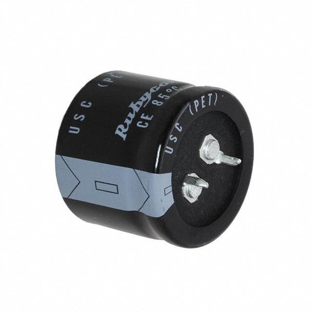

USC LARGE CAN TYPE ALUMINUM ELECTROLYTIC CAPACITORS USC SERIES 85oC Standard, Snap-in Terminal Type FEATURES • Load Life : 85°C 3000 hours. • Smaller size with higher ripple current endurance than USR series. • RoHS compliance. SPECIFICATIONS Items Characteristics Category Temperature Range -40 ∼ +85°C -25 ∼ +85°C Rated Voltage Range 10∼ 250V.DC 315∼ 450V.DC + 20%(20°C,120Hz) - Capacitance Tolerance I=3 CV Leakage Current(MAX) Dissipation (tanδ) (After 5 minutes application of rated voltage) I=Leakage Current(µA)     V=Rated Voltage(V)     C=Rated Capacitance(µF) Factor(MAX) tanδ 16 25 35 10∼250 Rated Voltage(V) Impedance Ratio(MAX) (20°C,120Hz) 100 160∼ 420∼ 400 450 0.55 0.50 0.45 0.40 0.35 0.30 0.25 0.20 0.15 0.25 Rated Voltage(V) 10 50 63 80 315∼400 420∼450 Z(-25°C)/Z(20°C) 3 8 12 Z(-40°C)/Z(20°C) 12 − − (120Hz) www.BDTIC.com/Rubycon After applying rated voltage with rated ripple current for 3000hrs at 85°C, the capacitors shall meet the following requirements. Endurance Capacitance Change + 20% of the initial value. Within - Dissipation Factor Not more than 200% of the specified value. Leakage Current Not more than the specified value. MULTIPLIER FOR RIPPLE CURRENT  Frequency coefficient Frequency(Hz) Coefficient 60(50) 120 500 1k < 10k = 10∼100WV 0.90 1.00 1.05 1.10 1.15 160∼250WV 0.80 1.00 1.20 1.30 1.50 315∼450WV 0.80 1.00 1.20 1.25 1.40 PART NUMBER USC Rated Voltage Series Rated Capacitance Capacitance Tolerance SN D ×L Terminal Code Case Size DIMENSIONS Option Code PET Sleeve without plate EFC PVC Sleeve without plate OOE PVC Sleeve with plate Option Blank (mm) SN[4(3.5)mm]terminal type 2-φ 2 SLEEVE NEGATIVE 10 VENT +0.1 10 - ∗ +2 L - + 0.5 4- ∗ + 0.5 For φ 35, 3.5 - +1 φD- +1 φDMOUNTING HOLES USC LARGE CAN TYPE ALUMINUM ELECTROLYTIC CAPACITORS STANDARD SIZE Cap (µF) WV φD 8200 10000 12000 15000 18000 22000 27000 33000 39000 47000 56000 68000 82000 Cap (µF) WV φD 3300 3900 4700 5600 6800 8200 10000 12000 15000 18000 22000 27000 33000 39000 47000 Cap (µF) WV φD 1500 1800 2200 2700 3300 3900 4700 5600 6800 8200 10000 12000 15000 18000 Cap (µF) WV φD 680 820 1000 1200 1500 1800 2200 2700 3300 3900 4700 5600 6800 8200 10000 φ 20 20×25 20×30 20×35 20×40 2.22 2.44 22×25 2.90 22×30 3.31 22×35 22×40 22×45 22×50 φ 20 20×25 20×30 20×35 20×40 φ 22 2.41 2.88 3.22 3.79 4.04 4.58 φ 22 2.33 2.56 22×25 2.56 2.91 22×30 2.91 3.18 22×35 3.18 22×40 3.53 22×45 4.08 22×50 4.68 10 φ 25 25×25 25×30 25×30 25×35 25×40 25×45 25×50 2.88 3.08 3.66 4.04 4.56 5.29 5.78 25 φ 25 25×25 25×30 25×35 25×40 25×45 25×50 3.18 3.53 4.08 4.68 5.19 6.02 φ 30 30×25 30×30 30×30 30×35 30×40 30×45 30×50 3.58 3.99 4.58 5.21 5.78 6.59 7.50 φ 30 30×25 30×30 30×35 30×40 30×45 30×50 4.08 4.68 5.19 6.02 6.75 7.56 φ 35 35×30 35×35 35×35 35×40 35×50 φ 20 φ 22 20×25 2.56 20×30 2.85 22×25 2.85 20×35 3.20 22×30 3.20 20×40 3.70 22×35 3.70 22×40 3.98 22×45 4.52 22×50 4.98 5.05 5.55 6.40 7.48 8.50 φ 35 35×30 35×35 35×40 35×45 35×50 φ 20 φ 22 20×25 2.14 20×30 2.28 20×35 2.46 22×25 2.46 20×40 2.79 22×30 2.79 22×35 2.89 22×40 3.47 22×45 3.59 22×50 4.51 16 φ 25 25×25 25×30 25×35 25×40 25×45 25×50 3.70 3.98 4.52 4.98 5.49 6.11 35 φ 25 25×25 25×30 25×30 25×35 25×40 25×45 2.79 2.89 3.47 3.59 4.51 4.80 5.19 6.02 6.75 7.56 8.30 φ 30 30×25 30×30 30×35 30×40 30×45 30×50 4.52 4.98 5.49 6.11 6.80 7.62 φ 30 30×25 30×30 30×30 30×35 30×40 30×45 φ 35 35×30 35×35 35×35 35×40 35×45 35×50 5.49 6.11 6.80 7.62 8.45 9.14 φ 35 3.47 3.59 4.51 4.80 35×30 4.80 5.70 35×35 5.70 6.38 35×40 6.38 35×45 6.90 35×50 7.49 www.BDTIC.com/Rubycon φ 20 20×25 20×30 20×35 20×40 2.07 2.21 22×25 2.21 2.41 22×30 2.41 2.72 22×30 2.72 22×35 3.01 22×40 3.43 22×45 3.94 φ 20 20×25 20×30 20×30 20×35 20×40 φ 22 1.56 1.80 2.10 2.30 2.53 φ 22 22×25 22×30 22×30 22×35 22×40 22×45 1.80 2.10 2.30 2.53 2.93 3.25 50 φ 25 25×25 25×30 25×35 25×35 25×40 25×50 2.72 3.01 3.43 3.94 4.37 5.02 80 φ 25 25×25 25×30 25×35 25×35 25×40 25×45 2.30 2.53 2.93 3.25 3.62 4.28 φ 30 30×25 30×30 30×35 30×40 30×45 30×50 φ 20 φ 22 20×25 1.69 20×30 2.04 22×25 2.04 20×35 2.40 22×30 2.40 20×40 2.52 22×35 2.52 22×40 2.69 22×45 3.10 22×50 3.49 3.43 3.94 4.37 5.02 35×30 5.02 5.60 35×35 5.60 6.44 35×40 6.44 35×45 6.71 φ 30 30×25 30×30 30×35 30×40 30×45 30×45 φ 35 φ 35 2.93 3.25 3.62 4.28 35×30 4.55 35×35 5.83 35×40 35×45 35×50 φ 20 20×25 1.66 20×30 1.86 20×30 2.02 20×35 2.12 20×40 2.45 φ 22 22×25 22×30 22×30 22×35 22×40 22×45 1.86 2.02 2.12 2.45 2.77 3.12 63 φ 25 25×25 25×30 25×35 25×40 25×45 25×50 2.52 2.69 3.10 3.49 3.81 4.41 100 φ 25 25×25 25×30 25×30 25×35 25×40 25×50 2.12 2.45 2.77 3.12 3.61 4.06 4.28 4.55 5.83 6.40 7.03 Ripple Current (A r.m.s./120Hz, 105°C) Case Size φ D×L(mm) φ 30 30×25 30×30 30×35 30×40 30×45 30×50 3.10 3.49 3.81 4.41 35×30 4.41 4.90 35×35 4.90 5.49 35×40 5.49 35×45 6.30 φ 30 30×25 30×30 30×30 30×35 30×40 30×45 φ 35 φ 35 2.77 3.12 3.61 4.06 35×30 4.60 35×35 5.13 35×40 35×45 35×50 4.06 4.60 5.13 5.75 6.01 USC LARGE CAN TYPE ALUMINUM ELECTROLYTIC CAPACITORS STANDARD SIZE Cap (µF) WV φD 270 330 390 470 560 680 820 1000 1200 1500 1800 2200 2700 Cap (µF) φD 68 82 100 120 150 180 220 270 330 390 470 560 680 820 1000 φ 20 20×25 1.19 20×25 1.39 20×30 1.56 20×35 1.74 20×35 2.03 20×40 2.18 WV φD 150 180 220 270 330 390 470 560 680 820 1000 1200 1500 1800 Cap (µF) φ 22 22×25 22×30 22×30 22×35 22×40 22×45 1.63 1.86 2.15 2.35 2.68 3.02 WV 220 270 330 390 470 560 680 820 1000 1200 1500 1800 2200 Cap (µF) φ 20 20×25 1.28 20×25 1.55 20×30 1.63 20×30 1.90 20×35 2.14 20×40 2.35 φ 20 20×25 20×25 20×30 20×35 20×40 1.20 1.26 1.42 1.68 1.92 φ 22 22×25 22×25 22×30 22×30 22×35 22×40 22×45 22×50 1.37 1.51 1.73 1.97 2.18 2.48 2.81 3.28 φ 20 25×25 25×25 25×30 25×30 25×35 25×40 25×50 1.86 2.15 2.33 2.65 3.00 3.43 3.96 200 φ 25 25×25 25×25 25×30 25×30 25×35 25×40 25×45 1.71 1.95 2.15 2.48 2.79 3.28 3.61 φ 30 30×25 30×25 30×30 30×30 30×35 30×40 30×50 2.33 2.64 2.96 3.41 3.96 4.31 4.96 φ 30 30×25 30×25 30×30 30×35 30×35 30×45 30×50 φ 35 35×30 35×30 35×35 35×40 35×45 φ 20 20×25 1.29 20×30 1.77 20×30 1.84 20×35 1.91 20×40 2.15 φ 22 22×25 22×25 22×30 22×35 22×35 22×40 22×50 1.49 1.84 1.91 2.25 2.48 2.86 3.10 3.40 3.94 4.28 4.96 5.57 φ 35 φ 20 20×25 1.23 20×30 1.46 20×35 1.64 20×35 1.79 20×40 2.12 2.15 2.48 2.75 3.15 3.61 35×30 3.57 4.13 35×35 4.06 4.60 35×40 4.59 35×45 5.25 φ 22 22×25 22×30 22×30 22×35 22×40 22×45 1.42 1.59 1.80 2.06 2.22 2.62 180 φ 25 25×25 25×25 25×30 25×35 25×40 25×45 2.08 2.25 2.50 2.75 3.06 3.63 220 φ 25 25×25 25×30 25×35 25×35 25×45 22×25 22×25 22×30 22×35 22×35 22×40 1.24 1.50 1.66 1.88 2.15 2.48 φ 22 20×30 0.96 22×25 20×30 1.10 22×30 20×35 1.24 22×30 22×35 22×40 22×45 1.04 1.20 1.34 1.47 1.70 1.87 250 φ 25 25×25 25×30 25×35 25×35 25×40 25×45 1.61 1.88 2.15 2.35 2.67 3.01 350 φ 25 25×25 25×25 25×30 25×35 25×35 25×40 25×50 1.22 1.37 1.53 1.73 1.97 2.14 2.55 φ 30 30×25 30×25 30×30 30×35 30×40 30×45 φ 20 φ 22 20×30 1.00 20×35 1.13 22×30 1.29 20×35 1.29 22×30 1.41 22×35 1.68 22×40 1.91 22×45 2.07 2.04 2.35 2.71 2.98 35×30 2.96 3.56 35×35 3.48 3.99 35×35 3.84 35×40 4.33 35×50 4.54 φ 30 30×25 30×25 30×30 30×35 30×35 30×40 30×50 φ 35 1.54 1.80 2.03 2.23 2.53 2.73 3.15 φ 35 35×30 35×30 35×35 35×40 35×45 35×50 φ 20 20×25 0.68 20×30 0.74 20×30 0.86 20×35 0.96 20×35 1.10 20×40 1.27 φ 22 22×25 22×30 22×30 22×35 22×35 22×40 22×50 2.30 2.55 2.75 3.15 3.47 3.60 0.76 0.89 0.98 1.12 1.27 1.42 1.60 315 φ 25 25×25 25×25 25×30 25×35 25×40 25×50 1.02 1.14 1.30 1.48 1.61 1.80 2.04 Ripple Current (A r.m.s./120Hz, 85°C) Case Size φ D×L(mm) 30×25 30×25 30×30 30×35 30×40 30×45 φ 30 φ 30 φ 30 30×25 30×30 30×30 30×35 30×40 30×45 30×50 φ 35 2.46 2.69 3.10 3.55 35×30 4.10 35×35 4.55 35×35 35×40 35×50 1.38 1.47 1.70 1.94 30×25 1.98 2.11 30×30 2.15 2.31 30×35 2.38 30×35 2.63 30×45 2.80 30×50 3.28 385 φ 25 25×25 25×30 25×30 25×35 25×40 25×45 25×50 φ 30 1.75 2.08 2.38 30×25 2.18 2.56 30×30 2.52 2.91 30×35 2.84 30×35 3.36 30×40 3.72 30×50 4.18 www.BDTIC.com/Rubycon φ 22 WV φD 160 φ 25 1.37 1.49 1.64 1.85 2.05 2.26 2.57 3.49 4.02 4.54 4.83 5.30 φ 35 35×30 35×30 35×35 35×40 35×45 2.79 3.29 3.68 4.10 4.52 φ 35 35×30 35×30 35×35 35×40 35×45 2.36 2.69 3.05 3.45 3.57 φ 35 35×30 35×35 35×35 35×40 35×45 1.87 2.07 2.26 2.59 2.80 USC LARGE CAN TYPE ALUMINUM ELECTROLYTIC CAPACITORS STANDARD SIZE WV φD Cap (µF) 68 82 100 120 150 180 220 270 330 390 470 560 680 WV φD Cap (µF) 56 68 82 100 120 150 180 220 270 330 390 470 560 φ 20 20×25 0.75 20×30 0.82 20×30 0.95 20×35 1.07 20×40 1.22 φ 20 20×25 0.61 20×30 0.70 20×35 0.80 20×35 0.88 20×40 0.99 400 φ 25 φ 22 22×25 22×30 22×30 22×35 22×40 22×45 0.84 0.99 1.09 1.24 1.41 1.58 25×25 25×30 25×30 25×35 25×40 25×45 450 φ 25 φ 22 22×25 22×25 22×30 22×35 22×40 22×45 0.71 0.86 0.95 1.07 1.18 1.32 1.13 1.27 1.44 1.64 1.79 2.00 25×25 25×30 25×30 25×35 25×40 25×45 25×50 0.97 1.09 1.25 1.40 1.59 1.73 2.12 φ 30 30×25 30×30 30×30 30×35 30×40 30×45 30×50 1.52 1.66 1.82 2.05 2.26 2.51 2.85 φ 30 30×25 30×25 30×30 30×30 30×35 30×40 30×45 30×50 1.12 1.29 1.45 1.64 1.89 2.12 2.35 2.65 φ 35 35×30 35×35 35×40 35×40 35×50 2.05 2.28 2.54 2.85 3.10 φ 20 20×25 0.70 20×30 0.80 20×35 0.90 20×35 1.04 20×40 1.17 φ 22 22×25 22×30 22×30 22×35 22×40 22×45 0.85 0.97 1.07 1.21 1.33 1.55 420 φ 25 25×25 25×25 25×30 25×35 25×35 25×40 25×50 0.98 1.08 1.26 1.42 1.58 1.74 2.20 φ 35 35×30 35×30 35×35 35×40 35×45 35×50 1.66 1.90 2.15 2.38 2.68 2.88 www.BDTIC.com/Rubycon Ripple Current (A r.m.s./120Hz, 85°C) Case Size φ D×L(mm) φ 30 30×25 30×25 30×30 30×35 30×35 30×40 30×45 1.30 1.48 1.65 1.90 1.98 2.22 2.50 φ 35 35×30 35×35 35×35 35×40 35×45 1.94 2.17 2.27 2.61 2.95

物料型号:Rubycon USC系列
器件简介:USC系列是符合RoHS标准的大容量铝电解电容器,具有85°C标准的工作温度范围,采用快插端子类型。
引脚分配:文档中提到了不同的端子类型,包括带/不带板的PET套和PVC套。
参数特性: - 工作温度范围:-40 ~ +85°C - 额定电压范围:10~250V DC和315~450V DC - 电容公差:+20%(20°C,120Hz) - 漏电流最大值:根据额定电压和电容计算 - 耗散因数最大值:根据额定电压在20°C,120Hz时的值 - 阻抗比最大值:在120Hz时,根据额定电压的值
功能详解:电容器设计用于在85°C下具有3000小时的负载寿命,并且具有比USR系列更小的尺寸和更高的纹波电流耐受性。
应用信息:适用于需要高容量和高纹波电流应用的场合。
封装信息:提供了详细的尺寸信息,包括端子类型和安装孔的尺寸。
