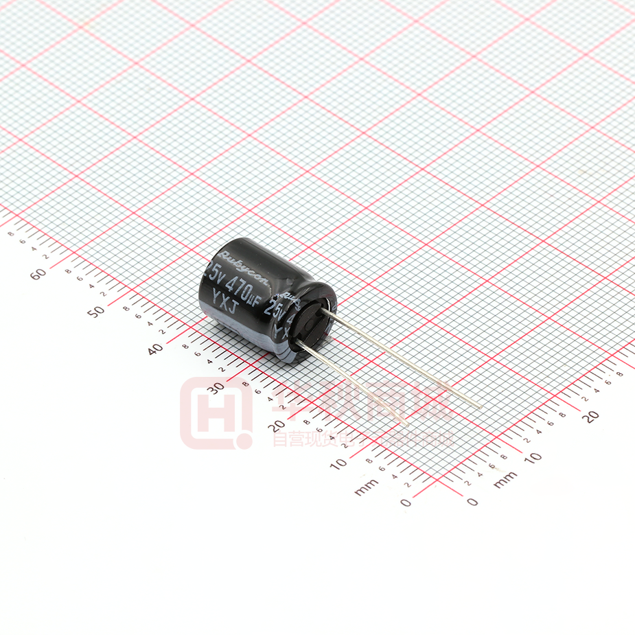

25YXJ470M10X12.5
25YXJ470M10X12.5
    RUBYCON(红宝石)
    插件,D10xL12.5mm
    直插铝电解电容 插件,D10xL12.5mm 470µF ±20% Ф10.00 x 12.50mm 25V 80mΩ 865mA 10000Hrs@105℃
25YXJ470M10X12.5 数据手册
RADIAL LEAD ALUMINUM ELECTROLYTIC CAPACITORS YXJ YXJ SERIES 105℃ Miniaturized, Long Life ・Load Life : 105℃ 4000∼10000 hours. RoHS compliance ◆SPECIFICATIONS Items Characteristics Category Temperature Range −40∼+105℃ 6.3∼100Vdc Rated Voltage Range ±20% (20℃, 120Hz) Capacitance Tolerance Leakage Current(MAX) I=0.01CV or 3μA whichever is greater.(After 2 minutes) I=Leakage Current(μA)     C=Capacitance(μF)     V=Rated Voltage(Vdc) (20℃, 120Hz) Rated Voltage 6.3 10 16 25 35 50 63 100 (Vdc) tanδ 0.22 0.19 0.16 0.14 0.12 0.10 0.09 0.08 Dissipation Factor(MAX) (tanδ) When capacitance is over 1000μF, tanδ shall be added 0.02 to the listed value with increase of every 1000μF. After applying rated voltage with rated ripple current for specified time at 105℃, the capacitors shall meet the following requirements. Capacitance Change Endurance Impedance Ratio(MAX) Not more than 200% of the specified value. Leakage Current Not more than the specified value. 10 Z (−40℃) /Z (20℃) 8 16 25 35 50 2 2 2 2 2 2 6 4 3 3 3 3 3 (120Hz) (mm) SLEEVE(PET) 10k 100k≦ 1uF 0.35 0.60 0.80 1.00 2.2∼10uF 0.42 0.60 0.80 1.00 22∼47uF 0.55 0.75 0.90 1.00 100∼330uF 0.70 0.85 0.95 1.00 φD 470∼1000uF 0.75 0.90 0.98 1.00 φd 2200∼15000uF 0.80 0.95 1.00 1.00 120 1k 10k 100k≦ 0.42 0.60 0.80 1.00 (63Vdc∼100Vdc) Coefficient F 1k ±0.5 φd 120 Frequency (Hz) Life Time(hrs) 6.3∼10Vdc 16∼100Vdc φD=5 4000 5000 φD=6.3,8 6000 7000 8000 10000 φD≧10 ◆DIMENSIONS (6.3Vdc∼50Vdc) Coefficient 63 100 3 ◆MULTIPLIER FOR RIPPLE CURRENT Frequency (Hz) Case Size Dissipation Factor Rated Voltage 6.3 (Vdc) Z (−25℃) /Z (20℃) 4 Low Temperature Stability Within ±25% of the initial value.(6.3V:±30%) L+αMAX 15MIN φD+0.5MAX 4MIN F 5 2.0 α ◆OPTION Code PET Sleeve Blank ◆PART NUMBER □□□ YXJ □□□□□ M □□□ □□ D×L Rated Voltage Series Capacitance Capacitance Tolerance Option Lead Forming Case Size 6.3 8 0.5 2.5 10 12.5 0.6 3.5 5.0 16 0.8 7.5 L≦16 : α=1.5 L≧20 : α=2.0 RADIAL LEAD ALUMINUM ELECTROLYTIC CAPACITORS YXJ ◆STANDARD SIZE Impedance Rated Capacitance Rated ripple current Size (Ω MAX) Voltage (μF) φD×L(mm) (mA r.m.s./105℃, 100kHz) (Vdc) 20℃, 100kHz −10℃, 100kHz 6.3 10 16 25 35 100 220 330 470 1000 2200 3300 4700 6800 10000 15000 100 220 330 470 1000 2200 3300 4700 6800 10000 47 100 220 330 470 1000 2200 3300 4700 6800 33 47 100 220 330 470 1000 2200 3300 4700 33 47 100 220 330 470 1000 2200 3300 5×11 5×11 6.3×11 6.3×11 8×11.5 10×16 10×20 12.5×25 12.5×25 16×25 16×35.5 5×11 5×11 6.3×11 6.3×11 10×12.5 10×20 12.5×20 12.5×25 16×25 16×31.5 5×11 5×11 6.3×11 6.3×11 8×11.5 10×16 12.5×20 12.5×25 16×25 16×31.5 5×11 5×11 5×11 6.3×11 8×11.5 10×12.5 10×20 12.5×25 16×25 16×31.5 5×11 5×11 6.3×11 8×11.5 10×12.5 10×16 12.5×20 16×25 16×31.5 150 250 340 400 640 1300 1400 2230 2230 2930 3610 150 250 400 400 865 1400 1900 2230 2930 3450 250 250 400 400 640 1210 1900 2230 2930 3450 250 250 250 400 640 865 1400 2230 2930 3450 250 250 400 640 865 1210 1900 2930 3450 0.90 0.40 0.22 0.22 0.13 0.062 0.046 0.032 0.032 0.021 0.015 0.90 0.40 0.22 0.22 0.080 0.046 0.041 0.032 0.021 0.019 0.40 0.40 0.22 0.22 0.13 0.062 0.041 0.032 0.021 0.019 0.40 0.40 0.40 0.22 0.13 0.080 0.046 0.032 0.021 0.019 0.40 0.40 0.22 0.13 0.080 0.062 0.041 0.021 0.019 3.6 1.2 0.87 0.87 0.52 0.25 0.18 0.11 0.11 0.060 0.044 3.6 1.2 0.87 0.87 0.32 0.18 0.14 0.11 0.060 0.056 1.2 1.2 0.87 0.87 0.52 0.25 0.14 0.11 0.060 0.056 1.2 1.2 1.2 0.87 0.52 0.32 0.18 0.11 0.060 0.056 1.2 1.2 0.87 0.52 0.32 0.25 0.14 0.060 0.056 Impedance Rated Capacitance Rated ripple current Size (Ω MAX) Voltage (μF) φD×L(mm) (mA r.m.s./105℃, 100kHz) (Vdc) 20℃, 100kHz −10℃, 100kHz 50 63 100 1 2.2 3.3 4.7 10 22 33 47 100 220 330 470 1000 2200 10 22 33 47 100 220 330 470 1000 1 2.2 3.3 4.7 10 22 33 47 100 220 330 5×11 5×11 5×11 5×11 5×11 5×11 5×11 6.3×11 8×11.5 10×16 10×20 12.5×20 16×25 16×35.5 5×11 5×11 6.3×11 6.3×11 10×12.5 10×20 12.5×20 12.5×25 16×25 5×11 5×11 5×11 5×11 6.3×11 6.3×11 8×11.5 8×16 10×20 12.5×25 16×25 30 43 53 88 100 180 250 295 555 1050 1220 1660 2730 3150 173 173 278 278 725 1200 1570 1990 2730 20 30 40 65 267 267 462 585 1040 1620 2210 4.0 2.5 2.2 1.9 1.5 0.70 0.70 0.30 0.17 0.084 0.060 0.045 0.032 0.019 0.88 0.88 0.35 0.35 0.15 0.078 0.060 0.043 0.032 4.5 3.0 2.7 2.5 0.57 0.57 0.36 0.25 0.12 0.060 0.044 8.0 6.0 5.6 5.0 4.0 2.8 2.8 1.2 0.68 0.34 0.24 0.15 0.096 0.057 3.5 3.5 1.4 1.4 0.60 0.31 0.19 0.14 0.096 15.0 13.0 11.0 10.0 2.3 2.3 1.4 1.0 0.52 0.23 0.16
