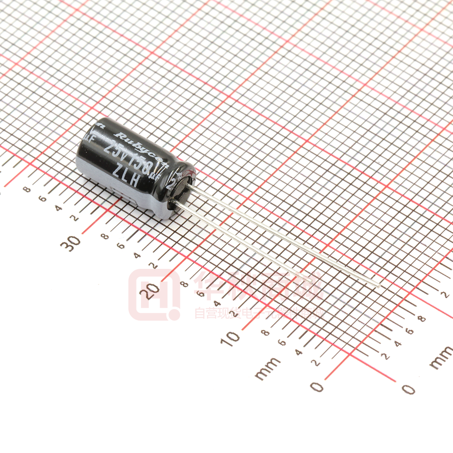

    直插铝电解电容 插件,D6.3xL11mm 150µF ±20% Ф6.30 x 11.00mm 25V 94mΩ 540mA 6000Hrs@105℃
25ZLH150MEFC6.3X11 数据手册
RADIAL LEAD ALUMINUM ELECTROLYTIC CAPACITORS ZLH ZLH SERIES 105℃ Miniaturized, Long Life, Low Impedance ・Load Life : 105℃ 6000∼10000 hours. RoHS compliance ◆SPECIFICATIONS Items Characteristics Category Temperature Range −40∼+105℃ 6.3∼100Vdc Rated Voltage Range Capacitance Tolerance ±20% (20℃, 120Hz) I=0.01CV or 3μA whichever is greater.(After 2 minutes) Leakage Current(MAX) I=Leakage Current(μA)     C=Capacitance(μF)     V=Rated Voltage(Vdc) Rated Voltage 120Hz) 6.3 10 16 25 35 50 63 80 100 (20℃, (Vdc) tanδ 0.22 0.19 0.16 0.14 0.12 0.10 0.09 0.08 0.08 Dissipation Factor(MAX) (tanδ) When capacitance is over 1000μF, tanδ shall be added 0.02 to the listed value with increase of every 1000μF. After applying rated voltage with rated ripple current for specified time at 105℃, the capacitors shall meet the following requirements. Endurance Capacitance Change Within ±25% of the initial value. (6.3Vdc, 10Vdc:±30%) Dissipation Factor Not more than 200% of the specified value. Leakage Current Rated Voltage 6.3 (Vdc) Z (−25℃) /Z (20℃) 2 Low Temperature Stability Impedance Ratio(MAX) Z (−40℃) /Z (20℃) 3 Not more than the specified value. 10 16 35 50 63 80 100 2 2 2 2 2 2 2 2 3 3 3 3 3 3 3 3 ◆MULTIPLIER FOR RIPPLE CURRENT Life Time (hrs) φD≦ 6.3 6000 φD= 8 8000 φD≧ 10 10000 (120Hz) ◆DIMENSIONS 120 1k 10k 100k≦ 8.2∼33μF 0.42 0.70 0.90 1.00 47∼270μF 0.50 0.73 0.92 1.00 Frequency (Hz) 25 Case Size (mm) SLEEVE(PET) Coefficient 330∼680μF 0.55 0.77 0.94 1.00 820∼1800μF 0.60 0.80 0.96 1.00 2200∼8200μF 0.70 0.85 0.98 1.00 L+α MAX φD+0.5MAX 4MIN 15MIN φD 5 φd F 6.3 8 0.5 2.0 α ◆PART NUMBER F ±0.5 φd 2.5 10 12.5 0.6 3.5 5.0 16 18 0.8 7.5 L≦16 : α=1.5 L≧20 : α=2.0 ◆OPTION □□□ ZLH □□□□□ M □□□ □□ D×L Rated Voltage Series Capacitance Capacitance Tolerance Option Lead Forming Case Size Code PET Sleeve EFC RADIAL LEAD ALUMINUM ELECTROLYTIC CAPACITORS ZLH ◆STANDARD SIZE Rated Capacitance Rated ripple current Size Voltage (μF) φD×L(mm) (mA r.m.s./105℃, 100kHz) (Vdc) 6.3 10 16 220 470 820 1200 1200 1500 1800 2200 2700 3900 4700 5600 6800 6800 8200 150 330 680 1000 1000 1500 1500 1800 2200 3300 3900 4700 4700 5600 6800 100 220 470 680 680 1000 1000 1500 1800 2200 2700 3300 3300 3900 4700 5×11 6.3×11 8×11.5 8×16 10×12.5 8×20 10×16 10×20 10×23 12.5×20 12.5×25 12.5×30 16×20 12.5×35 16×25 5×11 6.3×11 8×11.5 8×16 10×12.5 8×20 10×16 10×20 10×23 12.5×20 12.5×25 12.5×30 16×20 12.5×35 16×25 5×11 6.3×11 8×11.5 8×16 10×12.5 8×20 10×16 10×20 10×23 12.5×20 12.5×25 12.5×30 16×20 12.5×35 16×25 345 540 945 1250 1330 1500 1760 1960 2250 2480 2900 3450 3250 3570 3630 345 540 945 1250 1330 1500 1760 1960 2250 2480 2900 3450 3250 3570 3630 345 540 945 1250 1330 1500 1760 1960 2250 2480 2900 3450 3250 3570 3630 Impedance (Ω MAX) 20℃, 100kHz −10℃, 100kHz 0.22 0.094 0.056 0.045 0.039 0.029 0.028 0.020 0.018 0.017 0.015 0.013 0.015 0.012 0.013 0.22 0.094 0.056 0.045 0.039 0.029 0.028 0.020 0.018 0.017 0.015 0.013 0.015 0.012 0.013 0.22 0.094 0.056 0.045 0.039 0.029 0.028 0.020 0.018 0.017 0.015 0.013 0.015 0.012 0.013 0.80 0.35 0.19 0.15 0.14 0.11 0.10 0.060 0.054 0.043 0.038 0.033 0.038 0.031 0.035 0.80 0.35 0.19 0.15 0.14 0.11 0.10 0.060 0.054 0.043 0.038 0.033 0.038 0.031 0.035 0.80 0.35 0.19 0.15 0.14 0.11 0.10 0.060 0.054 0.043 0.038 0.033 0.038 0.031 0.035 Rated Capacitance Rated ripple current Size Voltage (μF) φD×L(mm) (mA r.m.s./105℃, 100kHz) (Vdc) 25 35 50 68 150 330 390 470 560 680 820 1000 1500 1800 2200 2200 2700 3300 47 100 220 270 330 390 470 560 680 1000 1200 1500 1500 1800 2200 27 56 100 120 150 180 220 270 330 470 560 680 820 820 1000 5×11 6.3×11 8×11.5 8×16 10×12.5 8×20 10×16 10×20 10×23 12.5×20 12.5×25 12.5×30 16×20 12.5×35 16×25 5×11 6.3×11 8×11.5 8×16 10×12.5 8×20 10×16 10×20 10×23 12.5×20 12.5×25 12.5×30 16×20 12.5×35 16×25 5×11 6.3×11 8×11.5 8×16 10×12.5 8×20 10×16 10×20 10×23 12.5×20 12.5×25 12.5×30 12.5×35 16×20 16×25 345 540 945 1250 1330 1500 1760 1960 2250 2480 2900 3450 3250 3570 3630 345 540 945 1250 1330 1500 1760 1960 2250 2480 2900 3450 3250 3570 3630 238 385 724 950 979 1190 1370 1580 1870 2050 2410 2860 2960 2730 3010 Impedance (Ω MAX) 20℃, 100kHz −10℃, 100kHz 0.22 0.094 0.056 0.045 0.039 0.029 0.028 0.020 0.018 0.017 0.015 0.013 0.015 0.012 0.013 0.22 0.094 0.056 0.045 0.039 0.029 0.028 0.020 0.018 0.017 0.015 0.013 0.015 0.012 0.013 0.34 0.14 0.074 0.061 0.061 0.046 0.042 0.030 0.028 0.027 0.023 0.021 0.019 0.023 0.021 0.80 0.35 0.19 0.15 0.14 0.11 0.10 0.060 0.054 0.043 0.038 0.033 0.038 0.031 0.035 0.80 0.35 0.19 0.15 0.14 0.11 0.10 0.060 0.054 0.043 0.038 0.033 0.038 0.031 0.035 1.18 0.50 0.22 0.18 0.18 0.14 0.12 0.090 0.085 0.068 0.059 0.052 0.051 0.059 0.056 RADIAL LEAD ALUMINUM ELECTROLYTIC CAPACITORS ZLH ◆STANDARD SIZE Rated Capacitance Size Rated ripple current Voltage (μF) φD×L(mm) (mA r.m.s./105℃, 100kHz) (Vdc) 63 80 18 47 82 100 120 150 180 270 270 330 390 470 560 560 680 820 820 820 1200 1200 1500 1500 1800 1800 2200 12 33 56 68 82 100 120 180 180 220 270 330 390 390 470 560 560 560 680 820 820 1000 1000 1200 1500 5×11 6.3×11 8×11.5 8×16 10×12.5 8×20 10×16 10×20 12.5×16 10×23 12.5×20 12.5×25 12.5×30 16×20 12.5×35 12.5×40 16×25 18×20 16×31.5 18×25 16×35.5 18×31.5 16×40 18×35.5 18×40 5×11 6.3×11 8×11.5 8×16 10×12.5 8×20 10×16 10×20 12.5×16 10×23 12.5×20 12.5×25 12.5×30 16×20 12.5×35 12.5×40 16×25 18×20 16×31.5 16×35.5 18×25 16×40 18×31.5 18×35.5 18×40 173 278 525 688 725 861 998 1200 1200 1410 1570 1990 2410 2100 2620 2940 2730 2500 2990 2800 3040 3300 3570 3570 3670 163 267 462 585 624 735 780 1040 975 1170 1430 1620 1950 1750 2140 2340 2210 1950 2400 2600 2270 2860 2470 2860 3510 Impedance (Ω MAX) 20℃, 100kHz −10℃, 100kHz 0.88 0.35 0.22 0.16 0.15 0.12 0.11 0.078 0.082 0.069 0.060 0.043 0.035 0.043 0.033 0.027 0.032 0.038 0.024 0.031 0.021 0.025 0.019 0.020 0.018 1.4 0.57 0.36 0.25 0.23 0.19 0.17 0.12 0.13 0.11 0.085 0.060 0.051 0.058 0.043 0.036 0.044 0.054 0.033 0.029 0.038 0.027 0.031 0.027 0.026 3.5 1.4 0.88 0.64 0.60 0.48 0.44 0.31 0.27 0.28 0.19 0.14 0.13 0.14 0.11 0.090 0.096 0.10 0.068 0.084 0.057 0.068 0.057 0.054 0.049 5.6 2.3 1.4 1.0 0.96 0.76 0.72 0.52 0.43 0.47 0.31 0.23 0.21 0.21 0.17 0.15 0.16 0.18 0.12 0.10 0.13 0.090 0.11 0.084 0.076 Rated Capacitance Size Rated ripple current Voltage (μF) φD×L(mm) (mA r.m.s./105℃, 100kHz) (Vdc) 100 8.2 18 33 47 56 68 82 100 100 120 150 220 270 270 330 390 390 390 470 470 560 560 680 680 820 5×11 6.3×11 8×11.5 8×16 10×12.5 8×20 10×16 10×20 12.5×16 10×23 12.5×20 12.5×25 12.5×30 16×20 12.5×35 12.5×40 16×25 18×20 16×31.5 18×25 16×35.5 18×31.5 16×40 18×35.5 18×40 163 267 462 585 624 735 780 1040 975 1170 1430 1620 1950 1750 2140 2340 2210 1950 2400 2270 2600 2470 2860 2860 3510 Impedance (Ω MAX) 20℃, 100kHz −10℃, 100kHz 1.4 0.57 0.36 0.25 0.23 0.19 0.17 0.12 0.13 0.11 0.085 0.060 0.051 0.058 0.043 0.036 0.044 0.054 0.033 0.038 0.029 0.031 0.027 0.027 0.026 5.6 2.3 1.4 1.0 0.96 0.76 0.72 0.52 0.43 0.47 0.31 0.23 0.21 0.21 0.17 0.15 0.16 0.18 0.12 0.13 0.10 0.11 0.090 0.084 0.076
