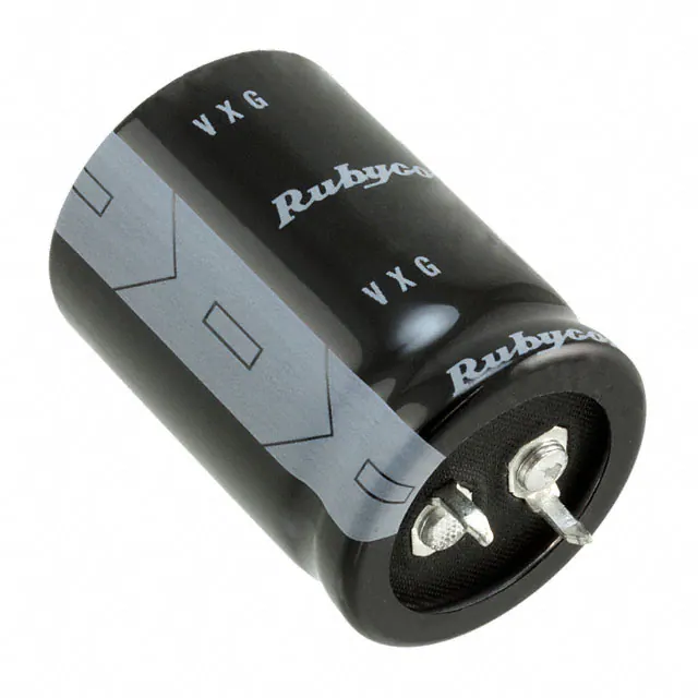

   SNAP-IN ALUMINUM ELECTROLYTIC CAPACITORS  series 105 5000  Load Life : 105 5000 hours RoHS compliance SPECIFICATIONS  Item   !"#$%& Category Temperature Range -40'+105( -25'+105( 10'100Vdc 200'500Vdc )*%& Rated Voltage Range +, Capacitance Tolerance  Leakage Current (MAX) Characteristics ±20%-20(, 120Hz. I=3 CV ()*/0512) I=3 CV (After 5 minutes application of rated voltage) I=-3A. C=-3F. V=)*-Vdc. Rated Voltage Leakage Current Capacitance )* (Vdc) Rated Voltage  -tanY. Dissipation Factor (MAX) 10 tanY 16 25 0.55 0.50 35 0.45 0.40 50 63 80 0.35 0.30 0.25 100 200' 400' 475' 250 450 500 0.20 0.20 (20(, 120Hz) 0.20 0.25 105(67500089)*-":;?@ABCDEFG After applying rated voltage with rated ripple current for 5000 hours at 105(, the capacitors shall meet the following requirements. 45 Endurance  ±20% (10WV ±25 ) Within ±20 (For 10WV ; ±25 )of the initial value.   Dissipation Factor  Leakage Current  200%  Not more than 200% of the specified value.   Not more than the specified value. 10' 200' 400' 475' 100 250 450 500 )* (Vdc) Rated Voltage H# Low Temperature Stability -IJKLMJNO. Impedance Ratio (MAX)   Capacitance Change Z(-25()/Z(+20() 3 3 8 10 Z(-40()/Z(+20() 12 d d d PART NUMBER VXG -120Hz . SN )* P"LQR  +, S?T ef?T WxX ULNVIQ Rated Voltage Series Capacitance Capacitance Tolerance Option Terminal Code Case Size M ()*OPTION !" #$%&' MULTIPLIER FOR RIPPLE CURRENT [\] (Hz) Frequency 60 (50) 120 (100) 300 500 1k 10kZ 10' 100Vdc 0.90 1.00 1.03 1.05 1.10 1.15 200' ^] 250Vdc Coefficient 0.80 1.00 1.15 1.20 1.30 1.50 400' 500Vdc 0.80 1.00 1.15 1.20 1.25 1.40 133 EFC : PET N"L_>`abc PET Sleeve without plate    SNAP-IN ALUMINUM ELECTROLYTIC CAPACITORS DIMENSIONS  : SN( !) SN[4(3.5)mm] Terminal code :"SN(Tin plating) SN[4(3.5)mm]terminal type  VENT (mm)  NEGATIVE  SLEEVE(PET) - 10  L± ±0.5 D±1 10±0.1  353.5±0.5 For 35, 3.5±0.5  MOUNTING HOLES STANDARD SIZE Cap. (F) 5600 6800 8200 10000 12000 15000 18000 22000 27000 33000 39000 47000 56000 Cap. (F) 2700 3300 3900 4700 5600 6800 8200 10000 12000 15000 18000 22000 27000 10Vdc 22 22×25 22×30 22×35 22×40 22×45 25 16Vdc 30 1.36 1.65 1.85 25×25 1.82 2.12 25×30 2.11 30×25 2.40 25×35 2.32 30×30 25×40 2.59 30×30 25×45 3.01 30×35 25×50 3.43 30×40 30×45 30×50 2.14 2.37 2.73 3.13 3.53 3.78 4.58 35 35×30 35×35 35×40 35×45 35×50 22 22×25 1.44 22×30 1.66 22×30 1.79 22×35 2.08 22×40 2.36 22×45 2.69 25 25×25 25×30 25×35 25×40 25×45 25×50 1.67 2.07 2.37 2.72 3.06 3.39 3.05 3.49 3.96 4.60 5.06 25Vdc 22 22×25 22×30 22×35 22×40 22×45 22×50 1.31 1.55 1.77 2.02 2.27 2.56 25 25×25 25×30 25×35 25×40 25×45 30 30×25 30×30 30×35 30×40 30×45 30×50 2.13 2.54 3.02 3.46 3.88 4.33 35 35×30 35×30 35×35 35×40 35×45 35×50 3.09 3.31 3.85 4.33 4.96 5.49 35Vdc 30 35 1.56 1.88 2.18 30×25 1.92 2.53 30×30 2.38 2.79 30×35 2.70 35×30 30×40 3.13 35×30 30×45 3.52 35×35 30×50 3.92 35×40 35×50 2.76 3.00 3.50 3.95 4.72 22 22×25 1.29 22×30 1.54 22×35 1.77 22×40 2.01 22×45 2.25 22×50 2.49 25 25×25 25×30 25×35 25×40 25×45 30 35 1.55 1.87 2.18 30×25 1.80 2.45 30×30 2.28 2.80 30×35 2.69 30×40 3.04 35×30 2.78 30×45 3.38 35×35 3.30 35×40 3.88 35×45 4.40 #$% Case Size D×L(mm) &'( Ripple Current (A.r.m.s./120Hz,105)) 134    SNAP-IN ALUMINUM ELECTROLYTIC CAPACITORS STANDARD SIZE Cap. (F) 1000 1200 1500 1800 2200 2700 3300 3900 4700 5600 6800 8200 10000 12000 Cap. (F) 560 680 820 1000 1200 1500 1800 2200 2700 3300 3900 4700 5600 Cap. (F) 270 330 390 470 560 680 820 1000 1200 1500 1800 2200 50Vdc 22 22×25 22×25 22×30 22×35 22×40 22×45 1.21 1.28 1.52 1.77 2.02 2.27 25 25×25 25×30 25×30 25×35 25×40 25×45 63Vdc 30 1.46 1.76 1.87 2.20 2.43 2.72 30×25 30×30 30×30 30×35 30×40 30×50 35 22 22×25 1.10 22×25 1.17 22×30 1.41 22×35 1.62 22×40 1.85 22×45 2.10 1.72 2.09 2.22 2.58 35×30 2.35 3.01 35×35 2.91 3.63 35×40 3.36 35×45 3.79 35×50 4.06 25 25×25 25×30 25×30 25×35 25×40 25×45 1.38 1.63 1.75 2.03 2.33 2.58 80Vdc 22 22×25 22×30 22×35 22×40 22×45 25 30 35 1.58 1.68 2.02 2.50 35×30 2.18 2.69 35×35 2.60 2.94 35×40 3.00 35×45 3.44 35×50 3.72 22 22×25 1.01 22×30 1.19 22×35 1.33 22×40 1.56 22×45 1.76 22×50 2.00 25 25×25 25×30 25×35 25×40 25×45 25×25 25×30 25×30 25×35 25×40 25×45 1.66 2.01 2.15 2.46 35×30 2.31 2.82 35×35 2.77 3.22 35×40 3.20 35×45 3.61 35×50 3.94 30 1.26 1.52 1.76 2.03 2.29 200Vdc 25 30×25 30×30 30×30 30×35 30×40 30×45 35 100Vdc 1.09 1.29 1.48 25×25 1.32 1.70 25×30 1.74 30×25 1.91 25×35 1.86 30×25 25×45 2.22 30×30 30×35 30×40 30×45 22 22×25 1.31 22×30 1.53 22×30 1.61 22×35 1.84 22×40 2.07 22×45 2.32 22×50 2.58 30 30×25 30×30 30×30 30×35 30×40 30×45 35 1.47 1.76 1.89 2.19 35×30 2.05 2.52 35×35 2.48 2.86 35×40 2.87 35×45 3.25 35×50 3.56 220Vdc 30 35 1.49 1.75 1.81 2.07 30×25 1.67 2.33 30×30 1.95 35×25 2.62 30×35 2.23 35×30 30×40 2.50 35×35 30×45 2.82 35×40 35×45 35×50 22 22×25 1.31 22×30 1.53 22×35 1.73 22×40 1.96 22×45 2.18 22×50 2.43 1.65 22×60 2.80 1.94 2.24 2.56 2.85 3.14 25 25×25 25×30 25×35 25×40 25×45 25×50 25×60 1.49 1.73 1.97 2.23 2.48 2.77 3.16 30 30×25 30×30 30×35 30×40 30×45 30×50 30×60 1.60 1.89 2.17 2.43 2.68 3.01 3.48 35 35×25 35×30 35×35 35×40 35×40 35×50 35×60  Case Size D×L(mm)  Ripple Current (A.r.m.s./120Hz,105 ) 135 1.58 1.91 2.21 2.48 2.50 3.04 3.40    SNAP-IN ALUMINUM ELECTROLYTIC CAPACITORS STANDARD SIZE Cap. (F) 82 100 120 150 180 220 270 330 390 470 560 680 820 1000 1200 1500 1800 Cap. (F) 82 100 120 150 180 220 270 330 390 470 560 680 820 Cap. (F) 47 56 68 82 100 120 150 180 220 270 330 390 470 250Vdc 22 22×25 22×30 22×35 22×40 22×45 22×50 22×55 1.22 1.43 1.64 1.84 2.06 2.29 2.54 25 25×25 25×30 25×35 25×40 25×45 25×50 25×60 400Vdc 30 1.39 1.65 1.88 2.11 2.36 2.61 3.02 30×25 30×30 30×35 30×40 30×45 30×50 30×60 1.55 1.84 2.11 2.36 2.63 2.85 3.31 35 35×25 35×30 35×30 35×35 35×40 35×50 35×55 22 22×25 0.77 22×30 0.89 22×30 0.96 22×35 1.11 22×40 1.25 22×50 1.47 22×55 1.65 25 25×25 25×30 25×35 25×35 25×45 25×50 25×55 0.95 1.11 1.26 1.35 1.61 1.80 1.99 1.56 1.80 1.81 2.38 2.41 2.92 3.12 420Vdc 22 22×25 0.75 22×30 0.87 22×35 0.99 22×40 1.14 22×45 1.28 22×50 1.44 22×60 1.66 25 25×25 25×30 25×35 25×40 25×45 25×50 25×60 30×25 30×30 30×35 30×40 30×45 30×50 30×60 1.14 1.32 1.51 1.71 1.89 2.09 2.39 35 35×25 35×30 35×35 35×40 35×40 35×50 35×55 35×60 22 22×25 0.76 22×30 0.88 22×35 1.00 22×40 1.14 22×45 1.29 1.24 22×55 1.49 1.45 1.66 1.86 1.93 2.27 2.48 2.69 25 25×25 25×30 25×30 25×35 25×40 25×50 22×25 22×30 22×30 22×35 22×40 22×45 22×55 0.62 0.71 0.77 0.89 1.00 1.15 1.32 25 25×25 25×30 25×30 25×35 25×40 25×50 25×60 0.77 0.88 0.96 1.11 1.25 1.45 1.68 1.16 1.35 1.54 1.74 1.93 2.14 2.44 30 0.86 0.99 1.09 1.23 1.40 1.64 475Vdc 22 30×25 30×30 30×35 30×40 30×45 30×50 30×60 35 35×25 35×30 35×30 35×35 35×40 35×45 35×50 35×60 1.26 1.48 1.54 1.74 1.95 2.19 2.40 2.77 450Vdc 30 0.93 1.08 1.23 1.39 1.57 1.77 2.01 30 30×25 30×30 30×30 30×35 30×45 30×50 30×55 1.08 1.24 1.32 1.51 1.80 1.98 2.19 35 35×25 35×30 35×35 35×40 35×45 35×50 35×55 1.23 1.45 1.65 1.85 2.05 2.26 2.49 500Vdc 30 30×25 30×30 30×30 30×35 30×40 30×55 0.96 1.12 1.20 1.36 1.55 1.89 35 35×25 35×30 35×35 35×40 35×50 35×60 22 22×25 0.58 22×30 0.66 22×30 0.73 22×35 0.83 22×40 0.94 22×50 1.08 22×55 1.24 1.14 22×60 1.38 1.33 1.52 1.71 1.99 2.28 25 25×25 25×30 25×35 25×35 25×45 25×50 25×55 0.72 0.83 0.94 1.02 1.21 1.36 1.52 30 30×25 30×25 30×30 30×35 30×40 30×45 30×50 30×55 0.83 0.91 1.04 1.19 1.34 1.51 1.69 1.89 35 35×25 35×30 35×30 35×40 35×40 35×45 35×55 35×60  Case Size D×L(mm)  Ripple Current (A.r.m.s./120Hz,105 ) 136 1.01 1.18 1.25 1.51 1.62 1.81 2.08 2.28
500VXG120MEFCSN25X35
物料型号:VXG系列
器件简介:Rubycon公司生产的基板自立形铝电解电容器,具有SNAP-IN安装方式,适用于高温环境,符合RoHS标准。
引脚分配:文档中提到了端子类型,例如SN[4(3.5)mm]端子夕,端子记号为SN(Tin plating),即锡镀层。
参数特性: - 工作温度范围分为-40~+105°C和-25~+105°C两个类别。 - 额定电压范围分为10~100Vdc和200~500Vdc两个类别。 - 电容公差为±20%(20°C, 120Hz)。 - 漏电流最大值为1=3CV(After 5 minutes application of rated voltage),即在额定电压下5分钟后的漏电流。 - 损耗角正切(Dissipation Factor)最大值随额定电压不同而变化。
功能详解:电容器在105°C下,经过5000小时额定电压和额定纹波电流的耐久性测试后,应满足以下要求: - 电容变化率在初始值的20%以内(对于10μF:±25%)。 - 损耗角正切不超过规格值的200%。 - 漏电流不超过规格值。
应用信息:适用于需要高温、长寿命和高可靠性的场合。
封装信息:提供了详细的尺寸信息,包括端子类型、安装孔、标准尺寸等。
