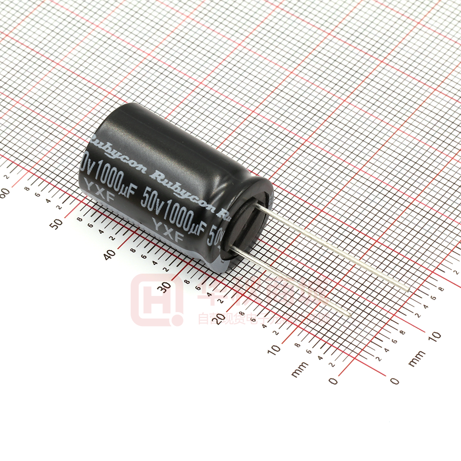

    直插铝电解电容 插件,D16xL25mm 1mF ±20% Ф16.00 x 25.00mm 50V 34mΩ 1.85A 10000Hrs@105℃
50YXF1000MFFC16X25 数据手册
RADIAL LEAD ALUMINUM ELECTROLYTIC CAPACITORS YXF YXF SERIES 105℃ Long Life ・Load Life : 105℃ 4000∼10000 hours. RoHS compliance ◆SPECIFICATIONS Items Characteristics Category Temperature Range −40∼+105℃ 6.3∼100Vdc Rated Voltage Range ±20% (20℃, 120Hz) Capacitance Tolerance I=0.01CV or 3μA whichever is greater.(After 2 minutes) Leakage Current(MAX) I=Leakage Current(μA) C=Capacitance(μF) V=Rated Voltage(Vdc) Rated Voltage 120Hz) 6.3 10 16 25 35 50 63 100 (20℃, (Vdc) tanδ 0.22 0.19 0.16 0.14 0.12 0.10 0.09 0.08 Dissipation Factor(MAX) (tanδ) When capacitance is over 1000μF, tanδ shall be added 0.02 to the listed value with increase of every 1000μF. After applying rated voltage with rated ripple current for specified time at 105℃, the capacitors shall meet the following requirements. Capacitance Change Within ±25% of the initial value. Dissipation Factor Not more than 200% of the specified value. Leakage Current Not more than the specified value. Endurance Rated Voltage 6.3 (Vdc) Z (−25℃) /Z (20℃) 4 Low Temperature Stability Impedance Ratio(MAX) Z (−40℃) /Z (20℃) 8 10 16 25 35 50 63 100 3 2 2 2 2 2 2 6 4 3 3 3 3 3 ◆MULTIPLIER FOR RIPPLE CURRENT Life Time (hrs) 6.3∼10Vdc 16∼100Vdc φD≦6.3 4000 5000 φD=8,10 6000 7000 φD≧12.5 8000 10000 Case Size (120Hz) ◆DIMENSIONS (mm) 120 1k 10k 100k≦ 1uF 0.35 0.60 0.80 1.00 2.2∼10uF 0.42 0.60 0.80 1.00 22∼33uF 0.55 0.75 0.90 1.00 47∼330uF 0.70 0.85 0.95 1.00 470∼1000uF 0.75 0.90 0.98 1.00 φD 2200∼15000uF 0.80 0.95 1.00 1.00 φd Frequency (Hz) SLEEVE(PET) Coefficient F ±0.5 φd L+α MAX 15MIN F 5 6.3 8 0.5 2.0 α ◆PART NUMBER φD+0.5MAX 4MIN 2.5 10 12.5 16 0.6 3.5 18 0.8 5.0 7.5 L≦16 : α=1.5 L≧20 : α=2.0 ◆OPTION □□□ YXF □□□□□ M □□□ □□ D×L Rated Voltage Series Capacitance Capacitance Tolerance Option Lead Forming Case Size Code PET Sleeve EFC RADIAL LEAD ALUMINUM ELECTROLYTIC CAPACITORS YXF ◆STANDARD SIZE Rated Rated ripple current Size Voltage Capacitance (μF) φD×L(mm) (mA r.m.s./105℃, 100kHz) (Vdc) 6.3 10 16 25 35 100 220 330 470 1000 2200 3300 4700 6800 10000 15000 100 220 330 470 1000 2200 3300 4700 6800 10000 47 100 220 330 470 1000 2200 3300 4700 6800 33 47 100 220 330 470 1000 2200 3300 4700 33 47 100 220 330 470 1000 2200 3300 5×11 6.3×11 6.3×11 8×11.5 10×12.5 12.5×20 12.5×20 16×25 16×25 16×31.5 18×35.5 5×11 6.3×11 8×11.5 8×11.5 10×16 12.5×20 12.5×25 16×25 16×31.5 18×35.5 5×11 6.3×11 8×11.5 8×11.5 10×12.5 10×20 12.5×25 16×25 16×31.5 18×35.5 5×11 5×11 6.3×11 8×11.5 10×12.5 10×16 12.5×20 16×25 16×31.5 18×35.5 5×11 6.3×11 8×11.5 10×12.5 10×16 10×20 12.5×25 16×31.5 18×35.5 150 250 250 400 580 1300 1300 1850 1850 2000 2200 150 250 400 400 770 1300 1650 1850 2000 2200 150 250 400 400 580 1050 1650 1850 2000 2200 150 150 250 400 580 770 1300 1850 2000 2200 150 250 400 580 770 1050 1650 2000 2200 Impedance (Ω MAX) 20℃, 100kHz −10℃, 100kHz 0.90 0.40 0.40 0.25 0.16 0.062 0.062 0.034 0.034 0.029 0.025 0.90 0.40 0.25 0.25 0.12 0.062 0.048 0.034 0.029 0.025 0.90 0.40 0.25 0.25 0.16 0.078 0.048 0.034 0.029 0.025 0.90 0.90 0.40 0.25 0.16 0.12 0.062 0.034 0.029 0.025 0.90 0.40 0.25 0.16 0.12 0.078 0.048 0.029 0.025 3.6 1.6 1.6 1.0 0.65 0.21 0.21 0.096 0.096 0.087 0.058 3.6 1.6 1.0 1.0 0.46 0.21 0.16 0.096 0.087 0.058 3.6 1.6 1.0 1.0 0.65 0.30 0.16 0.096 0.087 0.058 3.6 3.6 1.6 1.0 0.65 0.46 0.21 0.096 0.087 0.058 3.6 1.6 1.0 0.65 0.46 0.30 0.16 0.087 0.058 Rated Rated ripple current Size Voltage Capacitance (μF) φD×L(mm) (mA r.m.s./105℃, 100kHz) (Vdc) 50 63 100 1 2.2 3.3 4.7 10 22 33 47 100 220 330 470 1000 2200 10 22 33 47 100 220 330 470 1000 1 2.2 3.3 4.7 10 22 33 47 100 220 330 5×11 5×11 5×11 5×11 5×11 5×11 6.3×11 6.3×11 8×11.5 10×16 10×20 12.5×20 16×25 18×35.5 5×11 6.3×11 6.3×11 8×11.5 10×12.5 10×20 12.5×20 12.5×25 16×31.5 5×11 5×11 5×11 5×11 6.3×11 8×11.5 10×12.5 10×16 12.5×20 16×25 16×25 30 43 53 88 100 150 250 250 400 770 1050 1300 1850 2200 87 140 140 210 300 520 660 750 1390 20 30 40 65 140 160 230 290 430 900 900 Impedance (Ω MAX) 20℃, 100kHz −10℃, 100kHz 4.0 2.5 2.2 1.9 1.5 0.90 0.40 0.40 0.25 0.12 0.078 0.062 0.034 0.025 2.3 1.3 1.2 0.63 0.43 0.21 0.16 0.12 0.054 4.5 3.0 2.7 2.5 1.2 0.63 0.43 0.31 0.16 0.073 0.073 8.0 6.0 5.6 5.0 4.0 3.6 1.6 1.6 1.0 0.46 0.30 0.21 0.096 0.058 9.3 5.2 5.0 2.8 1.8 0.84 0.64 0.45 0.20 15.0 13.0 11.0 10.0 5.0 2.8 1.8 1.5 0.64 0.27 0.27
