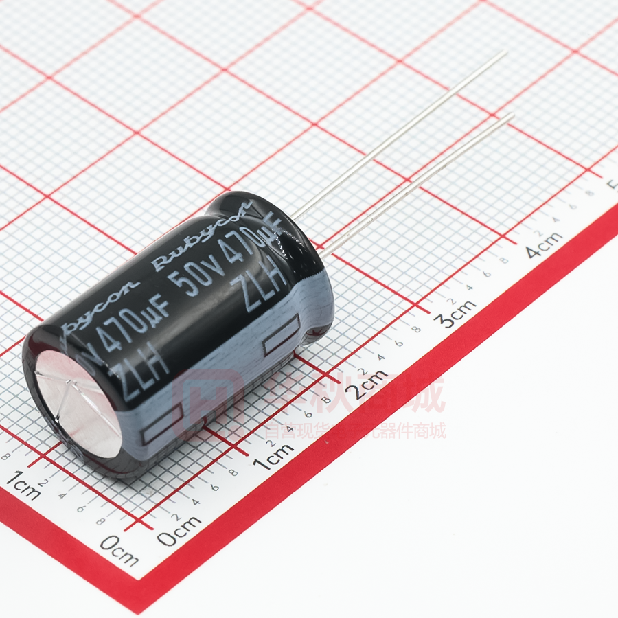

50ZLH470MEFC12.5X20
50ZLH470MEFC12.5X20
    RUBYCON(红宝石)
    插件,D12.5xL20mm
    470UF ±20% 50V
50ZLH470MEFC12.5X20 数据手册
        !"  series 105# 6000$10000%&'()* +,- ./012' 105# 6000$10000 hours. Miniaturized, Long Life, Low Impedance e RoHS compliance SPECIFICATIONS  Item  Characteristics  Category Temperature Range -40 +105  Rated Voltage Range 6.3 100Vdc  Capacitance Tolerance  Leakage Current (MAX) ±20%20, 120Hz IX0.01CVYZ3VA#[\]^_4`a.*+2b,) IX0.01CV or 3VA whichever is greater.cc cc(After 2 minutes) I=VA C=VF V=Vdc Leakage Current Capacitance Rated Voltage KLM#NOtanP Dissipation Factor (MAX)  (Vdc) Rated Voltage 6.3 10 16 25 35 50 63 80 100 tanP 0.22 0.19 0.16 0.14 0.12 0.10 0.09 0.08 0.08 (20, 120Hz) 1000VF0de4f#Z1000VFg3hij"#`i0.020+ek`6347 When capacitance is over 1000VF, tanP shall be added 0.02 to the listed value with increase of every 1000VF. 105 !"#$%&'()*+,-./01234567 After applying rated voltage with rated ripple current for specified time at 105, the capacitors shall meet the following requirements. lmn op`#±25qar 6.3Vdc, 10Vdcs±30% Capacitance Change Within ±25q of the initial value6.3Vdc, 10Vdcs±30%  Endurance KLM#NO Dissipation Factor  Leakage Current 8  Low Temperature Stability 9:;? Impedance Ratio (MAX) t`# 200% a. Not more than 200% of the specified value. t`a. Not more than the specified value. GH9A Case Size uDQ 6.3 uDX8 uDv10  (Vdc) Rated Voltage 6.3 10 16 25 35 50 63 80 100 Z(-25)/Z(+20) 2 2 2 2 2 2 2 2 2 Z(-40)/Z(+20) 3 3 3 3 3 3 3 3 3 $%(hrs) Time(hrs) 6000 8000 10000 (120Hz) 389:;7PART NUMBER  ZLH @
50ZLH470MEFC12.5X20
- 物料型号:ZLH系列 - 器件简介:105℃下6000至10000小时的小型化长寿命低压产品。 - 引脚分配:径向引线。 - 参数特性: - 工作温度范围:-40~+105°C - 额定电压范围:6.3~100Vdc - 电容公差:±20%(在20°C和120Hz时) - 漏电流最大值:0.01CV或3A,取较大者 - 损耗角正切(Dissipation Factor):随额定电压不同而变化,例如6.3Vdc时为0.22,100Vdc时为0.08 - 功能详解:耐久性测试显示,在105°C下,经过额定电压和额定纹波电流测试后,电容器应满足特定要求,例如电容变化率在25%以内。 - 应用信息:文档未明确列出应用信息,但通常这类电容器用于电源滤波、信号耦合等。 - 封装信息:提供了详细的尺寸信息,包括直径(D)、引脚直径(d)、高度(F)和最大长度(L+a)。
