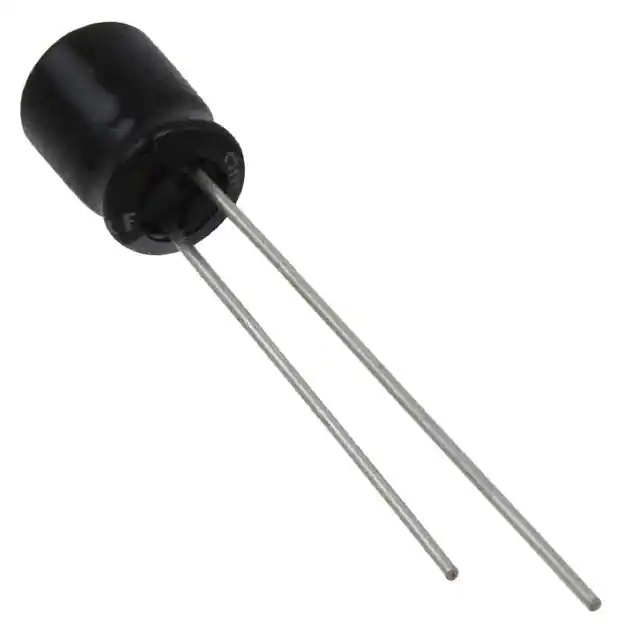

MINIATURE ALUMINUM ELECTROLYTIC CAPACITORS MS7 MS7 • RoHS SERIES 850C 7mm Height. FEATURES compliance. SPECIFICATIONS Items Category Temperature Range Characteristics -40 ∼ +85°C 4 ∼ 63V.DC + - 20% (20°C, 120Hz) I=0.01CV or 3 µ A whichever is greater. (After 2 minutes application of rated voltage) Rated Voltage Range Capacitance Tolerance Leakage Current(MAX) I=Leakage Current( µ A) C=Rated Capacitance( µ F) V=Rated Voltage(V) Dissipation Factor(MAX) (tanδ) Rated Voltage 4 6.3 10 16 25 35 50 63 (V) tanδ 0.35 0.24 0.20 0.17 0.15 0.13 0.10 0.10 (20°C, 120Hz) After applying rated voltage with rated ripple current for 1000 hrs at 85°C, the capacitors shall meet the following requirements. Capacitance Change Dissipation Factor Leakage Current Rated Voltage (V) Z( -25°C) /Z(20°C) Z( -40°C) /Z(20°C) + Within - 20% of the initial value. Not more than 200% of the specified value. Not more than the specified value. Endurance Low Temperature Stability Impedance Ratio(MAX) 4 7 15 6.3 4 10 10 3 8 16 3 6 25 2 4 35 2 4 50 2 4 63 2 4 (120Hz) MULTIPLIER FOR RIPPLE CURRENT Frequency coefficient 60(50) 120 (Hz) 0.1 ∼ 1 µ F 0.50 1.0 2.2 ∼ 4.7 µ F 0.65 1.0 Coefficient 10 ∼ 47 µ F 0.8 1.0 100 ∼ 470 µ F 0.8 1.0 Frequency 500 1.20 1.20 1.20 1.10 1k 1.30 1.30 1.30 1.15 10k< = 1.50 1.50 1.50 1.20 D×L PART NUMBER MS7 Rated Voltage Series Rated Capacitance Capacitance Tolerance Option Lead Forming Case Size MINIATURE ALUMINUM ELECTROLYTIC CAPACITORS MS7 (mm) DIMENSIONS SLEEVE φd + F0.5- φD φd F 4 5 6.3 0.45 8 1.5 2.0 2.5 3.5 L+1MAX 15MIN 4MIN φD+0.5MAX STANDARD SIZE, RATED RIPPLE CURRENT WV(V.DC) Cap (µF) 10 22 33 47 100 220 330 470 4×7 4×7 5×7 6.3 × 7 8×7 8×7 33 39 65 110 165 190 4×7 4×7 4×7 5×7 6.3 × 7 8×7 Size 4 (0G) Ripple Size 6.3 (0J) Size φ D×L(mm), Ripple Current (mA r.m.s./85°C, 120Hz) 10 (1A) Ripple Size Ripple Size 4×7 34 42 50 87 133 180 4×7 4×7 5×7 6.3 × 7 8×7 8×7 38 46 66 99 165 210 4×7 5×7 5×7 6.3 × 7 8×7 16 (1C) Ripple 28 42 62 73 110 145 WV(V.DC) Cap (µF) 0.1 0.22 0.33 0.47 1 2.2 3.3 4.7 10 22 33 47 100 Size 25 (1E) Ripple Size 35 (1V) Ripple Size 50 (1H) Ripple 1.3 3.0 4.4 6.3 12 16 19 24 42 64 75 85 Size 63 (1J) Ripple 1.3 3.0 4.4 6.3 12 16 24 33 45 4×7 4×7 4×7 4×7 4×7 4×7 4×7 4×7 4×7 5×7 6.3 × 7 6.3 × 7 8×7 21 31 55 66 80 115 4×7 5×7 6.3 × 7 6.3 × 7 8×7 8×7 18 22 32 60 73 95 115 4×7 4×7 5×7 6.3 × 7 8×7 8×7 4×7 4×7 4×7 4×7 4×7 4×7 5×7 6.3 × 7 6.3 × 7
