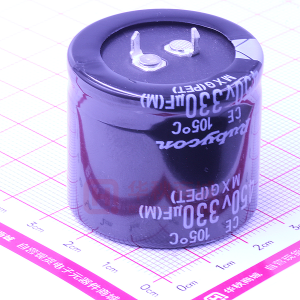

L ARGE CAN TYPE ALUMINUM ELECTROLYTIC CAPACITORS MXG MXG SERIES 105℃ Miniaturized, Snap-in Terminal Type ◆FEATURES • Load Life : 105℃ 2000 hours. • Smaller size than MXC series. • RoHS compliance. ◆SPECIFICATIONS Items Category Temperature Range Rated Voltage Range Capacitance Tolerance I=3 CV Leakage Current(MAX) Characteristics −25∼+105℃ 160∼450V.DC ±20%(20℃,120Hz) (After 5 minutes application of rated voltage) I=Leakage Current(μA)     V=Rated Voltage(V)     C=Rated Capacitance(μF) Dissipation Factor(MAX) (tanδ) Rated Voltage 160∼250 (V) Z (−25℃)(20℃) /Z 4 0.2(20℃,120Hz) 400∼450 8 Impedance Ratio(MAX) (120Hz) After applying rated voltage with rated ripple current for 2000hrs at 105℃, the capacitors shall meet the following requirements. Capacitance Change Dissipation Factor Leakage Current Within ±20% of the initial value. Not more than 200% of the specified value. Not more than the specified value. Endurance ◆MULTIPLIER FOR RIPPLE CURRENT  Frequency coefficient Frequency Coefficient 60 50) 120 ( (Hz) 160∼250WV 0.80 1.00 400∼450WV 0.80 1.00 500 1.20 1.20 1k 1.30 1.25 10k≦ 1.50 1.40 ◆PART NUMBER □□□ Rated Voltage MXG Series □□□□□ Rated Capacitance □ Capacitance Tolerance OOE Option SN Terminal Code D×L Case Size ◆Option Code without plate with plate ◆DIMENSIONS ●SN [4(3.5)mm]terminal type (mm) OOE Blank VENT SLEEVE 2-φ2 NEGATIVE 10 10±0.1 L±2 ※ 4±0.5 ※For φ35, 3.5±0.5 φD±1 φD±1 MOUNTING HOLES L ARGE CAN TYPE ALUMINUM ELECTROLYTIC CAPACITORS MXG ◆STANDARD SIZE, RATED RIPPLE CURRENT Cap (μF) WV φ D 330 390 470 560 680 820 1000 1200 1500 1800 2200 2700 Cap (μF) WV φ D 160 φ20 φ22 φ25 φ30 φ35 20×25 1.17 20×25 1.28 20×30 1.40 22×25 1.40 20×35 1.50 22×30 1.50 20×40 1.70 22×30 1.70 25×25 1.70 22×35 2.00 25×30 2.00 22×40 2.20 25×35 2.20 30×25 2.20 25×40 2.30 30×30 2.30 35×25 2.30 25×45 2.50 30×35 2.50 35×30 2.50 30×40 2.70 35×35 2.70 30×45 2.90 35×40 2.90 35×45 3.10 200 φ25 φ20 20×25 1.20 20×30 1.28 20×35 1.38 20×40 1.50 20×45 1.70 φ22 22×25 22×30 22×30 22×35 22×40 180 φ25 φ30 φ35 1.28 1.38 1.50 25×25 1.50 1.70 25×30 1.70 2.00 25×35 2.00 30×25 25×40 2.20 30×30 25×45 2.30 30×35 25×50 2.50 30×40 30×45 30×50 2.00 2.20 2.30 2.50 2.70 2.90 35×25 35×30 35×30 35×35 35×40 35×50 2.20 2.30 2.50 2.70 2.90 3.10 φ20 20×25 20×30 20×30 20×35 20×40 0.99 1.20 1.34 1.48 1.60 φ22 φ30 φ35 220 270 330 390 470 560 680 820 1000 1200 1500 1800 2200 Cap (μF) WV φ D 22×25 22×25 22×30 22×35 22×40 22×45 1.20 1.34 1.48 1.60 1.75 2.04 25×25 25×25 25×30 25×35 25×45 25×50 1.48 1.60 1.75 2.04 2.30 2.65 φ20 20×25 0.98 20×30 1.08 20×30 1.26 20×35 1.34 20×40 1.48 20×45 1.61 φ22 22×25 22×25 22×30 22×35 22×40 22×45 22×50 1.08 1.26 1.34 1.48 1.61 1.78 1.93 220 φ25 φ30 φ35 30×25 30×25 30×30 30×35 30×45 30×50 1.75 2.04 2.30 2.65 35×30 2.65 2.80 35×35 2.80 3.08 35×40 3.08 35×45 3.48 25×25 25×25 25×30 25×35 25×40 25×50 1.34 1.48 1.61 1.78 1.93 2.33 30×25 30×25 30×30 30×35 30×40 30×50 1.61 1.78 1.93 2.33 2.50 2.76 35×25 35×30 35×35 35×40 35×45 1.93 2.33 2.50 2.76 3.11 φ20 φ22 250 φ25 φ30 φ35 68 82 100 120 150 180 220 270 330 390 470 560 680 820 1000 1200 1500 1800 Cap (μF) WV φ D φ20 20×25 0.49 20×25 0.57 20×30 0.70 20×35 0.75 20×40 0.88 φ22 22×25 22×25 22×30 22×35 22×35 22×45 22×50 0.57 0.70 0.75 0.88 0.95 1.10 1.22 400 φ25 φ30 φ35 20×25 20×30 20×35 20×40 20×45 1.00 1.10 1.20 1.30 1.40 22×25 22×30 22×35 22×40 22×45 22×50 1.10 1.20 1.30 1.40 1.50 1.70 25×25 25×25 25×30 25×35 25×40 25×45 1.20 1.30 1.40 1.50 1.70 2.00 25×25 25×25 25×30 25×35 25×40 25×45 25×50 0.75 0.88 0.95 1.10 1.22 1.44 1.55 30×25 30×25 30×30 30×35 30×40 30×45 1.40 1.50 1.70 2.00 2.20 2.30 30×25 30×25 30×30 30×35 30×40 30×45 30×50 0.95 1.10 1.22 1.44 1.55 1.68 1.90 35×25 35×30 35×35 35×35 35×45 35×50 1.70 2.00 2.20 2.30 2.50 2.70 35×25 35×30 35×30 35×35 35×40 35×45 1.22 1.44 1.55 1.66 1.90 2.12 φ20 20×25 20×25 20×30 20×35 20×40 20×45 0.50 0.64 0.66 0.81 0.84 0.91 φ22 420 φ25 φ30 φ35 56 68 82 100 120 150 180 220 270 330 390 470 560 680 22×25 22×25 22×30 22×35 22×40 22×45 0.64 0.66 0.81 0.84 0.91 1.05 25×25 25×25 25×30 25×30 25×35 25×40 25×50 0.66 0.81 0.84 0.91 1.05 1.25 1.42 30×25 30×25 30×30 30×30 30×35 30×40 30×45 0.84 0.91 1.05 1.25 1.42 1.61 1.86 φ20 20×25 0.44 20×25 0.50 20×30 0.64 20×35 0.69 20×35 0.72 20×45 0.79 φ22 22×25 22×25 22×30 22×30 22×35 22×40 22×50 0.50 0.64 0.69 0.72 0.79 0.87 1.05 450 φ25 φ30 φ35 35×25 35×25 35×30 35×35 35×40 35×45 35×50 1.05 1.25 1.42 1.61 1.86 2.10 2.20 25×25 25×25 25×30 25×35 25×40 25×45 25×50 0.69 0.72 0.79 0.87 1.05 1.23 1.38 30×25 30×25 30×30 30×35 30×40 30×45 30×50 0.79 0.87 1.05 1.23 1.38 1.61 1.78 35×25 35×30 35×30 35×35 35×40 35×45 1.05 1.23 1.38 1.61 1.78 1.99 Ripple Current (A r.m.s./120Hz, 105℃) Case Size φD×L(mm)
