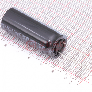

MINIATURE ALUMINUM ELECTROLYTIC CAPACITORS TXW TXW SERIES UPGRADE 105℃ Long Life(7000∼10000 hours), Miniaturized ◆FEATURES ・ Load Life : 105℃ 7000-10000 hours. ・ Body diameter of φ6.3 to φ18mm with high ripple current capability. ・ RoHS compliance. ◆SPECIFICATIONS Items Category Temperature Range Characteristics −40∼+105℃ 35∼100V.DV ±20% (20℃, 120Hz) I=0.01CV or 3μA whichever is greater. (After 2minites) −25∼+105℃ 160∼450V.DC Rated Voltage Range Capacitance Tolerance I=3 CV (After 5 minutes application of rated voltage) Leakage Current(MAX) I=(μA) Leakage Current C=(μF) Rated Capacitance V=(V) Rated Voltage (tanδ) Dissipation Factor(MAX) Rated Voltage tanδ 35 0.12 50 0.10 63 0.09 80 0.08 100 0.08 160∼400 420∼450 0.2 0.25 (20℃, 120Hz) After life test with rated Ripplle current at conditions stated in the table below, the capacitors shall meet the following requirements. 35∼100V.DC Endurance Capacitance Change Dissipation Factor Leakage Current 160∼450V.DC Case Size (hrs) Life Time Within ±25% of the initial value. Within ±20% of the initial value. Not more than 200% of the specified value. Not more than the specified value. φ6.3 φD≧8 7000 10000 Low Temperature Stability Impedance Ration(MAX) Rated Voltage 35 2 3 50 2 3 63 2 3 80 2 3 100 2 3 160∼250 350∼450 3 − 8 − (120Hz) Z (−25℃) (20℃) /Z Z (−40℃) (20℃) /Z ◆MULTIPLIER FOR RIPPLE CURRENT  Frequency Coefficient (35∼100WV) ◆OPTION Code 10k 100k≦ 1.00 1.00 1.00 1.00 (Hz)Frequency Coefficient 120 0.42 0.50 0.55 0.60 1k 0.70 0.73 0.77 0.80 PET Sleeve EFC 33μF 39∼270μF 330∼680μF 820∼1800μF 0.90 0.92 0.94 0.96 (160∼450WV) (Hz)Frequency Coefficient 60 (50) 0.80 0.80 120 1.00 1.00 500 1.20 1.25 1k 1.30 1.40 10k≦ 1.40 1.50 160∼250WV 350∼450WV ◆PART NUMBER □□□ Rated Voltage TXW Series □□□□□ Rated Capacitance M Capacitance Tolerance □□□ Option □□ Lead Forming D×L Case Size 2012_A MINIATURE ALUMINUM ELECTROLYTIC CAPACITORS TXW (mm) ◆DIMENSIONS SLEEVE(PET) ±0.5 φd φD φd F 35∼100V.DC 160∼450V.DC 6.3 0.5 2.5 - 8 3.5 2.0 F 10 0.6 12.5 16 0.8 7.5 - 18 5.0 2.5 L+α MAX 15MIN 4MIN φD+0.5MAX α ◆STANDARD SIZE Rated Voltage (V.DC) Rated Capacitance (μF) 180 220 330 390 390 35 470 680 820 820 1000 1200 1500 1800 100 120 180 220 220 50 270 390 470 470 560 680 820 1000 82 100 150 180 180 220 63 330 390 390 470 560 680 820 Size φD×L (㎜) 6.3×25 6.3×30 6.3×40 6.3×50 8×25 8×30 8×40 8×50 10×30 8×60 10×40 10×50 10×60 6.3×25 6.3×30 6.3×40 6.3×50 8×25 8×30 8×40 8×50 10×30 8×60 10×40 10×50 10×60 6.3×25 6.3×30 6.3×40 6.3×50 8×25 8×30 8×40 8×50 10×30 8×60 10×40 10×50 10×60 Ripple Current (A r.m.s.105℃) 120Hz 0.605 0.685 0.924 1.11 0.951 1.11 1.41 1.82 1.48 2.08 1.87 2.21 2.50 0.510 0.580 0.710 0.860 0.740 0.870 1.22 1.45 1.22 1.68 1.55 2.02 2.31 0.455 0.515 0.635 0.775 0.665 0.785 1.11 1.32 1.16 1.54 1.43 1.71 2.15 100kHz 1.21 1.37 1.68 2.02 1.73 2.03 2.57 3.04 2.47 3.48 3.12 3.69 4.17 1.02 1.16 1.42 1.72 1.48 1.74 2.23 2.65 2.22 3.07 2.82 3.37 3.86 0.910 1.03 1.27 1.55 1.33 1.57 2.02 2.41 2.10 2.80 2.60 3.12 3.59 100 80 Rated Voltage (V.DC) Rated Capacitance (μF) 47 56 82 100 100 120 180 220 220 270 270 390 470 33 39 56 68 82 100 120 150 150 220 220 270 330 Size φD×L (㎜) 6.3×25 6.3×30 6.3×40 6.3×50 8×25 8×30 8×40 8×50 10×30 8×60 10×40 10×50 10×60 6.3×25 6.3×30 6.3×40 6.3×50 8×25 8×30 8×40 8×50 10×30 8×60 10×40 10×50 10×60 Ripple Current (A r.m.s.105℃) 120Hz 0.455 0.515 0.635 0.775 0.665 0.785 1.01 1.20 1.05 1.40 1.30 1.71 1.97 0.382 0.515 0.635 0.775 0.665 0.785 1.01 1.20 1.05 1.40 1.30 1.56 1.97 100kHz 0.910 1.03 1.27 1.55 1.33 1.57 2.02 2.41 2.10 2.80 2.60 3.12 3.59 0.910 1.03 1.27 1.55 1.33 1.57 2.02 2.41 2.10 2.80 2.60 3.12 3.59 MINIATURE ALUMINUM ELECTROLYTIC CAPACITORS TXW ◆STANDARD SIZE Rated Voltage (V.DC) Rated Capacitance (μF) 56 68 82 82 100 120 120 150 150 180 160 180 220 220 220 270 330 330 330 390 390 390 470 470 560 560 680 820 39 56 68 68 82 82 100 100 120 120 150 150 180 200 180 180 220 220 220 270 270 270 330 330 330 390 390 470 470 560 Size φD×L (㎜) 8×25 8×30 8×35 10×25 8×40 8×55 10×30 10×40 12.5×25 10×50 12.5×30 10×60 12.5×35 16×25 12.5×40 12.5×50 16×30 18×25 12.5×55 16×35 18×30 16×40 18×35 16×50 18×40 18×45 18×50 8×25 8×30 8×40 10×25 8×45 10×30 8×55 10×40 10×45 12.5×25 10×50 12.5×30 10×60 12.5×35 16×25 12.5×45 16×30 18×25 12.5×50 16×30 18×30 12.5×60 16×40 18×30 16×45 18×35 16×50 18×40 18×45 Ripple Current (A r.m.s.105℃) 120Hz 0.32 0.37 0.43 0.43 0.49 0.57 0.54 0.67 0.66 0.80 0.77 0.94 0.89 0.93 1.01 1.20 1.20 1.18 1.35 1.34 1.40 1.52 1.58 1.79 1.78 2.00 2.23 0.30 0.37 0.45 0.43 0.51 0.50 0.60 0.63 0.75 0.65 0.83 0.80 0.91 0.92 0.85 1.09 1.01 1.00 1.26 1.18 1.16 1.36 1.31 1.30 1.43 1.43 1.58 1.58 1.77 100kHz 0.448 0.518 0.602 0.602 0.686 0.798 0.756 0.938 0.924 1.12 1.07 1.31 1.24 1.30 1.41 1.68 1.68 1.65 1.89 1.87 1.96 2.12 2.21 2.50 2.49 2.80 3.12 0.420 0.518 0.630 0.602 0.714 0.700 0.840 0.882 1.05 0.910 1.16 1.12 1.27 1.28 1.19 1.52 1.41 1.40 1.76 1.65 1.62 1.90 1.83 1.82 2.00 2.00 2.21 2.21 2.47 250 220 Rated Voltage (V.DC) Rated Capacitance (μF) 100 120 120 150 150 180 180 220 220 220 270 270 330 390 470 27 39 47 47 56 56 68 68 82 82 100 100 120 120 120 150 150 180 180 180 220 220 220 270 270 330 330 390 470 Size φD×L (㎜) 10×40 10×45 12.5×30 12.5×35 16×25 12.5×40 16×30 12.5×50 16×30 18×25 16×35 18×30 18×35 18×40 18×45 8×25 8×30 8×35 10×25 8×40 10×30 8×50 10×35 10×40 12.5×25 10×45 12.5×30 10×55 12.5×35 16×25 12.5×40 16×30 12.5×50 16×30 18×25 12.5×55 16×35 18×30 16×40 18×35 16×50 18×40 18×45 18×50 Ripple Current (A r.m.s.105℃) 120Hz 0.66 0.75 0.74 0.86 0.80 0.99 0.94 1.08 1.01 0.94 1.19 1.13 1.30 1.49 1.69 0.30 0.37 0.45 0.37 0.51 0.42 0.59 0.49 0.61 0.54 0.68 0.69 0.73 0.79 0.74 0.92 0.89 0.97 0.95 0.88 1.13 1.11 1.10 1.27 1.23 1.48 1.42 1.59 1.83 100kHz 0.924 1.05 1.03 1.20 1.12 1.38 1.31 1.51 1.41 1.31 1.66 1.58 1.82 2.08 2.36 0.420 0.518 0.630 0.518 0.714 0.588 0.826 0.686 0.854 0.756 0.952 0.966 1.02 1.10 1.03 1.28 1.24 1.35 1.33 1.23 1.58 1.55 1.54 1.77 1.72 2.07 1.98 2.22 2.56 MINIATURE ALUMINUM ELECTROLYTIC CAPACITORS TXW ◆STANDARD SIZE Rated Voltage (V.DC) Rated Capacitance (μF) 22 27 33 33 350 39 39 47 47 56 68 12 15 18 22 22 27 27 33 33 39 39 47 47 400 56 56 68 68 82 82 82 100 100 100 120 120 150 150 180 Size φD×L (㎜) 8×30 8×35 8×40 10×25 8×45 10×30 8×60 10×35 10×40 10×55 8×25 8×30 8×35 8×40 10×25 8×45 10×30 8×55 10×35 10×40 12.5×25 10×45 12.5×30 10×50 12.5×35 12.5×40 16×25 12.5×45 16×30 18×25 12.5×60 16×35 18×30 16×40 18×35 16×50 18×40 18×45 Ripple Current (A r.m.s.105℃) 120Hz 0.25 0.29 0.33 0.31 0.37 0.36 0.43 0.41 0.47 0.55 0.17 0.20 0.23 0.26 0.24 0.30 0.29 0.35 0.33 0.40 0.36 0.45 0.44 0.52 0.50 0.58 0.51 0.65 0.61 0.61 0.75 0.74 0.74 0.80 0.79 0.95 0.91 1.04 100kHz 0.375 0.435 0.495 0.465 0.555 0.540 0.645 0.615 0.705 0.825 0.255 0.300 0.345 0.390 0.360 0.450 0.435 0.525 0.495 0.600 0.540 0.675 0.660 0.780 0.750 0.870 0.765 0.975 0.915 0.915 1.12 1.11 1.11 1.20 1.18 1.42 1.36 1.56 450 420 Rated Voltage (V.DC) Rated Capacitance (μF) 12 15 18 22 33 39 39 47 56 56 68 68 82 82 82 100 100 120 150 12 15 18 33 33 39 39 47 47 56 56 68 68 68 82 82 100 120 150 Size φD×L (㎜) 8×30 8×35 8×40 8×50 10×40 10×45 12.5×30 12.5×35 12.5×40 16×25 12.5×45 16×30 12.5×50 16×35 18×25 16×40 18×30 18×35 18×40 8×30 8×40 8×45 10×40 12.5×30 10×50 12.5×35 12.5×40 16×25 12.5×45 16×30 12.5×50 16×35 18×25 16×40 18×30 18×35 18×40 18×45 Ripple Current (A r.m.s.105℃) 120Hz 0.13 0.17 0.20 0.25 0.37 0.41 0.39 0.45 0.52 0.46 0.58 0.55 0.66 0.63 0.56 0.73 0.67 0.77 0.90 0.15 0.19 0.21 0.36 0.37 0.41 0.42 0.48 0.44 0.53 0.51 0.62 0.59 0.57 0.68 0.65 0.74 0.83 0.95 100kHz 0.195 0.255 0.300 0.375 0.555 0.615 0.585 0.675 0.780 0.690 0.870 0.825 0.990 0.945 0.840 1.09 1.00 1.15 1.35 0.225 0.285 0.315 0.540 0.555 0.615 0.630 0.720 0.660 0.795 0.765 0.930 0.885 0.855 1.02 0.975 1.11 1.24 1.42 A custom design of the follow products is available. Please contact our sales office. WV Cap(μF) 82 450 100 120 150 Size(mm) 18×30 18×35 18×40 18×41 Ripple Current(A r.m.s. / 105℃) 120Hz 10kHz 100kHz 0.65 0.74 0.93 0.95 1.07 1.28 1.63 1.81 1.11 1.34 1.70 1.90 ※Multipler for Ripple Current is not applicable
