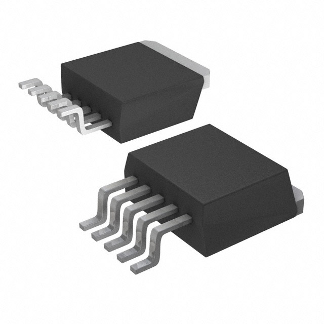

    IC REG BUCK 9V 1.5A TO263-5
SI-8090JD-TL 数据手册
1.5 A, Buck Converter IC SI-8000JD Series Data Sheet Description Package SI-8000JD series are buck converter ICs whose maximum output current is 1.5 A. These products have various functions including the Output On/Off Function, the Overcurrent Protection and the Thermal Shutdown, and achieve a buck converter circuit with few external components. TO263-5L Features Not to scale ● High Efficiency 88% (SI-8120JD: VIN = 24 V, IOUT = 0.5 A) ● Few Components ● Downsized Choke Coil (Switching Frequency 125 kHz (typ.)) ● Fixed Output Voltage ● On/Off Function ● Low Supply Current during Output Off ● Protection Functions Overcurrent Protections (OCP): Fold-back Type, Auto-restart Thermal Shutdown (TSD): Auto-restart Selection Guide Part Number SI-8033JD SI-8050JD SI-8090JD SI-8120JD Output Voltage 3.3 V 5V 9V 12 V Applications For the systems requiring power supplies such as: ● Audio Visual Equipment ● Office Automation Equipment (e.g., Printer) ● Onboard power supply Typical Application VIN SW GND VOS ON/OFF SI-8000JD 1 VIN CIN 2 3 4 5 L1 VOUT D1 COUT GND GND SI-8000JD-DSE Rev.2.1 SANKEN ELECTRIC CO., LTD. Sep. 03, 2020 https://www.sanken-ele.co.jp/en © SANKEN ELECTRIC CO., LTD. 2011 1 SI-8000JD Contents Description ------------------------------------------------------------------------------------------------------ 1 Contents --------------------------------------------------------------------------------------------------------- 2 1. Absolute Maximum Ratings----------------------------------------------------------------------------- 3 2. Thermal Resistance Characteristics ------------------------------------------------------------------- 3 3. Recommended Operating Conditions ----------------------------------------------------------------- 4 4. Electrical Characteristics -------------------------------------------------------------------------------- 5 4.1. SI-8033JD --------------------------------------------------------------------------------------------- 5 4.2. SI-8050JD --------------------------------------------------------------------------------------------- 6 4.3. SI-8090JD --------------------------------------------------------------------------------------------- 7 4.4. SI-8120JD --------------------------------------------------------------------------------------------- 8 5. Block Diagram --------------------------------------------------------------------------------------------- 9 6. Pin Configuration Definitions --------------------------------------------------------------------------- 9 7. Typical Application ------------------------------------------------------------------------------------- 10 8. Physical Dimensions ------------------------------------------------------------------------------------ 11 8.1. Land Pattern Example --------------------------------------------------------------------------- 11 9. Marking Diagram --------------------------------------------------------------------------------------- 12 10. Operational Description ------------------------------------------------------------------------------- 13 10.1. PWM Output Voltage Control------------------------------------------------------------------ 13 10.2. Input/output Current and Inductor Current ------------------------------------------------ 13 10.3. Overcurrent Protection Function (OCP) ----------------------------------------------------- 14 10.4. Thermal Shutdown (TSD) ----------------------------------------------------------------------- 14 10.5. Output On/Off Function ------------------------------------------------------------------------- 14 11. Design Notes ---------------------------------------------------------------------------------------------- 15 11.1. Selecting External Components ---------------------------------------------------------------- 15 11.1.1. Inductor, L1 ---------------------------------------------------------------------------------- 15 11.1.2. Input Capacitor, CIN ------------------------------------------------------------------------ 15 11.1.3. Output Capacitor, COUT -------------------------------------------------------------------- 16 11.1.4. Freewheeling Diode, D1 -------------------------------------------------------------------- 17 11.1.5. Spike Noise Reduction ---------------------------------------------------------------------- 17 11.1.6. Reverse Biasing Protection ---------------------------------------------------------------- 18 11.2. PCB Layout----------------------------------------------------------------------------------------- 18 11.2.1. High Current Line -------------------------------------------------------------------------- 18 11.2.2. Input/ Output Capacitor ------------------------------------------------------------------- 18 11.3. Operational Waveforms Confirmation ------------------------------------------------------- 19 11.4. Thermal Design ------------------------------------------------------------------------------------ 20 12. Pattern Layout Example ------------------------------------------------------------------------------- 21 13. Typical Characteristics --------------------------------------------------------------------------------- 22 13.1. SI-8033JD ------------------------------------------------------------------------------------------- 22 13.2. SI-8050JD ------------------------------------------------------------------------------------------- 23 13.3. SI-8090JD ------------------------------------------------------------------------------------------- 25 13.4. SI-8120JD ------------------------------------------------------------------------------------------- 26 13.6. Thermal Derating Curve------------------------------------------------------------------------- 28 Important Notes ---------------------------------------------------------------------------------------------- 29 SI-8000JD-DSE Rev.2.1 SANKEN ELECTRIC CO., LTD. Sep. 03, 2020 https://www.sanken-ele.co.jp/en © SANKEN ELECTRIC CO., LTD. 2011 2 SI-8000JD 1. Absolute Maximum Ratings Current polarities are defined as follows: current going into the IC (sinking) is positive current (+); current coming out of the IC (sourcing) is negative current (−). Unless specifically noted, TA = 25 °C. Parameter Symbol Conditions Rating Unit Remarks Input Voltage VIN Allowable Power Dissipation PD (1) (2) 43 V 3 W Junction Temperature TJ 125 °C Storage Temperature TSTG −40 to 125 °C (1) Limited by the thermal shutdown. Glass-epoxy board (40 mm × 40 mm), copper area 100% (2) 2. Thermal Resistance Characteristics Parameter Symbol Thermal Resistance between Junction and Ambient Thermal Resistance between Junction and Lead θJ-A θJ-L Conditions Mounted on the board.* See Figure 2-1. Min. Typ. Max. Unit — — 33.3 °C/W — — 3 °C/W TC Figure 2-1. * Case Temperature Measurement Point Glass-epoxy board (40 mm × 40 mm), copper area 100% SI-8000JD-DSE Rev.2.1 SANKEN ELECTRIC CO., LTD. Sep. 03, 2020 https://www.sanken-ele.co.jp/en © SANKEN ELECTRIC CO., LTD. 2011 3 SI-8000JD 3. Recommended Operating Conditions Parameter Input Voltage Symbol VIN Conditions Min. Max. Unit IOUT = 0 A to 1 A 5.3 40 V IOUT = 0 A to 1.5 A 6.3 40 V IOUT = 0 A to 1 A 7 40 V IOUT = 0 A to 1.5 A 8 40 V IOUT = 0 A to 1 A 11 40 V IOUT = 0 A to 1.5 A 12 40 V IOUT = 0 A to 1 A 14 40 V IOUT = 0 A to 1.5 A 15 40 V VIN ≥ VOUT + 3 V 0 1.5 A * IOUT Operating Junction Temperature TJOP −30 125 °C Operating Ambient Temperature* TOP −30 125 °C Output Current * Remarks SI-8033JD SI-8050JD SI-8090JD SI-8120JD Must be used in the range of thermal derating (see Figure 13-25). SI-8000JD-DSE Rev.2.1 SANKEN ELECTRIC CO., LTD. Sep. 03, 2020 https://www.sanken-ele.co.jp/en © SANKEN ELECTRIC CO., LTD. 2011 4 SI-8000JD 4. Electrical Characteristics 4.1. SI-8033JD Current polarities are defined as follows: a current flow going into the IC (sinking) is positive current (+); and a current flow coming out of the IC (sourcing) is negative current (−). Unless otherwise specified, TA = 25 °C. Parameter Output Voltage Output Voltage Coefficient Temperature Symbol Conditions Min. Typ. Max. Unit VOUT VIN = 15 V, IOUT = 0.5 A 3.234 3.30 3.366 V — ±0.5 — mV/°C ΔVOUT/Δ T Efficiency Η VIN = 15 V, IOUT = 0.5 A — 77 — % Operating Frequency fO VIN = 15 V, IOUT = 0.5 A — 125 — kHz VIN = 8 V to 30 V, IOUT = 0.5 A VIN = 15 V, IOUT = 0.2 A to 0.8 A — 25 80 mV — 10 30 mV VIN = 15 V 1.6 — — A — — 0.5 V VONOFF_L = 0 V — — 100 μA VIN = 15 V, IOUT = 0 A — 7 — mA VIN = 15 V, VONOFF_L = 0.3 A — — 200 μA Line Regulation VLINE Load Regulation VLOAD Overcurrent Current Protection Start IS ON/OFF Pin Low Level Voltage VONOFF_L ON/OFF Pin Source Current at Low Level IONOFF_L Quiescent Current 1 IQ Quiescent Current 2 IQ(OFF)  Efficiency is calculated by the following equation. η(%) = VOUT × IOUT × 100 VIN × IIN SI-8000JD-DSE Rev.2.1 SANKEN ELECTRIC CO., LTD. Sep. 03, 2020 https://www.sanken-ele.co.jp/en © SANKEN ELECTRIC CO., LTD. 2011 5 SI-8000JD 4.2. SI-8050JD Current polarities are defined as follows: a current flow going into the IC (sinking) is positive current (+); and a current flow coming out of the IC (sourcing) is negative current (−). Unless otherwise specified, TA = 25 °C. Parameter Output Voltage Output Voltage Temperature Coefficient Symbol Conditions Min. Typ. Max. Unit VOUT VIN = 20 V, IOUT = 0.5 A 4.9 5.0 5.1 V — ±0.5 — mV/°C ΔVOUT/ΔT Efficiency  η VIN = 20 V, IOUT = 0.5 A — 82 — % Operating Frequency fO VIN = 20 V, IOUT = 0.5 A — 125 — kHz VIN = 10 V to 30 V, IOUT = 0.5 A VIN = 20 V, IOUT = 0.2 A to 0.8 A — 40 100 mV — 10 40 mV VIN = 20 V 1.6 — — A — — 0.5 V VONOFF_L = 0 V — — 100 μA VIN = 20 V, IOUT = 0 A — 7 — mA — 200 μA Line Regulation VLINE Load Regulation VLOAD Overcurrent Protection Start Current ON/OFF Pin Low Level Voltage ON/OFF Pin Source Current at Low Level IS VONOFF_L IONOFF_L Quiescent Current 1 IQ Quiescent Current 2 IQ(OFF)  VIN = 20 V, VONOFF_L = 0.3 A Efficiency is calculated by the following equation. η(%) = VOUT × IOUT × 100 VIN × IIN SI-8000JD-DSE Rev.2.1 SANKEN ELECTRIC CO., LTD. Sep. 03, 2020 https://www.sanken-ele.co.jp/en © SANKEN ELECTRIC CO., LTD. 2011 6 SI-8000JD 4.3. SI-8090JD Current polarities are defined as follows: a current flow going into the IC (sinking) is positive current (+); and a current flow coming out of the IC (sourcing) is negative current (−). Unless otherwise specified, TA = 25 °C. Parameter Output Voltage Output Voltage Temperature Coefficient Symbol VOUT Conditions VIN = 21 V, IOUT = 0.5 A ΔVOUT/ΔT Min. Typ. Max. Unit 8.82 9.00 9.18 V — ±1.0 — mV/°C Efficiency  η VIN = 21 V, IOUT = 0.5 A — 86 — % Operating Frequency fO VIN = 21 V, IOUT = 0.5 A — 125 — kHz VIN = 15 V to 30 V, IOUT = 0.5 A VIN = 21 V, IOUT = 0.2 A to 0.8 A — 50 120 mV — 10 40 mV VIN = 21 V 1.6 — — A — — 0.5 V VONOFF_L = 0 V — — 100 μA VIN = 21 V, IOUT = 0 A — 7 — mA VIN = 21 V, VONOFF_L = 0.3 A — — 200 μA Line Regulation VLINE Load Regulation VLOAD Overcurrent Protection Start Current IS ON/OFF Pin Low Level Voltage VONOFF_L ON/OFF Pin Source Current at Low Level IONOFF_L Quiescent Current 1 IQ Quiescent Current 2 IQ(OFF)  Efficiency is calculated by the following equation. η(%) = VOUT × IOUT × 100 VIN × IIN SI-8000JD-DSE Rev.2.1 SANKEN ELECTRIC CO., LTD. Sep. 03, 2020 https://www.sanken-ele.co.jp/en © SANKEN ELECTRIC CO., LTD. 2011 7 SI-8000JD 4.4. SI-8120JD Current polarities are defined as follows: a current flow going into the IC (sinking) is positive current (+); and a current flow coming out of the IC (sourcing) is negative current (−). Unless otherwise specified, TA = 25 °C. Parameter Output Voltage Output Voltage Temperature Coefficient Symbol VOUT Conditions VIN = 24 V, IOUT = 0.5 A ΔVOUT/ΔT Min. Typ. Max. Unit 11.76 12.00 12.24 V — ±1.0 — mV/°C Efficiency  η VIN = 24 V, IOUT = 0.5 A — 88 — % Operating Frequency fO VIN = 24 V, IOUT = 0.5 A — 125 — kHz VIN = 18 V to 30 V, IOUT = 0.5 A VIN = 24 V, IOUT = 0.2 A to 0.8 A — 60 130 mV — 10 40 mV VIN = 24 V 1.6 — — A — — 0.5 V VONOFF_L = 0 V — — 100 μA VIN = 24 V, IOUT = 0 A — 7 — mA VIN = 24 V, VONOFF_L = 0.3 A — — 200 μA Line Regulation VLINE Load Regulation VLOAD Overcurrent Protection Start Current IS ON/OFF Pin Low Level Voltage VONOFF_L ON/OFF Pin Source Current at Low Level IONOFF_L Quiescent Current 1 IQ Quiescent Current 2 IQ(OFF)  Efficiency is calculated by the following equation. η(%) = VOUT × IOUT × 100 VIN × IIN SI-8000JD-DSE Rev.2.1 SANKEN ELECTRIC CO., LTD. Sep. 03, 2020 https://www.sanken-ele.co.jp/en © SANKEN ELECTRIC CO., LTD. 2011 8 SI-8000JD 5. Block Diagram VIN 1 2 SW Internal Regulator ON/OFF 5 Overcurrent Protection ON/OFF Reset Latch and Driver OSC Comp. Thermal Shutdown Error amp. 4 VOS Reference Voltage 3 GND Pin Configuration Definitions VIN SW GND VOS ON/OFF 6. 1 2 3 4 5 Pin Number 1 Pin Name VIN 2 SW 3 GND Ground 4 VOS 5 ON/OFF Feedback Pin On/off signal input, open if on/off function is not used. Description Input pin Output pin SI-8000JD-DSE Rev.2.1 SANKEN ELECTRIC CO., LTD. Sep. 03, 2020 https://www.sanken-ele.co.jp/en © SANKEN ELECTRIC CO., LTD. 2011 9 SI-8000JD 7. Typical Application VIN SW GND VOS ON/OFF SI-8000JD 1 2 3 4 5 L1 VIN VOUT CIN D1 COUT GND GND Figure 7-1. Typical Application Table 7-1. Reference Value of External Components Symbol Part Type Reference Value Remarks CIN Electrolytic capacitor 50 V/220 μF See Section 11.1.2. COUT Electrolytic capacitor 50 V/470 μF See Section 11.1.3. 60 V, 2 A See Section 11.1.4. 100 μH See Section 11.1.1. D1 Schottky diode L1 Choke coil SI-8000JD-DSE Rev.2.1 SANKEN ELECTRIC CO., LTD. Sep. 03, 2020 https://www.sanken-ele.co.jp/en © SANKEN ELECTRIC CO., LTD. 2011 10 SI-8000JD 8. Physical Dimensions ● TO263-5L E L1 A (E) H D D1 L4 (L1) C2 E1 A2 A1 c e L c Symbol A A1 A2 b b1 c c1 C2 D D1 E E1 e b L3 b PLATING b1 c c1 BASE METAL SECTION C-C H L L1 L3 L4 θ θ1 θ2 Min. 4.40 0 2.59 0.77 0.76 0.34 0.33 1.22 9.05 6.86 10.06 7.50 Nom. 4.57 0.10 2.69 — 0.81 — 0.38 — 9.15 — 10.16 — 1.70 BSC 14.70 15.10 2.00 2.30 1.17 1.27 0.25 BSC 2.00 REF 0° — 5° 7° 1° 3° Max. 4.70 0.25 2.79 0.90 0.86 0.47 0.43 1.32 9.25 7.50 10.26 8.30 15.50 2.60 1.40 8° 9° 5° NOTES: ● Dimensions in millimeters ● Bare lead frame: Pb-free (RoHS compliant) ● Dimensions do not include mold burrs. 8.1. Land Pattern Example 11 ±0.2 9 ±0.2 6.8 ±0.1 9 ±0.1 3.7 ±0.05 4 ±0.1 1.7 ±0.1 1 ±0.05 Dimensions in millimeters SI-8000JD-DSE Rev.2.1 SANKEN ELECTRIC CO., LTD. Sep. 03, 2020 https://www.sanken-ele.co.jp/en © SANKEN ELECTRIC CO., LTD. 2011 11 SI-8000JD 9. Marking Diagram Specific Device Code (See Table 9-1) YMDXXX 1 Lot Number Y is the last digit of the year of manufacture (0 to 9) M is the month of the year (1 to 9, O, N, or D) D is the period of days represented by: 1: the first 10 days of the month (1st to 10th) 2: the second 10 days of the month (11th to 20th) 3: the last 1 –11 days of the month (21st to 31st) XXX is the control number 5 Table 9-1. Specific Device Code Specific Device Code Part Number 8033JD SI-8033JD 8050JD SI-8050JD 8090JD SI-8090JD 8120JD SI-8120JD SI-8000JD-DSE Rev.2.1 SANKEN ELECTRIC CO., LTD. Sep. 03, 2020 https://www.sanken-ele.co.jp/en © SANKEN ELECTRIC CO., LTD. 2011 12 SI-8000JD 10. Operational Description All the characteristic values given in this section are typical values, unless they are specified as minimum or maximum. 10.1. PWM Output Voltage Control The SI-8000JD series control the output voltage by the PWM method and have a built-in PWM comparator, oscillator, error amplifier, reference voltage, output transistor drive circuit, etc. The PWM comparator outputs the switching transistor control signal as a square wave by comparing the triangular wave output (≈125 kHz) from the oscillator with the error amplifier output. The PWM comparator controls the switching transistor to turn on during the period when the error amplifier output exceeds the oscillator output. When the output voltage rises, the output of the error amplifier decreases because the error amplifier is an inverting type. When the error amplifier output decreases, the period below the oscillator triangle wave level decreases. Thus, the turn-on period of the switching transistor is shortened. In this way, the output voltage is regulated by changing the turn-on time of the switching transistor with the switching frequency fixed. The higher the V IN, the shorter the turn-on period of the switching transistor. The square wave output of the switching transistor is smoothed by an LC low-pass filter consisting of an inductor and a capacitor. As a result, a regulated DC voltage is supplied to the load. Switching Transistor VIN L1 PWM Comparator D1 Drive Circuit VOUT 10.2. Input/output Current and Inductor Current The square wave output generated by the switching transistor built in the IC is smoothed by the LC filter composed of the inductor and the output capacitor, and converted to the DC output voltage. The operation of the LC filter significantly affects the stable operation of the switching regulator. Figure 10-3 shows the schematic diagram of the current flowing through the circuit, and Figure 10-4 shows the waveforms of the current flowing through each element. ITR IL = ITR + IDI L1 TR VIN D1 Figure 10-3. IDI COUT IOUT Schematic Diagram of Circuit Current TON TOFF TR Emitter Voltage (Switching Output) VIN ITR ILP 0 COUT IIN IDI ILP Oscillator Error Amplifier 0 Reference Voltage IL ΔIL Figure 10-1. IOUT Basic Structure of Switching Regulator with PWM Control 0 Figure 10-4. Oscillator Output Error Amplifier Output ON OFF Figure 10-2. Switching Transistor Output PWM Comparator Operation Diagram ILP Waveforms of Current through Each Element As shown in Figure 10-3, the current, IL, flowing through the inductor has a triangular waveform. This triangular waveform is composed of two types of current components, ITR and IDI. The current, ITR, is the current supplied from the input side through the transistor at transistor turn-on, and the average value is the input current, IIN. The current, IDI, is the current that the energy SI-8000JD-DSE Rev.2.1 SANKEN ELECTRIC CO., LTD. Sep. 03, 2020 https://www.sanken-ele.co.jp/en © SANKEN ELECTRIC CO., LTD. 2011 13 SI-8000JD stored in the inductor is commutated through the freewheeling diode at transistor turn-off. The inductor current, IL, is the sum of ITR and IDI. Moreover, the average IL is the DC output current, IOUT, because the triangular wave component on which IL is superimposed is smoothed by the capacitor, COUT. 10.5. Output On/Off Function Output can be turned on/off using the ON/OFF pin. To use on/off function, connect a transistor as shown in Figure 10-7. When the ON/OFF pin voltage decreases to be VONOFF_L or lower, the output is stopped. U1 10.3. Overcurrent Protection Function (OCP) The IC has the fold-back type overcurrent protection (OCP) circuit. The overcurrent protection circuit detects the peak current of the switching transistor. When the peak current exceeds the set value, the current is limited by forcibly shortening the on-time of the transistor and reducing the output voltage. When the output voltage decreases further to 50% of the rated value, the switching frequency is decreased to about 40 kHz. As a result, the current increase at the low output voltage is suppressed. When the overcurrent state is released, the output voltage restarts automatically. Output Voltage SS 5 GND 3 Figure 10-7. On/Off Function By connecting C3 as shown in Figure 10-8, the rising delay time is set by using the on/off function. In this case, the discharge current of C3 flows through the transistor for on/off function. Therefore, protection such as current limiting is required when the capacitance of C3 is large. Oscillation frequency decreases at this point U1 GND SS 5 C3 3 Output Current Figure 10-5. Overcurrent Protection Characteristics 10.4. Thermal Shutdown (TSD) The thermal shutdown (TSD) circuit of the IC detects the junction temperature of the IC. When the junction temperature exceeds the set value, the TSD turns off the output by stopping the output transistor. When the junction temperature drops for about 15 °C from the thermal shutdown set value, the TSD automatically restarts the normal operation. Figure 10-8. Rising Delay Time Setting The voltage cannot be externally applied because the ON/OFF pin is pulled up to the internal power supply. Leave the ON/OFF pin open if the soft start function is not used. Output Voltage Restart Set Temperature Protection Set Temperature Junction Temperature Figure 10-6. Thermal Shutdown Characteristics SI-8000JD-DSE Rev.2.1 SANKEN ELECTRIC CO., LTD. Sep. 03, 2020 https://www.sanken-ele.co.jp/en © SANKEN ELECTRIC CO., LTD. 2011 14 SI-8000JD 11. Design Notes Low Inductance 11.1. Selecting External Components 11.1.1. Inductor, L1 a) An inductor should be for switching regulator Do not use an inductor for noise filter because it has a large loss. b) Rated current The inductor rated current must be larger than the maximum load current according to your application. When the load current exceeds the rated current of the inductor, the inductance decreases significantly, resulting in saturation. Note that in this state, the high frequency impedance decreases and an excessive current flows. c) Low noise In the open magnetic circuit core such as drum type, the peripheral circuit may be significantly affected by noise because the magnetic flux passes outside the coil. It is recommended to use a closed magnetic circuit core coil such as a toroidal type, EI type, or EE type. d) Inductance value should be appropriate The larger the inductance of the choke coil, the larger the external size of the coil. On the other hand, the ripple current flowing through the coil decreases and the output ripple voltage also decreases (see Figure 11-1). The smaller the inductance, the larger the peak current that flows through the switching transistor or diode. Thus, the loss increases and the ripple voltage also increases (see Figure 11-2). High Inductance COUT Figure 11-2. The inductor, L, supplies the current to the load side at switching transistor turn-off. For the regulator stable operation, it is required to avoid saturating the inductor and excessive self-heating. The following are the key considerations and the guidelines for selecting an inductor. Small Ripple Voltage, Current COUT Large Ripple Voltage, Current Ripple Voltage and Current (Low Inductance) Inductance is calculated by the Equation (1). L= (VIN − VOUT ) × VOUT ∆IL × VIN × f (1) In the Equation, (1), ΔIL shows the ripple current value of the choke coil, and the reference value is set as follows: ● When the output current in your application is close to the maximum rating (1.5 A): 0.2 to 0.3 times the output current ● When the output current in your application is approximately 0.5 A or less: 0.5 to 0.6 times the output current For example, when VIN = 25 V, VOUT = 5 V, ΔIL = 0.3 A, and f = 125 kHz, L is calculated as follows: L= (25 − 5) × 5 ≒ 106 μH 0.3 × 25 × 125 × 103 Thus, the inductor of about 100 μH should be selected. 11.1.2. Input Capacitor, CIN The input capacitor, CIN, operates as a bypass capacitor for the input circuit. CIN compensates for the voltage drop in the input side by supplying a steep current at switching to the regulator. Therefore, CIN should be placed as close as possible to the IC. When the smoothing capacitor of AC rectifier circuit is in the input circuit, the smoothing capacitor can also be used as the input capacitor. The following are the key considerations and the guidelines for selecting CIN. a) Within the rated voltage b) Within the allowable ripple current Figure 11-1. Ripple Voltage and Current (High Inductance) SI-8000JD-DSE Rev.2.1 SANKEN ELECTRIC CO., LTD. Sep. 03, 2020 https://www.sanken-ele.co.jp/en © SANKEN ELECTRIC CO., LTD. 2011 15 SI-8000JD for selecting COUT. U1 IIN VIN IL 1 VIN L1 Ripple current GND CIN Ripple current 3 ESR IP D = TON / T The ripple current of the output capacitor is equal to the ripple current of the choke coil and does not change even if the load current increases or decreases. As the load current increases, the ripple current of the input capacitor increases. Figure 11-3. Figure 11-4. CIN Current Flow Exceeding the rated voltage or the allowable ripple current or using without considering the derating may cause abnormal oscillation of the switching regulator as well as shorten the life of the capacitor. Therefore, select CIN with sufficient margin for the rated voltage and allowable ripple current. The ripple effective current, IRMS, flowing through the input capacitor is calculated by Equation (2). IRMS ≈ 1.2 × VOUT × IOUT VIN 5 × 1.5 = 0.45 A 20 Thus, select a capacitor that has an allowable ripple current of > 0.45 A. 11.1.3. Output Capacitor, COUT The output capacitor, COUT, operates as an LC lowpass filter along with the inductor, L1, and operates as a smoothing capacitor for switching output. The output capacitor is charged and discharged with a current equal to the ripple current of the choke coil, ΔIL. Therefore, as in the input capacitor, CIN, COUT is selected with sufficient margin and equivalent series resistance (ESR) for the rated voltage and allowable ripple current. The following are the key considerations and the guidelines COUT Current Flow ● Allowable ripple current The ripple effective current of the output capacitor is calculated by Equation (3). IRMS = ∆IL (3) 2√3 For example, when ΔIL is 0.5 A, IRMS is calculated as follows: (2) For example, when IOUT = 1.5 A, VIN = 20 V, and VOUT = 5 V, IRMS is calculated as follows: IRMS ≈ 1.2 × ΔIL 0 T IOUT COUT current waveform IV TON RL COUT CIN current waveform 0 VOUT IRMS = 0.5 2√3 ≈ 0.14 A Thus, select a capacitor that has an allowable ripple current of > 0.14 A. ● Equivalent series resistance (ESR) Select an appropriate value for ESR for stable operation. If the ESR is too large, the output ripple voltage increases, and abnormal oscillation may be caused. On the other hand, if the ESR is too small, the phase margin becomes insufficient. The output ripple voltage is determined by the product of the inductor ripple current, ΔIL (= COUT charge/discharge current) and ESR. For stable operation, the output ripple voltage should be 0.5% to 2% of the output voltage. The output ripple voltage is calculated using equations (4) and (5). ESR changes with temperature. Note that the ESR decreases at high temperatures. SI-8000JD-DSE Rev.2.1 SANKEN ELECTRIC CO., LTD. Sep. 03, 2020 https://www.sanken-ele.co.jp/en © SANKEN ELECTRIC CO., LTD. 2011 16 SI-8000JD VRIP 11.1.5. Spike Noise Reduction (VIN − VOUT ) × VOUT ≈ × ESR L1 × VIN × f (4) VRIP ≈ ∆IL × ESR (5) If the ESR is too small (about 1 mΩ to 3 mΩ or less), the phase delay becomes large and abnormal oscillation may occur. Do not use tantalum capacitors and monolithic ceramic capacitors alone for COUT as they have low ESR. When used at low temperature (0 °C or less), connecting a tantalum capacitor or a laminated ceramic capacitor in parallel with the electrolytic capacitor is effective in reducing the output ripple voltage. In order to further reduce the output ripple voltage, it is effective to add an LC filter to configure a pi filter (see Figure 11-5). When an LC filter is added, connect the point A to the VOS pin so that point A in Figure 11-5 is the output voltage detection point. If point A is not set as the output voltage detection point, abnormal oscillation may occur. To reduce spike noise, add a noise reduction circuit between the input and output of the IC and both ends of the freewheeling diode, D1. Note that the efficiency is decreased. When measuring spike noise with an oscilloscope, connect the probe to the root of the output capacitor with the shortest probe lead wire. If the probe ground lead wire is long, the spike noises may be measured abnormally large because the lead wire acts as an antenna. 0 Ω to 20 Ω 100 pF to 3000 pF U1 1 VIN SW 2 0 Ω to 20 Ω GND 3 D1 Figure 11-6. 100 pF to 4000 pF Spike Noise Reduction A U1 1 VIN L2 L1 SW 2 GND VOS 4 3 D1 COUT COUT2 Figure 11-5. Pi Filter (L2: 20 μH, COUT2: 200 μF) The output capacitor should be placed as close as possible to the IC. Figure 11-7. Without Noise Reduction Circuit 11.1.4. Freewheeling Diode, D1 The freewheel diode is used to release the energy stored in the inductor at switching off. Be sure to use a Schottky diode for the freewheeling diode. If a diode with a long recovery time and a large forward voltage, such as a general-purpose rectifier diode, is used, a reverse voltage is applied to the IC, which may damage the IC. The voltage output from the SW pin is close to the input voltage. Therefore, use a freewheeling diode whose reverse breakdown voltage is higher than the input voltage. Do not add ferrite beads to the freewheeling diode. Figure 11-8. SI-8000JD-DSE Rev.2.1 SANKEN ELECTRIC CO., LTD. Sep. 03, 2020 https://www.sanken-ele.co.jp/en © SANKEN ELECTRIC CO., LTD. 2011 With Noise Reduction Circuit 17 SI-8000JD 11.1.6. Reverse Biasing Protection CIN, COUT For the applications where the output pin voltage is higher than the input pin voltage (e.g., battery charger), add a diode for reverse bias protection between the input and output. CIN, COUT Improper Pattern Example Protection Diode Figure 11-11. Proper Pattern Example Pattern Example U1 1 VIN Figure 11-9. SW 2 Addition of Reverse Bias Protection Diode 11.2. PCB Layout 11.2.1. High Current Line Traces where the switching current flows (bold line in Figure 11-10) should be as wide and short as possible. L1 VIN 1 VIN CIN U1 VOUT SW 2 VOS 4 COUT GND 3 D1 GND GND Figure 11-10. High Current Line 11.2.2. Input/ Output Capacitor The input capacitor, CIN, and the output capacitor, COUT, must be placed as close as possible to the IC. When CIN and COUT are far from the IC, it may cause poor regulation or abnormal oscillation due to increased switching ripple. When a smoothing capacitor for the AC rectifier circuit is in the input side, the smoothing capacitor can also be used as the input capacitor. When the input smoothing capacitor and the IC are distant, connect an input capacitor separated from the smoothing capacitor. Since the large current is charged and discharged to the input/output capacitor at high speed, the lead wire should be as short as possible. The pattern of the capacitor should also be the shortest. SI-8000JD-DSE Rev.2.1 SANKEN ELECTRIC CO., LTD. Sep. 03, 2020 https://www.sanken-ele.co.jp/en © SANKEN ELECTRIC CO., LTD. 2011 18 SI-8000JD 11.3. Operational Waveforms Confirmation Whether the switching operation is normal can be confirmed by the waveform between the SW and GND pins of the IC. Figure 11-12 shows examples of waveforms in normal operation and abnormal oscillation. When the load current is large, the IC operates in continuous conduction mode. In continuous conduction mode, the period when the current through inductor becomes zero does not occur. The switching waveform has the shape of a normal square wave (waveform 1). When the load current is small, the IC operates in discontinuous conduction mode. In discontinuous conduction mode, the period when the current through inductor becomes zero occurs. The damped oscillation occurs in the switching waveform, which is normal operation (waveform 2). If the IC and CIN, COUT are distant from each other, abnormal on/off time of switching is disturbed, and abnormal oscillation occurs as shown in waveform 3 and waveform 4. 1. Normal operation (continuous conduction mode) 2. Normal operation (discontinuous conduction mode) 異常発振動作(C が離れている場合) 3. Abnormal oscillation IN (when CIN is distant) Figure 11-12. 異常発振動作(C が離れている場合) 4. Abnormal oscillationOUT (when COUT is distant) Waveform Examples SI-8000JD-DSE Rev.2.1 SANKEN ELECTRIC CO., LTD. Sep. 03, 2020 https://www.sanken-ele.co.jp/en © SANKEN ELECTRIC CO., LTD. 2011 19 SI-8000JD 11.4. Thermal Design Generally, the heat dissipation of an IC depends on the size and material of the board and the copper area. To improve the thermal performance, the copper area of the part where the backside of the IC is soldered should be as large as possible. Figure 13-25 shows the thermal derating of the IC. When using the IC, ensure a sufficient margin. Follow the procedure below to design heat dissipation. (1) Measure the maximum ambient temperature, TA(MAX) of the IC. (2) PD(MAX) is calculated by changing the input/output conditions and checking the power dissipation, PD. PD is calculated by Equation (6). Junction-to-Ambient Thermal Resistance, θJ-A (°C/W) 100 VO PD = VO × IO ( − 1) − VF × IO (1 − ) η VIN Where: VOUT is the output voltage VIN is the input voltage IOUT is the output current η is the efficiency (%) (calculated by Figure 13-1 and Figure 13-7) VF is D1 forward voltage (3) Determine the copper area by confirming the intersection of ambient temperature and power dissipation by the thermal derating characteristics shown in Figure 13-25. For reference, Figure 11-13 shows the relationship between the copper area and thermal resistance of a single-sided copper foil board, FR-4. (6) Glass-epoxy Board (40 mm × 40 mm) Copper Area (mm2) Figure 11-13. Thermal Resistance - Copper Area Reference Characteristics (Single-sided Copper Foil Board, FR-4)* * Limited by the condition of the input voltage and output current because the power dissipation of the IC package is 3 W. SI-8000JD-DSE Rev.2.1 SANKEN ELECTRIC CO., LTD. Sep. 03, 2020 https://www.sanken-ele.co.jp/en © SANKEN ELECTRIC CO., LTD. 2011 20 SI-8000JD 12. Pattern Layout Example Connect the ground traces to the GND pin at a single point. Place control components near the IC with a minimal length of PCB traces. Figure 12-1. Pattern Layout Example SI-8000JD-DSE Rev.2.1 SANKEN ELECTRIC CO., LTD. Sep. 03, 2020 https://www.sanken-ele.co.jp/en © SANKEN ELECTRIC CO., LTD. 2011 21 SI-8000JD 13. Typical Characteristics 13.1. SI-8033JD Efficiency, η (%) Output Voltage, VOUT (V) Unless specifically noted, TA = 25 °C. Output Current, IOUT (A) Figure 13-1. Efficiency Output Current, IOUT (A) Figure 13-2. Overcurrent Protection Characteristics Output Voltage, VOUT (V) Output Voltage, VOUT (V) VIN = 12 V, IOUT = 0 A Input Voltage, VIN (V) Figure 13-3. Rising Characteristics Ambient Temperature, TA (°C) Figure 13-4. SI-8000JD-DSE Rev.2.1 SANKEN ELECTRIC CO., LTD. Sep. 03, 2020 https://www.sanken-ele.co.jp/en © SANKEN ELECTRIC CO., LTD. 2011 Thermal Shutdown Characteristics 22 Output Voltage, VOUT (V) VIN = 15 V, IOUT = 0.5 A Efficiency, η (%) Output Voltage, VOUT (V) Frequency (kHz) SI-8000JD Output Current, IOUT (A) Figure 13-5. Ambient Temperature, TA (°C) Load Regulation Figure 13-6. Temperature Characteristic 13.2. SI-8050JD Efficiency, η (%) Output Voltage, VOUT (V) Unless specifically noted, TA = 25 °C. Output Current, IOUT (A) Output Current, IOUT (A) Figure 13-7. Efficiency Figure 13-8. SI-8000JD-DSE Rev.2.1 SANKEN ELECTRIC CO., LTD. Sep. 03, 2020 https://www.sanken-ele.co.jp/en © SANKEN ELECTRIC CO., LTD. 2011 Overcurrent Protection Characteristics 23 SI-8000JD Output Voltage, VOUT (V) Output Voltage, VOUT (V) VIN = 20 V, IOUT = 0 A Input Voltage, VIN (V) Figure 13-10. VIN = 20 V, IOUT = 1 A Efficiency, η (%) Output Voltage, VOUT (V) Thermal Shutdown Characteristics Output Voltage, VOUT (V) Rising Characteristics Frequency (kHz) Figure 13-9. Ambient Temperature, TA (°C) Output Current, IOUT (A) Figure 13-11. Load Regulation Ambient Temperature, TA (°C) Figure 13-12. SI-8000JD-DSE Rev.2.1 SANKEN ELECTRIC CO., LTD. Sep. 03, 2020 https://www.sanken-ele.co.jp/en © SANKEN ELECTRIC CO., LTD. 2011 Temperature Characteristic 24 SI-8000JD 13.3. SI-8090JD Efficiency, η (%) Output Voltage, VOUT (V) Unless specifically noted, TA = 25 °C. Output Current, IOUT (A) Efficiency Figure 13-14. Overcurrent Protection Characteristics Output Voltage, VOUT (V) Output Voltage, VOUT (V) Figure 13-13. Output Current, IOUT (A) VIN = 21 V, IOUT = 0 A Input Voltage, VIN (V) Figure 13-15. Rising Characteristics Ambient Temperature, TA (°C) Figure 13-16. SI-8000JD-DSE Rev.2.1 SANKEN ELECTRIC CO., LTD. Sep. 03, 2020 https://www.sanken-ele.co.jp/en © SANKEN ELECTRIC CO., LTD. 2011 Thermal Shutdown Characteristics 25 Output Voltage, VOUT (V) VIN = 21 V, IOUT = 0.5 A Efficiency, η (%) Output Voltage, VOUT (V) Frequency (kHz) SI-8000JD Ambient Temperature, TA (°C) Output Current, IOUT (A) Figure 13-17. Load Regulation Figure 13-18. Temperature Characteristic 13.4. SI-8120JD Efficiency, η (%) Output Voltage, VOUT (V) Unless specifically noted, TA = 25 °C. Output Current, IOUT (A) Figure 13-19. Efficiency Output Current, IOUT (A) Figure 13-20. SI-8000JD-DSE Rev.2.1 SANKEN ELECTRIC CO., LTD. Sep. 03, 2020 https://www.sanken-ele.co.jp/en © SANKEN ELECTRIC CO., LTD. 2011 Overcurrent Protection Characteristics 26 SI-8000JD Output Voltage, VOUT (V) Output Voltage, VOUT (V) VIN = 24 V, IOUT = 0 A Input Voltage, VIN (V) Figure 13-22. VIN = 24 V, IOUT = 1 A Efficiency, η (%) Output Voltage, VOUT (V) Thermal Shutdown Characteristics Output Voltage, VOUT (V) Rising Characteristics Frequency (kHz) Figure 13-21. Ambient Temperature, TA (°C) Output Current, IOUT (A) Figure 13-23. Load Regulation Ambient Temperature, TA (°C) Figure 13-24. SI-8000JD-DSE Rev.2.1 SANKEN ELECTRIC CO., LTD. Sep. 03, 2020 https://www.sanken-ele.co.jp/en © SANKEN ELECTRIC CO., LTD. 2011 Temperature Characteristic 27 SI-8000JD 13.6. Thermal Derating Curve Allowable Power Dissipation, PD (W) Copper area 40 mm × 40 mm (θJ-A = 33.3 °C/W) 20 mm × 40 mm (θJ-A = 37 °C/W) 20 mm× 20 mm (θJ-A = 44 °C/W) 10 mm × 10 mm (θJ-A = 53 °C/W) Ambient Temperature, TA (°C) Figure 13-25. Thermal Derating SI-8000JD-DSE Rev.2.1 SANKEN ELECTRIC CO., LTD. Sep. 03, 2020 https://www.sanken-ele.co.jp/en © SANKEN ELECTRIC CO., LTD. 2011 28 SI-8000JD Important Notes ● All data, illustrations, graphs, tables and any other information included in this document (the “Information”) as to Sanken’s products listed herein (the “Sanken Products”) are current as of the date this document is issued. The Information is subject to any change without notice due to improvement of the Sanken Products, etc. Please make sure to confirm with a Sanken sales representative that the contents set forth in this document reflect the latest revisions before use. ● The Sanken Products are intended for use as components of general purpose electronic equipment or apparatus (such as home appliances, office equipment, telecommunication equipment, measuring equipment, etc.). Prior to use of the Sanken Products, please put your signature, or affix your name and seal, on the specification documents of the Sanken Products and return them to Sanken. When considering use of the Sanken Products for any applications that require higher reliability (such as transportation equipment and its control systems, traffic signal control systems or equipment, disaster/crime alarm systems, various safety devices, etc.), you must contact a Sanken sales representative to discuss the suitability of such use and put your signature, or affix your name and seal, on the specification documents of the Sanken Products and return them to Sanken, prior to the use of the Sanken Products. The Sanken Products are not intended for use in any applications that require extremely high reliability such as: aerospace equipment; nuclear power control systems; and medical equipment or systems, whose failure or malfunction may result in death or serious injury to people, i.e., medical devices in Class III or a higher class as defined by relevant laws of Japan (collectively, the “Specific Applications”). Sanken assumes no liability or responsibility whatsoever for any and all damages and losses that may be suffered by you, users or any third party, resulting from the use of the Sanken Products in the Specific Applications or in manner not in compliance with the instructions set forth herein. ● In the event of using the Sanken Products by either (i) combining other products or materials or both therewith or (ii) physically, chemically or otherwise processing or treating or both the same, you must duly consider all possible risks that may result from all such uses in advance and proceed therewith at your own responsibility. ● Although Sanken is making efforts to enhance the quality and reliability of its products, it is impossible to completely avoid the occurrence of any failure or defect or both in semiconductor products at a certain rate. You must take, at your own responsibility, preventative measures including using a sufficient safety design and confirming safety of any equipment or systems in/for which the Sanken Products are used, upon due consideration of a failure occurrence rate and derating, etc., in order not to cause any human injury or death, fire accident or social harm which may result from any failure or malfunction of the Sanken Products. Please refer to the relevant specification documents and Sanken’s official website in relation to derating. ● No anti-radioactive ray design has been adopted for the Sanken Products. ● The circuit constant, operation examples, circuit examples, pattern layout examples, design examples, recommended examples, all information and evaluation results based thereon, etc., described in this document are presented for the sole purpose of reference of use of the Sanken Products. ● Sanken assumes no responsibility whatsoever for any and all damages and losses that may be suffered by you, users or any third party, or any possible infringement of any and all property rights including intellectual property rights and any other rights of you, users or any third party, resulting from the Information. ● No information in this document can be transcribed or copied or both without Sanken’s prior written consent. ● Regarding the Information, no license, express, implied or otherwise, is granted hereby under any intellectual property rights and any other rights of Sanken. ● Unless otherwise agreed in writing between Sanken and you, Sanken makes no warranty of any kind, whether express or implied, including, without limitation, any warranty (i) as to the quality or performance of the Sanken Products (such as implied warranty of merchantability, and implied warranty of fitness for a particular purpose or special environment), (ii) that any Sanken Product is delivered free of claims of third parties by way of infringement or the like, (iii) that may arise from course of performance, course of dealing or usage of trade, and (iv) as to the Information (including its accuracy, usefulness, and reliability). ● In the event of using the Sanken Products, you must use the same after carefully examining all applicable environmental laws and regulations that regulate the inclusion or use or both of any particular controlled substances, including, but not limited to, the EU RoHS Directive, so as to be in strict compliance with such applicable laws and regulations. ● You must not use the Sanken Products or the Information for the purpose of any military applications or use, including but not limited to the development of weapons of mass destruction. In the event of exporting the Sanken Products or the Information, or providing them for non-residents, you must comply with all applicable export control laws and regulations in each country including the U.S. Export Administration Regulations (EAR) and the Foreign Exchange and Foreign Trade Act of Japan, and follow the procedures required by such applicable laws and regulations. ● Sanken assumes no responsibility for any troubles, which may occur during the transportation of the Sanken Products including the falling thereof, out of Sanken’s distribution network. ● Although Sanken has prepared this document with its due care to pursue the accuracy thereof, Sanken does not warrant that it is error free and Sanken assumes no liability whatsoever for any and all damages and losses which may be suffered by you resulting from any possible errors or omissions in connection with the Information. ● Please refer to our official website in relation to general instructions and directions for using the Sanken Products, and refer to the relevant specification documents in relation to particular precautions when using the Sanken Products. ● All rights and title in and to any specific trademark or tradename belong to Sanken and such original right holder(s). DSGN-CEZ-16003 SI-8000JD-DSE Rev.2.1 SANKEN ELECTRIC CO., LTD. Sep. 03, 2020 https://www.sanken-ele.co.jp/en © SANKEN ELECTRIC CO., LTD. 2011 29
