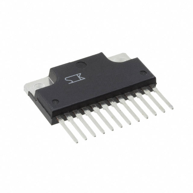

    SLA5059
SLA5059 数据手册
SLA5059 Absolute maximum ratings Symbol VDSS VGSS ID ID(pulse) PT N channel 60 ±20 4 8 (PW≤1ms, Duty≤25%) N-channel + P-channel 3-phase motor drive External dimensions B (Ta=25°C) ••• SLA (12-pin) Ratings P channel –60 20 –4 –8 (PW≤1ms, Duty≤25%) Unit V V A A W W °C/W °C/W °C °C 5 (Ta=25°C, with all circuits operating, without heatsink) 30 (Tc=25°C, with all circuits operating, with infinite heatsink) 25 (Junction-Air, Ta=25°C, with all circuits operating) 4.17 (Junction-Case, Tc=25°C, with all circuits operating) 150 –40 to +150 θ j-a θ j-c Tch Tstg sEquivalent circuit diagram 1 2 3 4 8 7 6 9 10 11 5 12 Characteristic curves ID-VDS Characteristics (Typical) N-ch 8 10V 4.5V ID-VGS Characteristics (Typical) P-ch N-ch 8 –10V (VDS=10V) –8 Ta=40°C 25°C 6 4.0V –6 –4.5V 6 125°C ID (A) ID (A) –4.0V 4 3.5V –4 –3.6V ID (A) 4 2 VGS=3.0V –2 –3.2V 2 VGS=–2.7V 0 0 2 4 6 8 10 0 0 –2 –4 –6 –8 –10 0 0 2 4 6 8 10 VDS (V) VDS (V) VGS (V) RDS(ON)-ID Characteristics (Typical) N-ch 0.6 (Ta=25°C) P-ch 0.6 VGS= –4V (Ta=25°C) –8 Tc= –40°C P-ch (VDS=–10V) 0.5 VGS=4V 0.5 25°C –6 (Ω) (Ω) 0.4 VGS=10V 0.4 VGS= –10V 125°C (ON) (ON) RDS RDS 0.3 0.3 ID (A) –4 0.2 0.2 –2 0.1 0.1 0 0 2 4 6 8 0 0 0 –2 –4 –6 –8 0 –2 –4 –6 –8 –10 ID (A) ID (A ) VGS (V) RDS(ON)-TC Characteristics (Typical) N-ch 0.8 ID=2A VGS=4V P-ch 0.8 ID= –2A VGS=–10V 0.7 0.7 (Ω) 0.6 (Ω) (ON) 0.6 (ON) RDS RDS 0.5 0.5 0.4 0.4 0.3 0.3 0.2 –40 –25 0 25 Tc (°C) 50 75 100 125 150 0.2 –40 –25 0 25 Tc (°C) 50 75 100 125 150 82 SLA5059 Electrical characteristics N channel Symbol min V(BR)DSS IGSS IDSS VTH Re(yfs) RDS(ON) Ciss Coss Crss td(on) tr td(off) tf VSD trr 150 70 15 12 40 40 25 1.2 75 1.0 2.5 0.55 60 ±10 100 2.0 Specification typ max Unit V Conditions ID=100µA, VGS=0V VGS=±20V VDS=60V, VGS=0V VDS=10V, ID=250µA VDS=10V, ID=2A VGS=4V, ID=2A VDS=10V, f=1.0MHz, VGS=0V 320 130 40 20 95 70 60 –1.1 75 –1.0 3 0.55 Specification min –60 10 –100 –2.0 typ max P channel Unit V Conditions ID=–100µA, VGS=0V VGS= 20V VDS=–60V, VGS=0V VDS=–10V, ID=–250µA VDS=–10V, ID=–2A VGS=–10V, ID=–2A VDS=–10V, f=1.0MHz, VGS=0V (Ta=25°C) µA µA V S Ω pF pF pF ns ns ns ns V ns µA µA V S Ω pF pF pF ns ns ns ns V ns ID=2A, VDD 20V, RL=10Ω, VGS=5V, see Fig. 3 on page 16. ISD=4A, VGS=0V ISD=2A, VGS=0V, di/dt=100A/µs ID=–2A, VDD –20V, RL=10Ω, VGS=–5V, see Fig. 4 on page 16. ISD=–4A, VGS=0V ISD=–2A, VGS=0V, di/dt=100A/µs Characteristic curves Re(yfs)-ID Characteristics (Typical) N-ch 10 Safe Operating Area (SOA) P-ch (VDS=–10V) 10 (VDS=10V) N-ch 10 (Tc=25°C) 100µs 1ms Re (yfs) (S) 10ms Re (yfs) (S) RDS (on) LIMITED 1 25°C 125°C 1 Tc=–40°C 25°C 125°C ID (A) –8 Tc= –40°C 1 0.1 0.005 0.1 1 8 0.1 –0.005 –0.1 0.1 –1 1 10 100 ID (A) ID (A) VDS (V) Capacitance-VDS Characteristics (Typical) N-ch 1000 VGS=0V f=1MHz P-ch 1000 VGS=0V f=1MHz P-ch –10 (Tc=25°C) 100µs 1ms 10ms Ciss Ciss Capacitance (pF) Capacitance (pF) 100 Coss 100 Coss RDS (ON) LIMITED ID (A) Crss –1 10 Crss 10 1 0 10 20 30 40 50 1 0 –10 –20 –30 –40 –50 –0.1 –1 –10 –100 VDS (V) VDS (V) VDS (V) IDR-VSD Characteristics (Typical) N-ch 8 –8 PT-Ta Characteristics P-ch 40 35 With Silicone Grease Natural Cooling All Circuits Operating 6 –6 30 25 IDR (A) IDR (A) PT (W) 4 VGS=10V 4V 0V –4 VGS=–10V 20 15 10 5 0 Without Heatsink W ith In fin ite He at sin k 2 –2 –4V 0V 0 0.0 0.5 1.0 1.5 2.0 0 0.0 –0.5 –1.0 –1.5 –2.0 0 50 100 150 VSD (V) VSD (V) Ta (°C) 83
