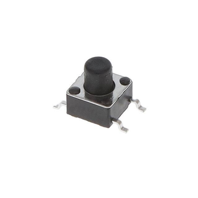

6x6 mm tact switches Momentary Action Switches https://www.schurter.com /PG09 Print and SMD Switch 6x6 LSH: Gullwing, variable height LPV: Through hole, angled LPS: Through hole, square See below: Approvals and Compliances Description Weblinks - Switches are possible with different heights - Design 6x6 mm Through hole or SMD mounting - Solder terminals pdf data sheet, html datasheet, General Product Information, CADDrawings, Product News, Detailed request for product Unique Selling Proposition - Reliable tactile feedback on input - Simple assembly - Long life time Technical Data   Electrical Data Switching Voltage Switching current Lifetime Contact Resistance Duration of Bounce Mechanical Data Actuating Force Actuating Travel End Stop Strength Lifetime 12 VDC 50 mA > 10⁵ actuations at Rated Switching Capacity max.  100 mΩ max. 100 mΩ after lifetime typ. 0.1 ms Climatical Data Operating Temperature Storage Temperature IP-Protection Soldering Data Soldering Methods Solderability Resistance to Soldering Heat 1.6 ± 0.5 N 0.25 + 0.2 / -0.1 mm 50 N / 3 s > 10⁵ actuations Material Terminals Socket Actuator -20 °C  to  70 °C -30 °C  to  85 °C IP40 Reflow  245 °C / 5 sec (IEC 60068-2-58 Test Td) 260 °C / 10 sec (IEC 60068-2-58 Test Td) CuZn37 0.7 µm Ag  UL 94V-0  UL 94V-0  Approvals and Compliances Detailed information on product approvals, code requirements, usage instructions and detailed test conditions can be looked up in  Details about Approvals SCHURTER products are designed for use in industrial environments. They have approvals from independent testing bodies according to national and international standards. Products with specific characteristics and requirements such as required in the automotive sector according to IATF 16949, medical technology according to ISO 13485 or in the aerospace industry can be offered exclusively with customer-specific, individual agreements by SCHURTER. Application standards Application standards where the product can be used Organization Design Standard Description Suitable for applications acc. IEC/UL 62368-1 Audio/video, information and communication technology equipment - Part 1: Safety requirements Switches 1 6x6 mm tact switches Momentary Action Switches https://www.schurter.com /PG09 Compliances The product complies with following Guide Lines Identification Details Initiator Description RoHS SCHURTER AG Directive RoHS 2011/65/EU, Amendment (EU) 2015/863 China RoHS SCHURTER AG The law SJ / T 11363-2006 (China RoHS) has been in force since 1 March 2007. It is similar to the EU directive RoHS. REACH SCHURTER AG On 1 June 2007, Regulation (EC) No 1907/2006 on the Registration, Evaluation, Authorization and Restriction of Chemicals 1 (abbreviated as "REACH") entered into force. Dimension [mm] LSG Gullwing basic module LPV PCB basic module 2 1.1 0.3 9 3.1 ±0.2 3 6.2 ±0.2 ±0.20 6.6 6.2 2 3 4 0.7 4.5 1 LPS PCB basic module 2 LPH PCB basic module Switches 6x6 mm tact switches Momentary Action Switches https://www.schurter.com /PG09 0.3max 0.3 10.00 h 3.6 LSH Gullwing basic module 0.7 6 2 3 4 6 4.50 1 Drilling diagrams LPV PCB lead: 1301.9503 1.4*3 Pad 4-ø1 Bohrungen holes 2.50 0 ø1.1 2x 4.50 4.50 2x 0 ø1.0 8.40 4.50 2 4 3 2.10 10.00 6.50 7.00 1 LSH Gullwing lead 4.50 4-1.4*2.5 Pad LPH / LPS PCB lead 1.40 LSG: Gullwing 2 3 1 4 1 2 1 2 3 4 3 4 2.50 LPV PCB lead: 1301.9501, 1301.9502 2x 0 ø1.3 2x 0 ø1.0 4.50 7.00 2 3 1 4 All Variants Type Terminal Type Actuator ⌀ A / Overall height Packaging Order Number LPH Through hole Height variable 4.30 mm loose in boxes(2000 pcs.) 1301.9301 █ LPH Through hole Height variable 5.00 mm loose in boxes(2000 pcs.) 1301.9302 █ LPH Through hole Height variable 7.00 mm loose in boxes(2000 pcs.) 1301.9303 █ LPH Through hole Height variable 7.30 mm loose in boxes(2000 pcs.) 1301.9304 █ LPH Through hole Height variable 8.00 mm loose in boxes(2000 pcs.) 1301.9305 █ LPH Through hole Height variable 9.50 mm loose in boxes(2000 pcs.) 1301.9306 █ LPH Through hole Height variable 12.50 mm loose in boxes(2000 pcs.) 1301.9307 █ LPS Through hole square 2.40 mm x 2.40 mm - loose in boxes(2000 pcs.) 1301.9308 █ LPS Through hole square 2.80 mm x 2.80 mm - loose in boxes(2000 pcs.) 1301.9309 █ LPV Through hole angled 3.85 mm loose in boxes(1000 pcs.) 1301.9501 █ LPV Through hole angled 11.35 mm loose in boxes(1000 pcs.) 1301.9502 █ LPV Through hole angled 6.15 mm loose in boxes(2000 pcs.) 1301.9503 █ LSG Gullwing - 3.10 mm Blister Tape 33 cm Reel(1500 pcs.) 1301.9324.25 █ LSH Gullwing Height variable 4.30 mm loose in boxes(2000 pcs.) 1301.9314 █ LSH Gullwing Height variable 4.30 mm Blister Tape 33 cm Reel(1000 pcs.) 1301.9314.24 █ LSH Gullwing Height variable 5.00 mm loose in boxes(2000 pcs.) 1301.9315 █ Switches 3 6x6 mm tact switches Momentary Action Switches https://www.schurter.com /PG09 Type Terminal Type Actuator ⌀ A / Overall height Packaging Order Number LSH Gullwing Height variable 5.00 mm Blister Tape 33 cm Reel(1000 pcs.) 1301.9315.24 █ LSH Gullwing Height variable 7.00 mm loose in boxes(2000 pcs.) 1301.9316 █ LSH Gullwing Height variable 7.00 mm Blister Tape 33 cm Reel(750 pcs.) 1301.9316.24 █ LSH Gullwing Height variable 7.30 mm loose in boxes(2000 pcs.) 1301.9317 █ LSH Gullwing Height variable 7.30 mm Blister Tape 33 cm Reel(750 pcs.) 1301.9317.24 █ LSH Gullwing Height variable 8.00 mm loose in boxes(2000 pcs.) 1301.9318 █ LSH Gullwing Height variable 8.00 mm Blister Tape 33 cm Reel(500 pcs.) 1301.9318.24 █ LSH Gullwing Height variable 9.50 mm loose in boxes(2000 pcs.) 1301.9319 █ LSH Gullwing Height variable 9.50 mm Blister Tape 33 cm Reel(400 pcs.) 1301.9319.24 █ LSH Gullwing Height variable 12.50 mm loose in boxes(2000 pcs.) 1301.9320 █ LSH Gullwing Height variable 12.50 mm Blister Tape 33 cm Reel(250 pcs.) 1301.9320.24 █ █ Most Popular. 17.08.2023 Availability for all products can be searched real-time:https://www.schurter.com/en/Stock-Check/Stock-Check-SCHURTER 4 Switches The specifications, descriptions and illustrations indicated in this document are based on current information. All content is subject to modifications and amendments. Information furnished is believed to be accurate and reliable. However, users should independently evaluate the suitability and test each product selected for their own applications.
