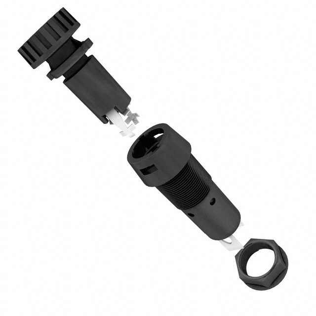

    FUSE HLDR CART 400V 16A PNL MNT
3101.0015 数据手册
Fuseholders www.schurter.com/pg02 Shock-Safe Fuseholder, 5 x 20 mm, Slot/Fingergrip, IP 40 / IP 67, IEC 60335-1 FPG Fingergrip 250 VAC · 2.5 W / 10 A (VDE)16 A (UL/CSA) Description - Meets the new requirements of IEC 60335-1 Ed. 4.0 for appliances in unattended use (clause 30.2.3). This includes the enhanced requirements of glow wire tests acc. to IEC 60695-2-11 to -13. Order numbers: xxxx.xxxx.15 Applications - Industrial electronic - Household appliances - Medical equipments Standards References Weblinks General Product Information Approvals, RoHS, CHINA-RoHS, e-Store, Distributor-Stock-Check, Accessories, Product Change Notification (PCN) - IEC 60127-6 - UL 4248-1 / UL 512 - CSA C22.2 no. 39 Approvals - VDE License Number: 127216 - UL File Number: E39328 Technical Data Shocksafe Category Fuse-Link Mounting Mounting Terminal Rated Voltage Rated Current Rated Power Acceptance IEC PC2 5 x 20 mm Panel Mount, Front-Side Fixing Nut Solder or Quick-Connect 4.8 x 0.5 mm 250 VAC 10 A (VDE), 16 A (UL/CSA) 2.5 W / 10 A @ Ta 23 °C Admissible power acceptance at higher ambient temperature see derating curves Degree of Protection IP 40 / IP 67 Protection Class Suitable for appliances with protection class 1 or 2 acc. to IEC 61140 Admissible Ambient Air Temp. -40 °C to 85 °C Climatic Category 40/085/21 acc. to IEC 60068-1 Material: Socket Thermoplastic, black, UL 94V-0 Material: Terminals Tin-Plated Copper Alloy Unit Weight (Socket/Cap) 5.7 g Storage Conditions 0 °C to 60 °C, max. 70% r.h. Product Marking , Type, Voltage, Power Acc./Current Rating, Approvals Soldering Methods Solderability Resistance to Soldering Heat Contact Resistance Dielectric Strength Iron 350 °C / 2 sec acc. to IEC 60068-2-20, Test Ta, method 2 350 °C / 10 sec acc. to IEC 60068-2-20, Test Tb, method 2 < 5 mΩ at 20 mV > 3 kV between L-N > 4 kV between L/N-PE (50 Hz; 1 min) > 2.5 kV between L-N > 6 kV between L/N-PE > 10 MΩ between L-N > 100 MΩ between L/N-PE (500 VDC; 1 min) I - II acc. to IEC 60664-1 1 - 3 acc. to IEC 60664-1 acc. to IEC 60068-2-6, test Fc max 1.2 Nm max 6 mm Impulse Withstand Voltage Insulation Resistance Overvoltage Category Pollution Degree Resistance to Vibration Admissible Torque on Fixing Nut Panel Thickness s Fuses  FPG www.schurter.com/pg02 Abmessungen 41.5 mm ø 16.1 4 ø 16.1 ø 11.1 6 7.62 6 Fuseholders ø 11.1 ø 12.5 ø 15 7.62 1.8 ø 15 1.8 SW14 SW14 M12.7x1.5 7 26.5 41.5 8 7 26.5 41.5 46.5 8 6 12 M12.7x1.5 6 Variants 3101.0010 and 3101.0210 Variants Fingergrip 3101.0015 and 3101.0215 ø 16.1 ø 16.1 ø 11.1 7.62 ø 12.5 ø 15 7.62 1.8 6 ø 15 1.8 ø 11.1 4 6 SW14 SW14 M12.7x1.5 7.6 25.9 41.5 8 41.5 46.5 6 12.6 7.6 M12.7x1.5 25.9 8 6 Variants 3101.0110 and 3101.0310 Variants Fingergrip 3101.0115 and 3101.0315 12.7 -0.1 11.7 -0.15 0 12.7 -0.1 0 0 12 -0.1 0 13 -0.3 0 Mounting Holes Derating Curves for Fuseholders Admissible power acceptance in Watt 2.5 2.0 1.5 1.0 0.5 0.0 0 20 40 60 80 100 I = 1.0 In I = 0.7 In I = < < In Ambient air temperature Ta °C 2 Fuses Fuseholders www.schurter.com/pg02 Variants Holder l l l l l l l l l l l l l l l l Cap Slot Knob Slot Knob Slot Knob Slot Knob Fingergrip Fingergrip Fingergrip Fingergrip Slot Knob Slot Knob Slot Knob Slot Knob Fingergrip Fingergrip Fingergrip Fingergrip Terminal Solder Solder Quick-Connect 4.8 x 0.5 mm Quick-Connect 4.8 x 0.5 mm Solder Solder Quick-Connect 4.8 x 0.5 mm Quick-Connect 4.8 x 0.5 mm Solder Solder Quick-Connect 4.8 x 0.5 mm Quick-Connect 4.8 x 0.5 mm Solder Solder Quick-Connect 4.8 x 0.5 mm Quick-Connect 4.8 x 0.5 mm Degree of Protection IP 40 IP 40 IP 40 IP 40 IP 40 IP 40 IP 40 IP 40 IP 67 IP 67 IP 67 IP 67 IP 67 IP 67 IP 67 IP 67 Material Thermoplastic Spec. Thermoplastic 1 Thermoplastic Spec. Thermoplastic 1 Thermoplastic Spec. Thermoplastic 1 Thermoplastic Spec. Thermoplastic 1 Thermoplastic Spec. Thermoplastic 1 Thermoplastic Spec. Thermoplastic 1 Thermoplastic Spec. Thermoplastic 1 Thermoplastic Spec. Thermoplastic 1 Remark Approvals pending Approvals pending Approvals pending Approvals pending Approvals pending Approvals pending Approvals pending Approvals pending Order Number 3101.0010 3101.0010.15 3101.0210 3101.0210.15 3101.0015 3101.0015.15 3101.0215 3101.0215.15 3101.0110 3101.0110.15 3101.0310 3101.0310.15 3101.0115 3101.0115.15 3101.0315 3101.0315.15 FPG Spec. thermoplastic meet the new requirements of IEC 60335-1 Ed. 4.0 for appliances in unattended use (clause 30.2.3). This includes the enhanced requirements of glow wire tests acc. to IEC 60695-2-11 to -13. White and grey colours available on request Packaging Unit Bulk 186 x 91 x 91 mm (100 pcs.) The specifications, descriptions and illustrations indicated in this document are based on Fuses current information. All content is subject to modifications and amendments.
