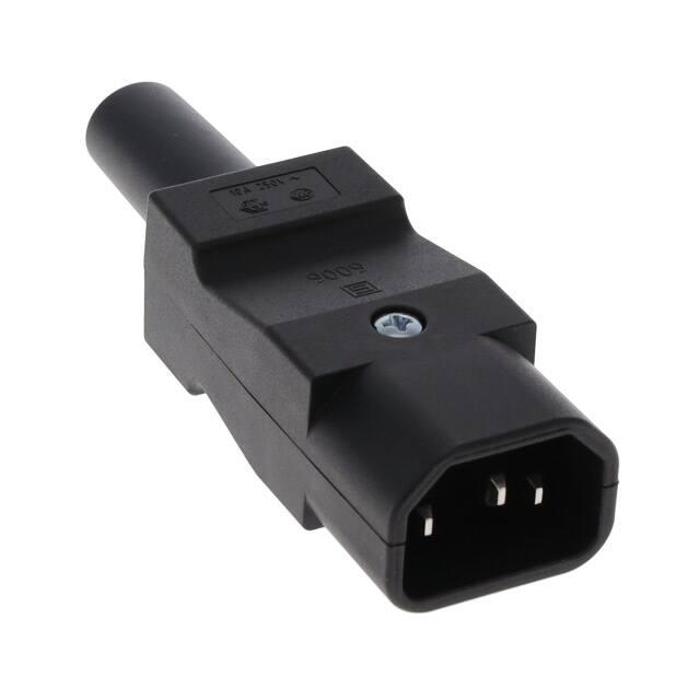

    电源接入连接器 插头,公引脚 IEC 320-2-2/E 自由悬挂
9009.0211 数据手册
9009 Cord Connectors (Rewireable) https://www.schurter.com /PG07 IEC Plug E, Cord Connector (Rewireable), Straight Rewireable connector grey straight Rewireable connector black straight Example with assembled cable E See below: Approvals and Compliances 70° C Description Screwing cable terminal ,  - Pin temperature 70 °C , Protection class I ,  - Strain relief for 8 or 10 mm cable included | The strain relief for 8 mm can be cut off for 10 mm cables Technical Data Weblinks pdf data sheet, html datasheet, General Product Information, Approvals, Distributor-Stock-Check, Accessories, Detailed request for product   Ratings IEC Ratings UL/CSA Dielectric Strength Allowable Operation Temperature IP-Protection Protection against electric shock Terminal Material: Housing 10 A / 250 VAC; 50 Hz 15 A / 250 VAC; 60 Hz > 4 kVAC between L-N > 2 kVAC between L/N-PE (1 min/50 Hz) -25 °C to 70 °C Appliance inlet/-outlet E acc. to IEC 60320-1, UL 60320-1, CSA C22.2 no. 60320-1 (for cold conditions) pin-temperature 70 °C, 10 A, Protection Class I front side IP20 acc. to IEC 60529 Suitable for appliances with protection class I acc. to IEC 61140 Screw clamps PA6, black or grey, UL 94V-0 Approvals and Compliances Detailed information on product approvals, code requirements, usage instructions and detailed test conditions can be looked up in  Details about Approvals SCHURTER products are designed for use in industrial environments. They have approvals from independent testing bodies according to national and international standards. Products with specific characteristics and requirements such as required in the automotive sector according to IATF 16949, medical technology according to ISO 13485 or in the aerospace industry can be offered exclusively with customer-specific, individual agreements by SCHURTER. Approvals The approval mark is used by the testing authorities to certify compliance with the safety requirements placed on electronic products. Approval Reference Type: 9009 Approval Logo Certificates Certification Body Description VDE Approvals VDE Certificate Number: 40040553 UL Approvals UL UL File Number: CCC Approvals CCC CCC Certificate Number: 2019180204011182 Connectors 1 9009 Cord Connectors (Rewireable) https://www.schurter.com /PG07 Product standards Product standards that are referenced Organization Design Standard Description Designed according to IEC 60320-1 Appliance couplers for household and similar general purposes Designed according to UL 60320-1 Standard for Attachment Plugs and Receptacles Designed according to CSA C22.2 no. 60320-1 General Use Receptacles, Attachment Plugs, and Similar Wiring Devices Design Standard Description Suitable for applications acc. IEC/UL 62368-1 Audio/video, information and communication technology equipment - Part 1: Safety requirements Details Initiator Description CE declaration of conformity SCHURTER AG The CE marking declares that the product complies with the applicable requirements laid down in the harmonisation of Community legislation on its affixing in accordance with EU Regulation 765/2008. UKCA declaration of conformity SCHURTER AG The UKCA marking declares that the product complies with the applicable requirements laid down in the British Amendment of Regulation (EC) 765/2008. RoHS SCHURTER AG Directive RoHS 2011/65/EU, Amendment (EU) 2015/863 China RoHS SCHURTER AG The law SJ / T 11363-2006 (China RoHS) has been in force since 1 March 2007. It is similar to the EU directive RoHS. REACH SCHURTER AG On 1 June 2007, Regulation (EC) No 1907/2006 on the Registration, Evaluation, Authorization and Restriction of Chemicals 1 (abbreviated as "REACH") entered into force. Application standards Application standards where the product can be used Organization Compliances The product complies with following Guide Lines Identification Dimensions [mm] 20.7 61 28.8 1) B A 1) Cut strain relief 8 (10) mm here for 10 mm cable A: Strain relief 8 mm: 96 mm B: Strain relief 10 mm: 91 mm All Variants Color Recommended cable diameter Max. wire size L = Length of cable guard Order Number black 8 (10) mm 3 x 1.5 mm² / 3 x 14 AWG - 9009.0111 █ grey 8 (10) mm 3 x 1.5 mm² / 3 x 14 AWG - 9009.0121 █ black 10 mm 3 x 1.5 mm² / 3 x 14 AWG - 9009.0211 grey 10 mm 3 x 1.5 mm² / 3 x 14 AWG - 9009.0221 █ Most Popular. Availability for all products can be searched real-time:https://www.schurter.com/en/Stock-Check/Stock-Check-SCHURTER 2 Connectors 9009 Cord Connectors (Rewireable) https://www.schurter.com /PG07 Color Recommended cable diameter Max. wire size L = Length of cable guard Order Number Max. torque for screws: Terminals: 0.5 Nm, Cable clamps: 0.8 Nm, Cover: 0.8 Nm Packaging unit   50 Pcs  Mating Outlets/Connectors Category / Description » Overview complete IEC Appliance Inlet C14 with Appliance Outlet F, Line Switch 2-pole and Voltage Selector PMM   Appliance Outlet Overview complete 6600-5, Mounting: Snap-in version, Appliance Outlet: IEC F, For PCB mounting, 10 A, Suitable for appliances with protection class I 6600-5 4787, Mounting: Screw-on mounting, Appliance Outlet: IEC Solder terminals, 10 A, Suitable for appliances with protection class I 4787 4788, Mounting: Snap-in version, Appliance Outlet: IEC Solder / Quick Connect, 10 A, Suitable for appliances with protection class I 4788   Appliance Outlet shuttered Overview complete 4721, Mounting: Screw-on mounting, Appliance Outlet: IEC F, Solder / Quick Connect, 10 A, Suitable for appliances with protection class I 4721 4723, Mounting: Snap-in version, Appliance Outlet: IEC F, Solder / Quick Connect, 10 A, Suitable for appliances with protection class I 4723   Distribution Unit Overview complete 4750, Mounting: Snap-in, Front Side, Solder / PCB / QC (4.8 / 6.3 x 0.8) mm, 7x Appliance Outlet: IEC F 4750 4751, Mounting: Snap-in, Front Side, Solder pin / quick connect terminals 6.3 x 0.8 / 4.8 x 0.8 mm, x Appliance Outlet: 4751 IEC F 0712-PQ, Mounting: Snap-in, Front Side, Solder terminal (4.8 x 0.8 mm), 1x Appliance Outlet: IEC F 0712 4741, Mounting: 2x Appliance Outlet: IEC F 4741 0909, Mounting: Snap-in, Front Side, Solder terminals, 7x Appliance Outlet: IEC F 0909 ...   Power Entry Module Overview complete IEC Appliance Inlet C14 with Appliance Outlet F KP (Outlet) Felcom 64, Mounting: 0 mm, Fuseholder: Solder terminals 3.5 x 0.8 mm / quick connect terminals 6.3 x 0.8 mm, Rocker switch: 2-pole non-illuminated, Appliance Inlet: IEC C14, Power Entry Module Felcom 64 4719, Mounting: Snap-in, mm, Fuseholder: 1-pole, Appliance Outlet: IEC F, with or without neon indicator, Suitable for appliances with protection class I 4719   Connectors 3 9009 Cord Connectors (Rewireable) https://www.schurter.com /PG07 Category / Description Power Entry Module with line filter Overview complete Felcom 54, Mounting: mm, Front Side, Filter: Standard version, Fuseholder: 1-/2-pole, Front Side, 10 A, Rocker switch: 2-pole, Solder terminals 3.5 x 0.8 mm / quick connect terminals 6.3 x 0.8 mm, Appliance Inlet: IEC C14 Felcom 54 16.08.2023   4 Connectors The specifications, descriptions and illustrations indicated in this document are based on current information. All content is subject to modifications and amendments. Information furnished is believed to be accurate and reliable. However, users should independently evaluate the suitability and test each product selected for their own applications.
