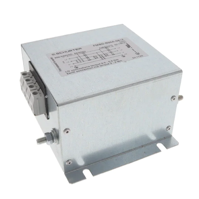

3-Phase Filters FMBD NEO www.schurter.com/pg80 2-stage filter for 3-phase systems with neutral conductor Description - Terminals for three phases, neutral conductor and ground - Very high symmetrical and asymmetrical attenuation loss - In the frequency range from 10kHz up to 300MHz Applications Standards Approvals - Voltage rating 520 VAC for world wide acceptance - Protection against interference voltage from the mains - Especially designed for industrial applications such as: Frequency Converters, Stepper Motor Drives, UPS-Systems, Inverters - IEC 60939 - UL 1283, Edition 5, CSA 22.2 No. 8-M1986, @ Ta 75 °C - VDE License Number: pending - UL License Number: E72928 References Weblinks General Product Information Approvals, RoHS, CHINA-RoHS, Distributor-Stock-Check Technical Data Rated Current Rated voltage Approval for 8 - 200 A 300/520 VAC, 50/60 Hz 8 - 200 A @ 50 (75) °C / 300/520 VAC; 50/60 Hz Overload Current 1.5 x Ir Dielectric Strength for 520 VAC 2.25 kVDC between L-L 1.7 kVDC between L-N 2.75 kVDC between L-PE 2.75 kVDC between N-PE Test voltage 2 sec Number of Filter Stages 2 Weight 1.1 - 8.6 kg Material: Housing Metal Sealing Compound UL 94V-0 Mounting Terminal Operating Temperature [°C] Climatic Category Degree of Protection Protection Class MTBF Screw-on mounting on chassis Screw Clamp -25 °C to 100 °C 25/100/21 acc. to IEC 60068-1 IP 20 acc. to IEC 60529 Suitable for appliances with protection class 1 acc. to IEC 61140 > 200'000 h acc. to MIL-HB-217 F EMC Products  FMBD NEO www.schurter.com/pg80 Dimensions Case 2A 3-Phase Filters max. 155 (120) max. 115 3x11.5=(34.5) max. 80 M6x14; 3-4 Nm 54.5 14 80 ±0.3 6.5±0.3 (4x) 4mm 2 ; 0.5-0.6 Nm max. 145 127.5–2 0 1) 2) 1) Line 2) Load Case 2B max. 165 (130) max. 125 3x23=(69) max. 115 M6x14; 3-4 Nm 50 14 90 ±0.3 6.5 (4x) 10mm 2 ; 1.5-1.8 Nm max. 155 137.5 –2 0 1) 2) 1) Line 2) Load  EMC Products 89 35 3-Phase Filters FMBD NEO www.schurter.com/pg80 Case 2C max. 220 (160) max. 125 3x25=(75) max. 125 M10; 10-17 Nm 94 100 ±0.3 6.5 ±0.3 (4x) 18 25mm 2 ; 2-2.2 Nm max. 155 137.5 –2 0 1) 2) 1) Line 2) Load Case 2D max. 315 (230) max. 135 3x28=(84) max. 125 83 55 M10; 10-17 Nm 120 ±0.3 6.5 ±0.3 (4x) 24 50mm2 ; 2.2-2.5 Nm max. 165 147.5 –2 0 1) 2) 1) Line 2) Load EMC Products 40 3 FMBD NEO www.schurter.com/pg80 Case 2E max. 335 (250) max. 140 3x30=(90) 3-Phase Filters max. 140 M10; 10-17 Nm 98 18 200 ±0.3 6.5 ±0.3 (4x) 50mm 2 ; 2.2-2.5 Nm max. 170 152.5 –2 0 1) 2) 1) Line 2) Load Case 2F max. 380 (280) max. 140 3x30=(90) max. 170 24 230 ±0.3 6.5 ±0.3 (4x) 95mm 2 ; 15-20 Nm max. 170 152.5 –2 0 1) 2) 1) Line 2) Load  EMC Products 45 M10; 10-17 Nm 106.5 55 3-Phase Filters FMBD NEO www.schurter.com/pg80 L [mH] 2 1.3 1.6 1 0.7 0.6 0.6 0.4 0.3 L [μH] 4 12 12 12 7.5 9 9 9 9 C [μF] 2.2 2.2 4.7 4.7 4.7 8.2 13.6 13.6 13.6 C [μF] 2.2 2.2 4.7 4.7 4.7 8.2 13.6 13.6 13.6 C3 [μF] 3.4 3.4 3.4 3.4 3.4 3.4 3.4 3.4 3.4 R [MΩ] R [MΩ] R3 [MΩ] 1 1 1 1 0.5 0.5 0.5 1 1 1 1 1 1 0.5 0.5 0.5 2 2 2 2 2 2 2 2 2 Technical data to the filter components Rated Current @ Ta 0°C (7°C) [A] 8 (5) 16 (11) 25 (16) 36 (21) 64 (40) 80 (50) 120 (96) 160 (100) 200 (140) Diagrams L1 L2 1) L3 N PE 1) Line 2) Load C3/R3 C1/R1 C1/R1 C1/R1 L1 C2/R2 C 2/R 2 C 2/R 2 L2 L1' L2' L3' 2) N' PE Derating Curves Permissible Working Current as a Function of Ambient Temperature Admissible operating current in % of In 100 80 60 UL Listet 40 20 0 0 20 40 60 75 100 Ambient air temperature Ta °C EMC Products  FMBD NEO www.schurter.com/pg80 Attenuation Loss 7A Industrial Version 3-Phase Filters ........ 01/100 differential mode . . . . 100/0.1 differential mode - - - - differential mode _____ common mode 16A 25A 36A 64A 80A 120A 160A 200A Variants Rated Current @ Ta 0°C (7°C) [A] Tripped Power Dissipation [W] Contact Resistance [mΩ] 12.5 6.8 3.8 2.4 1.3 0.88 0.75 0.37 0.26 Leakage Current [mA] ) Weight [kg] Screw clamps [mm] ) 4 4 10 10 25 50 50 95 95 Housing Packaging unit [PCS] Order Number 8 (5) 16 (11) 25 (16) 36 (21) 64 (40) 80 (50) 120 (96) 160 (100) 200 (140) 3.2 7 9.5 12.5 21.3 22.6 43.2 37.9 41.6
