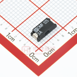

Non resettable fuses SMD-FST www.schurter.com/pg0_2 Surface Mount Fuse, 5 x 20 mm, Time-Lag T, L, 250 VAC, Au plating IEC 60127-2 · 250 VAC · Time-Lag T Description - Directly solderable on printed circuit boards - L = Low Breaking Capacity - For rated current 1 A to 16 A, SMD-SPT is recommended Applications References Weblinks - Primary Protection on SMD PCB General Product Information Packaging Details Approvals, RoHS, CHINA-RoHS, e-Store, Distributor-Stock-Check, Accessories, Product Change Notification (PCN) Standards - IEC 60127-2/3 - UL 248-14 - CSA C22.2 no. 248.14 Approvals - VDE License Number: 40011522 - UL File Number: E41599 Technical Data Rated Voltage Rated Current Breaking Capacity Characteristic Mounting Admissible Ambient Air Temp. Climatic Category Material: Housing Material: Terminals Unit Weight Storage Conditions Product Marking 250 VAC 0.05 - 20 A 35 A - 125 A Time-Lag T PCB,SMT -55 °C to 125 °C 55/125/21 acc. to IEC 60068-1 Glass Gold-Plated Copper Alloy 1.05 g 0 °C to 60 °C, max. 70% r.h. , Current, Voltage, Characteristic, Breaking Capacity Soldering Methods Solderability Resistance to Soldering Heat Resistance to Vibration Load Humidity Test Moisture Resistance Test Terminal Strength Thermal Shock Reflow 245 °C / 3 sec acc. to IEC 60068-2-58, Test Td 260 °C / 10 sec acc. to IEC 60068-2-58, Test Td acc. to IEC 60068-2-6, test Fc MIL-STD-202, Method 103B (1000h @ 0.1*In @ 0.85 r.H. @ 85°C) MIL-STD-202, Method 106E (50 cycles in a temp./mister chamber) MIL-STD-202, Method 211A (Deflection of board 1 mm for 1 minute) MIL-STD-202, Method 107D (200 air-to-air cycles from -55 to +125°C) acc. to EIA/IS-722, Test 4.7 >100 MΩ (between leeds and body) MIL-STD-202, Method 215A Case Resistance Resistance to Solvents Dimensions   20 mm 10 ±0.2 +0.1 -0.2 ø 5.2 5 5.5 20 ±0.5 Soldering pads 9.5 5.5 Fuses  SMD-FST www.schurter.com/pg0_2 Pre-Arcing Time Rated Current In 0.05 A - 0.1 A 0.125 A - 6.3 A 8 A - 10 A 12.5 A - 20 A .5 x In min. 2. x In max. 60 min 60 min 30 min 15 min 120 s 120 s 120 s 120 s 2.75 x In min. 300 ms 600 ms 600 ms 600 ms 2.75 x In max. 10 s 10 s 10 s 10 s 4.0 x In min. 4.0 x In max. 40 ms 150 ms 150 ms 150 ms 3 s 3 s 3 s 3 s 0.0 x In min. 10 ms 20 ms 20 ms 20 ms 0.0 x In max. 300 ms 300 ms 300 ms 300 ms Non resettable fuses Variants Rated Current [A] Rated Voltage [VAC] Breaking Capacity Voltage Drop .0 In max. [mV] 3500 3000 3000 2500 2000 1900 1500 1300 1100 1000 900 300 250 150 150 150 150 120 100 100 100 100 100 100 Voltage Drop .0 In typ. [mV] 950 1300 1100 565 400 415 270 210 170 150 160 160 120 60 60 60 60 60 60 60 60 60 60 60 60 60 60 Power Dissipation .5 In max. [mW] 1600 1600 1600 1600 1600 1600 1600 1600 1600 1600 1600 1600 1600 1600 1600 1600 1600 1600 1600 1600 1600 1600 4000 4000 Power Dissipation .5 In typ. [mW] 125 200 300 155 200 185 200 200 200 200 200 200 200 200 300 300 300 400 500 800 900 1000 1300 1300 2500 3300 4200 Melting I²t 0.0 Intyp. [A²s] 0.0363 0.0401 0.057 0.107 0.064 0.23 0.256 0.238 0.544 0.768 3 4.35 3.85 3.3 5.5 10.5 16 21.9 47 68.3 102 190 275 520 750 1638 3057 l l l l l l l l l l l l l l l l l l l l l l l l       l l l l l l l l l l l l l l l l l l l l l l l l l l   Order Number 0.05 0.063 0.08 0.1 0.125 0.16 0.2 0.25 0.315 0.4 0.5 0.63 0.8 1 1.25 1.6 2 2.5 3.15 4 5 6.3 8 10 12.5 16 20 1) 35 A @ 250 VAC 2) 10 In @ 250 VAC 3) 125 A @ 250 VAC 250 250 250 250 250 250 250 250 250 250 250 250 250 250 250 250 250 250 250 250 250 250 250 250 250 250 250 1) 1) 1) 1) 1) 1) 1) 1) 1) 1) 1) 1) 1) 1) 1) 1) 1) 1) 1) 2) 2) 2) 2) 2) 3) 3) 3) 0034.5604.xx 0034.5605.xx 0034.5606.xx 0034.5607.xx 0034.5608.xx 0034.5609.xx 0034.5610.xx 0034.5611.xx 0034.5612.xx 0034.5613.xx 0034.5614.xx 0034.5615.xx 0034.5616.xx 0034.5617.xx 0034.5618.xx 0034.5619.xx 0034.5620.xx 0034.5621.xx 0034.5622.xx 0034.5623.xx 0034.5624.xx 0034.5625.xx 0034.5626.xx 0034.5627.xx 0034.5628.xx 0034.5629.xx 0034.5630.xx Packaging Unit .xx = .11 Plastic Bag (100 pcs.) .xx = .22 Blister Tape 38 cm Reel (1000 pcs.) 2 Fuses Non resettable fuses SMD-FST www.schurter.com/pg0_2 Time-Current-Curves 100000 0.02–0.1 A 0.125–20 A 10000 1000 100 Time in Seconds 10 1 0.1 0.01 0.001 1 10 Multiple of Rated Current In The specifications, descriptions and illustrations indicated in this document are based on Fuses current information. All content is subject to modifications and amendments.
