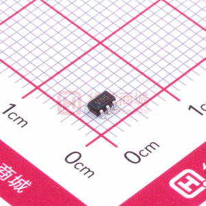

PROTECTION PRODUCTS Description RailClamps are surge rated diode arrays designed to protect high speed data interfaces. The SR series has been specifically designed to protect sensitive components which are connected to data and transmission lines from overvoltage caused by electrostatic discharge (ESD), electrical fast transients (EFT), and lightning. The unique design of the SR series devices incorporates eight surge rated, low capacitance steering diodes and a TVS diode in a single package. During transient conditions, the steering diodes direct the transient to either the positive side of the power supply line or to ground. The internal TVS diode prevents over-voltage on the power line, protecting any downstream components. The SRV05-4 has a low typical capacitance of 3pF and operates with virtually no insertion loss to 1GHz. This makes the device ideal for protection of high-speed data lines such as USB 2.0, Firewire, DVI, and gigabit Ethernet interfaces. The low capacitance array configuration allows the user to protect four high-speed data or transmission lines. The low inductance construction minimizes voltage overshoot during high current surges. They may be used to meet the ESD immunity requirements of IEC 61000-4-2, Level 4 (±15kV air, ±8kV contact discharge). RailClamp Low Capacitance TVS Diode Array Features ESD protection for high-speed data lines to IEC 61000-4-2 (ESD) ±15kV (air), ±8kV (contact) IEC 61000-4-4 (EFT) 40A (5/50ns) IEC 61000-4-5 (Lightning) 12A (8/20µs) Array of surge rated diodes with internal TVS Diode Small package saves board space Protects four I/O lines Low capacitance: 3pF typical Low clamping voltage Low operating voltage: 5.0V Solid-state silicon-avalanche technology SRV05-4 Mechanical Characteristics JEDEC SOT-23 6L package Molding compound flammability rating: UL 94V-0 Marking : V05 Packaging : Tape and Reel Applications USB 2.0 Power and Data Line Protection Video Graphics Cards Monitors and Flat Panel Displays Digital Video Interface (DVI) 10/100/1000 Ethernet Notebook Computers SIM Ports ATM Interfaces IEEE 1394 Firewire Ports Circuit Diagram Schematic and PIN Configuration 5 1 3 4 6 2 SOT-23 6L (Top View) Revision 01/18/2008 1 www.semtech.com SRV05-4 PROTECTION PRODUCTS Absolute Maximum Rating R ating Peak Pulse Power (tp = 8/20µs) Peak Pulse Current (tp = 8/20µs) ESD per IEC 61000-4-2 (Air) ESD per IEC 61000-4-2 (Contact) Lead Soldering Temperature Operating Temperature Storage Temperature Symbol Pp k IP P VESD TL TJ TSTG Value 300 12 15 8 260 (10 sec.) -55 to +125 -55 to +150 Units Watts A kV °C °C °C Electrical Characteristics SR V05-4 Parameter Reverse Stand-Off Voltage Reverse Breakdown Voltage Reverse Leakage Current Forward Voltage Clamping Voltage Clamping Voltage Junction Capacitance Symbol VRWM V BR IR VF VC VC Cj Conditions Pi n 5 to 2 It = 1mA Pi n 5 to 2 VRWM = 5V, T=25°C Pi n 5 to 2 If = 15mA IPP = 1A, tp = 8/20µs Any I/O pin to Ground IPP = 5A, tp = 8/20µs Any I/O pin to Ground VR = 0V, f = 1MHz Any I/O pin to Ground VR = 0V, f = 1MHz Between I/O pins 3 1.5 6 5 1.2 12.5 17.5 5 Minimum Typical Maximum 5 Units V V µA V V V pF pF  2008 Semtech Corp. 2 www.semtech.com SRV05-4 PROTECTION PRODUCTS Typical Characteristics Non-Repetitive Peak Pulse Power vs. Pulse Time 10 110 Power Derating Curve Peak Pulse Power - PPk (kW) 100 % of Rated Power or PP I 90 80 70 60 50 40 30 20 10 0 1 0.1 0.01 0.1 1 10 Pulse Duration - tp (µs) 100 1000 0 25 50 75 100 125 150 Ambient Temperature - TA (oC) Pulse Waveform 110 100 90 80 70 60 50 40 30 20 10 0 0 5 10 15 Time (µs) 20 25 30 td = IPP/2 PP Clamping Voltage vs. Peak Pulse Current Waveform Parameters: tr = 8µs td = 20µs 30.00 Clamping Voltage -VC (V) 25.00 20.00 15.00 10.00 5.00 0.00 0.00 2.00 4.00 6.00 8.00 10.00 12.00 Peak Pulse Current - IPP (A) Waveform Parameters: tr = 8µs td = 20µs Percent of I e-t Forward Voltage vs. Forward Current 7.00 Normalized Capacitance vs. Reverse Voltage 1.4 1.2 Forward Voltage -VF (V) 6.00 5.00 4.00 3.00 2.00 1.00 0.00 0.00 2.00 4.00 6.00 8.00 10.00 12.00 Forward Current - IF (A) Waveform Parameters: tr = 8µs td = 20µs CJ(V R) / C J(V R=0) 1 0.8 0.6 0.4 0.2 f = 1 MHz 0 0 1 2 3 4 5 Reverse Voltage - VR (V)  2008 Semtech Corp. 3 www.semtech.com SRV05-4 PROTECTION PRODUCTS Applications Information Insertion Loss S21 CH1 S21 LOG 3 dB/ REF 0 dB Analog Cross Talk CH1 S21 LOG 20 dB/ REF 0 dB START .030 000 MHz STOP 3 000. 000 000 MHz START .030 000 MHz STOP 3 000. 000 000 MHz  2008 Semtech Corp. 4 www.semtech.com SRV05-4 PROTECTION PRODUCTS Applications Information Device Connection Options for Protection of Four High-Speed Data Lines The SRV05-4 TVS is designed to protect four data lines from transient over-voltages by clamping them to a fixed reference. When the voltage on the protected line exceeds the reference voltage (plus diode VF) the steering diodes are forward biased, conducting the transient current away from the sensitive circuitry. Data lines are connected at pins 1, 3, 4 and 6. The negative reference (REF1) is connected at pin 2. This pin should be connected directly to a ground plane on the board for best results. The path length is kept as short as possible to minimize parasitic inductance. The positive reference (REF2) is connected at pin 5. The options for connecting the positive reference are as follows: 1. To protect data lines and the power line, connect pin 5 directly to the positive supply rail (VCC). In this configuration the data lines are referenced to the supply voltage. The internal TVS diode prevents over-voltage on the supply rail. 2. The SRV05-4 can be isolated from the power supply by adding a series resistor between pin 5 and VCC. A value of 100kΩ is recommended. The internal TVS and steering diodes remain biased, providing the advantage of lower capacitance. 3. In applications where no positive supply reference is available, or complete supply isolation is desired, the internal TVS may be used as the reference. In this case, pin 5 is not connected. The steering diodes will begin to conduct when the voltage on the protected line exceeds the working voltage of the TVS (plus one diode drop). ESD Protection With RailClamps RailClamps are optimized for ESD protection using the rail-to-rail topology. Along with good board layout, these devices virtually eliminate the disadvantages of using discrete components to implement this topology. Consider the situation shown in Figure 1 where discrete diodes or diode arrays are configured for rail-torail protection on a high speed line. During positive duration ESD events, the top diode will be forward biased when the voltage on the protected line exceeds Data Line and Power Supply Protection Using Vcc as reference Data Line Protection with Bias and Power Supply Isolation Resistor Data Line Protection Using Internal TVS Diode as Reference  2008 Semtech Corp. 5 www.semtech.com SRV05-4 PROTECTION PRODUCTS Applications Information (continued) the reference voltage plus the VF drop of the diode. For negative events, the bottom diode will be biased when the voltage exceeds the VF of the diode. At first approximation, the clamping voltage due to the characteristics of the protection diodes is given by: VC = VCC + VF VC = -VF PIN Descriptions (for positive duration pulses) (for negative duration pulses) However, for fast rise time transient events, the effects of parasitic inductance must also be considered as shown in Figure 2. Therefore, the actual clamping voltage seen by the protected circuit will be: VC = VCC + VF + LP diESD/dt (for positive duration pulses) VC = -VF - LG diESD/dt (for negative duration pulses) ESD current reaches a peak amplitude of 30A in 1ns for a level 4 ESD contact discharge per IEC 61000-4-2. Therefore, the voltage overshoot due to 1nH of series inductance is: V = LP diESD/dt = 1X10-9 (30 / 1X10-9) = 30V Example: Consider a VCC = 5V, a typical VF of 30V (at 30A) for the steering diode and a series trace inductance of 10nH. The clamping voltage seen by the protected IC for a positive 8kV (30A) ESD pulse will be: VC = 5V + 30V + (10nH X 30V/nH) = 335V This does not take into account that the ESD current is directed into the supply rail, potentially damaging any components that are attached to that rail. Also note that it is not uncommon for the VF of discrete diodes to exceed the damage threshold of the protected IC. This is due to the relatively small junction area of typical discrete components. It is also possible that the power dissipation capability of the discrete diode will be exceeded, thus destroying the device. The RailClamp is designed to overcome the inherent disadvantages of using discrete signal diodes for ESD suppression. The RailClamp’s integrated TVS diode “Rail-T Pro Topology Figure 1 - “Rail-To-Rail” Pr o t ection Topology (First Approximation) Figure 2 - The Effects of Parasitic Inductance When Using Discrete Components to Implement Rail-T Pro Rail- To-Rail Pr o t ection Rail-T Pro Figure 3 - Rail- To-Rail Pr o t ection Using RailClamp Arrays RailClam p T V S Arra ys  2008 Semtech Corp. 6 www.semtech.com SRV05-4 PROTECTION PRODUCTS Applications Information (continued) helps to mitigate the effects of parasitic inductance in the power supply connection. During an ESD event, the current will be directed through the integrated TVS diode to ground. The maximum voltage seen by the protected IC due to this path will be the clamping voltage of the device. Video Interface Protection Video interfaces are susceptible to transient voltages resulting from electrostatic discharge (ESD) and “hot plugging” cables. If left unprotected, the video interface IC may be damaged or even destroyed. Protecting a high-speed video port presents some unique challenges. First, any added protection device must have extremely low capacitance and low leakage current so that the integrity of the video signal is not compromised. Second, the protection component must be able to absorb high voltage transients without damage or degradation. As a minimum, the device should be rated to handle ESD voltages per IEC 61000-4-2, level 4 (±15kV air, ±8kV contact). The clamping voltage of the device (when conducting high current ESD pulses) must be sufficiently low enough to protect the sensitive CMOS IC. If the clamping voltage is too high, the “protected” device may latch-up or be destroyed. Finally, the device must take up a relatively small amount of board space, particularly in portable applications such as notebooks and handhelds. The SRV05-4 is designed to meet or exceed all of the above criteria. A typical video interface protection circuit is shown in Figure 4. All exposed lines are protected including R, G, B, H-Sync, V-Sync , and the ID lines for plug and play monitors. Universal Serial Bus ESD Protection The SRV05-4 may also be used to protect the USB ports on monitors, computers, peripherals or portable systems. Each device will protect up to two USB ports (Figure 5). When the voltage on the data lines exceed the bus voltage (plus one diode drop), the internal rectifiers are forward biased conducting the transient current away from the protected controller chip. The TVS diode directs the surge to ground. The TVS diode also acts to suppress ESD strikes directly on the voltage bus. Thus, both power and data pins are protected with a single device. Figure 6 - SIM Port  2008 Semtech Corp. 7 www.semtech.com Figure 4 - Video Interface Protection SRV05-4 Figure 5 - Dual USB Port Protection SRV05-4 PROTECTION PRODUCTS DVI Protection The small geometry of a typical digital-visual interface (DVI) graphic chip will make it more susceptible to electrostatic discharges (ESD) and cable discharge events (CDE). Transient protection of a DVI port can be challenging. Digital-visual interfaces can often transmit and receive at a rate equal to or above 1Gbps. The high-speed data transmission requires the protection device to have low capacitance to maintain signal integrity and low clamping voltage to reduce stress on the protected IC. The SRV05-4 has a low typical insertion loss of 1.5kV. If more common mode protection is needed, figure 9 shows how to design the SRV05-4 on the IC side of the 10/100 Figure 7 - Digital Video Interface (DVI) Protection  2008 Semtech Corp. 8 www.semtech.com SRV05-4 PROTECTION PRODUCTS SRV05-4 Figure 8 - 10/100 Ethernet Differential Protection Figure 9 - 10/100 Ethernet Differential and Common Mode Protection  2008 Semtech Corp. 9 www.semtech.com SRV05-4 PROTECTION PRODUCTS 10/100 ETHERNET PROTECTION CONT’ Ethernet circuit to provide differential and common mode protection. The SRV05-4 can not be grounded on the line side because the hi-pot test requires the line side not to be grounded.  2008 Semtech Corp. 10 www.semtech.com SRV05-4 PROTECTION PRODUCTS Applications Information - SPICE Model nH SRV05-4 Spice Model SR V05-4 Spice Parameters Parameter IS BV VJ RS IB V CJO TT M N EG Unit Amp Volt Volt Ohm Amp Farad sec --eV D1 (LCR D) 10E-14 180 0.62 0.31 1E-3 3E-12 2.541E-9 0.01 1.1 1.11 D2 (LCR D) 10E-14 20 0.59 0.37 1E-3 1E-12 2.541E-9 0.01 1.1 1.11 D3 (T VS) 10E-14 8.59 0.6 0.500 1E-3 360E-12 2.541E-9 0.334 1.1 1.11  2008 Semtech Corp. 11 www.semtech.com SRV05-4 PROTECTION PRODUCTS Outline Drawing - SO-8 Outline Drawing -SOT23 6L A e1 N EI 1 ccc C 2X N/2 TIPS B e 2 E D DIM A A1 A2 b c D E1 E e e1 L L1 N 01 aaa bbb ccc DIMENSIONS MILLIMETERS INCHES MIN NOM MAX MIN NOM MAX .057 .035 .006 .000 .035 .045 .051 .020 .010 .009 .003 .110 .114 .122 .060 .063 .069 .110 BSC .037 BSC .075 BSC .012 .018 .024 (.024) 6 10° 0° .004 .008 .008 1.45 0.90 0.00 0.15 .90 1.15 1.30 0.25 0.50 0.08 0.22 2.80 2.90 3.10 1.50 1.60 1.75 2.80 BSC 0.95 BSC 1.90 BSC 0.30 0.45 0.60 (0.60) 6 0° 10° 0.10 0.20 0.20 2X E/2 D aaa C A2 SEATING PLANE C A1 bxN bbb C A-B D A H GAGE PLANE 0.25 L (L1) SEE DETAIL c 01 A DETAIL A SIDE VIEW NOTES: 1. CONTROLLING DIMENSIONS ARE IN MILLIMETERS (ANGLES IN DEGREES). 2. DATUMS -A- AND -B- TO BE DETERMINED AT DATUM PLANE -H3. DIMENSIONS "E1" AND "D" DO NOT INCLUDE MOLD FLASH, PROTRUSIONS OR GATE BURRS. Land Pattern -SOT23 6L X DIM (C) G Y P Z C G P X Y Z DIMENSIONS INCHES MILLIMETERS (.098) .055 .037 .024 .043 .141 (2.50) 1.40 0.95 0.60 1.10 3.60 NOTES: 1. THIS LAND PATTERN IS FOR REFERENCE PURPOSES ONLY. CONSULT YOUR MANUFACTURING GROUP TO ENSURE YOUR COMPANY'S MANUFACTURING GUIDELINES ARE MET.  2008 Semtech Corp. 12 www.semtech.com SRV05-4 PROTECTION PRODUCTS Marking Codes Ordering Information Par t Number Lead Finish SnPb Pb free Qty per Reel 3,000 3,000 R eel Size 7 Inch 7 Inch V05 Part Number SRV05-4 Marking Code V05 SRV05-4.TC SRV05-4.TCT Tape and Reel Specification User Direction of feed A0 3.23 +/-0.05 mm B0 3.17 +/-0.05 mm K0 1.37 +/-0.05 mm Tape Width B, (Max) D D1 E F K (MAX) P P0 P2 T(MAX) W 8.0 mm + 0.3 mm - 0.1 mm 8 mm 4.2 mm (.165) 1.5 + 0.1 mm - 0.0 mm 1.0 mm ±0.05 1.750±.10 mm 3.5±0.05 mm 2.4 mm 4.0±0.1 mm 4.0±0.1 mm 2.0±0.05 mm 0.4 mm Contact Information Semtech Corporation Protection Products Division 200 Flynn Road, Camarillo, CA 93012 Phone: (805)498-2111 FAX (805)498-3804  2008 Semtech Corp. 13 www.semtech.com
