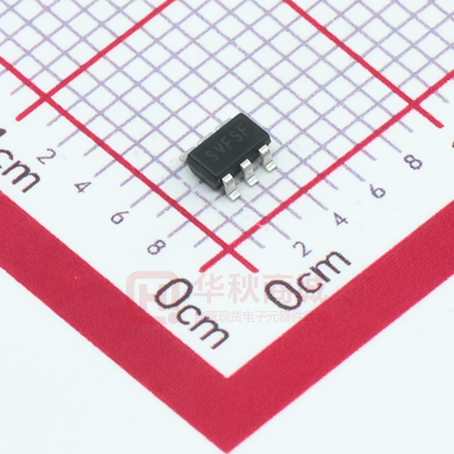

SGM2202-ADJYN6G/TR 数据手册
SGM2202 150mA, High PSRR, High Voltage Regulator GENERAL DESCRIPTION FEATURES The SGM2202 series is a set of low power high voltage ● Low Power Consumption regulators implemented in CMOS technology which can ● 150mA Nominal Output Current provide 150mA output current. The device allows input ● Low Dropout Voltage voltage as high as 36V. The SGM2202 series is available ● High PSRR in adjustable and several fixed output voltages. CMOS ● Low Temperature Coefficient technology ensures low dropout voltage and low ● High Input Voltage (up to 36V) quiescent current. ● Output Voltage Accuracy: ±2.5% ● Fixed Output Voltages: 2.5V, 2.8V, 3.0V, 3.3V and 5.0V Although designed primarily as fixed voltage regulator, ● Adjustable Output Voltages: 0.8V to 13.2V the device can be used with external components to ● -40℃ to +85℃ Operating Temperature Range obtain variable output voltages. ● Available in Green SOT-23-5 and SOT-23-6 Packages The SGM2202 series is available in Green SOT-23-5 APPLICATIONS and SOT-23-6 packages. It operates over an ambient temperature range of -40℃ to +85℃. Battery-Powered Equipment Communication Equipment Audio/Video Equipment TYPICAL APPLICATION VIN VIN CIN 1μF VOUT VOUT SGM2202 ON EN COUT 1μF BP GND OFF CBP 0.01μF Figure 1. Fixed Voltage Typical Application Circuit VIN CIN 1μF OFF EN BP CBP 0.01μF VOUT VOUT VIN ON SGM2202-ADJ GND R1 FB COUT 1μF R2 Figure 2. Adjustable Voltage Typical Application Circuit SG Micro Corp www.sg-micro.com OCTOBER 2020 – REV. A. 2 SGM2202 150mA, High PSRR, High Voltage Regulator PACKAGE/ORDERING INFORMATION SPECIFIED PACKAGE TEMPERATURE DESCRIPTION RANGE MODEL VOUT (V) ORDERING NUMBER PACKAGE MARKING PACKING OPTION SGM2202-2.5 2.5 SOT-23-5 -40℃ to +85℃ SGM2202-2.5YN5G/TR G1DXX Tape and Reel, 3000 SGM2202-2.8 2.8 SOT-23-5 -40℃ to +85℃ SGM2202-2.8YN5G/TR SX5XX Tape and Reel, 3000 SGM2202-3.0 3.0 SOT-23-5 -40℃ to +85℃ SGM2202-3.0YN5G/TR SX6XX Tape and Reel, 3000 SOT-23-5 (L-Type) -40℃ to +85℃ SGM2202-3.0YN5LG/TR G12XX Tape and Reel, 3000 SGM2202-3.3 3.3 SOT-23-5 -40℃ to +85℃ SGM2202-3.3YN5G/TR SX8XX Tape and Reel, 3000 SGM2202-5.0 5.0 SOT-23-5 -40℃ to +85℃ SGM2202-5.0YN5G/TR G3DXX Tape and Reel, 3000 SGM2202-ADJ Adjustable SOT-23-6 -40℃ to +85℃ SGM2202-ADJYN6G/TR SVFXX Tape and Reel, 3000 MARKING INFORMATION NOTE: XX = Date Code. YYY X X Date Code - Month Date Code - Year Serial Number Green (RoHS & HSF): SG Micro Corp defines "Green" to mean Pb-Free (RoHS compatible) and free of halogen substances. If you have additional comments or questions, please contact your SGMICRO representative directly. ABSOLUTE MAXIMUM RATINGS VIN, EN to GND ................................................. -0.3V to 44V VOUT to GND .......................... -0.3V to Min(VIN + 0.3V, 15V) BP, FB to GND .......................... -0.3V to Min(VIN + 0.3V, 6V) Power Dissipation, PD @ TA = +25℃ SOT-23-5, SOT-23-5 (L-Type) ................................... 0.517W SOT-23-6 ................................................................... 0.558W Package Thermal Resistance SOT-23-5, SOT-23-5 (L-Type), θJA .......................... 242℃/W SOT-23-6, θJA .......................................................... 224℃/W Junction Temperature .................................................+150℃ Storage Temperature Range ....................... -65℃ to +150℃ Lead Temperature (Soldering, 10s) ............................+260℃ ESD Susceptibility HBM ............................................................................. 4000V MM ................................................................................. 150V CDM ............................................................................ 1000V RECOMMENDED OPERATING CONDITIONS Input Voltage Range ............................................2.7V to 36V Operating Temperature Range ...................... -40℃ to +85℃ SG Micro Corp www.sg-micro.com OVERSTRESS CAUTION Stresses beyond those listed in Absolute Maximum Ratings may cause permanent damage to the device. Exposure to absolute maximum rating conditions for extended periods may affect reliability. Functional operation of the device at any conditions beyond those indicated in the Recommended Operating Conditions section is not implied. ESD SENSITIVITY CAUTION This integrated circuit can be damaged if ESD protections are not considered carefully. SGMICRO recommends that all integrated circuits be handled with appropriate precautions. Failure to observe proper handling and installation procedures can cause damage. ESD damage can range from subtle performance degradation to complete device failure. Precision integrated circuits may be more susceptible to damage because even small parametric changes could cause the device not to meet the published specifications. DISCLAIMER SG Micro Corp reserves the right to make any change in circuit design, or specifications without prior notice. OCTOBER 2020 2 SGM2202 150mA, High PSRR, High Voltage Regulator PIN CONFIGURATIONS SGM2202-Fixed Output (TOP VIEW) VIN 1 GND 2 EN 3 5 4 SGM2202-3.0 (Only) (TOP VIEW) VOUT BP VIN 1 GND 2 EN 3 SOT-23-5 5 VOUT 4 NC SOT-23-5 (L-Type) SGM2202-ADJ (TOP VIEW) VIN 1 6 VOUT GND 2 5 BP EN 3 4 FB SOT-23-6 PIN DESCRIPTION PIN NAME FUNCTION 1 VIN Regulator Input. Up to 36V input voltage. At least 1μF supply bypass capacitor is recommended. 2 2 GND Ground. 3 3 3 EN ‒ ‒ 4 FB 4 ‒ 5 BP ‒ 4 ‒ NC 5 5 6 VOUT SOT-23-5 SOT-23-5 (L-Type) SOT-23-6 1 1 2 SG Micro Corp www.sg-micro.com Shutdown Input. Connect to VIN pin for normal operation. Feedback Pin (adjustable voltage version only). This is used to set the output voltage of the device. Reference-Noise Bypass Pin. Bypass with a low-leakage 0.01μF ceramic capacitor for reduced noise at the output. Not Connected. Regulator Output. Recommended output capacitor range: 1μF to 10μF. OCTOBER 2020 3 SGM2202 150mA, High PSRR, High Voltage Regulator ELECTRICAL CHARACTERISTICS (VIN = 15V, VEN = 2V, CIN = COUT = 1μF, CBP = 0.01µF, Full = -40℃ to +85℃, typical values are at TA = +25℃, unless otherwise noted.) PARAMETER Input Voltage SYMBOL VIN Output Voltage Accuracy CONDITIONS TEMP Full 2.7 32 2.7 36 IOUT = 1mA +25℃ -2.5 2.5 % +25℃ 15 nA SGM2202-ADJ, VFB = VOUT, IOUT = 1mA IFB SGM2202-ADJ, VFB = 0.9V Full IOUT = 50mA +25℃ VIN = VOUT + 2V or 4V, whichever is greater +25℃ Load Regulation ΔVOUT VIN = VOUT + 2V or 4V, IOUT = 1mA to 150mA Output Voltage Temperature Coefficient (3) ∆VOUT ∆TA × VOUT VOUT = 3.3V, IOUT = 10mA µA 4.2 mA 1300 1840 2380 +25℃ 0.005 0.01 +25℃ 0.005 0.01 24 +25℃ 10 f = 217Hz +25℃ 55 f = 1kHz +25℃ 40 Full 35 VIN = VOUT + 2V or 4V, IOUT = 1mA 5.4 150 Full VIN = VOUT + 2V or 4V to 32V, VOUT < 3.3V IOUT = 1mA VIN = VOUT + 2V to 36V, VOUT ≥ 3.3V IOUT = 1mA V V 6.5 +25℃ IOUT = 150mA, VOUT ≥ 2.5V ∆VOUT ∆VIN × VOUT PSRR 4.2 Full Line Regulation Power Supply Rejection Ratio 0.8 -15 +25℃ No load VDROP UNITS Full VFB Dropout Voltage (2) MAX VOUT ≥ 3.3V FB Input Current Maximum Output Current (1) TYP VOUT < 3.3V Feedback Voltage Ground Pin Current MIN mV %/V mV dB ppm/℃ Shutdown EN Input Threshold EN Input Bias Current Shutdown Supply Current Start-Up Time (4) VIH VIL VIN = 2.7V to 36V Full 1.2 Full 0.4 IBH VEN = VIN Full IBL VEN = 0V Full IQ(SHDN) VEN = 0V +25℃ 1.5 tSTR No load +25℃ 5 ms VIN = 2.7V, VEN = 0V, IOUT = -1mA +25℃ 75 Ω RON of Discharge MOSFET 0.02 -1 1 V 1 2 μA μA Thermal Protection Thermal Shutdown Temperature TSHDN 150 ℃ Thermal Shutdown Hysteresis ΔTSHDN 20 ℃ NOTES: 1. Maximum output current is affected by the PCB layout, size of metal trace, the thermal conduction path between metal layers, ambient temperature and the other environment factors of system. Attention should be paid to the dropout voltage when VIN < VOUT + VDROP. 2. The dropout voltage is defined as VIN - VOUT, when VOUT is 95% of the value of VOUT for VIN = VOUT + 2V. 3. Output voltage temperature coefficient is defined as the worst-case voltage change divided by the total temperature range. 4. Time needed for VOUT to reach 90% of final value. SG Micro Corp www.sg-micro.com OCTOBER 2020 4 SGM2202 150mA, High PSRR, High Voltage Regulator TYPICAL PERFORMANCE CHARACTERISTICS TA = +25℃, VIN = 5.3V, VEN = 2V, VOUT = 3.3V, CIN = COUT = 1μF, CBP = 0.01µF, unless otherwise noted. Load-Transient Response Line-Transient Response VIN = 5.3V to 6.3V, IOUT = 50mA IOUT = 10mA to 100mA VIN 100mV/div 50mA/div IOUT 1V/div 100mV/div VOUT VOUT Time (2ms/div) Time (1ms/div) Power-Up/Power-Down Output Waveform Power Ramp-Up/Ramp-Down Output Waveform VIN = 0V to 5.3V, IOUT = 50mA VIN = 0V to 6.3V, IOUT = 50mA 2V/div 2V/div VIN VIN 2V/div VOUT 2V/div VOUT Time (4ms/div) Time (5ms/div) Output Short Waveform Thermal Protection Waveform 1V/div 100mA/div 2V/div 100mA/div VOUT VOUT IOUT IOUT Time (50ms/div) SG Micro Corp www.sg-micro.com Time (4ms/div) OCTOBER 2020 5 SGM2202 150mA, High PSRR, High Voltage Regulator TYPICAL PERFORMANCE CHARACTERISTICS (continued) TA = +25℃, VIN = 5.3V, VEN = 2V, VOUT = 3.3V, CIN = COUT = 1μF, CBP = 0.01µF, unless otherwise noted. Pulse Load Current Output Waveform Power Supply Rejection Ratio vs. Frequency 100 80 1V/div PSRR (dB) VOUT 100mA/div IOUT IOUT = 10mA ∆VRIP = 0.2VP-P 60 40 20 0 0.01 Time (20ms/div) Dropout Voltage vs. Temperature 10 100 Dropout Voltage vs. Output Current 1600 IOUT = 50mA Dropput Voltage (mV) Dropout Voltage (mV) 1 Frequency (kHz) 600 550 0.1 500 450 400 1200 800 400 350 300 -50 0 -25 0 25 50 75 100 Temperature (℃) 0 25 50 75 100 125 150 Output Current (mA) Ground Pin Current vs. Temperature 5.5 Ground Pin Current (μA) V IN = 36V, No Load 5.0 4.5 4.0 3.5 3.0 -50 -25 0 25 50 75 100 Temperature (℃) SG Micro Corp www.sg-micro.com OCTOBER 2020 6 SGM2202 150mA, High PSRR, High Voltage Regulator DETAILED DESCRIPTION The SGM2202 series is a linear regulator designed primarily for high input voltage applications. The SGM2202 series is available in several fixed output voltages and adjustable from 0.8V to 13.2V with a simple resistor divider. The maximum output current is dependent on the package’s maximum power dissipation for a given temperature. CMOS technology ensures low dropout voltage and low quiescent current. The SGM2202 adjustable voltage version uses external feedback, allowing the user to set the output voltage with an external resistor divider. The typical FB pin voltage is 0.8V. The IC enters shutdown mode when EN is low. In shutdown mode, the pass transistor and control circuitry are turned off, reducing the supply current to < 2μA. Connect EN to VIN for automatic startup. APPLICATION INFORMATION Setting the Output Voltage Set the output voltage of the SGM2202 adjustable voltage version by using a resistor divider as shown: VIN VIN ON CIN 1μF EN OFF BP CBP 0.01μF VOUT VOUT SGM2202ADJ GND C1 R1 FB COUT 1μF R2 Figure 3. SGM2202-ADJ with External Resistor Divider Choose R2 = 2MΩ to maintain a 0.4μA minimum load. Calculate the value for R1 using the following equation: For stable operation, use a ceramic capacitor (COUT) between 1μF and 10μF. Larger values in this range will help improve load transient response and reduce noise. Output capacitors of other dielectric types may be used, but are not recommended as their capacitance can deviate greatly from their rated value over temperature. Thermal Considerations When the junction temperature is too high, the thermal protection circuitry sends a signal to the control logic that will shutdown the IC. The IC will restart when the temperature has sufficiently cooled down. The maximum power dissipation is dependent on the thermal resistance of the case and the circuit board, the temperature difference between the die junction and the ambient air, and the rate of air flow. V  R1 =× R2  OUT − 1 0.8V   Input Capacitor and Output Capacitor For proper operation, place a ceramic capacitor (CIN) between 1μF and 10μF between the input pin and ground. Larger values in this range will help improve line transient response. SG Micro Corp www.sg-micro.com OCTOBER 2020 7 SGM2202 150mA, High PSRR, High Voltage Regulator REVISION HISTORY NOTE: Page numbers for previous revisions may differ from page numbers in the current version. OCTOBER 2020 ‒ REV.A.1 to REV.A.2 Page Updated Package/Ordering Information section ................................................................................................................................................... 2 Changes from Original (APRIL 2017) to REV.A Page Changed from product preview to production data ............................................................................................................................................. All SG Micro Corp www.sg-micro.com OCTOBER 2020 8 PACKAGE INFORMATION PACKAGE OUTLINE DIMENSIONS SOT-23-5 1.90 D e1 E1 2.59 E 0.99 b e 0.69 0.95 RECOMMENDED LAND PATTERN (Unit: mm) L A A1 θ A2 Symbol Dimensions In Millimeters MIN MAX c 0.2 Dimensions In Inches MIN MAX A 1.050 1.250 0.041 0.049 A1 0.000 0.100 0.000 0.004 A2 1.050 1.150 0.041 0.045 b 0.300 0.500 0.012 0.020 c 0.100 0.200 0.004 0.008 D 2.820 3.020 0.111 0.119 E 1.500 1.700 0.059 0.067 E1 2.650 2.950 0.104 0.116 e 0.950 BSC 0.037 BSC e1 1.900 BSC 0.075 BSC SG Micro Corp www.sg-micro.com L 0.300 0.600 0.012 0.024 θ 0° 8° 0° 8° TX00033.000 PACKAGE INFORMATION PACKAGE OUTLINE DIMENSIONS SOT-23-6 D e1 e 2.59 E E1 0.99 b 0.95 0.69 RECOMMENDED LAND PATTERN (Unit: mm) L A A1 θ A2 Symbol Dimensions In Millimeters MIN MAX c 0.2 Dimensions In Inches MIN MAX A 1.050 1.250 0.041 0.049 A1 0.000 0.100 0.000 0.004 A2 1.050 1.150 0.041 0.045 b 0.300 0.500 0.012 0.020 c 0.100 0.200 0.004 0.008 D 2.820 3.020 0.111 0.119 E 1.500 1.700 0.059 0.067 E1 2.650 2.950 0.104 0.116 e 0.950 BSC 0.037 BSC e1 1.900 BSC 0.075 BSC SG Micro Corp www.sg-micro.com L 0.300 0.600 0.012 0.024 θ 0° 8° 0° 8° TX00034.000 PACKAGE INFORMATION TAPE AND REEL INFORMATION REEL DIMENSIONS TAPE DIMENSIONS P2 W P0 Q1 Q2 Q1 Q2 Q1 Q2 Q3 Q4 Q3 Q4 Q3 Q4 B0 Reel Diameter K0 A0 P1 Reel Width (W1) DIRECTION OF FEED NOTE: The picture is only for reference. Please make the object as the standard. KEY PARAMETER LIST OF TAPE AND REEL Reel Diameter Reel Width W1 (mm) A0 (mm) B0 (mm) K0 (mm) P0 (mm) P1 (mm) P2 (mm) W (mm) Pin1 Quadrant SOT-23-5 7″ 9.5 3.20 3.20 1.40 4.0 4.0 2.0 8.0 Q3 SOT-23-6 7″ 9.5 3.17 3.23 1.37 4.0 4.0 2.0 8.0 Q3 SG Micro Corp www.sg-micro.com TX10000.000 DD0001 Package Type PACKAGE INFORMATION CARTON BOX DIMENSIONS NOTE: The picture is only for reference. Please make the object as the standard. KEY PARAMETER LIST OF CARTON BOX Length (mm) Width (mm) Height (mm) Pizza/Carton 7″ (Option) 368 227 224 8 7″ 442 410 224 18 SG Micro Corp www.sg-micro.com DD0002 Reel Type TX20000.000
