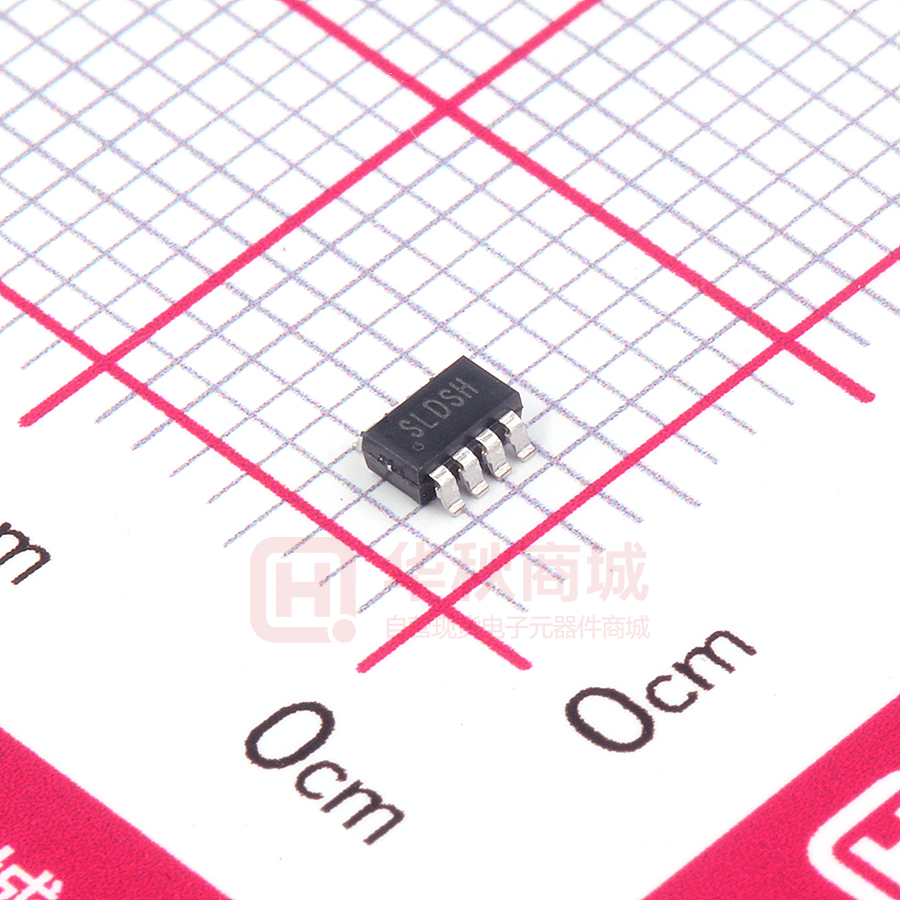

    转换器/电平移位器 双向 SOT23-8 24Mbps 1.65V~5.5VCCA 2.3V~5.5VCCB
SGM4553YN8G/TR 数据手册
SGM4553 2-Bit Bidirectional Voltage-Level Translator for Open-Drain and Push-Pull Applications GENERAL DESCRIPTION FEATURES This two-bit non-inverting translator is a bidirectional voltage-level translator and can be used to establish digital switching compatibility between mixed-voltage systems. It uses two separate configurable power-supply rails, with the A ports supporting operating voltages from 1.65V to 5.5V while it tracks the VCCA supply, and the B ports supporting operating voltages from 2.3V to 5.5V while it tracks the VCCB supply. This allows the support of both lower and higher logic signal levels while providing bidirectional translation capabilities between any of the 1.8V, 2.5V, 3.3V, and 5V voltage nodes.  No Direction-Control Signal Needed  Data Rates 24Mbps (Push-Pull) 2Mbps (Open-Drain)  1.65V to 5.5V on A Ports and 2.3V to 5.5V on B Ports (VCCA ≤ VCCB)  VCC Isolation: If Either VCC is at GND, Both Ports are in the High-Impedance State  No Power-Supply Sequencing Required: Either VCCA or VCCB can be Ramped First  IOFF: Supports Partial-Power-Down Mode Operation  Available in Green SOT-23-8 and XTDFN-1.4×1-8L Packages When the output-enable (OE) input is low, all I/Os are placed in the high-impedance state, which significantly reduces the power-supply quiescent current consumption. OE has an internal pull-down current source, as long as VCCA is powered. To ensure the high-impedance state during power up or power down, OE should be tied to GND through a pull-down resistor; the minimum value of the resistor is determined by the current-sourcing capability of the driver. APPLICATIONS I2C/SMBus UART GPIO The SGM4553 is available in the Green SOT-23-8 and XTDFN-1.4×1-8L packages. It operates over an ambient temperature range of -40℃ to +85℃. TYPICAL APPLICATION CIRCUIT 1.8V 1μF 3.3V 0.1μF 0.1μF 1.8V System Controller VCCB VCCA OE 1μF 3.3V System SGM4553 DATA GND SG Micro Corp www.sg-micro.com A1 A2 GND B1 B2 DATA GND REV. A 2-Bit Bidirectional Voltage-Level Translator for Open-Drain and Push-Pull Applications SGM4553 PACKAGE/ORDERING INFORMATION PACKAGE DESCRIPTION MODEL SGM4553 ORDERING NUMBER PACKAGE MARKING PACKAGE OPTION SOT-23-8 SGM4553YN8G/TR SLDXX Tape and Reel, 3000 XTDFN-1.4×1-8L SGM4553YXDO8G/TR N2X Tape and Reel, 5000 NOTE: X = Date Code, XX = Date Code. MARKING INFORMATION SLD X X Date code - Month ("A" = Jan. "B" = Feb. … "L" = Dec.) Date code - Year ("A" = 2010, "B" = 2011 …) Chip I.D. For example: SLDDB (2013, February) ABSOLUTE MAXIMUM RATINGS VCCA, Supply Voltage Range..................................... -0.3V to 6V VCCB, Supply Voltage Range..................................... -0.3V to 6V (2) VI, A Ports, B Ports, OE Input Voltage Range ........-0.3V to 6V VO, Voltage Range Applied to Any Output in the High(2) Impedance or Power-Off State A Ports.................................................................... -0.3V to 6V B Ports.....................................................................-0.3V to 6V VO, Voltage Range Applied to Any Output in the High or Low (2) (3) State A Ports.......................................................-0.3V to VCCA + 0.3V B Ports.......................................................-0.3V to VCCB + 0.3V IIK, Input Clamp Current (VI < 0) .......................................-50mA IOK, Output Clamp Current (VO < 0) ..................................-50mA IO, Continuous Output Current..........................................±50mA Continuous Current through VCCA, VCCB, or GND........…±100mA Operating Temperature Range........................... -40℃ to +85℃ Junction Temperature....................................................... 150℃ Storage Temperature Range............................. -65℃ to +150℃ Lead Temperature (Soldering, 10sec).............................. 260℃ ESD Susceptibility HBM..................................................................................4000V MM......................................................................................300V NOTES: 1. Stresses beyond those listed under “Absolute Maximum Ratings” may cause permanent damage to the device. These are stress ratings only, and functional operation of the device at these or any other conditions beyond those indicated in the operational sections of the specifications is not implied. Exposure to absolute Maximum rating conditions for extended periods may affect device reliability. 2. The input and output negative-voltage ratings may be exceeded if the input and output current ratings are observed. 3. The value of VCCA and VCCB are provided in the recommended operating conditions table. CAUTION This integrated circuit can be damaged by ESD if you don’t pay attention to ESD protection. SGMICRO recommends that all integrated circuits be handled with appropriate precautions. Failure to observe proper handling and installation procedures can cause damage. ESD damage can range from subtle performance degradation to complete device failure. Precision integrated circuits may be more susceptible to damage because very small parametric changes could cause the device not to meet its published specifications. SGMICRO reserves the right to make any change in circuit design, specification or other related things if necessary without notice at any time. Please contact SGMICRO sales office to get the latest datasheet. SG Micro Corp www.sg-micro.com 2 2-Bit Bidirectional Voltage-Level Translator for Open-Drain and Push-Pull Applications SGM4553 PIN CONFIGURATIONS (TOP VIEW) VCCB 1 8 VCCA B1 2 7 A1 B2 3 6 A2 OE 4 5 GND SOT-23-8 VCCA 1 8 VCCB A1 2 7 B1 A2 3 6 B2 GND 4 5 OE XTDFN-1.4×1-8L PIN DESCRIPTION SOT-23-8 1 2 3 PIN XTDFN-1.4×1-8L 8 7 6 4 5 OE 5 6 7 8 4 3 2 1 GND A2 A1 VCCA SG Micro Corp www.sg-micro.com NAME FUNCTION VCCB B1 B2 B Ports Supply Voltage. 2.3V ≤ VCCB ≤ 5.5V. Input/Output B. Referenced to VCCB. Input/Output B. Referenced to VCCB. Output Enable (Active High). Pull OE low to place all outputs in 3-state mode. Referenced to VCCA. Ground. Input/Output A. Referenced to VCCA. Input/Output A. Referenced to VCCA. A Ports Supply Voltage. 1.65V ≤ VCCA ≤ 5.5V and VCCA ≤ VCCB. 3 2-Bit Bidirectional Voltage-Level Translator for Open-Drain and Push-Pull Applications SGM4553 ELECTRICAL CHARACTERISTICS (VCCA = 1.65V to 5.5V, VCCB = 2.3V to 5.5V, Full = -40℃ to +85℃, typical values are at TA = +25℃, unless otherwise noted.) PARAMETER CONDITIONS TEMP MIN VCCA Full 1.65 5.5 VCCB Full 2.3 5.5 VCCA = 1.65V to 1.95V, VCCB = 2.3V to 5.5V Full VCCI - 0.2 VCCI VCCA = 2.3V to 5.5V, VCCB = 2.3V to 5.5V Full VCCI - 0.4 VCCI B Port I/Os Full VCCI - 0.4 VCCI OE Input Full VCCA × 0.8 5.5 A Port I/Os Full 0 0.15 RECOMMENDED OPERATING CONDITIONS Supply Voltage (3) A Port I/Os High-Level Input Voltage (VIH) Low-Level Input Voltage (VIL) TYP MAX B Port I/Os Full 0 0.15 OE Input Full 0 VCCA × 0.25 A Port I/Os Push-Pull Driving Full 10 B Port I/Os Push-Pull Driving Full 10 Control Input Full 10 A Ports High Level Output Voltage (VOHA) IOH = -20µA, VIB ≥ VCCB - 0.4V Full A Ports Low Level Output Voltage (VOLA) IOL = 1mA, VIB ≤ 0.15V Full B Ports High Level Output Voltage (VOHB) IOH = -20µA, VIA ≥ VCCA - 0.4V Full B Ports Low Level Output Voltage (VOLB) IOL = 1mA, VIA ≤ 0.15V Input Transition Rise or Fall Rate (Δt/ΔV) UNITS (1) (2) V V V ns/V ELECTRICAL CHARACTERISTICS Input Leakage Current (II) Full 0.4 ±1 Full ±1.5 +25℃ ±0.5 Full ±1 +25℃ ±0.5 Full ±1 +25℃ ±0.6 Full ±1 VCCA = 1.65V to VCCB, VCCB = 2.3V to 5.5V Full 5.5 VCCA = 5.5V, VCCB = 0V Full 5.5 VCCA = 0V, VCCB = 5.5V Full -1 VCCA = 1.65V to VCCB, VCCB = 2.3V to 5.5V Full 15 VCCA = 5.5V, VCCB = 0V Full -1 VCCA = 0V, VCCB = 5.5V Full 6 VCCA = 1.65V to VCCB, VCCB = 2.3V to 5.5V Full 20 OE A Ports VCCA = 0V, VCCB = 0V to 5.5V B Ports VCCA = 0V to 5.5V, VCCB = 0V A or B Ports Quiescent Supply Current (ICCA) Quiescent Supply Current (ICCB) Quiescent Supply Current (ICCA + ICCB) SG Micro Corp www.sg-micro.com OE = 0V VI = VO = OPEN, IO = 0 VI = VO = OPEN, IO = 0 VI = VO = OPEN, IO = 0 0.4 VCCB × 0.7 +25℃ Power Off Leakage Current (IOFF) 3-State Output Leakage (IOZ) VCCA × 0.7 V μA μA μA μA μA μA 4 SGM4553 2-Bit Bidirectional Voltage-Level Translator for Open-Drain and Push-Pull Applications ELECTRICAL CHARACTERISTICS (VCCA = 1.65V to 5.5V, VCCB = 2.3V to 5.5V, Full = -40℃ to +85℃, typical values are at TA = +25℃, unless otherwise noted.) PARAMETER CONDITIONS TEMP MAX UNITS Full 5.5 μA Full 5.5 μA Quiescent Supply Current (ICCZA) VI = VCCI or 0V, IO = 0, OE = 0V VCCA = 1.65V to VCCB, VCCB = 2.3V to 5.5V Quiescent Supply Current (ICCZB) VI = VCCI or 0V, IO = 0, OE = 0V VCCA = 1.65V to VCCB, VCCB = 2.3V to 5.5V OE Input Capacitance (CI) VCCA = 3.3V, VCCB = 3.3V +25℃ VCCA = 3.3V, VCCB = 3.3V +25℃ Input/Output Capacitance A Ports (CIO) Input/Output Capacitance B Ports (CIO) MIN TYP 4 5 5 pF pF NOTES: 1. VCCI is the VCC associated with the input ports. 2. VCCO is the VCC associated with the output ports. 3. VCCA must be less than or equal to VCCB, and VCCA must not exceed 5.5V. SG Micro Corp www.sg-micro.com 5 2-Bit Bidirectional Voltage-Level Translator for Open-Drain and Push-Pull Applications SGM4553 TIMING REQUIREMENTS VCCB = 2.5V VCCB = 3.3V VCCB = 5V TYP TYP TYP Push-Pull Driving 21 22 24 Open-Drain Driving 2 2 2 47 45 41 500 500 500 Push-Pull Driving 20 22 24 Open-Drain Driving 2 2 2 50 45 41 500 500 500 Push-Pull Driving 23 24 Open-Drain Driving 2 2 43 41 500 500 UNITS (TA = +25℃, VCCA = 1.8V, unless otherwise noted.) Data Rate Pulse Duration (tW) Push-Pull Driving Open-Drain Driving Data Inputs Mbps ns (TA = +25℃, VCCA = 2.5V, unless otherwise noted.) Data Rate Pulse Duration (tW) Push-Pull Driving Open-Drain Driving Data Inputs Mbps ns (TA = +25℃, VCCA = 3.3V, unless otherwise noted.) Data Rate Pulse Duration (tW) Push-Pull Driving Open-Drain Driving Data Inputs Mbps ns (TA = +25℃, VCCA = 5V, unless otherwise noted.) Data Rate Pulse Duration (tW) Push-Pull Driving 24 Open-Drain Driving 2 Push-Pull Driving Open-Drain Driving SG Micro Corp www.sg-micro.com Data Inputs 41 500 Mbps ns 6 2-Bit Bidirectional Voltage-Level Translator for Open-Drain and Push-Pull Applications SGM4553 SWITCHING CHARACTERISTICS (TA = +25℃, VCCA = 1.8V, unless otherwise noted. ) PARAMETER FROM (INPUT) TO (OUTPUT) tPHL A B tPLH tPHL B A tPLH TEST CONDITIONS VCCB = 2.5V VCCB = 3.3V VCCB = 5V TYP TYP TYP Push-Pull Driving 2.4 3.0 4.3 Open-Drain Driving 26.0 26.3 26.7 Push-Pull Driving 4.0 3.6 3.5 Open-Drain Driving 175 145 110 Push-Pull Driving 2.0 1.9 2.1 Open-Drain Driving 26.0 26.1 26.2 Push-Pull Driving 1.7 1.5 1.4 Open-Drain Driving 133 69 51 tEN (tPZH & tPZL) OE A or B 24 20 18 tDIS (tPHZ & tPLZ) OE A or B 1200 1200 1200 Push-Pull Driving 6.6 5.8 5.4 Open-Drain Driving 89 31 10 Push-Pull Driving 5.6 4.6 3.9 Open-Drain Driving 128 98 58 Push-Pull Driving 2.9 2.7 2.6 Open-Drain Driving 1.9 1.7 1.6 Push-Pull Driving 4.6 5.9 8.0 Open-Drain Driving 2.2 2.3 2.9 0.5 0.5 0.5 Push-Pull Driving 21 22 24 Open-Drain Driving 2 2 2 trA A Ports Rise Time trB B Ports Rise Time tfA A Ports Fall Time tfB B Ports Fall Time tsk(0) Channel-to-Channel Skew Data Rate SG Micro Corp www.sg-micro.com UNITS ns ns ns ns ns ns ns ns Mbps 7 2-Bit Bidirectional Voltage-Level Translator for Open-Drain and Push-Pull Applications SGM4553 SWITCHING CHARACTERISTICS (TA = +25℃, VCCA = 2.5V, unless otherwise noted. ) PARAMETER FROM (INPUT) TO (OUTPUT) tPHL A B tPLH tPHL B A tPLH TEST CONDITIONS VCCB = 2.5V VCCB = 3.3V VCCB = 5V TYP TYP TYP Push-Pull Driving 2.7 3.3 4.8 Open-Drain Driving 26.2 26.4 26.7 Push-Pull Driving 2.6 2.4 2.3 Open-Drain Driving 169 144 110 Push-Pull Driving 2.4 2.3 2.4 Open-Drain Driving 26.3 26.4 26.5 Push-Pull Driving 2.0 1.9 1.8 Open-Drain Driving 165 118 55 tEN (tPZH & tPZL) OE A or B 23 19 16 tDIS (tPHZ & tPLZ) OE A or B 1200 1200 1200 Push-Pull Driving 3.2 2.8 2.6 Open-Drain Driving 120 70 10 Push-Pull Driving 4.5 3.4 2.6 Open-Drain Driving 122 96 62 Push-Pull Driving 4.9 5.0 4.8 Open-Drain Driving 2.0 1.9 1.7 Push-Pull Driving 4.8 6.1 8.3 Open-Drain Driving 1.9 2.1 2.7 0.5 0.5 0.5 Push-Pull Driving 20 22 24 Open-Drain Driving 2 2 2 trA A Ports Rise Time trB B Ports Rise Time tfA A Ports Fall Time tfB B Ports Fall Time tsk(0) Channel-to-Channel Skew Data Rate SG Micro Corp www.sg-micro.com UNITS ns ns ns ns ns ns ns ns Mbps 8 2-Bit Bidirectional Voltage-Level Translator for Open-Drain and Push-Pull Applications SGM4553 SWITCHING CHARACTERISTICS (TA = +25℃, VCCA = 3.3V, unless otherwise noted. ) PARAMETER FROM (INPUT) TO (OUTPUT) tPHL A B tPLH tPHL B A tPLH TEST CONDITIONS VCCB = 3.3V VCCB = 5V TYP TYP Push-Pull Driving 3.5 4.9 Open-Drain Driving 26.3 26.7 Push-Pull Driving 2.2 2.0 Open-Drain Driving 133 104 Push-Pull Driving 3.0 3.2 Open-Drain Driving 26.6 26.8 Push-Pull Driving 1.8 1.7 Open-Drain Driving 132 83 tEN (tPZH & tPZL) OE A or B 18 15 tDIS (tPHZ & tPLZ) OE A or B 1200 1200 Push-Pull Driving 2.2 2.0 Open-Drain Driving 87 36 Push-Pull Driving 2.9 2.3 Open-Drain Driving 87 56 Push-Pull Driving 6.2 5.8 Open-Drain Driving 2.3 2.0 Push-Pull Driving 6.5 8.2 Open-Drain Driving 2.0 2.5 0.5 0.5 Push-Pull Driving 23 24 Open-Drain Driving 2 2 trA A Ports Rise Time trB B Ports Rise Time tfA A Ports Fall Time tfB B Ports Fall Time tsk(0) Channel-to-Channel Skew Data Rate SG Micro Corp www.sg-micro.com UNITS ns ns ns ns ns ns ns ns Mbps 9 2-Bit Bidirectional Voltage-Level Translator for Open-Drain and Push-Pull Applications SGM4553 SWITCHING CHARACTERISTICS (TA = +25℃, VCCA = 5V, unless otherwise noted. ) PARAMETER FROM (INPUT) TO (OUTPUT) tPHL A B tPLH tPHL B A tPLH TEST CONDITIONS VCCB = 5V Push-Pull Driving 5.4 Open-Drain Driving 26.7 Push-Pull Driving 1.9 Open-Drain Driving 120 Push-Pull Driving 5.6 Open-Drain Driving 27.3 Push-Pull Driving 1.7 Open-Drain Driving 126 TYP tEN (tPZH & tPZL) OE A or B 16 tDIS (tPHZ & tPLZ) OE A or B 1200 trA A Ports Rise Time trB B Ports Rise Time tfA A Ports Fall Time tfB B Ports Fall Time tsk(0) Channel-to-Channel Skew Data Rate SG Micro Corp www.sg-micro.com Push-Pull Driving 1.8 Open-Drain Driving 79 Push-Pull Driving 2.2 Open-Drain Driving 73 Push-Pull Driving 8.7 Open-Drain Driving 2.7 Push-Pull Driving 8.6 Open-Drain Driving 2.4 0.5 Push-Pull Driving 24 Open-Drain Driving 2 UNITS ns ns ns ns ns ns ns ns Mbps 10 2-Bit Bidirectional Voltage-Level Translator for Open-Drain and Push-Pull Applications SGM4553 APPLICATION INFORMATION Applications The SGM4553 can be used to bridge the digital-switching compatibility gap between two voltage nodes to successfully interface logic threshold levels found in electronic systems. It should be used in a point-to-point topology for interfacing devices or systems operating at different interface voltages with one another. Its primary target application use is for interfacing with open-drain drivers on the data I/Os such as I2C or 1-wire, where the data is bidirectional and no control signal is available. The SGM4553 can also be used in applications where a push-pull driver is connected to the data I/Os. Architecture The SGM4553 architecture (see Figure 1) is an auto-direction-sensing based translator that does not require a direction-control signal to control the direction of data flow from A to B or from B to A. These two bidirectional channels independently determine the direction of data flow without a direction-control signal. Each I/O pin can be automatically reconfigured as either an input or an output, which is how this auto-direction feature is realized. T1 Oneshot Oneshot T2 R1 10kΩ R2 10kΩ Gate Bias A B N Figure 1. Architecture of an SGM4553 Cell SG Micro Corp www.sg-micro.com Input Driver Requirements The fall time (tfA, tfB) of a signal depends on the output impedance of the external device driving the data I/Os of the SGM4553. Similarly, the tPHL and data rates also depend on the output impedance of the external driver. The values for tfA, tfB, tPHL, and data rates in the datasheet assume that the output impedance of the external driver is less than 50Ω. Power Up During operation, ensure that VCCA ≤ VCCB at all times. The sequencing of each power supply will not damage the device during the power up operation, so either power supply can be ramped up first. Output Load Considerations VCCB VCCA The SGM4553 employs two key circuits to enable this voltage translation:  An N-channel pass-gate transistor topology that ties the A port to the B port.  Output one-shot (O.S.) edge-rate accelerator circuitry to detect and accelerate rising edges on the A or B ports. We recommend careful PCB layout practices with short PCB trace lengths to avoid excessive capacitive loading and to ensure that proper O.S. triggering takes place. PCB signal trace-lengths should be kept short enough such that the round trip delay of any reflection is less than the one-shot duration. This improves signal integrity by ensuring that any reflection sees a low impedance at the driver. The O.S. circuits have been designed to stay on for approximately 30ns. The maximum capacitance of the lumped load that can be driven also depends directly on the one-shot duration. With very heavy capacitive loads, the one-shot can time-out before the signal is driven fully to the positive rail. The O.S. duration has been set to best optimize trade-offs between dynamic ICC, load driving capability, and maximum bit-rate considerations. Both PCB trace length and connectors add to the capacitance that the SGM4553 output sees, so it is recommended that this lumped-load capacitance be considered to avoid O.S. retriggering, bus contention, output signal oscillations, or other adverse system-level affects. 11 SGM4553 2-Bit Bidirectional Voltage-Level Translator for Open-Drain and Push-Pull Applications APPLICATION INFORMATION Enable and Disable Pull-Up or Pull-Down Resistors on I/O Lines The SGM4553 has an OE input that is used to disable the device by setting OE low, which places all I/Os in the Hi-Z state. OE has an internal pull-down current source, as long as VCCA is powered. The disable time (tDIS) indicates the delay between the time when OE goes low and when the outputs are disabled (Hi-Z). The enable time (tEN) indicates the amount of time the user must allow for the one-shot circuitry to become operational after OE is taken high. Each A port I/O has an internal 10kΩ pull-up resistor to VCCA, and each B port I/O has an internal 10kΩ pull-up resistor to VCCB. If a smaller value of pull-up resistor is required, an external resistor must be added from the I/O to VCCA or VCCB (in parallel with the internal 10kΩ resistors). Adding lower value pull-up resistors will affect VOL levels, however. The internal pull-ups of the SGM4553 are disabled when the OE pin is low. SG Micro Corp www.sg-micro.com 12 2-Bit Bidirectional Voltage-Level Translator for Open-Drain and Push-Pull Applications SGM4553 PARAMETER MEASUREMENT INFORMATION VCCI VCCI VCCO VCCO DUT DUT IN OUT IN 15pF OUT 1MΩ 15pF DATA RATE, PULSE DURATION, PROPAGATION DELAY, OUTPUT RISE AND FALL TIME MEASUREMENT USING A PUSH-PULL DRIVER 1MΩ DATA RATE, PULSE DURATION, PROPAGATION DELAY, OUTPUT RISE AND FALL TIME MEASUREMENT USING AN OPEN-DRAIN DRIVER 50kΩ S1 From Output Under Test 15pF 2 × VCCO Open 50kΩ LOAD CIRCUIT FOR ENABLE/DISABLE TIME MEASUREMENT TEST S1 tPZL/tPLZ 2 × VCCO tPHZ/tPZH Open tW VCCI Input Output Control (high-level enabling) VCCI/2 VCCI/2 0V VOLTAGE WAVEFORMS PULSE DURATION VCCI VCCI/2 Input VCCI/2 0V VCCA/2 0V tPZL tPLZ 0.1 × VCCO VCCO/2 VCCO/2 0.9 × VCCO 0.1 × VCCO tr VOH VCCO/2 VOL Output Waveform 2 S1 at OPEN (see Note 2) tPZH VCCO VOL tPHL tPLH Output Output Waveform 1 S1 at 2 × VCCO (see Note 2) VCCA VCCA/2 tPHZ VOH 0.9 × VCCO VCCO/2 0V tf VOLTAGE WAVEFORMS PROPAGATION DELAY TIMES VOLTAGE WAVEFORMS ENABLE AND DISABLE TIMES NOTES: 1. CL includes probe and jig capacitance. 2. Waveform 1 is for an output with internal conditions such that the output is low, except when disabled by the output control. Waveform 2 is for an output with internal conditions such that the output is high, except when disabled by the output control. 3. All input pulses are supplied by generators having the following characteristics: PRR ≤ 10MHz, ZO = 50Ω, dv/dt ≥ 1V/ns. 4. The outputs are measured one at a time, with one transition per measurement. 5. tPLZ and tPHZ are the same as tDIS. 6. tPZL and tPZH are the same as tEN. 7. tPLH and tPHL are the same as tPD. 8. VCCI is the VCC associated with the input ports. 9. VCCO is the VCC associated with the output ports. 10. All parameters and waveforms are not applicable to all devices. Figure 2. Load Circuit and Voltage Waveforms SG Micro Corp www.sg-micro.com 13 2-Bit Bidirectional Voltage-Level Translator for Open-Drain and Push-Pull Applications SGM4553 PACKAGE OUTLINE DIMENSIONS SOT-23-8 D e1 0.65 0.4 e E1 E 2.59 0.99 b RECOMMENDED LAND PATTERN (Unit: mm) L A θ A1 c 0.2 A2 Symbol Dimensions In Millimeters MIN MAX Dimensions In Inches MIN MAX A 1.050 1.250 0.041 0.049 A1 0.000 0.100 0.000 0.004 A2 1.050 1.150 0.041 0.045 b 0.300 0.500 0.012 0.020 c 0.100 0.200 0.004 0.008 D 2.820 3.020 0.111 0.119 E 1.500 1.700 0.059 0.067 E1 2.650 2.950 0.104 0.116 e 0.650 BSC 0.026 BSC e1 0.975 BSC 0.038 BSC L 0.300 0.600 0.012 0.024 θ 0° 8° 0° 8° SG Micro Corp www.sg-micro.com 14 2-Bit Bidirectional Voltage-Level Translator for Open-Drain and Push-Pull Applications SGM4553 PACKAGE OUTLINE DIMENSIONS XTDFN-1.4×1-8L e D N5 N8 L k E N4 N1 b TOP VIEW L1 BOTTOM VIEW 0.20 0.50 1.20 A A1 A2 SIDE VIEW 0.35 0.20 RECOMMENDED LAND PATTERN (Unit: mm) Symbol Dimensions In Millimeters Dimensions In Inches MIN MAX MIN MAX A 0.340 0.400 0.013 0.016 A1 0.000 0.050 0.000 A2 0.110 REF 0.002 0.004 REF D 1.350 1.450 0.053 0.057 E 0.950 1.050 0.037 0.041 k b 0.200 MIN 0.150 e 0.008 MIN 0.200 0.006 0.350 TYP 0.008 0.014 TYP L 0.250 0.350 0.010 0.014 L1 0.350 0.450 0.014 0.018 SG Micro Corp www.sg-micro.com 15 2-Bit Bidirectional Voltage-Level Translator for Open-Drain and Push-Pull Applications SGM4553 TAPE AND REEL INFORMATION REEL DIMENSIONS TAPE DIMENSIONS P2 W P0 Q1 Q2 Q1 Q2 Q1 Q2 Q3 Q4 Q3 Q4 Q3 Q4 B0 Reel Diameter P1 A0 K0 DIRECTION OF FEED Reel Width (W1) NOTE: The picture is only for reference. Please make the object as the standard. KEY PARAMETER LIST OF TAPE AND REEL Package Type Reel Diameter Reel Width W1 (mm) A0 (mm) B0 (mm) K0 (mm) P0 (mm) P1 (mm) P2 (mm) W (mm) Pin1 Quadrant SOT-23-8 7″ 9.5 3.17 3.23 1.37 4.0 4.0 2.0 8.0 Q3 XTDFN-1.4×1-8L 7″ 9.5 1.15 1.6 0.5 4.0 4.0 2.0 8.0 Q1 SG Micro Corp www.sg-micro.com 16 2-Bit Bidirectional Voltage-Level Translator for Open-Drain and Push-Pull Applications SGM4553 CARTON BOX DIMENSIONS NOTE: The picture is only for reference. Please make the object as the standard. KEY PARAMETER LIST OF CARTON BOX Reel Type Length (mm) Width (mm) Height (mm) Pizza/Carton 7″ (Option) 368 227 224 8 7″ 442 410 224 18 SG Micro Corp www.sg-micro.com 17
