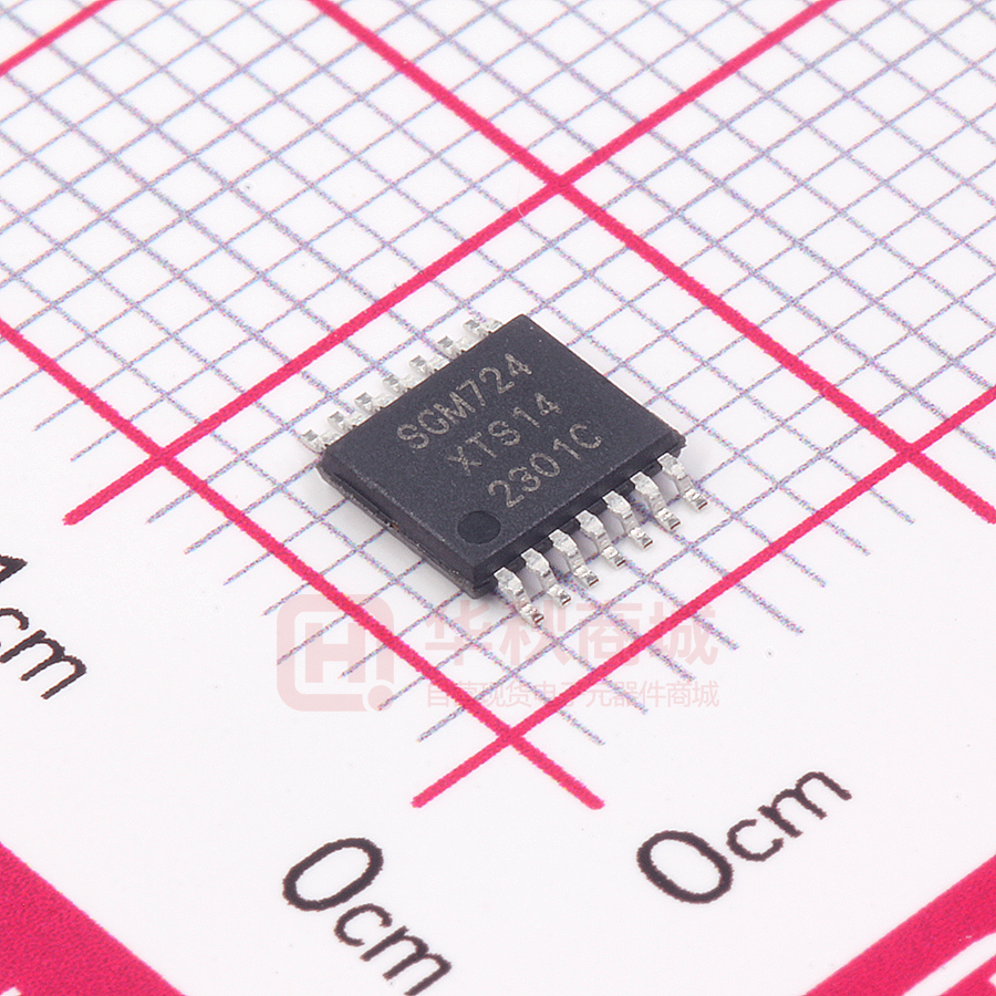

SGM721/SGM722/SGM723/SGM724 11MHz, Rail-to-Rail I/O CMOS Operational Amplifiers GENERAL DESCRIPTION FEATURES The SGM721 (single), SGM722 (dual), SGM723 (single ● Rail-to-Rail Input and Output with shutdown) and SGM724 (quad) are low noise, low ● Input Offset Voltage: 4mV (MAX) voltage and low power operational amplifiers, that can ● High Gain-Bandwidth Product: 11MHz be designed into a wide range of applications. The ● High Slew Rate: 8.5V/μs SGM721/2/3/4 have a high gain-bandwidth product of ● Settling Time to 0.1% with 2V Step: 0.21μs 11MHz and a slew rate of 8.5V/μs. The SGM723 has a ● Overload Recovery Time: 0.6μs power-down disable feature that reduces the supply ● Low Noise: 8.5nV/√Hz at 10kHz current to less than 1μA. ● Supply Voltage Range: 2.1V to 5.5V The SGM721/2/3/4 are designed to provide optimal performance in low voltage and low noise systems. They provide rail-to-rail output swing into heavy loads. The input common mode voltage range includes ground, and the maximum input offset voltage is 4mV for SGM721/2/3/4. They are specified over the extended industrial temperature range (-40℃ to +125℃). The operating supply range is from 2.1V to 5.5V. The single version, SGM721 is available in Green SC70-5, SOT-23-5 and SOIC-8 packages. SGM723 is available in Green SOT-23-6 and SOIC-8 packages. The dual version SGM722 is available in Green SOIC-8, MSOP-8 and TSSOP-8 packages. The quad version SGM724 is available in Green SOIC-14 and TSSOP-14 packages. ● Input Voltage Range: -0.1V to 5.6V with VS = 5.5V ● Low Power: SGM721/3: 1.2mA (TYP) SGM722/4: 1.1mA/Amplifier (TYP) SGM723 Less than 1μA when Disabled ● -40℃ to +125℃ Operating Temperature Range ● Small Packaging: SGM721 Available in Green SC70-5, SOT-23-5 and SOIC-8 Packages SGM722 Available in Green MSOP-8, SOIC-8 and TSSOP-8 Packages SGM723 Available in Green SOT-23-6 and SOIC-8 Packages SGM724 Available in Green TSSOP-14 and SOIC-14 Packages APPLICATIONS Sensors Audio Active Filters A/D Converters Communications Test Equipment Cellular and Cordless Phones Laptops and PDAs Photodiode Amplification Battery-Powered Instrumentation SG Micro Corp www.sg-micro.com NOVEMBER 2019 - REV. C. 3 SGM721/SGM722 SGM723/SGM724 11MHz, Rail-to-Rail I/O CMOS Operational Amplifiers PACKAGE/ORDERING INFORMATION MODEL SGM721 SGM722 PACKAGE DESCRIPTION SPECIFIED TEMPERATURE RANGE ORDERING NUMBER PACKAGE MARKING PACKING OPTION SC70-5 -40℃ to +125℃ SGM721XC5/TR 721 Tape and Reel, 3000 SOT-23-5 -40℃ to +125℃ SGM721XN5/TR 721 Tape and Reel, 3000 SOIC-8 -40℃ to +125℃ SGM721XS/TR SGM721XS XXXXX Tape and Reel, 2500 MSOP-8 -40℃ to +125℃ SGM722XMS/TR SGM722 XMS XXXXX Tape and Reel, 3000 SOIC-8 -40℃ to +125℃ SGM722XS/TR SGM722XS XXXXX Tape and Reel, 2500 TSSOP-8 -40℃ to +125℃ SGM722XTS8G/TR SGM722 XTS8 XXXXX Tape and Reel, 4000 SOT-23-6 -40℃ to +125℃ SGM723XN6/TR 723 Tape and Reel, 3000 SOIC-8 -40℃ to +125℃ SGM723XS/TR SGM723XS XXXXX Tape and Reel, 2500 SOIC-14 -40℃ to +125℃ SGM724XS14/TR SGM724XS14 XXXXX Tape and Reel, 2500 TSSOP-14 -40℃ to +125℃ SGM724XTS14/TR SGM724 XTS14 XXXXX Tape and Reel, 3000 SGM723 SGM724 MARKING INFORMATION NOTE: XXXXX = Date Code and Vendor Code. SOIC-8/MSOP-8/TSSOP-8/SOIC-14/TSSOP-14 XXXXX Vendor Code Date Code - Week Date Code - Year Green (RoHS & HSF): SG Micro Corp defines "Green" to mean Pb-Free (RoHS compatible) and free of halogen substances. If you have additional comments or questions, please contact your SGMICRO representative directly. SG Micro Corp www.sg-micro.com NOVEMBER 2019 2 SGM721/SGM722 SGM723/SGM724 ABSOLUTE MAXIMUM RATINGS Supply Voltage, +VS to -VS ................................................ 7V Input Common Mode Voltage Range .................................................... (-VS) - 0.3V to (+VS) + 0.3V Package Thermal Resistance @ TA = +25℃ SC70-5, θJA .............................................................. 333℃/W SOT-23-5, θJA .......................................................... 190℃/W SOT-23-6, θJA .......................................................... 190℃/W SOIC-8, θJA .............................................................. 125℃/W MSOP-8, θJA ............................................................ 216℃/W TSSOP-8, θJA........................................................... 170℃/W Junction Temperature .................................................+150℃ Storage Temperature Range ........................ -65℃ to +150℃ Lead Temperature (Soldering, 10s) ............................+260℃ ESD Susceptibility HBM (SGM721/2/4) ..................................................... 8000V HBM (SGM723) ........................................................... 4000V MM ................................................................................. 400V CDM ............................................................................ 1000V RECOMMENDED OPERATING CONDITIONS Operating Temperature Range ..................... -40℃ to +125℃ SG Micro Corp www.sg-micro.com 11MHz, Rail-to-Rail I/O CMOS Operational Amplifiers OVERSTRESS CAUTION Stresses beyond those listed in Absolute Maximum Ratings may cause permanent damage to the device. Exposure to absolute maximum rating conditions for extended periods may affect reliability. Functional operation of the device at any conditions beyond those indicated in the Recommended Operating Conditions section is not implied. ESD SENSITIVITY CAUTION This integrated circuit can be damaged if ESD protections are not considered carefully. SGMICRO recommends that all integrated circuits be handled with appropriate precautions. Failure to observe proper handling and installation procedures can cause damage. ESD damage can range from subtle performance degradation to complete device failure. Precision integrated circuits may be more susceptible to damage because even small parametric changes could cause the device not to meet the published specifications. DISCLAIMER SG Micro Corp reserves the right to make any change in circuit design, or specifications without prior notice. NOVEMBER 2019 3 SGM721/SGM722 SGM723/SGM724 11MHz, Rail-to-Rail I/O CMOS Operational Amplifiers PIN CONFIGURATIONS SGM721 (TOP VIEW) OUT -VS +IN SGM721/723 (TOP VIEW) 5 1 +VS NC 1 8 DISABLE (SGM723 ONLY) -IN 2 7 +VS +IN 3 6 OUT -VS 4 5 NC 2 3 4 -IN SC70-5/SOT-23-5 SOIC-8 SGM723 (TOP VIEW) OUT 1 6 -VS 2 5 +IN 3 NC = NO CONNECT 4 SGM722 (TOP VIEW) OUTA 1 8 +VS -INA 2 7 OUTB +INA 3 6 -INB -VS 4 5 +INB +VS DISABLE -IN SOT-23-6 SOIC-8/MSOP-8/TSSOP-8 SGM724 (TOP VIEW) OUTA 1 14 OUTD -INA 2 13 -IND +INA 3 12 +IND +VS 4 11 -VS +INB 5 10 +INC -INB 6 9 -INC OUTB 7 8 OUTC TSSOP-14/SOIC-14 SG Micro Corp www.sg-micro.com NOVEMBER 2019 4 SGM721/SGM722 SGM723/SGM724 11MHz, Rail-to-Rail I/O CMOS Operational Amplifiers ELECTRICAL CHARACTERISTICS (At TA = +25℃, VS = +5V, VCM = VS/2, RL = 600Ω, unless otherwise noted.) SGM721/2/3/4 PARAMETER CONDITIONS TYP MIN/MAX OVER TEMPERATURE +25℃ +25℃ 1.5 4 -40℃ to -40℃ to +85℃ +125℃ 4.3 4.6 UNITS MIN/ MAX mV MAX Input Characteristics Input Offset Voltage (VOS) Input Bias Current (IB) 1 pA TYP Input Offset Current (IOS) 1 pA TYP -0.1 to 5.6 V TYP dB MIN Input Common Mode Voltage Range (VCM) Common Mode Rejection Ratio (CMRR) Open-Loop Voltage Gain (AOL) VS = 5.5V VS = 5.5V, VCM = - 0.1V to 4V 83 67 66 65 VS = 5.5V, VCM = - 0.1V to 5.6V 75 60 59 56 dB MIN RL = 600Ω ,VOUT = 0.15V to 4.85V 89 82 74 71 dB MIN RL = 10kΩ ,VOUT = 0.05V to 4.95V 102 96 85 83 dB MIN 2.1 μV/℃ TYP RL = 600Ω 0.076 V TYP RL = 10kΩ 0.006 Input Offset Voltage Drift (ΔVOS/ΔT) Output Characteristics Output Voltage Swing from Rail V TYP mA MIN 8.5 Ω TYP Turn-On Time 1.1 μs TYP Turn-Off Time 0.3 μs TYP Output Current (IOUT) 67 Closed-Loop Output Impedance f = 1MHz, G = 1 52 42 36 Power-Down Disable (SGM723 Only) DISABLE Voltage-Off 0.8 V MAX DISABLE Voltage-On 2 V MIN Power Supply Operating Voltage Range Power Supply Rejection Ratio (PSRR) Quiescent Current/Amplifier (IQ) VS = 2.1V to 5.5V, VCM = (-VS) + 0.5V 2.1 2.1 2.1 2.1 V MIN 5.5 5.5 5.5 5.5 V MAX 82 68 67 64 dB MIN SGM722/4 IOUT = 0 1.10 1.40 1.60 1.75 mA MAX SGM721/3 IOUT = 0 1.2 1.5 1.7 1.85 mA MAX 0.5 8 9 10 μA MAX Supply Current when Disabled (SGM723 only) Dynamic Performance Gain-Bandwidth Product (GBP) 11 MHz TYP Phase Margin (φO) 62 ° TYP Full Power Bandwidth (BWP) <1% distortion 400 kHz TYP Slew Rate (SR) G = 1, 2V output step 8.5 V/μs TYP Settling Time to 0.1% (tS) G = 1, 2V output step 0.21 μs TYP Overload Recovery Time VIN × G = VS 0.6 μs TYP f = 1kHz 12.5 nV/√Hz TYP f = 10kHz 8.5 nV/√Hz TYP Noise Performance Input Voltage Noise Density (en) SG Micro Corp www.sg-micro.com NOVEMBER 2019 5 SGM721/SGM722 SGM723/SGM724 11MHz, Rail-to-Rail I/O CMOS Operational Amplifiers TYPICAL PERFORMANCE CHARACTERISTICS At TA = +25℃, VCM = VS/2, RL = 600Ω, unless otherwise noted. Supply Current vs. Temperature Shutdown Current vs. Temperature 1.5 750 VS = 2.1V Shutdown Current (nA) Supply Current (mA) 1.3 1.1 VS = 5V VS = 3V 0.9 0.7 0.5 -50 -25 0 25 50 75 100 600 450 300 VS = 3V 150 0 125 VS = 5V VS = 2.1V -50 -25 0 Temperature (℃) VS = 5.5V 70 VCM = -0.1V to 5.6V 60 100 125 VS = 2.1V to 5.5V 90 80 70 50 60 -50 -25 0 25 50 75 Temperature (℃) 100 125 -50 Open-Loop Voltage Gain vs. Temperature 110 RL = 10kΩ 110 VS = 5V 100 VS = 2.1V 90 80 -50 -25 0 25 50 Temperature (℃) SG Micro Corp www.sg-micro.com 75 100 -25 0 25 50 75 Temperature (℃) Open-Loop Voltage Gain vs. Temperature Open–Loop Voltage Gain (dB) Open–Loop Voltage Gain (dB) 125 100 PSRR (dB) CMRR (dB) VCM = -0.1V to 4V 80 70 100 110 90 120 75 PSRR vs. Temperature 120 100 50 Temperature (℃) CMRR vs. Temperature 110 25 125 RL = 600Ω 100 VS = 5V 90 VS = 2.1V 80 70 60 -50 -25 0 25 50 75 100 125 Temperature (℃) NOVEMBER 2019 6 SGM721/SGM722 SGM723/SGM724 11MHz, Rail-to-Rail I/O CMOS Operational Amplifiers TYPICAL PERFORMANCE CHARACTERISTICS (continued) At TA = +25℃, VCM = VS/2, RL = 600Ω, unless otherwise noted. Output Voltage Swing vs. Output Current 5 Sourcing Current Output Voltage (V) 3 +125℃ 2 +25℃ Sourcing Current 1.5 +125℃ 1.0 +25℃ -40℃ 0.5 1 0 VS = 2.1V 2.0 VS = 5V -40℃ Sinking Current 0 10 20 30 40 50 60 70 80 0.0 Sinking Current 0 5 10 15 20 25 30 35 40 Output Current (mA) Output Current (mA) Large-Signal Step Response Large-Signal Step Response G=1 CL = 200pF RL = 10kΩ VS = 2.1V G=1 CL = 200pF RL = 10kΩ VS = 5V Voltage (1V/div) Voltage (1V/div) Time (1μs/div) Time (1μs/div) Small-Signal Step Response Small-Signal Step Response G=1 CL = 100pF RL = 10kΩ VS = 2.1V Time (200ns/div) SG Micro Corp www.sg-micro.com Voltage (50mV/div) Voltage (50mV/div) Output Voltage (V) 4 Output Voltage Swing vs. Output Current 2.5 G=1 CL = 100pF RL = 10kΩ VS = 5V Time (200ns/div) NOVEMBER 2019 7 SGM721/SGM722 SGM723/SGM724 11MHz, Rail-to-Rail I/O CMOS Operational Amplifiers TYPICAL PERFORMANCE CHARACTERISTICS (continued) At TA = +25℃, VCM = VS/2, RL = 600Ω, unless otherwise noted. Positive Overload Recovery Negative Overload Recovery VOUT VIN 0V 0V VOUT Time (1μs/div) Time (1μs/div) CMRR vs. Frequency PSRR vs. Frequency 120 VS = 5V 100 100 80 80 PSRR (dB) CMRR (dB) 120 60 40 20 0 VS = 5V PSRR- 60 PSRR+ 40 20 1 10 100 1000 Frequency (kHz) 0 10000 1 10 Channel Separation vs. Frequency 120 90 Channel Separation (dB) Channel Separation (dB) 10000 150 Channel B to A Channel A to B 60 0 100 1000 Frequency (kHz) Channel Separation vs. Frequency 150 30 1V/div VS = 5V VIN = 50mV RL = 10kΩ G = -100 0V 1V/div VS = 5V VIN = 50mV RL = 10kΩ G = -100 50mV/div 50mV/div 0V VIN VS = 2.1V RL = 620Ω G=1 0.1 1 10 Frequency (kHz) SG Micro Corp www.sg-micro.com 100 1000 Channel A to B 120 90 Channel B to A 60 30 0 VS = 5V RL = 620Ω G=1 0.1 1 10 100 1000 Frequency (kHz) NOVEMBER 2019 8 SGM721/SGM722 SGM723/SGM724 11MHz, Rail-to-Rail I/O CMOS Operational Amplifiers TYPICAL PERFORMANCE CHARACTERISTICS (continued) At TA = +25℃, VCM = VS/2, RL = 600Ω, unless otherwise noted. Closed-Loop Output Voltage Swing Closed-Loop Output Voltage Swing 2.5 6 5 Output Voltage (VP-P) 1.5 1.0 VS = 2.1V VIN = 2.1VP-P RL = 2kΩ G=1 0.5 0.0 10 100 1000 Frequency (kHz) 2 0 10000 VS = 5V VIN = 4.9VP-P RL = 2kΩ G=1 10 100 0 VS = 5V 100 10 40 -60 20 -90 0 1000 1 10000 10 1000 10000 -180 100000 Output Impedance vs. Frequency 60 VS = 2.1V 50 VS = 5V 30 G = 100 G = 10 20 G=1 Output Impedance (Ω) 50 40 40 30 G = 100 G = 10 20 G=1 10 10 0 100 Frequency (kHz) Output Impedance vs. Frequency 60 -150 RL = 600Ω CL = 10pF -40 100 -120 Phase -20 10 -30 Open-Loop Gain Frequency (Hz) Output Impedance (Ω) 10000 Open-Loop Gain and Phase vs. Frequency 80 60 1 1000 Frequency (kHz) Open-Loop Gain (dB) Input Voltage Noise Density (nV/√Hz) 3 1 Input Voltage Noise Density vs. Frequency 1000 4 1 10 100 Frequency (kHz) SG Micro Corp www.sg-micro.com 1000 10000 0 1 10 100 1000 10000 Frequency (kHz) NOVEMBER 2019 9 Phase (degree) Output Voltage (VP-P) 2.0 SGM721/SGM722 SGM723/SGM724 11MHz, Rail-to-Rail I/O CMOS Operational Amplifiers TYPICAL PERFORMANCE CHARACTERISTICS (continued) At TA = +25℃, VCM = VS/2, RL = 600Ω, unless otherwise noted. Small-Signal Overshoot vs. Load Capacitance 50 VS = 2.1V RL = 10kΩ G=1 40 Small-Signal Overshoot (%) Small-Signal Overshoot (%) 50 Small-Signal Overshoot vs. Load Capacitance 30 20 10 0 10 100 1000 40 VS = 5V RL = 10kΩ G=1 30 20 10 0 10 100 1000 Load Capacitance (pF) Load Capacitance (pF) Input Offset Voltage Production Distribution Percentage of Amplifiers (%) 30 25 21100 Samples 1 Production Lot VS = 5V 20 15 10 5 0 -4 -3 -2 -1 0 1 2 3 4 5 6 Input Offset Voltage (mV) SG Micro Corp www.sg-micro.com NOVEMBER 2019 10 SGM721/SGM722 SGM723/SGM724 11MHz, Rail-to-Rail I/O CMOS Operational Amplifiers APPLICATION NOTES Driving Capacitive Loads The SGM721/2/3/4 can directly drive 4700pF in unity-gain without oscillation. The unity-gain follower (buffer) is the most sensitive configuration to capacitive loading. Direct capacitive loading reduces the phase margin of amplifiers and this results in ringing or even oscillation. Applications that require greater capacitive driving capability should use an isolation resistor between the output and the capacitive load like the circuit in Figure 1. The isolation resistor RISO and the load capacitor CL form a zero to increase stability. The bigger the RISO resistor value, the more stable VOUT will be. Note that this method results in a loss of gain accuracy because RISO forms a voltage divider with the RLOAD. RISO SGM721 VOUT VIN CL Figure 1. Indirectly Driving Heavy Capacitive Load An improved circuit is shown in Figure 2. It provides DC accuracy as well as AC stability. RF provides the DC accuracy by connecting the inverting input with the output. CF and RISO serve to counteract the loss of phase margin by feeding the high frequency component of the output signal back to the amplifier’s inverting input, thereby preserving phase margin in the overall feedback loop. Power Supply Bypassing and Layout The SGM72x family operates from either a single 2.1V to 5.5V supply or dual ±1.05V to ±2.75V supplies. For single-supply operation, bypass the power supply +VS with a 0.1µF ceramic capacitor which should be placed close to the +VS pin. For dual-supply operation, both the +VS and the -VS supplies should be bypassed to ground with separate 0.1µF ceramic capacitors. 2.2µF tantalum capacitor can be added for better performance. Good PC board layout techniques optimize performance by decreasing the amount of stray capacitance at the operational amplifier’s inputs and output. To decrease stray capacitance, minimize trace lengths and widths by placing external components as close to the device as possible. Use surface-mount components whenever possible. For the operational amplifier, soldering the part to the board directly is strongly recommended. Try to keep the high frequency current loop area small to minimize the EMI (electromagnetic interference). +VS +VS 10μF 10μF 0.1μF 0.1μF VN VN SGM721 VOUT VOUT SGM721 VP 10μF VP CF RF SGM721 VIN 0.1μF -VS (GND) RISO VOUT CL RL Figure 2. Indirectly Driving Heavy Capacitive Load with DC Accuracy For non-buffer configuration, there are two other ways to increase the phase margin: (a) by increasing the amplifier’s closed-loop gain or (b) by placing a capacitor in parallel with the feedback resistor to counteract the parasitic capacitance associated with inverting node. -VS Figure 3. Amplifier with Bypass Capacitors Grounding A ground plane layer is important for SGM72x circuit design. The length of the current path in an inductive ground return will create an unwanted voltage noise. Broad ground plane areas will reduce the parasitic inductance. Input-to-Output Coupling To minimize capacitive coupling, the input and output signal traces should not be in parallel. This helps reduce unwanted positive feedback. SG Micro Corp www.sg-micro.com NOVEMBER 2019 11 SGM721/SGM722 SGM723/SGM724 11MHz, Rail-to-Rail I/O CMOS Operational Amplifiers TYPICAL APPLICATION CIRCUITS Differential Amplifier The circuit shown in Figure 4 performs the difference function. If the resistor ratios are equal (R4/R3 = R2/R1), then VOUT = (VP - VN) × R2/R1 + VREF. R2 R1 VN SGM721 VOUT VP Active Low-Pass Filter The low-pass filter shown in Figure 6 has a DC gain of (-R2/R1) and the -3dB corner frequency is 1/2πR2C. Make sure the filter bandwidth is within the bandwidth of the amplifier. Feedback resistors with large values can couple with parasitic capacitance and cause undesired effects such as ringing or oscillation in high-speed amplifiers. Keep resistor values as low as possible and consistent with output loading consideration. C R3 R2 R4 R1 VIN VREF Figure 4. Differential Amplifier SGM721 VOUT Instrumentation Amplifier The circuit in Figure 5 performs the same function as that in Figure 4 but with a high input impedance. R2 R3 = R1 // R2 Figure 6. Active Low-Pass Filter R1 SGM721 VN SGM721 VP R3 VOUT R4 SGM721 VREF Figure 5. Instrumentation Amplifier REVISION HISTORY NOTE: Page numbers for previous revisions may differ from page numbers in the current version. NOVEMBER 2019 ‒ REV.C.2 to REV.C.3 Page Updated Absolute Maximum Ratings section ....................................................................................................................................................... 3 JANUARY 2018 ‒ REV.C.1 to REV.C.2 Page Added Open-Loop Gain and Phase vs. Frequency .............................................................................................................................................. 9 SEPTEMBER 2017 ‒ REV.C to REV.C.1 Page Changed Supply Voltage ..................................................................................................................................................................................... 2 SG Micro Corp www.sg-micro.com NOVEMBER 2019 12 PACKAGE INFORMATION PACKAGE OUTLINE DIMENSIONS SC70-5 D e1 0.65 e E1 1.9 E 0.75 b 0.4 1.3 RECOMMENDED LAND PATTERN (Unit: mm) L L1 A θ A1 c 0.20 A2 Symbol Dimensions In Millimeters MIN MAX Dimensions In Inches MIN MAX A 0.900 1.100 0.035 0.043 A1 0.000 0.100 0.000 0.004 A2 0.900 1.000 0.035 0.039 b 0.150 0.350 0.006 0.014 c 0.080 0.150 0.003 0.006 D 2.000 2.200 0.079 0.087 E 1.150 1.350 0.045 0.053 E1 2.150 2.450 0.085 0.096 e 0.65 TYP 0.026 TYP e1 1.300 BSC 0.051 BSC L 0.525 REF 0.021 REF L1 0.260 0.460 0.010 0.018 θ 0° 8° 0° 8° SG Micro Corp www.sg-micro.com TX00043.000 PACKAGE INFORMATION PACKAGE OUTLINE DIMENSIONS SOT-23-5 1.90 D e1 E1 2.59 E 0.99 b e 0.69 0.95 RECOMMENDED LAND PATTERN (Unit: mm) L A A1 θ A2 Symbol Dimensions In Millimeters MIN MAX c 0.2 Dimensions In Inches MIN MAX A 1.050 1.250 0.041 0.049 A1 0.000 0.100 0.000 0.004 A2 1.050 1.150 0.041 0.045 b 0.300 0.500 0.012 0.020 c 0.100 0.200 0.004 0.008 D 2.820 3.020 0.111 0.119 E 1.500 1.700 0.059 0.067 E1 2.650 2.950 0.104 0.116 e 0.950 BSC 0.037 BSC e1 1.900 BSC 0.075 BSC SG Micro Corp www.sg-micro.com L 0.300 0.600 0.012 0.024 θ 0° 8° 0° 8° TX00033.000 PACKAGE INFORMATION PACKAGE OUTLINE DIMENSIONS SOT-23-6 D e1 e 2.59 E E1 0.99 b 0.95 0.69 RECOMMENDED LAND PATTERN (Unit: mm) L A A1 θ A2 Symbol Dimensions In Millimeters MIN MAX c 0.2 Dimensions In Inches MIN MAX A 1.050 1.250 0.041 0.049 A1 0.000 0.100 0.000 0.004 A2 1.050 1.150 0.041 0.045 b 0.300 0.500 0.012 0.020 c 0.100 0.200 0.004 0.008 D 2.820 3.020 0.111 0.119 E 1.500 1.700 0.059 0.067 E1 2.650 2.950 0.104 0.116 e 0.950 BSC 0.037 BSC e1 1.900 BSC 0.075 BSC SG Micro Corp www.sg-micro.com L 0.300 0.600 0.012 0.024 θ 0° 8° 0° 8° TX00034.000 PACKAGE INFORMATION PACKAGE OUTLINE DIMENSIONS MSOP-8 b E1 E 4.8 1.02 e 0.41 0.65 RECOMMENDED LAND PATTERN (Unit: mm) D L A A1 c θ A2 Symbol Dimensions In Millimeters MIN MAX Dimensions In Inches MIN MAX A 0.820 1.100 0.032 0.043 A1 0.020 0.150 0.001 0.006 A2 0.750 0.950 0.030 0.037 b 0.250 0.380 0.010 0.015 c 0.090 0.230 0.004 0.009 D 2.900 3.100 0.114 0.122 E 2.900 3.100 0.114 0.122 E1 4.750 5.050 0.187 0.199 e SG Micro Corp www.sg-micro.com 0.650 BSC 0.026 BSC L 0.400 0.800 0.016 0.031 θ 0° 6° 0° 6° TX00014.000 PACKAGE INFORMATION PACKAGE OUTLINE DIMENSIONS TSSOP-8 D e E1 E 5.94 1.78 b 0.42 0.65 RECOMMENDED LAND PATTERN (Unit: mm) L A A1 A2 Symbol H θ Dimensions In Millimeters MIN MAX A Dimensions In Inches MIN MAX 1.100 0.043 A1 0.050 0.150 0.002 0.006 A2 0.800 1.000 0.031 0.039 b 0.190 0.300 0.007 0.012 c 0.090 0.200 0.004 0.008 D 2.900 3.100 0.114 0.122 E 4.300 4.500 0.169 0.177 E1 6.250 6.550 0.246 0.258 e L 0.650 BSC 0.500 H θ SG Micro Corp www.sg-micro.com 0.026 BSC 0.700 0.02 0.25 TYP 1° c 0.028 0.01 TYP 7° 1° 7° TX00018.000 PACKAGE INFORMATION PACKAGE OUTLINE DIMENSIONS SOIC-8 0.6 D e 2.2 E1 E 5.2 b 1.27 RECOMMENDED LAND PATTERN (Unit: mm) L A A1 c θ A2 Symbol Dimensions In Millimeters MIN MAX Dimensions In Inches MIN MAX A 1.350 1.750 0.053 0.069 A1 0.100 0.250 0.004 0.010 A2 1.350 1.550 0.053 0.061 b 0.330 0.510 0.013 0.020 c 0.170 0.250 0.006 0.010 D 4.700 5.100 0.185 0.200 E 3.800 4.000 0.150 0.157 E1 5.800 6.200 0.228 0.244 e SG Micro Corp www.sg-micro.com 1.27 BSC 0.050 BSC L 0.400 1.270 0.016 0.050 θ 0° 8° 0° 8° TX00010.000 PACKAGE INFORMATION PACKAGE OUTLINE DIMENSIONS TSSOP-14 D E E1 5.94 1.78 e b 0.42 0.65 RECOMMENDED LAND PATTERN (Unit: mm) L A A1 θ A2 Symbol Dimensions In Millimeters MIN MAX Dimensions In Inches MIN MAX 1.200 0.047 A A1 c H 0.050 0.150 0.002 0.006 A2 0.800 1.050 0.031 0.041 b 0.190 0.300 0.007 0.012 c 0.090 0.200 0.004 0.008 D 4.860 5.100 0.191 0.201 E 4.300 4.500 0.169 0.177 E1 6.250 6.550 0.246 0.258 0.700 0.02 e L 0.650 BSC 0.500 H θ SG Micro Corp www.sg-micro.com 0.026 BSC 0.25 TYP 1° 0.028 0.01 TYP 7° 1° 7° TX00019.001 PACKAGE INFORMATION PACKAGE OUTLINE DIMENSIONS SOIC-14 D E 5.2 E1 2.2 e b 0.6 1.27 RECOMMENDED LAND PATTERN (Unit: mm) L1 R1 R A3 A A2 h L2 θ A1 Symbol h L Dimensions In Millimeters MIN MAX Dimensions In Inches MIN MAX A 1.35 1.75 0.053 0.069 A1 0.10 0.25 0.004 0.010 A2 1.25 1.65 0.049 0.065 A3 0.55 0.75 0.022 0.030 b 0.36 0.49 0.014 0.019 D 8.53 8.73 0.336 0.344 E 5.80 6.20 0.228 0.244 E1 3.80 4.00 0.150 e L 1.27 BSC 0.45 L1 0.80 0.018 1.04 REF L2 0.157 0.050 BSC 0.032 0.040 REF 0.25 BSC 0.01 BSC R 0.07 0.003 R1 0.07 0.003 h 0.30 0.50 0.012 0.020 θ 0° 8° 0° 8° SG Micro Corp www.sg-micro.com TX00011.001 PACKAGE INFORMATION TAPE AND REEL INFORMATION REEL DIMENSIONS TAPE DIMENSIONS P2 W P0 Q1 Q2 Q1 Q2 Q1 Q2 Q3 Q4 Q3 Q4 Q3 Q4 B0 Reel Diameter A0 P1 K0 Reel Width (W1) DIRECTION OF FEED NOTE: The picture is only for reference. Please make the object as the standard. KEY PARAMETER LIST OF TAPE AND REEL Reel Diameter Reel Width W1 (mm) A0 (mm) B0 (mm) K0 (mm) P0 (mm) P1 (mm) P2 (mm) W (mm) Pin1 Quadrant SC70-5 7″ 9.5 2.25 2.55 1.20 4.0 4.0 2.0 8.0 Q3 SOT-23-5 7″ 9.5 3.2 3.2 1.4 4.0 4.0 2.0 8.0 Q3 SOT-23-6 7″ 9.5 3.17 3.23 1.37 4.0 4.0 2.0 8.0 Q3 SOIC-8 13″ 12.4 6.4 5.4 2.1 4.0 8.0 2.0 12.0 Q1 MSOP-8 13″ 12.4 5.2 3.3 1.5 4.0 8.0 2.0 12.0 Q1 TSSOP-8 13″ 12.4 6.76 3.3 1.8 4.0 8.0 2.0 12.0 Q1 TSSOP-14 13″ 12.4 6.95 5.6 1.2 4.0 8.0 2.0 12.0 Q1 SOIC-14 13″ 16.4 6.6 9.3 2.1 4.0 8.0 2.0 16.0 Q1 SG Micro Corp www.sg-micro.com TX10000.000 DD0001 Package Type PACKAGE INFORMATION CARTON BOX DIMENSIONS NOTE: The picture is only for reference. Please make the object as the standard. KEY PARAMETER LIST OF CARTON BOX Length (mm) Width (mm) Height (mm) Pizza/Carton 7″ (Option) 368 227 224 8 7″ 442 410 224 18 13″ 386 280 370 5 SG Micro Corp www.sg-micro.com DD0002 Reel Type TX20000.000
