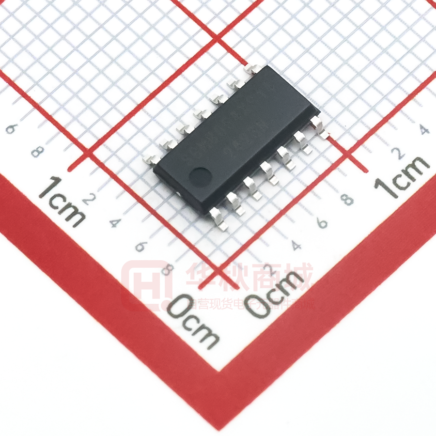

SGM8051/SGM8052/SGM8053 SGM8054/SGM8055 250MHz, Rail-to-Rail Output, CMOS Operational Amplifiers GENERAL DESCRIPTION FEATURES The SGM8051/3 (single), SGM8052/5 (dual) and ● Low Cost SGM8054 (quad) are low cost, high speed, rail-to-rail ● Rail-to-Rail Output output, voltage feedback amplifiers. They have a wide ● Input Offset Voltage: 8mV (MAX) input common mode voltage range and output voltage ● High Speed: swing, making them easy to be used on single supply -3dB Bandwidth (G = +1): 250MHz as low as 2.5V. Slew Rate: 130V/μs Despite being low cost, the SGM8051 series provide excellent overall performance. They offer wide bandwidth to 250MHz (G = +1) along with 0.1dB flatness out to 37MHz (G = +2) and offer a typical low current consumption of 2.3mA/amplifier. Low distortion and fast settling make the SGM8051 series ideal for buffering high speed A/D or D/A converters. The SGM8053/5 have a power-down disable feature that reduces the supply current to 75μA. This feature makes the SGM8053/5 ideal for portable and battery-powered applications where power dissipation is critical. All are specified over the extended -40℃ to Settling Time to 0.1% with 2V Step: 58ns ● Supply Voltage Range: 2.5V to 5.5V ● Input Voltage Range: -0.2V to 3.8V with VS = 5V ● Excellent Video Specs (RL = 150Ω, G = +2): 0.1dB Gain Flatness: 37MHz Diff Gain: 0.03%, Diff Phase: 0.08° ● Low Supply Current: 2.3mA/Amplifier (TYP) 75μA Shutdown Current for SGM8053/5 ● Small Packaging: SGM8051 Available in SOT-23-5 and SOIC-8 Packages SGM8052 Available in MSOP-8 and SOIC-8 +125℃ temperature range. Packages APPLICATIONS Packages Imaging Packages Photodiode Preamp Professional Video and Camera SGM8053 Available in SOT-23-6 and SOIC-8 SGM8054 Available in TSSOP-14 and SOIC-14 SGM8055 Available in a MSOP-10 Package Small-Signal Frequency Response Hand Set 3 DVD/CD 0 A-to-D Driver Normalized Gain (dB) Base Station Filter VOUT = 0.1VP-P G = +1 RL = 1kΩ RF = 24Ω -3 -6 G = +2 RL = 150Ω RF = 887Ω -9 -12 -15 1 10 100 1000 Frequency (MHz) SG Micro Corp www.sg-micro.com JUNE 2017 – REV. E. 1 SGM8051/SGM8052/SGM8053/4/5 SGM8054/SGM8055 250MHz, Rail-to-Rail Output, CMOS Operational Amplifiers PACKAGE/ORDERING INFORMATION MODEL SGM8051 SGM8052 CHANNEL PACKAGE DESCRIPTION SPECIFIED TEMPERATURE RANGE ORDERING NUMBER PACKAGE MARKING PACKING OPTION SOT-23-5 -40℃ to +125℃ SGM8051XN5/TR 8051 Tape and Reel, 3000 SOIC-8 -40℃ to +125℃ SGM8051XS/TR SGM8051XS XXXXX Tape and Reel, 2500 MSOP-8 -40℃ to +125℃ SGM8052XMS/TR SGM8052 XMS XXXXX Tape and Reel, 3000 SOIC-8 -40℃ to +125℃ SGM8052XS/TR SGM8052XS XXXXX Tape and Reel, 2500 SOT-23-6 -40℃ to +125℃ SGM8053XN6/TR SOFXX Tape and Reel, 3000 SOIC-8 -40℃ to +125℃ SGM8053XS/TR SGM8053XS XXXXX Tape and Reel, 2500 SOIC-14 -40℃ to +125℃ SGM8054XS14/TR Single Dual Single SGM8053 with Shutdown SGM8054 SGM8055 Quad Dual with Shutdown TSSOP-14 -40℃ to +125℃ SGM8054XTS14/TR MSOP-10 -40℃ to +125℃ SGM8055XMS/TR SGM8054XS14 Tape and Reel, 2500 XXXXX SGM8054 XTS14 XXXXX SGM8055 XMS XXXXX Tape and Reel, 3000 Tape and Reel, 3000 MARKING INFORMATION NOTE: XX = Date Code. XXXXX = Date Code and Vendor Code. SOT-23-6 SOIC-8/MSOP-8/SOIC-14/TSSOP-14/MSOP-10 XXXXX YYY X X Date Code - Month Date Code - Year Serial Number Vendor Code Date Code - Week Date Code - Year Green (RoHS & HSF): SG Micro Corp defines "Green" to mean Pb-Free (RoHS compatible) and free of halogen substances. If you have additional comments or questions, please contact your SGMICRO representative directly. SG Micro Corp www.sg-micro.com JUNE 2017 2 SGM8051/SGM8052/SGM8053/4/5 SGM8054/SGM8055 ABSOLUTE MAXIMUM RATINGS 250MHz, Rail-to-Rail Output, CMOS Operational Amplifiers OVERSTRESS CAUTION Supply Voltage, +VS to -VS ................................................ 6V Input Common Mode Voltage Range .................................................... (-VS) - 0.1V to (+VS) + 0.1V Signal Input Terminals Voltage Range .................................................... (-VS) - 0.3V to (+VS) + 0.3V Package Thermal Resistance @ TA = +25℃ SOT-23-5, θJA .......................................................... 190℃/W SOT-23-6, θJA .......................................................... 190℃/W SOIC-8, θJA... ........................................................... 125℃/W MSOP-8, θJA ............................................................ 216℃/W MSOP-10, θJA .......................................................... 216℃/W Junction Temperature .................................................+150℃ Storage Temperature Range ....................... -65℃ to +150℃ Lead Temperature (Soldering, 10s) ............................+260℃ ESD Susceptibility HBM ............................................................................. 1000V MM ................................................................................. 400V This integrated circuit can be damaged by ESD if you don’t pay attention to ESD protection. SGMICRO recommends that all integrated circuits be handled with appropriate precautions. Failure to observe proper handling and installation procedures can cause damage. ESD damage can range from subtle performance degradation to complete device failure. Precision integrated circuits may be more susceptible to damage because very small parametric changes could cause the device not to meet its published specifications. RECOMMENDED OPERATING CONDITIONS DISCLAIMER Operating Temperature Range ..................... -40℃ to +125℃ SG Micro Corp www.sg-micro.com Stresses beyond those listed in Absolute Maximum Ratings may cause permanent damage to the device. Exposure to absolute maximum rating conditions for extended periods may affect reliability. Functional operation of the device at any conditions beyond those indicated in the Recommended Operating Conditions section is not implied. ESD SENSITIVITY CAUTION SG Micro Corp reserves the right to make any change in circuit design, or specifications without prior notice. JUNE 2017 3 SGM8051/SGM8052/SGM8053/4/5 SGM8054/SGM8055 250MHz, Rail-to-Rail Output, CMOS Operational Amplifiers PIN CONFIGURATIONS SGM8051 (TOP VIEW) OUT 1 -VS 2 +IN 3 5 + SGM8053 (TOP VIEW) +VS OUT 1 -VS 2 +IN 3 _ 4 -IN + _ 6 +VS 5 DISABLE 4 -IN SOT-23-5 SOT-23-6 SGM8052 (TOP VIEW) SGM8051/8053 (TOP VIEW) OUTA 1 -INA 2 _ +INA 3 + -VS 4 8 +VS NC 1 7 OUTB -IN 2 _ 6 -INB +IN 3 + 5 +INB -VS 4 8 DISABLE (SGM8053 ONLY) _ 7 +VS + 6 OUT 5 NC NC = NO CONNECT SOIC-8/MSOP-8 SOIC-8 SGM8054 (TOP VIEW) OUTA 1 -INA 2 _ +INA 3 + +VS 4 +INB 5 + -INB 6 _ OUTB 7 14 OUTD _ 13 -IND + 12 +IND 11 -VS + 10 +INC _ 9 -INC 8 OUTC SGM8055 (TOP VIEW) OUTA 1 -INA 2 _ +INA 3 + -VS 4 DISABLE 5 10 +VS 9 OUTB _ 8 -INB + 7 +INB 6 DISABLE MSOP-10 TSSOP-14/SOIC-14 SG Micro Corp www.sg-micro.com JUNE 2017 4 SGM8051/SGM8052/SGM8053/4/5 SGM8054/SGM8055 250MHz, Rail-to-Rail Output, CMOS Operational Amplifiers ELECTRICAL CHARACTERISTICS (VS = 5V, G = +2, RF = 887Ω, RL = 150Ω, unless otherwise noted.) SGM8051/2/3/4/5 PARAMETER CONDITIONS TYP +25℃ Dynamic Performance -3dB Small-Signal Bandwidth MIN/MAX OVER TEMPERATURE +25℃ 0℃ -40℃ -40℃ UNITS to +70℃ to +85℃ to +125℃ MIN/ MAX Settling Time to 0.1% Overload Recovery Time 180 G = +1, VOUT = 0.1VP-P, RF = 24Ω, RL = 150Ω 250 G = +1, VOUT = 0.1VP-P, RF = 24Ω, RL = 1kΩ 40 G = +2, VOUT = 0.1VP-P, RL = 50Ω 80 G = +2, VOUT = 0.1VP-P, RL = 150Ω 130 G = +2, VOUT = 0.1VP-P, RL = 1kΩ 160 G = +2, VOUT = 0.1VP-P, RL = 10kΩ 90 G = +10, RL = 150Ω 120 G = +10, RL = 1kΩ 37 G = +2, VOUT = 0.1VP-P, RL = 150Ω, RF = 887Ω 93/-118 G = +1, 2V output step 116/-103 G = +2, 2V output step 130/-130 G = +2, 4V output step 4 G = +2, VOUT = 0.2VP-P, 10% to 90% 14 G = +2, VOUT = 2VP-P, 10% to 90% 58 G = +2, 2V output step VIN · G = +VS 18 Noise/Distortion Performance Input Voltage Noise Density Differential Gain Error (NTSC) Differential Phase Error (NTSC) f = 1MHz G = +2, RL = 150Ω G = +2, RL = 150Ω 8.1 0.03 0.08 ±8 ±8.9 ±9.5 ±9.8 VOUT = 0.3V to 4.7V, RL = 150Ω VOUT = 0.2V to 4.8V, RL = 1kΩ ±2 4.4 6 2 80 104 75 92 74 91 74 91 73 80 mV μV/℃ pA pA dB dB -0.2 to 3.8 80 66 65 65 62 V dB TYP MIN V V mA Ω TYP TYP MIN TYP ns ns V V pA TYP TYP MAX MIN TYP Gain-Bandwidth Product Bandwidth for 0.1dB Flatness Slew Rate Rise-and-Fall Time DC Performance Input Offset Voltage (VOS) Input Offset Voltage Drift Input Bias Current (IB) Input Offset Current (IOS) Open-Loop Gain (AOL) Input Characteristics Input Common Mode Voltage Range (VCM) Common Mode Rejection Ratio (CMRR) Output Characteristics Output Voltage Swing from Rail Output Current Closed-Loop Output Impedance VCM = -0.1V to 3.5V RL = 150Ω RL = 1kΩ f < 100kHz Power-Down (SGM8053/5 Only) Turn-On Time Turn-Off Time DISABLE Voltage-Off DISABLE Voltage-On Output Leakage Current (IOFF) (SGM8055 Only) DISABLE = 0V, VS = 5V, VOUT = 5V 0.12 0.03 130 0.08 236 52 50 Power Supply Operating Voltage Range Quiescent Current (per Amplifier) Supply Current when Disabled per Amplifier (SGM8053/5 only) Power Supply Rejection Ratio (PSRR) SG Micro Corp www.sg-micro.com VS = 2.7V to 5.5V, VCM = (-VS) + 0.5V 100 95 90 84 0.8 2 MHz MHz MHz MHz MHz MHz MHz MHz MHz V/μs V/μs V/μs ns ns ns ns TYP TYP TYP TYP TYP TYP TYP TYP TYP TYP TYP TYP TYP TYP TYP TYP nV/ Hz % degree TYP TYP TYP MAX TYP TYP TYP MIN MIN 2.3 75 2.5 5.5 3.2 120 2.7 5.5 3.4 127 2.7 5.5 3.8 130 2.7 5.5 4 137 V V mA μA MIN MAX MAX MAX 80 67 67 65 62 dB MIN JUNE 2017 5 SGM8051/SGM8052/SGM8053/4/5 SGM8054/SGM8055 250MHz, Rail-to-Rail Output, CMOS Operational Amplifiers TYPICAL PERFORMANCE CHARACTERISTICS At TA = +25℃, VS = 5V, G = +2, RF = 887Ω, RG = 887Ω and RL = 150Ω connected to VS/2, unless otherwise noted. Non-Inverting Small-Signal Frequency Response 3 VOUT = 0.1VP-P G = +1 RF = 24Ω G = +2 -6 G = +5 -9 G = +10 -12 -15 1 10 100 VOUT = 0.1VP-P 0 Normalized Gain (dB) Normalized Gain (dB) 0 -3 Inverting Small-Signal Frequency Response 3 -3 G = -2 -6 G = -5 -9 G = -10 -12 -15 1000 G = -1 0.1 1 10 Frequency (MHz) Frequency Response for Various RL 0.1dB Gain Flatness for Various RF 0.5 RL = 10kΩ RL = 1kΩ -6 RL = 150Ω -9 RL = 50Ω -12 0.3 Normalized Gain (dB) Normalized Gain (dB) -3 -15 VOUT = 0.1VP-P CL = 0pF 0.4 CL = 0pF VOUT = 0.1VP-P 0.2 RF = 1kΩ 0.1 0 -0.1 RF = 900Ω -0.2 RF = 887Ω -0.3 -0.4 1 10 100 -0.5 1000 1 10 Frequency (MHz) RS = 0Ω VOUT = 0.1VP-P Frequency Response vs. Capacitive Load 3 CL = 100pF CL = 47pF 3 0 -3 CL = 6pF -6 -9 -12 1 10 100 Frequency (MHz) SG Micro Corp www.sg-micro.com VOUT = 0.1VP-P CL = 6pF RS = 100Ω 0 Normalized Gain (dB) Normalized Gain (dB) 6 100 Frequency (MHz) Frequency Response for Various CL 9 -15 1000 Frequency (MHz) 3 0 100 1000 CL = 100pF RS = 37.4Ω -3 CL = 47pF RS = 66.5Ω -6 -9 -12 -15 1 10 100 1000 Frequency (MHz) JUNE 2017 6 SGM8051/SGM8052/SGM8053/4/5 SGM8054/SGM8055 250MHz, Rail-to-Rail Output, CMOS Operational Amplifiers TYPICAL PERFORMANCE CHARACTERISTICS (continued) At TA = +25℃, VS = 5V, G = +2, RF = 887Ω, RG = 887Ω and RL = 150Ω connected to VS/2, unless otherwise noted. Large-Signal Disable/Enable Response Output Voltage (1V/div) 6 5 5 Disable Voltage (V) 4 3 2 Disabled VOUT = 2V 1 Output Voltage (VP-P) VS = 5V G = +2 fIN = 2MHz Enabled Maximum Output Voltage vs. Frequency 6 Maximum Output Voltage Without Slew-Rate Induced Distortion VS = 5.5V 4 3 VS = 2.7V 2 0 1 -1 0 Time (500ns/div) 1 10 100 Frequency (MHz) Non-Inverting Large-Signal Step Response Output Voltage (50mV/div) Output Voltage (500mV/div) Non-Inverting Small-Signal Step Response Time (50ns/div) Time (50ns/div) Rail-to-Rail Disabled Output Isolation Frequency Response 0 G = +2, RF = 887Ω, RL = 1kΩ Disabled Isolation (dB) 4.88V 0V VOUT = 0.2VP-P VDISABLE = 0V RL = 1kΩ -10 -20 -30 -40 -50 -60 -70 -80 -90 Time (200ns/div) SG Micro Corp www.sg-micro.com 1 10 100 1000 Frequency (MHz) JUNE 2017 7 SGM8051/SGM8052/SGM8053/4/5 SGM8054/SGM8055 250MHz, Rail-to-Rail Output, CMOS Operational Amplifiers TYPICAL PERFORMANCE CHARACTERISTICS (continued) At TA = +25℃, VS = 5V, G = +2, RF = 887Ω, RG = 887Ω and RL = 150Ω connected to VS/2, unless otherwise noted. Closed-Loop Output Impedance vs. Frequency Power Supply Rejection Ratio vs. Frequency 100 -20 PSRR (dB) 0 Output Impedance (Ω) 1000 10 1 -PSRR -40 -60 +PSRR -80 0.1 0.01 0.01 0.1 1 10 100 -100 0.01 0.1 Output Settling Time to 0.1% 1000 Common Mode Rejection Ratio vs. Frequency -20 0.3 0.2 CMRR (dB) Output Error (%) 100 0 VOUT = 2VP-P 0.4 10 Frequency (MHz) Frequency (MHz) 0.5 1 0.1 0 -0.1 -40 -60 -0.2 -80 -0.3 -0.4 -0.5 0 20 40 60 80 100 120 -100 0.01 Time (ns) 1 10 100 1000 Frequency (MHz) Input Voltage Noise Density vs. Frequency Input Voltage Noise Density (nV/√Hz) 0.1 Overload Recovery Time 1000 VS = ±2.5V VIN = 1.18V G = +2 2.5V 100 1.18V 0V 10 1 0.01 0.1 1 10 100 1000 10000 Time (25ns/div) Frequency (kHz) SG Micro Corp www.sg-micro.com JUNE 2017 8 SGM8051/SGM8052/SGM8053/4/5 SGM8054/SGM8055 250MHz, Rail-to-Rail Output, CMOS Operational Amplifiers TYPICAL PERFORMANCE CHARACTERISTICS (continued) At TA = +25℃, VS = 5V, G = +2, RF = 887Ω, RG = 887Ω and RL = 150Ω connected to VS/2, unless otherwise noted. Open-Loop Gain vs. Temperature CMRR and PSRR vs. Temperature 120 110 100 RL = 150Ω 90 100 80 70 RL = 150Ω 110 RL = 1kΩ CMRR, PSRR (dB) Open-Loop Gain (dB) 120 PSRR 90 80 CMRR 70 -50 -25 0 25 50 75 100 125 60 150 -50 -25 0 Temperature (℃) 75 2.8 VS = 5V 65 VS = 3V 60 VS = 2.7V 55 50 45 40 50 75 100 125 150 Quiescent Current vs. Temperature 3 Quiescent Current (mA) Shutdown Current (μA) Shutdown Current vs. Temperature 80 70 25 Temperature (℃) 2.6 VS = 5V VS = 3V 2.4 2.2 2 VS = 2.7V 1.8 1.6 1.4 -50 -25 0 25 50 75 100 125 1.2 150 -50 -25 0 Temperature (℃) 25 50 75 100 125 150 Temperature (℃) Output Voltage Swing vs. Output Current Output Voltage Swing vs. Output Current 5 3 Sourcing Current +25℃ -50℃ Output Voltage (V) 4 Output Voltage (V) 2.5 +135℃ Sourcing Current 3 VS = 5V 2 +25℃ 1 0 -50℃ Sinking Current 25 50 75 100 Output Current (mA) SG Micro Corp www.sg-micro.com 125 150 +25℃ -50℃ 1.5 VS = 3V 1 0 +25℃ +135℃ 0.5 +135℃ 0 +135℃ 2 -50℃ Sinking Current 0 20 40 60 80 100 120 Output Current (mA) JUNE 2017 9 SGM8051/SGM8052/SGM8053/4/5 SGM8054/SGM8055 250MHz, Rail-to-Rail Output, CMOS Operational Amplifiers TYPICAL PERFORMANCE CHARACTERISTICS (continued) At TA = +25℃, VS = 5V, G = +2, RF = 887Ω, RG = 887Ω and RL = 150Ω connected to VS/2, unless otherwise noted. Offset Voltage Production Distribution 24 -30 21 Percentage of Amplifiers (%) Channel Separation (dB) Channel Separation vs. Frequency -20 -40 -50 -60 -70 -80 -90 -100 -110 -120 0.1 1 10 Frequency (MHz) SG Micro Corp www.sg-micro.com 100 1000 18 Typical Production Distribution of Packaged Units. 15 12 9 6 3 0 -8 -7 -6 -5 -4 -3 -2 -1 0 1 2 3 4 5 6 7 8 Offset Voltage (mV) JUNE 2017 10 SGM8051/SGM8052/SGM8053/4/5 SGM8054/SGM8055 250MHz, Rail-to-Rail Output, CMOS Operational Amplifiers APPLICATION NOTES Driving Capacitive Loads The SGM8051 series are optimized for bandwidth and speed, not for driving capacitive loads. Output capacitance will create a pole in the amplifier’s feedback path, leading to excessive peaking and potential oscillation. If dealing with load capacitance is a requirement of the application, the two strategies to consider are (1) using a small resistor in series with the amplifier’s output and the load capacitance and (2) reducing the bandwidth of the amplifier’s feedback loop by increasing the overall noise gain. Figure 1 shows a unity gain follower using the series resistor strategy. The resistor isolates the output from the capacitance and, more importantly, creates a zero in the feedback path that compensates for the pole created by the output capacitance. For the high speed operational amplifier, soldering the part to the board directly is strongly recommended. Try to keep the high frequency current loop area small to minimize the EMI (electromagnetic interference). +VS +VS 10μF 10μF 0.1μF 0.1μF VN VN SGM8051 VOUT VOUT SGM8051 VP 10μF VP 0.1μF -VS (GND) -VS SGM8051 VIN Figure 2. Amplifier with Bypass Capacitors RISO VOUT CLOAD Figure 1. Series Resistor Isolating Capacitive Load Power-Supply Bypassing and Layout The SGM8051 series operate from either a single 2.7V to 5.5V supply or dual ±1.35V to ±2.75V supplies. For single-supply operation, bypass the power supply +VS with a 0.1µF ceramic capacitor which should be placed close to the +VS pin. For dual-supply operation, both the +VS and the -VS supplies should be bypassed to ground with separate 0.1µF ceramic capacitors. 2.2µF tantalum capacitor can be added for better performance. Grounding A ground plane layer is important for high speed circuit design. The length of the current path in an inductive ground return will create an unwanted voltage noise. Broad ground plane areas will reduce the parasitic inductance. Input-to-Output Coupling To minimize capacitive coupling, the input and output signal traces should not be in parallel. This helps reduce unwanted positive feedback. Good PC board layout techniques optimize performance by decreasing the amount of stray capacitance at the operational amplifier’s inputs and output. To decrease stray capacitance, minimize trace lengths and widths by placing external components as close to the device as possible. Use surface-mount components whenever possible. SG Micro Corp www.sg-micro.com JUNE 2017 11 SGM8051/SGM8052/SGM8053/4/5 SGM8054/SGM8055 250MHz, Rail-to-Rail Output, CMOS Operational Amplifiers TYPICAL APPLICATION CIRCUITS Differential Amplifier The circuit shown in Figure 3 performs the difference function. If the resistor ratios are equal (R4/R3 = R2/R1), then VOUT = (VP - VN) × R2/R1 + VREF. The SGM8051 series can be used in video applications as shown in Figure 5. VIN R2 VN Driving Video SGM8051 75Ω R1 SGM8051 75Ω CABLE VOUT VP RF VOUT RG R3 75Ω R4 G = 1 + RF/RG VREF Figure 3. Differential Amplifier Figure 5. Typical Video Driving Active Low-Pass Filter The low-pass filter shown in Figure 4 has a DC gain of (-R2/R1) and the -3dB corner frequency is 1/2πR2C. Make sure the filter bandwidth is within the bandwidth of the amplifier. Feedback resistors with large values can couple with parasitic capacitance and cause undesired effects such as ringing or oscillation in high-speed amplifiers. Keep resistor values as low as possible and consistent with output loading consideration. C R2 R1 VIN SGM8051 VOUT R3 = R1 // R2 Figure 4. Active Low-Pass Filter SG Micro Corp www.sg-micro.com JUNE 2017 12 SGM8051/SGM8052/SGM8053/4/5 SGM8054/SGM8055 250MHz, Rail-to-Rail Output, CMOS Operational Amplifiers REVISION HISTORY NOTE: Page numbers for previous revisions may differ from page numbers in the current version. JUNE 2017 ‒ REV.E to REV.E.1 Page Changed Package/Ordering Information section .................................................................................................................................................. 2 Updated Electrical Characteristics section ........................................................................................................................................................... 2 Changed Absolute Maximum Ratings section ...................................................................................................................................................... 3 MAY 2014 ‒ REV.D.4 to REV.E Page Changed Package/Ordering Information section .................................................................................................................................................. 2 JANUARY 2013 ‒ REV.D.3 to REV.D.4 Page Updated Package Outline Dimensions section .......................................................................................................................................... 12 ~ 18 Added Tape and Reel Information section ................................................................................................................................................... 19, 20 SG Micro Corp www.sg-micro.com JUNE 2017 13 PACKAGE INFORMATION PACKAGE OUTLINE DIMENSIONS SOT-23-5 1.90 D e1 E1 2.59 E 0.99 b e 0.69 0.95 RECOMMENDED LAND PATTERN (Unit: mm) L A A1 θ A2 Symbol Dimensions In Millimeters MIN MAX c 0.2 Dimensions In Inches MIN MAX A 1.050 1.250 0.041 0.049 A1 0.000 0.100 0.000 0.004 A2 1.050 1.150 0.041 0.045 b 0.300 0.500 0.012 0.020 c 0.100 0.200 0.004 0.008 D 2.820 3.020 0.111 0.119 E 1.500 1.700 0.059 0.067 E1 2.650 2.950 0.104 0.116 e 0.950 BSC 0.037 BSC e1 1.900 BSC 0.075 BSC SG Micro Corp www.sg-micro.com L 0.300 0.600 0.012 0.024 θ 0° 8° 0° 8° TX00033.000 PACKAGE INFORMATION PACKAGE OUTLINE DIMENSIONS SOT-23-6 D e1 e 2.59 E E1 0.99 b 0.95 0.69 RECOMMENDED LAND PATTERN (Unit: mm) L A A1 θ A2 Symbol Dimensions In Millimeters MIN MAX c 0.2 Dimensions In Inches MIN MAX A 1.050 1.250 0.041 0.049 A1 0.000 0.100 0.000 0.004 A2 1.050 1.150 0.041 0.045 b 0.300 0.500 0.012 0.020 c 0.100 0.200 0.004 0.008 D 2.820 3.020 0.111 0.119 E 1.500 1.700 0.059 0.067 E1 2.650 2.950 0.104 0.116 e 0.950 BSC 0.037 BSC e1 1.900 BSC 0.075 BSC SG Micro Corp www.sg-micro.com L 0.300 0.600 0.012 0.024 θ 0° 8° 0° 8° TX00034.000 PACKAGE INFORMATION PACKAGE OUTLINE DIMENSIONS SOIC-8 0.6 D e 2.2 E1 E 5.2 b 1.27 RECOMMENDED LAND PATTERN (Unit: mm) L A A1 c θ A2 Symbol Dimensions In Millimeters MIN MAX Dimensions In Inches MIN MAX A 1.350 1.750 0.053 0.069 A1 0.100 0.250 0.004 0.010 A2 1.350 1.550 0.053 0.061 b 0.330 0.510 0.013 0.020 c 0.170 0.250 0.006 0.010 D 4.700 5.100 0.185 0.200 E 3.800 4.000 0.150 0.157 E1 5.800 6.200 0.228 0.244 e SG Micro Corp www.sg-micro.com 1.27 BSC 0.050 BSC L 0.400 1.270 0.016 0.050 θ 0° 8° 0° 8° TX00010.000 PACKAGE INFORMATION PACKAGE OUTLINE DIMENSIONS MSOP-8 b E1 E 4.8 1.02 e 0.41 0.65 RECOMMENDED LAND PATTERN (Unit: mm) D L A A1 c θ A2 Symbol Dimensions In Millimeters MIN MAX Dimensions In Inches MIN MAX A 0.820 1.100 0.032 0.043 A1 0.020 0.150 0.001 0.006 A2 0.750 0.950 0.030 0.037 b 0.250 0.380 0.010 0.015 c 0.090 0.230 0.004 0.009 D 2.900 3.100 0.114 0.122 E 2.900 3.100 0.114 0.122 E1 4.750 5.050 0.187 0.199 e SG Micro Corp www.sg-micro.com 0.650 BSC 0.026 BSC L 0.400 0.800 0.016 0.031 θ 0° 6° 0° 6° TX00014.000 PACKAGE INFORMATION PACKAGE OUTLINE DIMENSIONS MSOP-10 b E1 4.8 E 1.02 e 0.5 0.3 RECOMMENDED LAND PATTERN (Unit: mm) D L A θ c A1 A2 Symbol Dimensions In Millimeters MIN MAX A 0.820 1.100 A1 0.020 A2 0.750 b 0.180 Dimensions In Inches MIN MAX 0.032 0.043 0.150 0.001 0.006 0.950 0.030 0.037 0.280 0.007 0.011 c 0.090 0.230 0.004 0.009 D 2.900 3.100 0.114 0.122 E 2.900 3.100 0.114 0.122 E1 4.750 5.050 0.187 e SG Micro Corp www.sg-micro.com 0.500 BSC 0.199 0.020 BSC L 0.400 0.800 0.016 0.031 θ 0° 6° 0° 6° TX00015.000 PACKAGE INFORMATION PACKAGE OUTLINE DIMENSIONS SOIC-14 D E 5.2 E1 2.2 e b 0.6 1.27 RECOMMENDED LAND PATTERN (Unit: mm) L1 R1 R A3 A A2 h L2 θ A1 Symbol h L Dimensions In Millimeters MIN MAX Dimensions In Inches MIN MAX A 1.35 1.75 0.053 0.069 A1 0.10 0.25 0.004 0.010 A2 1.25 1.65 0.049 0.065 A3 0.55 0.75 0.022 0.030 b 0.36 0.49 0.014 0.019 D 8.53 8.73 0.336 0.344 E 5.80 6.20 0.228 0.244 E1 3.80 4.00 0.150 e L 1.27 BSC 0.45 L1 0.80 0.018 1.04 REF L2 0.157 0.050 BSC 0.032 0.040 REF 0.25 BSC 0.01 BSC R 0.07 0.003 R1 0.07 0.003 h 0.30 0.50 0.012 0.020 θ 0° 8° 0° 8° SG Micro Corp www.sg-micro.com TX00011.001 PACKAGE INFORMATION PACKAGE OUTLINE DIMENSIONS TSSOP-14 D E E1 5.94 1.78 e b 0.42 0.65 RECOMMENDED LAND PATTERN (Unit: mm) L A A1 θ A2 Symbol Dimensions In Millimeters MIN MAX Dimensions In Inches MIN MAX 1.200 0.047 A A1 c H 0.050 0.150 0.002 0.006 A2 0.800 1.050 0.031 0.041 b 0.190 0.300 0.007 0.012 c 0.090 0.200 0.004 0.008 D 4.860 5.100 0.191 0.201 E 4.300 4.500 0.169 0.177 E1 6.250 6.550 0.246 0.258 0.700 0.02 e L 0.650 BSC 0.500 H θ SG Micro Corp www.sg-micro.com 0.026 BSC 0.25 TYP 1° 0.028 0.01 TYP 7° 1° 7° TX00019.001 PACKAGE INFORMATION TAPE AND REEL INFORMATION REEL DIMENSIONS TAPE DIMENSIONS P2 W P0 Q1 Q2 Q1 Q2 Q1 Q2 Q3 Q4 Q3 Q4 Q3 Q4 B0 Reel Diameter K0 A0 P1 Reel Width (W1) DIRECTION OF FEED NOTE: The picture is only for reference. Please make the object as the standard. KEY PARAMETER LIST OF TAPE AND REEL Reel Diameter Reel Width W1 (mm) A0 (mm) B0 (mm) K0 (mm) P0 (mm) P1 (mm) P2 (mm) W (mm) Pin1 Quadrant SOT-23-5 7″ 9.5 3.20 3.20 1.40 4.0 4.0 2.0 8.0 Q3 SOT-23-6 7″ 9.5 3.17 3.23 1.37 4.0 4.0 2.0 8.0 Q3 SOIC-8 13″ 12.4 6.40 5.40 2.10 4.0 8.0 2.0 12.0 Q1 MSOP-8 13″ 12.4 5.20 3.30 1.50 4.0 8.0 2.0 12.0 Q1 MSOP-10 13″ 12.4 5.20 3.30 1.20 4.0 8.0 2.0 12.0 Q1 SOIC-14 13″ 16.4 6.60 9.30 2.10 4.0 8.0 2.0 16.0 Q1 TSSOP-14 13″ 12.4 6.95 5.60 1.20 4.0 8.0 2.0 12.0 Q1 SG Micro Corp www.sg-micro.com TX10000.000 DD0001 Package Type PACKAGE INFORMATION CARTON BOX DIMENSIONS NOTE: The picture is only for reference. Please make the object as the standard. KEY PARAMETER LIST OF CARTON BOX Length (mm) Width (mm) Height (mm) Pizza/Carton 7″ (Option) 368 227 224 8 7″ 442 410 224 18 13″ 386 280 370 5 SG Micro Corp www.sg-micro.com DD0002 Reel Type TX20000.000
