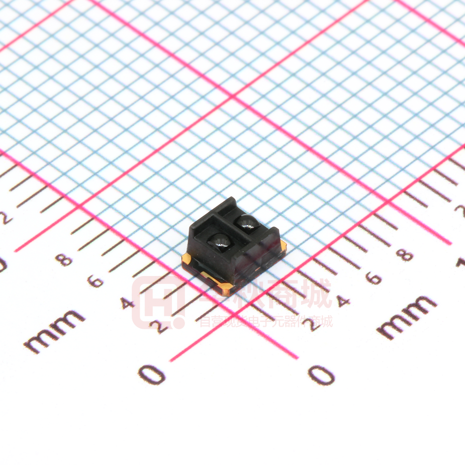

GP2S700HCP GP2S700HCP SMT, Detecting Distance : 3mm Phototransistor Output, Compact Reflective Photointerrupter ■ Description ■Agency approvals/Compliance 1. Compliant with RoHS directive GP2S700HCP is a compact-package, phototransistor output, reflective photointerrupter, with emitter and detector facing the same direction in a molding that provides ■Applications non-contact sensing. The compact package series is formed 1. Detection of object presence or motion. Example : printer, optical storage by epoxy resin, that also blocks visible light to minimize false detection. This device has a long focal distance for this family of devices and has a leadless (T&R) package, suitable for reflow soldering. ■Features 1. Reflective with Phototransistor Output 2. Highlights : • Compact Size • Surface Mount Type (SMT), reflow soldering • Tape and Reel (T&R) 1 000 pcs per reel 3. Key Parameters : • Optimal Sensing Distance : 3mm • Package : 4×3×2mm • Visible light cut resin to prevent 4. RoHS directive compliant Notice The content of data sheet is subject to change without prior notice. In the absence of confirmation by device specification sheets, SHARP takes no responsibility for any defects that may occur in equipment using any SHARP devices shown in catalogs, data books, etc. Contact SHARP in order to obtain the latest device specification sheets before using any SHARP device. 1 Sheet No.:D3-A02201EN-A GP2S700HCP ■ Internal Connection Diagram Top view ① ④ ② ③ ① Emitter ② Collector ③ Cathode ④ Anode ■ Outline Dimensions (Unit : mm) Top view Detector center 4 (0.8) ④ 3 (2.3) (1.5) ① Optical center ② ③ (0.8) Emitter center 2 (2.7) (1) (0.93) (1) 0.4 (0.25) (0.93) (0.25) • Unspecified tolerance : ±0.3mm. • Dimensions in parenthesis are shown for reference. • Dimensions on the outline drawing is the maximum value excluding burr. • The dimensions shown do not include burr. • Burr's dimension : 0.15mm MAX. Product mass : approx. 0.01g Plating material : Au 2 Sheet No.: D3-A02201EN-A GP2S700HCP ■ Absolute Maximum Ratings Parameter Forward current Input Reverse voltage Power dissipation Collector-emitter voltage Emitter-collector voltage Output Collector current Collector power dissipation Total power dissipation Operating temperature Storage temperature ∗1 Soldering temperature Symbol Rating IF 50 VR 6 PD 75 VCEO 35 VECO 6 IC 20 PC 75 Ptot 100 Topr −25 to +85 Tstg −40 to +100 Tsol 260 (Ta=25˚C) Unit mA V mW V V mA mW mW ˚C ˚C ˚C ∗ 1 For 5s or less ■ Electro-optical Characteristics Parameter Forward voltage Input Reverse current Output Collector dark current ∗2 Collector current Transfer ∗3 Leak current characRise time teristics Response time Fall time ∗ ∗ Symbol VF IR ICEO IC ILEAK tr tf Condition IF=20mA VR=6V VCE=20V IF=4mA, VCE=2V IF=4mA, VCE=2V VCE=2V, IC=100μA, RL=1kΩ, d=4mm MIN. − − − 60 − − − TYP. 1.2 − 1 − − 20 20 (Ta=25˚C) MAX. Unit 1.4 V 10 μA 100 nA 410 μA 700 nA 100 μs 100 2 The condition and arrangement of the reflective object are shown below. 3 Without reflective object. ● Test Condition and Arrangement for Collector Current Aluminum evaporation Glass plate d=4mm Sheet No.:D3-A02201EN-A 3 GP2S700HCP Fig.2 Collector Power Dissipation vs. Ambient Temperature 60 120 50 100 Power dissipation P (mW) Forward current IF (mA) Fig.1 Forward Current vs. Ambient Temperature 40 30 20 60 40 20 15 0 0 -25 0 25 50 75 85 100 Ambient temperature Ta (˚C) Fig.3 Forward Current vs. Forward Voltage 0 25 50 75 85 100 Ambient temperature Ta (˚C) Fig.4 Collector Current vs. Forward Current 100 3 000 75˚C 10 Collector current IC (mA) 50˚C Ta=25˚C d=4mm 2 500 25˚C Forward current IF (mA) PD, PC 80 10 -25 Ptot -25˚C 0˚C 2 000 1 500 1 000 500 1 0 0 0.3 0.6 0.9 1.2 1.5 1.8 2.1 2.4 2.7 0 3 Fig.5 Collector Dark Current vs. Ambient Temperature 20 30 40 50 Fig.6 Response Time vs. Load Resistance 10-6 1000 10-7 Response time (μs) Collector dark current ICEO (A) 10 Forward current IF (mA) Ambient temperature Ta (˚C) 10-8 10-9 10-10 100 10 1 0 25 50 75 Ambient temperature Ta (˚C) 100 0.1 4 1 10 Load resistance RL (kΩ) 100 Sheet No.: D3-A02201EN-A GP2S700HCP Fig.7 Test Circuit for Response Time Fig.8 Relative Collector Current vs. Distance 100 Relative collector current (%) Reflector plate VCC RL Input Test terminal Output 10% 90% td ts tr tf IF=4mA VCE=2V 80 Ta=25˚C 60 40 Aluminum evaporation glass 20 d 0 0 2 4 6 8 10 Distance d (mm) Fig.9 Relative Collector Current vs. Ambient Temperature Relative collector current (%) 120 100 80 60 40 20 0 -25 0 25 50 75 85 100 Ambient temperature Ta (˚C) Remarks : Please be aware that all data in the graph are just for reference and not for guarantee. 5 Sheet No.: D3-A02201EN-A GP2S700HCP ■ Design Considerations ● Design guide 1) Regarding to prevation of malfunction To prevent photointerrupter from faulty operation caused by external light, do not set the detecting face to the external light. Also, if some other electronic components are located close to this device, false operation may occur. (The light reflection caused by the other components may slip into the photodetecting portion of the device and if may cause false operation.) 2) Distance characteristic The distance between the photointerrupter and the object to be detected shall be determined the distance by referencing Fig.8 "Relative collector current vs. distance". 3) For wiring on a mounting PCB To avoid possibility for short, please do not apply pattern wiring on the back side of the device. 4) Regarding to mounting this product There is a possibility that the opaque molded resin portion may have a crack by force at mounting etc. Please use this product after well confirmation of conditions in your production line. And please confirm the mounting workability beforehand when using the automatic mounting machine. This product is not designed against irradiation and incorporates non-coherent IRED. ● Degradation In the case of long term operation, please take the general IRED degradation (50% degradation over 5 years) into the design consideration. ● Parts This product is assembled using the below parts. • Light detector (qty. : 1) Category Material Maximum Sensitivity wavelength (nm) Sensitivity wavelength (nm) Response time (μs) Phototransister Silicon (Si) 930 700 to 1 200 20 • Light emitter (qty. : 1) Category Material Maximum light emitting wavelength (nm) I/O Frequency (MHz) Infrared light emitting diode (non-coherent) Gallium arsenide (GaAs) 950 0.3 • Material Case PCB Lead frame plating Black epoxy resin Glass epoxy resin Au plating Sheet No.:D3-A02201EN-A 6 GP2S700HCP ● Recommended pattern (Unit : mm) measure tolerance : ±0.1 area : Please do not apply the pattern wiring to avoid the possibility of short circuit. Regarding amount of solder, if there is solder leakage in terminal wiring pattern between PCB and housing main body, the reliability will be deteriorated. Please check the proper amount of solder in advance not to have solder leakage into terminal wiring pattern between PCB and housing main body. 7 Sheet No.: D3-A02201EN-A GP2S700HCP ■ Manufacturing Guidelines ● Storage and management after open Storage condition Storage temp.: 5 to 30˚C, Storage humidity : 70%RH or less at regular packaging. Treatment after opening the moisture-proof package After opening, you should mount the products while keeping them on the condition of 5 to 25˚C and 60%RH or less in humidity within 2 days. After opening the bag once even if the prolonged storage is necessary, you should mount the products within two weeks. And when you store the rest of products you should put into a DRY BOX. Otherwise after the rest of products and silicagel are sealed up again, you should keep them under the condition of 5 to 30˚C and 70%RH or less in humidity. Baking before mounting When the above-mentioned storage method could not be executed, please process the baking treatment before mounting the products. However the baking treatment is permitted within one time. Recommended condition : 125˚C, 16 to 24 hours ∗Do not process the baking treatment with the product wrapped. When the baking treatment processing, you should move the products to a metallic tray or fix temporarily the products to substrate. Sheet No.:D3-A02201EN-A 8 GP2S700HCP ● Soldering Method Reflow Soldering: Reflow soldering should follow the temperature profile shown below. Soldering should not exceed the curve of temperature profile and time. Please solder within one time. MAX 240˚C 1 to 4˚C/s 200˚C MAX 165°C 1 to 4˚C/s 1 to 4˚C/s 25˚C MAX10s MAX120s MAX60s MAX90s Other notice Please take care not to let any external force exert on lead pins. Please test the soldering method in actual condition and make sure the soldering works fine, since the impact on the junction between the device and PCB varies depending on the cooling and soldering conditions. ● Cleaning instructions Solvent cleaning : Solvent temperature should be 45˚C or below. Immersion time should be 3 minutes or less. Ultrasonic cleaning : Do not execute ultrasonic cleaning. Recommended solvent materials : Ethyl alcohol, Methyl alcohol and Isopropyl alcohol. Sheet No.:D3-A02201EN-A 9 GP2S700HCP ● Presence of ODC This product shall not contain the following materials. And they are not used in the production process for this product. Regulation substances : CFCs, Halon, Carbon tetrachloride, 1.1.1-Trichloroethane (Methylchloroform) Specific brominated flame retardants such as the PBBOs and PBBs are not used in this product at all. This product shall not contain the following materials banned in the RoHS Directive (2002/95/EC). •Lead, Mercury, Cadmium, Hexavalent chromium, Polybrominated biphenyls (PBB), Polybrominated diphenyl ethers (PBDE). Content of six substances specified in Management Methods for Control of Pollution Caused by Electronic Information Products Regulation (Chinese : 电子信息产品污染控制管理办法). Toxic and hazardous substances Category Photointerrupter Lead Mercury Cadmium (Pb) (Hg) (Cd) ✔ ✔ ✔ Hexavalent Polybrominated Polybrominated chromium biphenyls diphenyl ethers (Cr ) (PBB) (PBDE) ✔ ✔ ✔ 6+ ✔ : indicates that the content of the toxic and hazardous substance in all the homogeneous materials of the part is below the concentration limit requirement as described in SJ/T 11363-2006 standard. 10 Sheet No.: D3-A02201EN-A GP2S700HCP ■ Package specification ● Tape and Reel package Package materials Reel : PS Package method 1 000 pcs of products shall be packaged in a reel. One reed is endased in aluminum laminated bag. After sealing up the bag, it encased in one case (5 bags/case). Carrier tape structure and Dimensions b-b’ b b’ Dimension List A 12 ±0.3 I +0.2 -0 3.2 B 5.5 ±0.05 J 2.2 ±0.1 (Unit : mm) C 1.75 ±0.1 K 1.2 ±0.1 D E F ±0.1 ±0.1 ±0.1 8 4 L 0.3 ±0.05 M 6.3 11 ±0.1 2 N +0.2 -0 4.2 G Φ1.55 H ±0.05 5.2±0.1 O Φ1.6 ±0.1 Sheet No.: D3-A02201EN-A GP2S700HCP Reel structure and Dimensions Dimension List (Unit : mm) a b c 180±1.5 13±1.0 0.5 60+ -0 e f Φ21 ±0.8 15.4 d Φ13 ±0.2 g ±1.0 2 +0.3 -0 Direction of product insertion [Packing : 1 000pcs/reel] Storage method Storage conditions should follow the condition shown below. Storage temperature : 5 to 30°C Storage hunidity : 70%RH or less 12 Sheet No.: D3-A02201EN-A GP2S700HCP ■ Important Notices · The circuit application examples in this publication are · Telecommunication equipment (Terminal) provided to explain representative applications of · Measuring equipment SHARP devices and are not intended to guarantee any · Tooling machines · Computers circuit design or license any intellectual property rights. If the use of the product in the above application areas is SHARP takes no responsibility for any problems related for equipment listed in paragraphs (2) or (3), please be to any intellectual property right of a third party resulting sure to observe the precautions given in those respective from the use of SHARP's devices. paragraphs. · Contact SHARP in order to obtain the latest device (2) Appropriate measures, such as fail-safe design and specification sheets before using any SHARP device. redundant design considering the safety design of the SHARP reserves the right to make changes in the overall system and equipment, should be taken to ensure specifications, characteristics, data, materials, structure, reliability and safety when this product is used for and other contents described herein at any time without equipment which demands high reliability and safety in notice in order to improve design or reliability. function and precision, such as ; Manufacturing locations are also subject to change · Transportation control and safety equipment (aircraft, without notice. train, automobile etc.) · Traffic signals · These specification sheets include materials protected · Gas leakage sensor breakers · Rescue and security equipment under copyright of Sharp Corporation ("Sharp"). · Other safety equipment Please do not reproduce or cause anyone to reproduce (3) Please do not use this product for equipment which them without Sharp's consent. require extremely high reliability and safety in function and · When using this product, please observe the absolute precision, such as ; maximum ratings and the instructions for use outlined in · Space equipment these specification sheets, as well as the precautions · Telecommunication equipment (for trunk lines) mentioned below. Sharp assumes no responsibility for · Nuclear power control equipment · Medical equipment any damage resulting from use of the product which does · Power generation and power transmission control not comply with the absolute maximum ratings and the system (Key system) instructions included in these specification sheets, and (4) Please contact and consult with a Sharp sales the precautions mentioned below. representative if there are any questions regarding · Please do verify the validity of this part after assembling interpretation of the above four paragraphs. it in customer’s products, when customer wants to make · Please contact and consult with a Sharp sales catalogue and instruction manual based on the representative for any questions about this product. specification sheet of this part. (Precautions) · If the SHARP devices listed in this publication fall within (1) This product is designed for use in the following the scope of strategic products described in the Foreign application areas ; · OA equipment Exchange and Foreign Trade Law of Japan, it is · Audio visual equipment necessary to obtain approval to export such SHARP · Home appliances devices. 13 Sheet No.: D3-A02201EN-A

物料型号:GP2S700HCP
器件简介:GP2S700HCP是一款紧凑型封装、光电晶体管输出的反射式光电传感器,发射器和检测器面向相同方向,封装在环氧树脂中,可实现非接触式传感。该系列采用环氧树脂封装,同时阻断可见光以减少误检测。
引脚分配:文档中提供了内部连接图,包括发射极、集电极和阴极/阳极。
参数特性:包括最佳感应距离3mm、封装尺寸4×3×2mm、符合RoHS指令、工作温度范围-25至+85摄氏度等。
功能详解:该设备具有长焦距,适用于回流焊接的无引线(T&R)封装,适用于打印机、光盘存储等设备的存在或运动检测。
应用信息:适用于检测物体存在或运动,例如打印机、光盘存储设备。
封装信息:提供了外形尺寸图和公差,以及产品重量和镀层材料信息。
